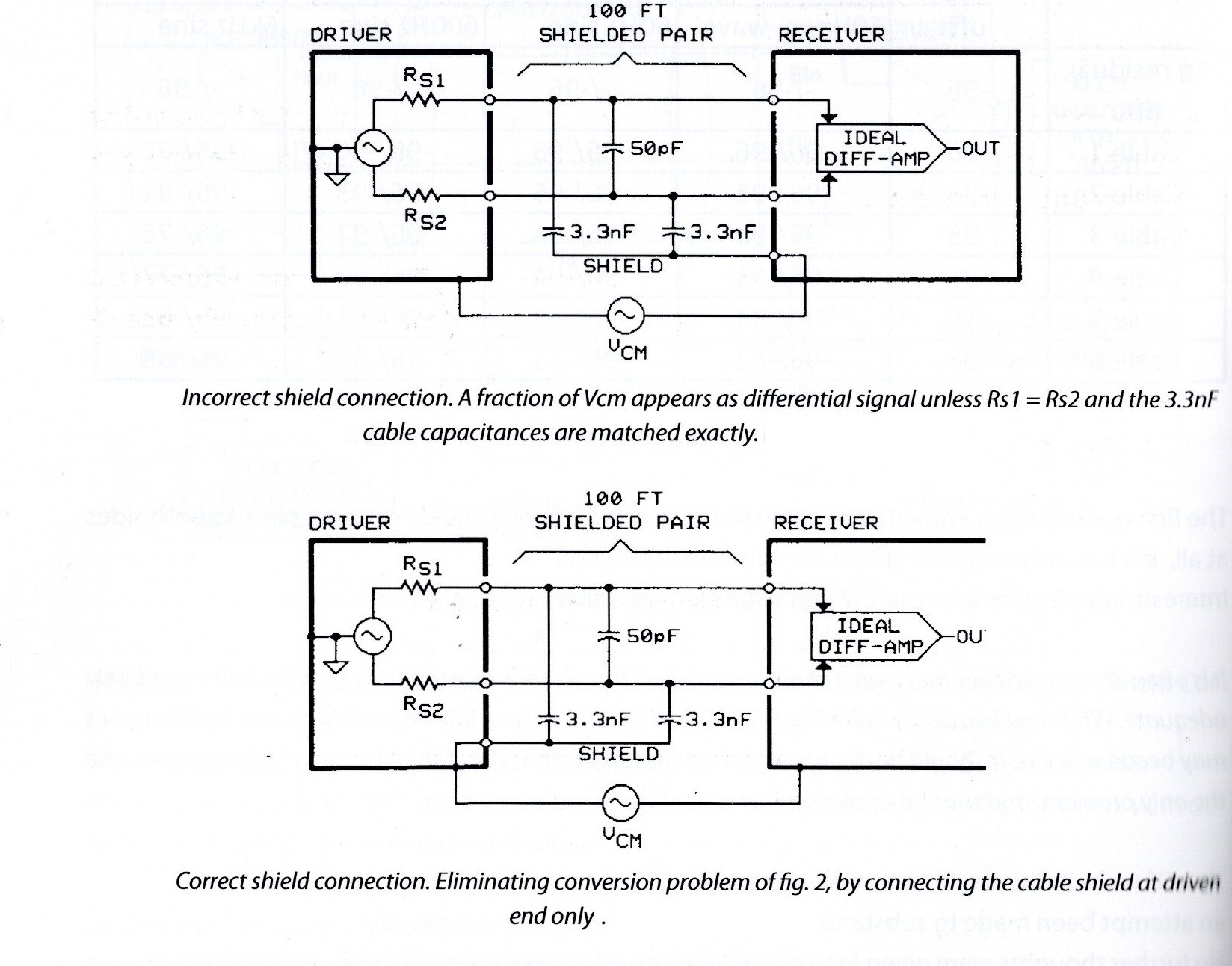

Not meant in any way to be a personal attack, but allow me to be amazed that all at the sudden balanced connections are getting a bad name.Any recommendations to replace my balanced Benchmark Amp with a pure SE Amp? 🙂
Balanced connections have many advantages, but have to be executed properly.
As I mentioned earlier, if not you will have two SE lines fighting each other, so in most cases not leading to an improvement over one single SE connection.
The Article that I published in Linear Audio was supported by Bill Whitlock, one of the authors of AES48, so not exactly someone.
He also supported and preferred this "One End Only" topology and explained why, see first image below.

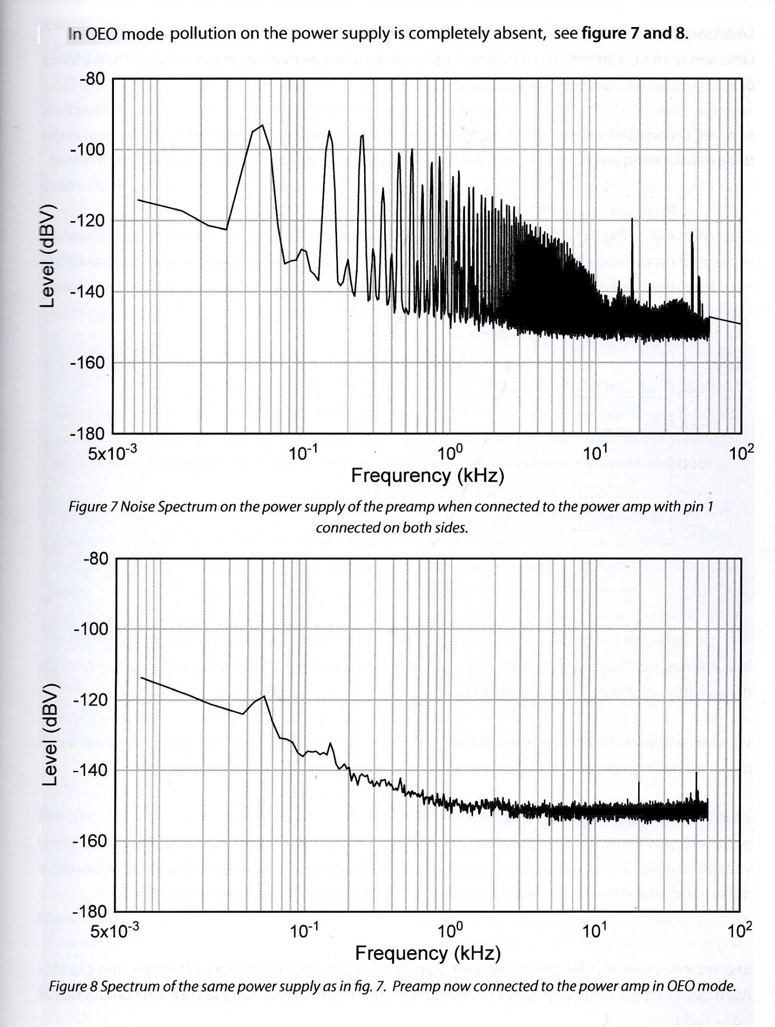

The Vcm source between the two chassis, indicate that although both chassis must be connected to mains gnd via their rep. mains cable, that because of induction to this mains gnd wire in the cable, the two chassis have potential differences between them. In the article measurements show this to be easily confirmed.
Example of comparing noise on a preamps power supply, with and without pin1 connected between preamp and main amp and both chassis connected to PE, is shown in the second image.
When you try this by simply lifting pin1 on the receiving side, but you still prefer SE, fair enough.
But rejecting balanced without having properly tried is, you name it.
