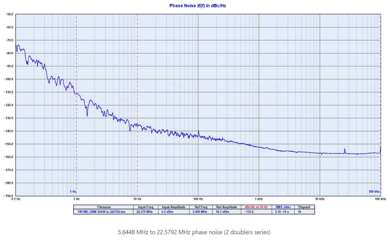

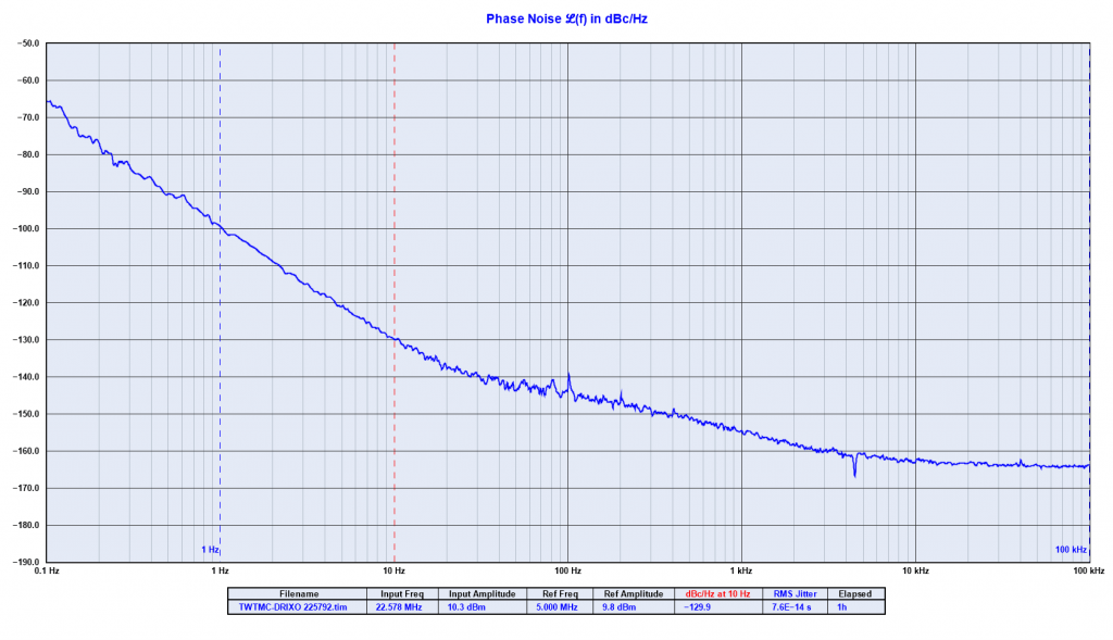

Acko, the two plots shown are just that what You see.. the phase noise plot of the the multiplied up source is 10dB better at 1Hz; ,~6dB better at 10Hz..
What You maybe are hinting at that the lower phase noise plot is getting more "rugged", less clean.
Now, if You have experience with looking at these things, that is again just a second confirmation of the quality of the DUT: at that close-in frequencies the applied instrument itself gets just too close to it's limits and gives a less stable output plot..
Reassuming: at 1Hz, 10Hz it's simply better than the 'native' 22MHz oscillator. At 100Hz, 1kHz they are equal. At 100kHz out - there is a slight advantage for the native oscillator, there one can observe the additive noise of the amplifier stage in the doublers.

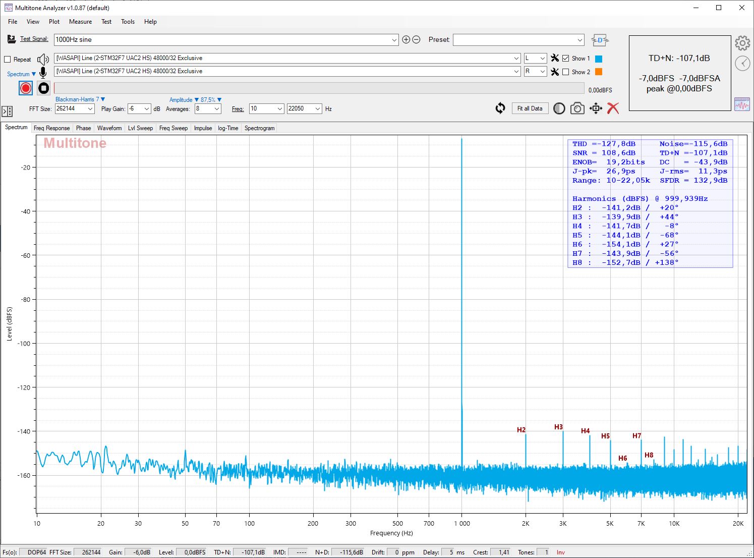

Early this morning while half asleep in my bed it dawned on me that I could just use MCK divided by flip flops as DCLK since MCU generates DSD signals from the same MCK.
Some solder-slingering and here are the results. This time only in DoP64.
First 1kHz:
That noise figure looks promising. BTW I switched to ES9822PRO to get to the lowest noisefloor.

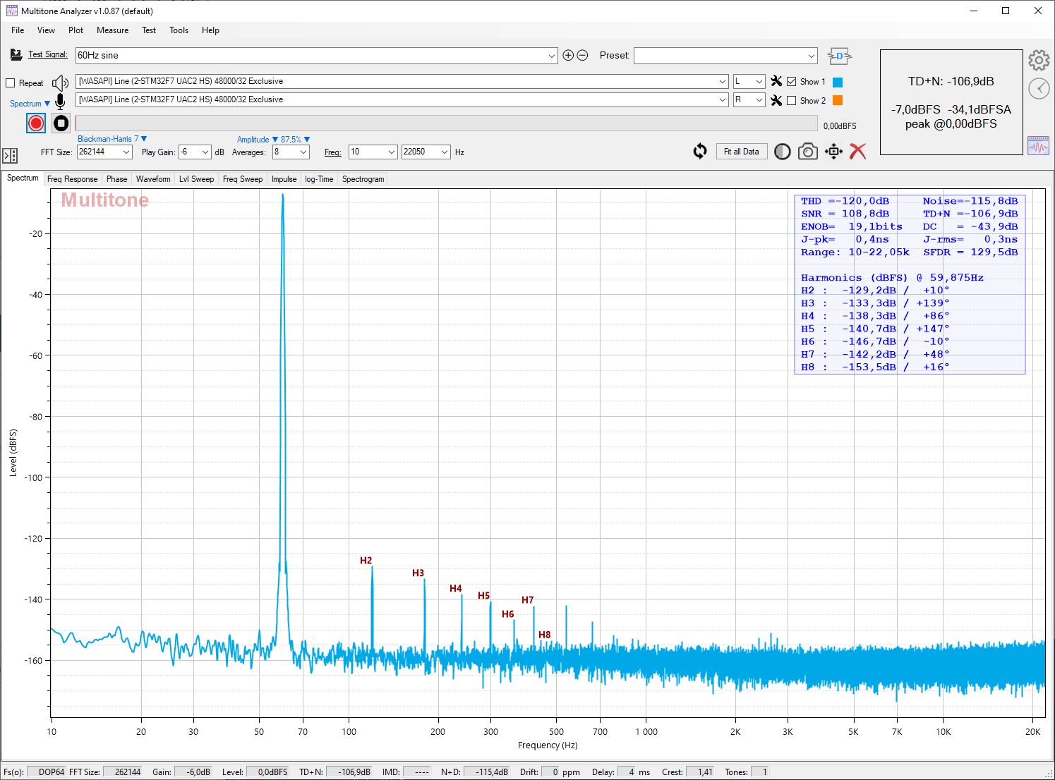

Next 60Hz:
Still looking excellent.

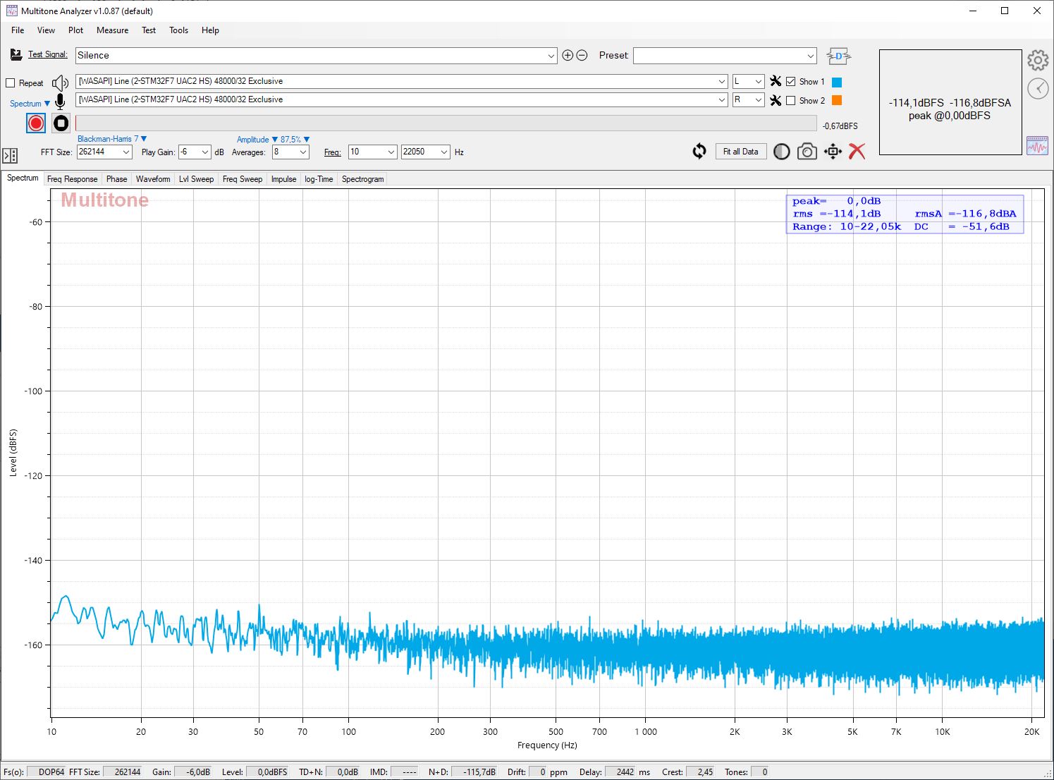

Finally SNR:
SNR -116,8dB(A). So not only new PB but new WR and by a wide margin.

Finally SNR:
