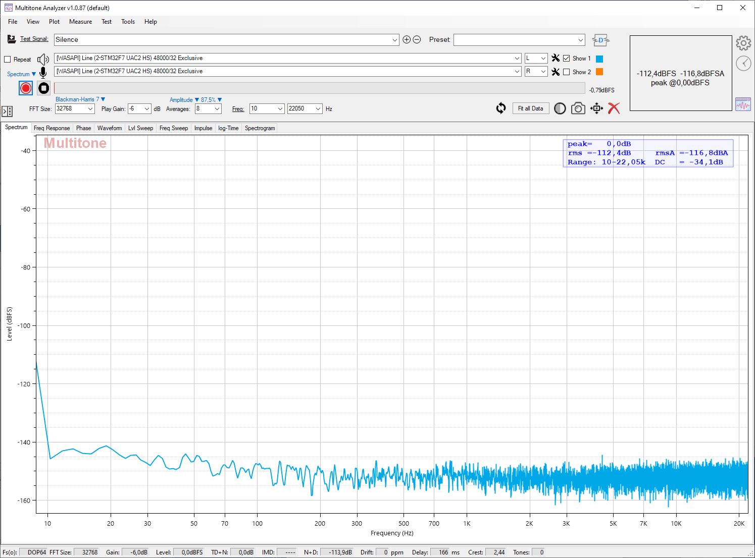

I'm trying to understand the noise figures that you measured.

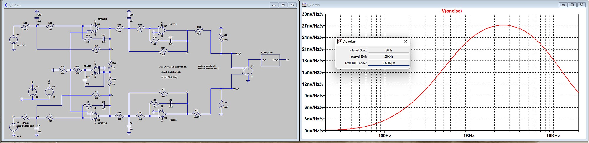

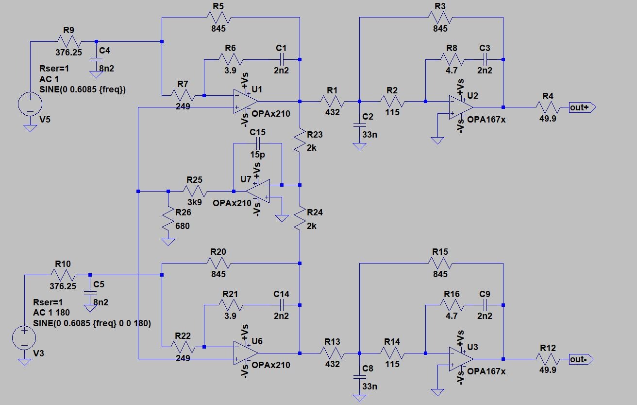

The 0dB output from the RTZ Firdac that I had, measured 1.924Vrms on the balanced outputs.
When simulating the filter that you use, with OPA2210 and NE5532, I measure a A weighted noise level of 2.6882uVrms.
There are many things where LTspice is not as accurate, but with noise measurements it excels.
All the right Voltage and Current noise figures, including their knee frequencies, were used as from the specs.
Taking 20*log(2.6882e-6/1.924) gives a S/N of -117.1 dB(A).
But this is the reconstruction filter only, without the added noise generated by the DAC.
So with a measured -116.8dB(A) and practically the same noise level visible in all 3 images in #1090, it almost seems as if some some calculation from filter bin width to broadband noise has a factor that is incorrect.
Hans
P.S. just to check, what happens to the measured noise level when taking a FFT size of 32,768.

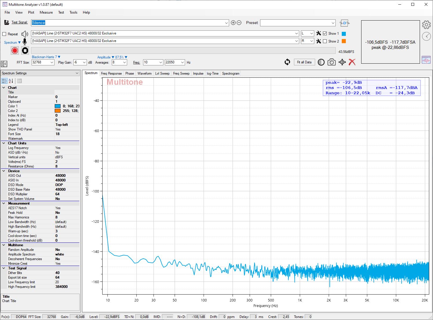

As I said on post #1102 my filter stage has higher gain so 0dBFS results in about 4Vrms. Not that it necessarily matters for noise on my board the filter stage uses OPA1678s instead of NE5532s.
Here is SNR measurement (i.e. dac playing silence) with 32k FFT. Result is more or less the same. As I said before most SW I've used has been able to calculate SNR correctly regardless of FFT window or size.

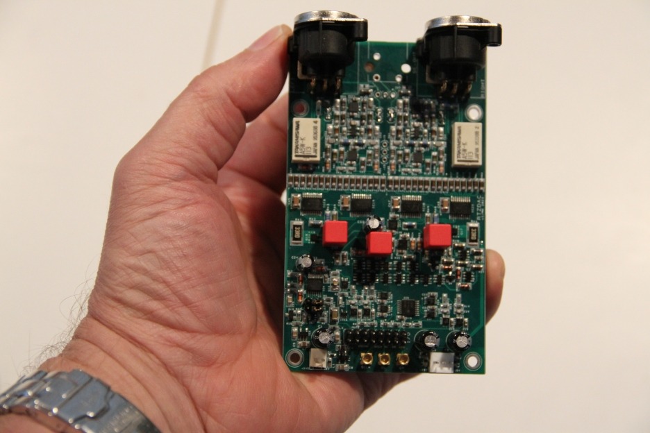

During the weekend I found some time to disassemble my DAC and bypass the last op-amp stage and the coupling caps as suggested.
The obvious confirmed, (not so obvious until Hans Polak revealed that).
The already organic and smooth sound of this DAC is much better now.
@nautibuoy The filter board sent to Acko is unmodified. Why would he be sent a version that three people already found to have inferior sound?
Just trying to understand. The sound is inferior to Andrea's dac, and this is likely one fairly obvious possible cause.

So obviously the size of the FFT does not influence the S/N.
I don't know at what point in your filter you changed the gain, but the most effective point would be to change the 845R around the OPA2210 to 1k75, and to change the 2n2 to 1n2 for keeping the FR as flat as before.
With these changes including OPA1678 , I get a S/N of -120.3dB(A) just for the reconstruction filter.
When subtracting this noise value from the measured -116.8dB(A) for (DAC + Reconstruction Filter), this calculates into -119,4dB(A) for the Dac alone.
Hans
The filter in #1116, gives 2.2dB more noise as changing the gain at the first stage.
Now 0dBFS is 3.767Vrms and noise is 4.7048uV(A)
S/N then becomes 118.1dB(A) for the reconstruction filter, so with the measured -116.8dB(A) for the combo, this calculates into -122.7dB(A) for the Dac alone.
Hans
Just tried the last filter stage bypass mod.
Sound is a little more bright/clear, instruments are bit more separated from each other, soundstage is slightly wider than the speakers, imaging is improved some, and some but not all of the blur/smear is gone.
One more improvement. Moved slightly closer to Andrea's dac sound.
Chances are that the filter of post #1116 distorts a bit less than one with doubled gain in the first stage. At least the first stage will distort less due to the smaller signal levels at its output and the higher loop gain due to stronger negative feedback. I have no idea how large or small the difference will be.
