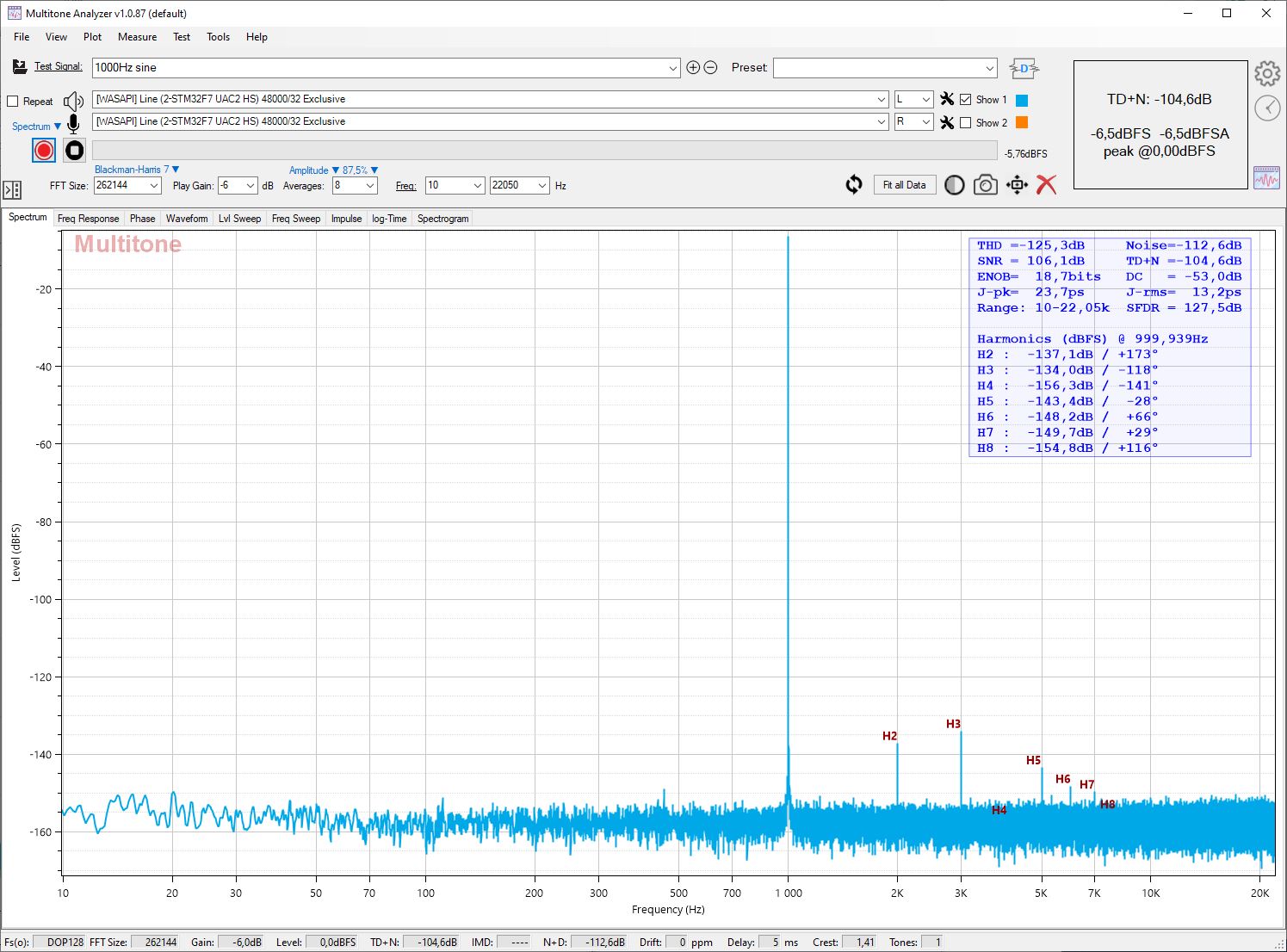

This got me thinking. It would be fairly straightforward to do all that in MCU. So instead of generating DCLK, DL and DR as it now does MCU would generate doubled DCLK, RTZ DL+DLN and RTZ DR+DRN. Not much processing in SW. I need to try that later. It would however require STM32H7 instead of STM32F7 since the latter has some limitations in clock generation.
DSD signals are generated already now with MCU SAI (serial audio interface) from on-board or external clock. Do you see any far-off phase noise or clock spuries in my ES9038Q2M measurements?
Actually I should be able to do a proof-of-concept on one channel with my existing STM32F7 board. I'll just use DR for DLN. So MCU would output doubled DCLK and RTZ DL+DLN straight to 74LV574s.
No, because as far as I can see, you didn't measure the clock spectrum.
It could very well be that the ES9038 is less sensitive to far-off phase noise and spurs than my DAC. That depends on the internal structure of the ES9038 (I don't have time to read its datasheet at the moment).

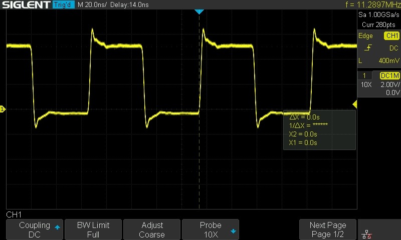

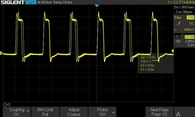

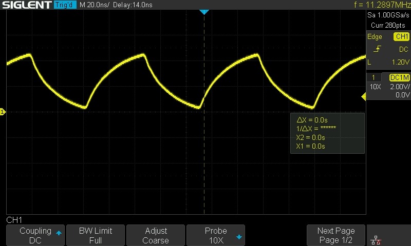

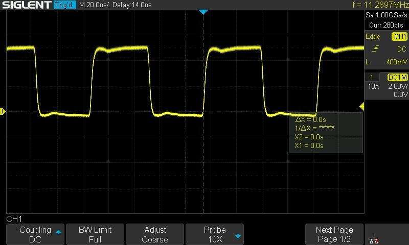

I haven't a clue what the input signals of U28 look like, but Hans did have a look at the output of U28A on my prototype board, using a 470 ohm resistor, 50 ohm coax cable and 50 ohm termination at the input of his oscilloscope. It looked quite nice, actually, with a pulse width of about 8 ns, closer to the design target than I had expected.
Here are the signals to/from U28 in my board. DCLK signal in this case comes directly from a 11.2896MHz clock so MCU can be ruled out. I used a probe with spring clip for ground. Clock doubler (U28 pin 7) looks very jittery. In this case it is not connected to anything so there should be no reflections. I have already swapped U28 but signals look still the same.

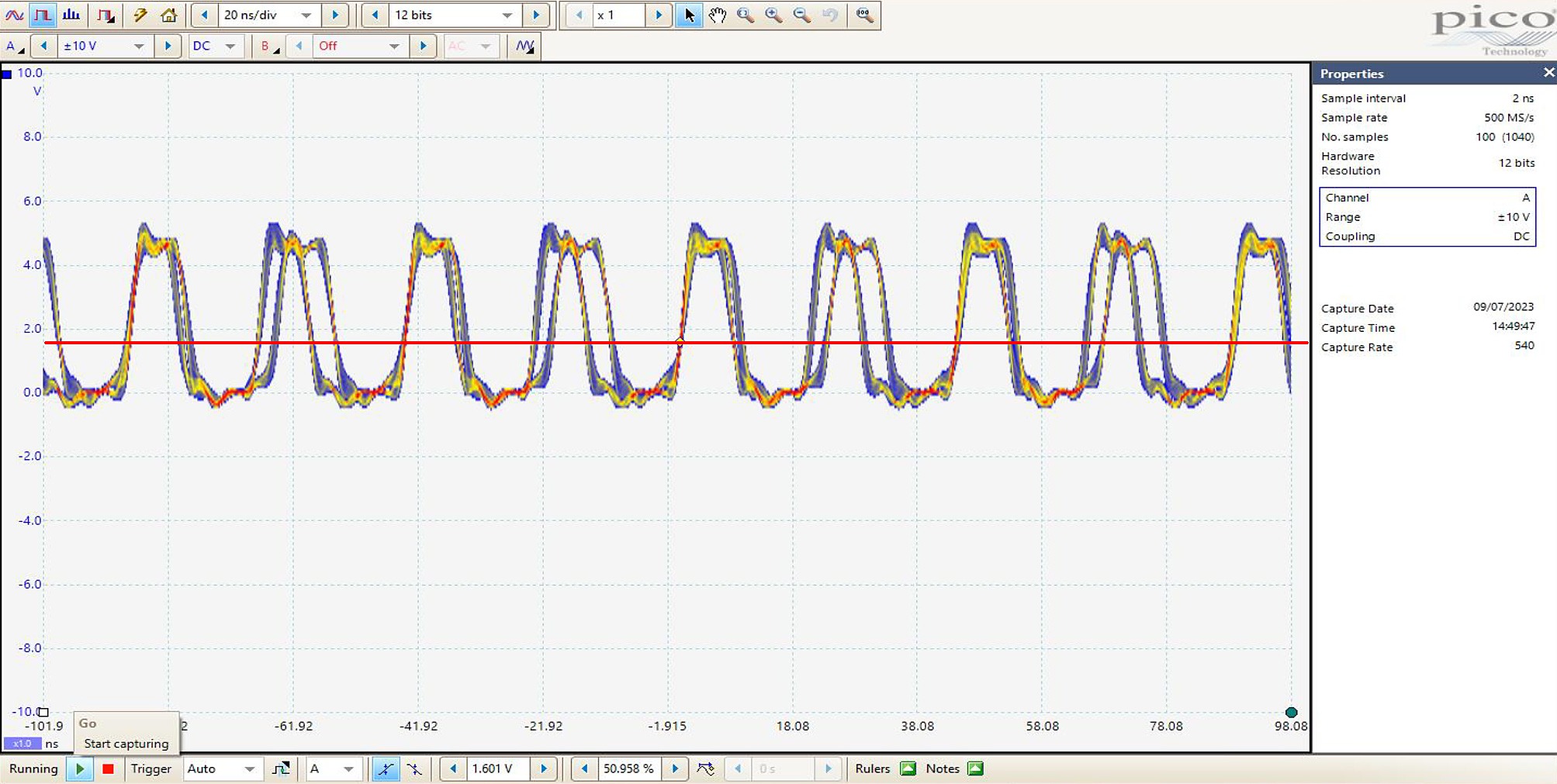

Here are my measurements at U28 pin 7 at DSD512.
I use the persistence mode on my scope to better detect any jitter, the horizontal red line shows the trigger level.
The clock doubler produces an asymmetric pattern of a shorter period S and a longer period L, where L+S is the period of the incoming clock, because of assymetric triggereing of U28.
So what seems to be jitter, are the L and S periods in between, but Marcel explained that this has no effect on the Dac.
If any jitter exists, it must come from the Amanero.
Hans
