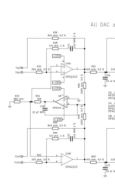

….The first filter stage with its common-mode loop (U8, U15 on the filter board) is the differential to single-ended converter when you use it in single-ended mode.
Hi Marcel, I can’t seem to get my head around this concept. I thought U8/U15 are like dc servos to null the outputs. So, how do they function as BAL to SE converter like a typical differential Amp?

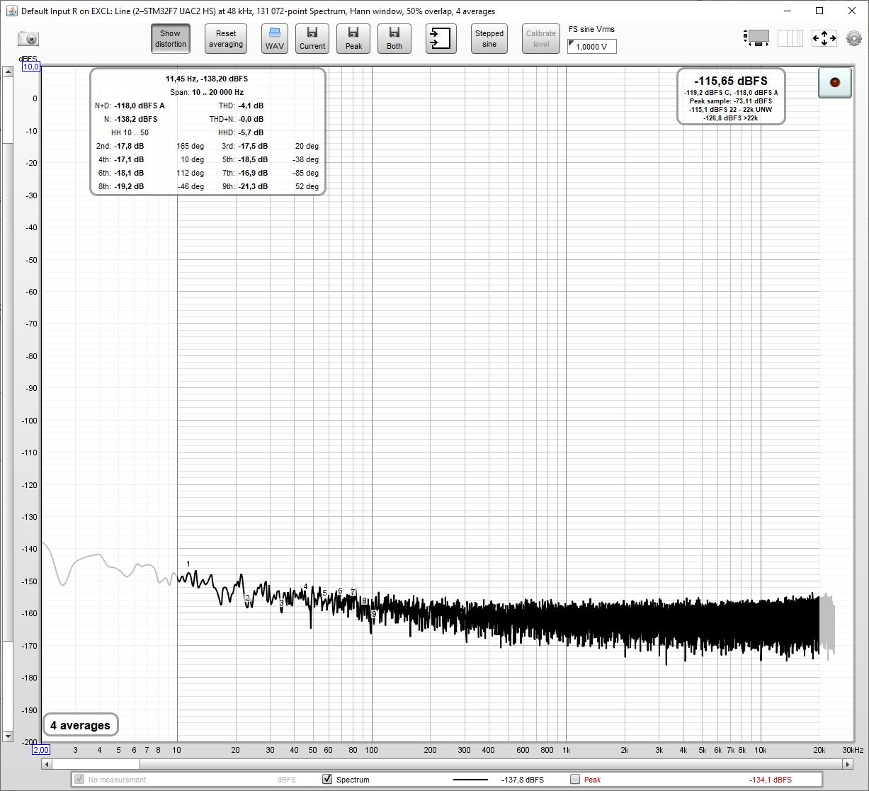

What sound card are you using.
I’m amazed what dynamic range you seem to be able to cover.
In your image I can see a 262.144 point FFT, but what is the sampling frequency, 44.1 Khz ?
That would mean a filter bin width of ca. 0.17 Hz.
To compare your noise level to 1Hz bins, one would have to add 7.7dB to the noise level . One Herz is the bin width I’m always using for easier calculations.
in your case a Blackman-Harris window increases the spectral content per bin.
A rectangular windows does not, but maybe your software takes this into account ?
A last question, what is the noise you measure when connecting the output of your soundcard to its input in a loop test ?

No sound card. DAC is DUT and ADC is AK5394 as seen on https://www.diyaudio.com/community/attachments/measurement-setup-jpg.1199175/.
So all my DAC measurements are in a sense loop tests.

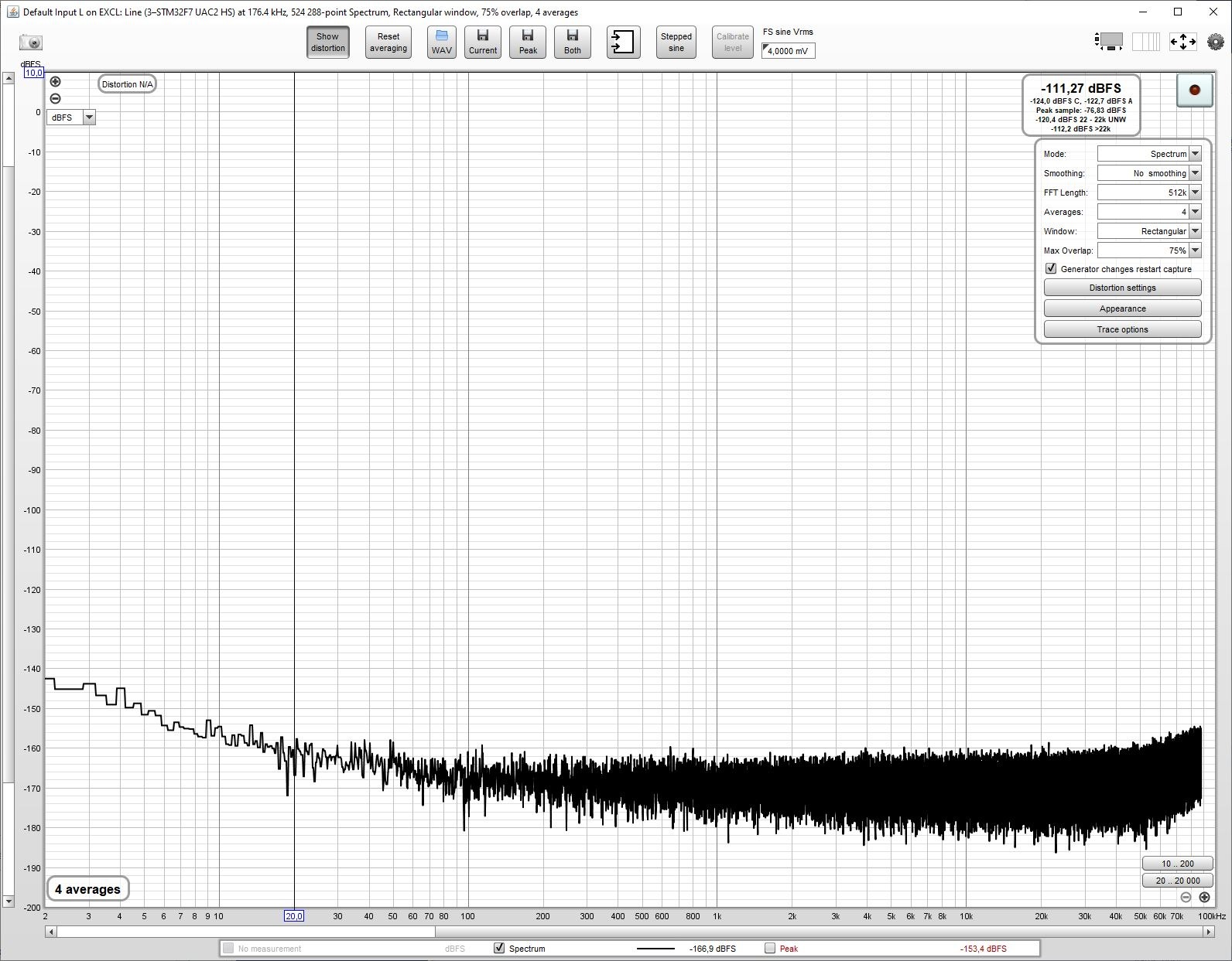

For noise measurements you should use V/rtHz scale as then the bin width is fixed. E.g. as in https://www.diyaudio.com/community/attachments/lt3045-15v_noise-jpg.1199182/. But for measuring SNR most software are able to calculate it properly in dBFS/dBc/dBV scale regardless of FFT window or size.
For lowest noise floor I use PCM and ES9822PRO as ADC. Here is the PCM noisefloor of ES9038Q2M/ES9822PRO with bandwidth from 2Hz to 96kHz.
Unfortunately ES9822PRO suffers from "ESS IMD hump" and has high order HD artefacts which is why I don't use it for DAC THD measurements.

your ES9038Q2M result is indeed impressive
Thanks. What I find remarkable about those results is that no THD compensation is needed. ES9038Q2M is set to SYNC mode (without ASRC). With PCM input 3rd HD is much higher so THD compensation is required to reach similar levels. Also ES9038Q2M in PCM mode has much more high order artefacts as shown here. These DSD results are somewhat strange as ES9038Q2M is supposed to convert DSD to PCM internally for volume control so it may be that PCM input causes higher RF glitches than DSD.

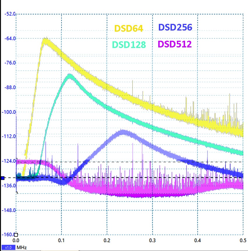

So you are using a 60dB 0.33nV/rtHz LNA and an ADC at some sample frequency displayed with a window that is all calculated in your software down to V/rtHz, Right ?
Sorry for my questions, reason is to trying to understand why you are measuring a much higher S/N than Marcel and I did.
What is the maximum signal your LNA can handle, because that's the reason I could not measure the S/N for DSD64 because of the huge HF content .
And is this LNA SE or Balanced, I tried to fid Scott's LNA but failed to find it, because in balanced form S/N will be most likely -3dB lower.
Your ADC most likely has a sharp filter to prevent aliasing from the large HF content in your spectrum up to 20Khz, right?
Hans
...how do they function as BAL to SE converter...
Look at the feedback cap on the common mode opamp. The time constant is too short to only affect average DC offset. It will work to correct dynamic AC offset/imbalance too (do common mode noise attenuation). IIUC the circuit, that's essentially what balanced to SE conversion does.
Yes, for the 2 noise measurements I used a 60dB LNA. The software I use is either REW or Multitone Analyzer neither of which is my software.
LNA is SE. More about it here. My version has 4 parallel 2SK369s which bring the noise density to about 580pV/rtHz. I also have Samuel Groner's LNA which goes to about 400pV/rtHz.
SNR measurements were made without LNA. So normal loopback from DAC to ADC in balanced mode.
Yes, AK5394 has a filter but I don't think that is the reason for no HF content with DSD64. My guess is that the SW you used for DSD generation is responsible for the HF content.
It's not the software I use, it's the spectrum of DSD after filtering on Marcel's board.
See image below.
It's exactly this huge HF content that oversteers my LNA, making it impossible to measure S/N.
But does it also ‘sum’ the inputs like typical differential Amp? Any other reference for this circuit about how this BAL-SE is accomplished?
...does it also ‘sum’ the inputs...
We sometimes call it 'differential summing.' Its taking the difference of two signals, one of which is inverted relative to the other. Doing that attenuates common mode noise. Doesn't matter the exact topology used to do it, just the end result that matters.
Also, maybe consider what it would be doing if it were a DC servo. That would just mean it attenuates only very low frequency common mode noise. At least, you could think of it in those terms.
Ok, thanks!
In that case all good to go with SE only by just taking half of the final output stage - knowing that the balanced output from the DAC core gets converted fully into unbalanced line output with good CMRR. So do we still need to worry about tidying up other matters as thought before?
