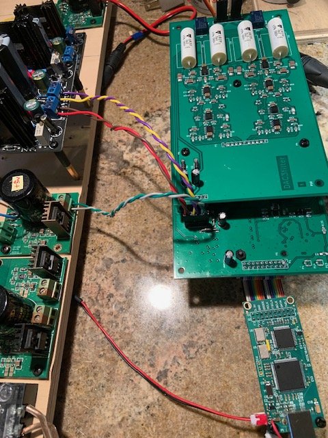

Simple power supply change:
Each rail is on its own transformer winding. Only common ground connection is at the dac.
Sound is getting deeper, with more space and detail. At the same time certain remaining distortion is more obvious. Compared balanced and SE again. SE sounds more distorted yet better space and detail. OTOH balanced is less distorted but it really hurts the space and detail. So, just have to go after the distortion.
Probably time to add galvanic isolation of the USB ground and the better clocking of I2SoverUSB.

Mark,Simple power supply change:

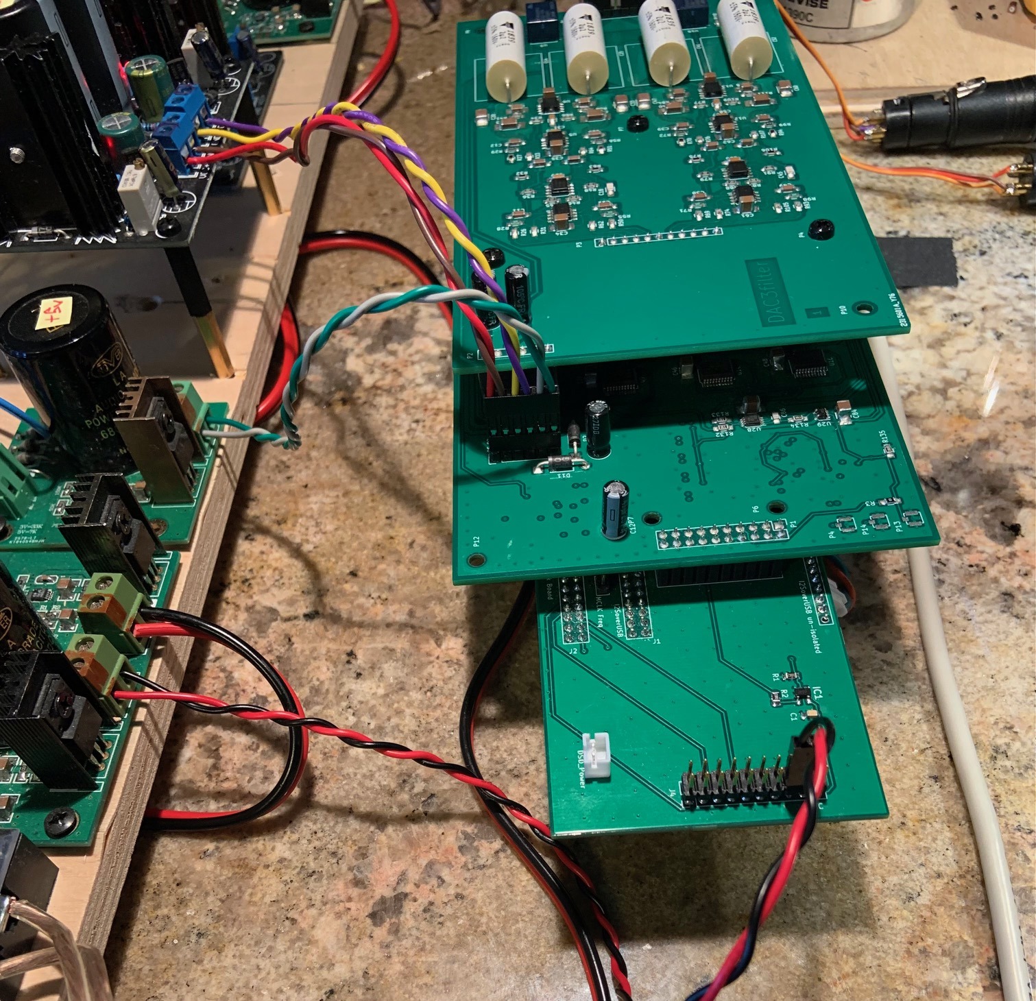

Yeah. Something doesn't make sense here. Will put off troubleshooting for now though....Amanero Wasapi can be used for DSD64 and DSD128 and only the Amanero Asio driver can be used up to DSD512.
Turns out the adapter board I have for Simple DSD Converter works to interface I2SoverUSB to Marcel's dac:
I2SoverUSB clocks are still warming up, but the distortion nearly all gone. Maybe 95% gone. Using two isolated 5v supplies for I2SoverUSB, one for the dac side and the other for the USB side. There is also a 3.3v power input for an inverter for the DSD_ON signal on the adapter board, as can be seen in the lower right hand corner of the pic. Normally the inverter would be powered by the Simple DSD Converter board.

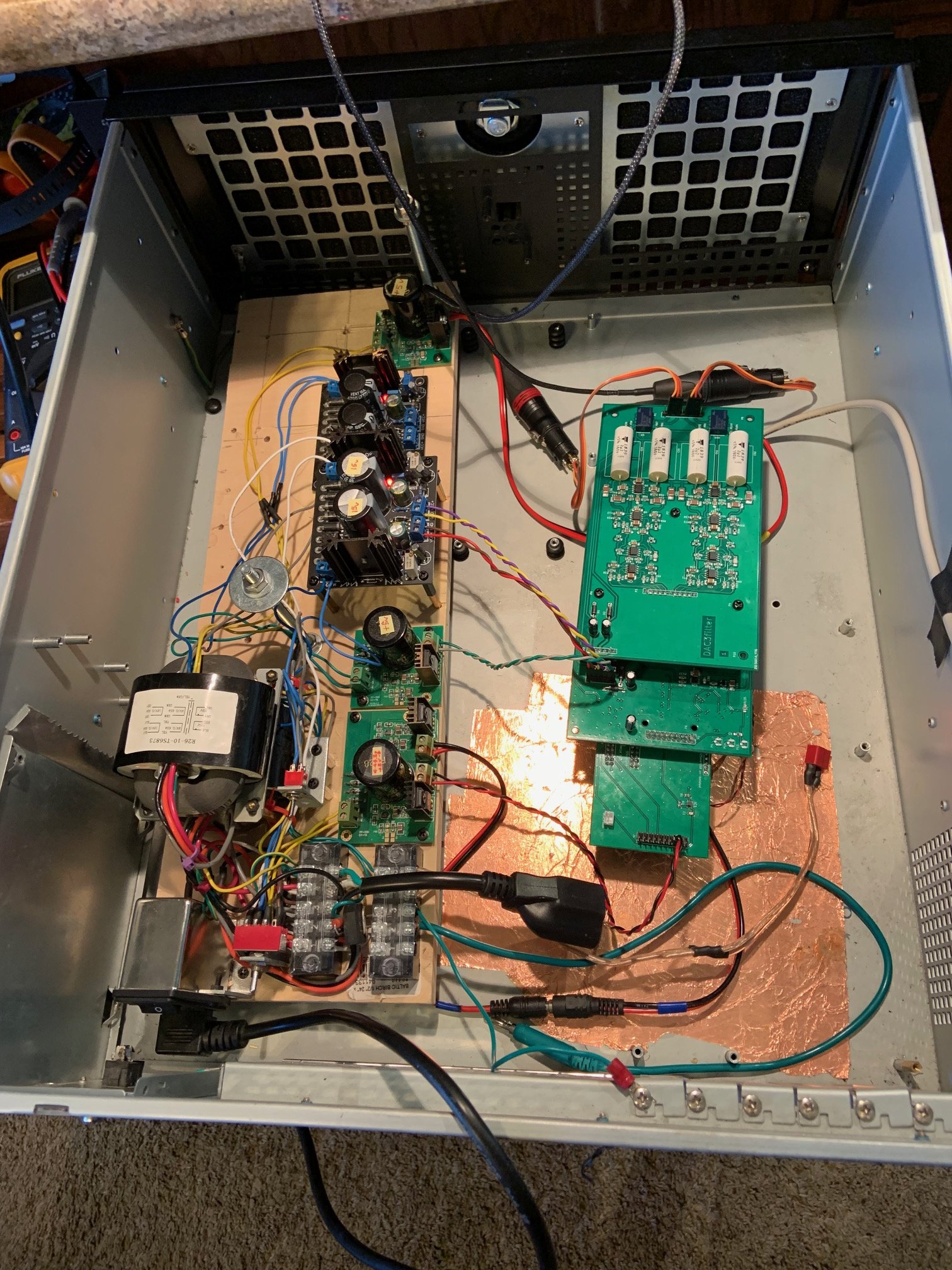

Latest audible improvment:
Some shielding. Getting close to time to hook it up to the main system.
Impression at this time is that I am listening to a string of op amps, and clocking could be better. There are options though. One thing at a time. Feel like its still too soon for a fair comparison with Andrea's dac.

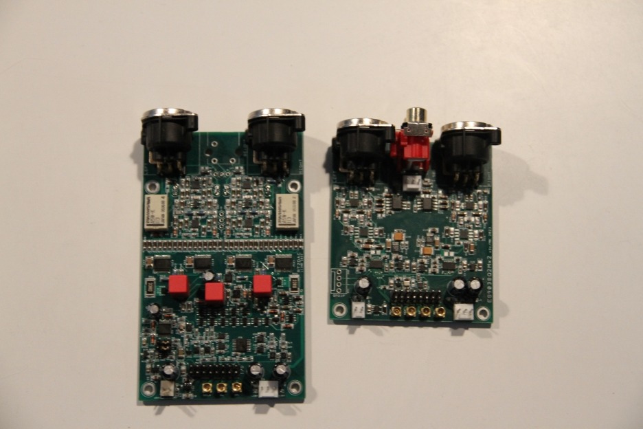

Here is another picture of the RTZ dac next to my ES9038Q2M dual dac. Both use same form factor for input and output connectors which makes it easier to swap dacs in chassis.

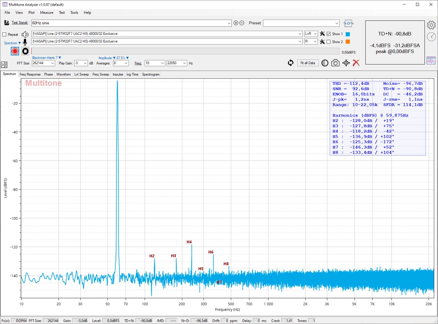

Here is 60Hz sine:
As with 1kHz high order HD is below the noisefloor.

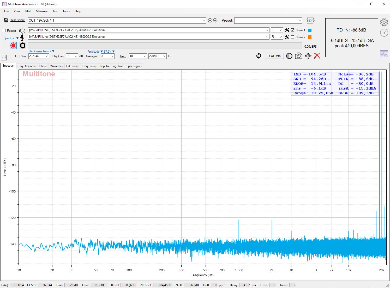

CCIF 19k/20k:
Very good.

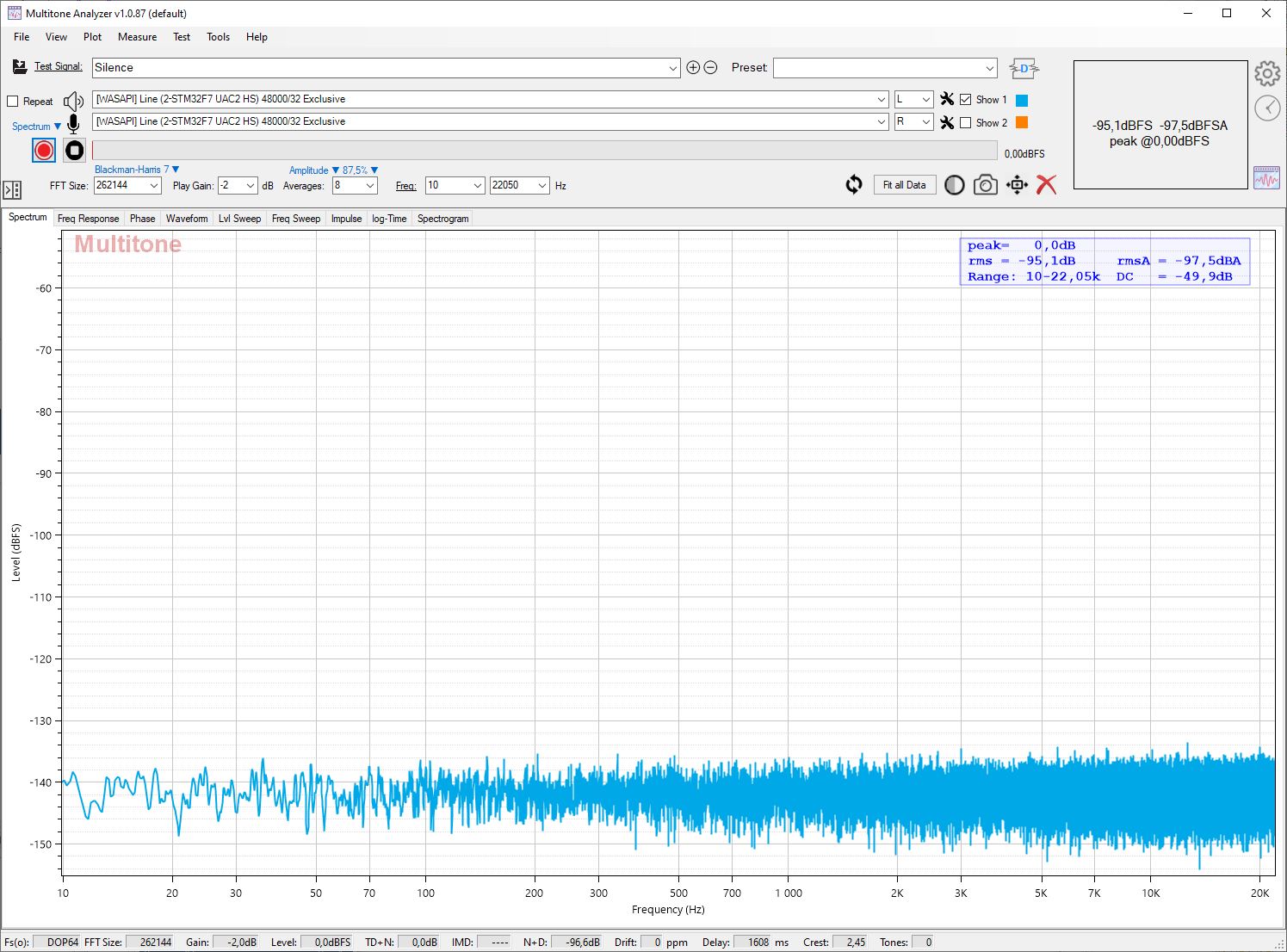

Let's get back to the noise performance.
Here is SNR (i.e. DAC playing silence):
So SNR(A) is -97.5dB. I'm not sure if this can be directly compared to Hans' measurements as I have typically seen slightly worse noise numbers with Multitone Analyzer.

Here is 60Hz sine:
CCIF 19k/20k:
Very good.

Overview of the measured noise floors:
-97.5 dB(A) for DSD64, bohrok2610, different board design, DAC + DIY STM32F723 board
-105.3 dB(A) for DSD128, Hans Polak, DAC + Amanero
-103.3 dB(A) for DSD256, Hans Polak, DAC + Amanero
-95.7 dB(A) for DSD512, Hans Polak, DAC + Amanero
-100.8 dB(A) for DSD512 with my PWM8 algorithm, Hans Polak, DAC + Amanero
-104.6 dB(A) at 27 Mbit/s PWM8, MarcelvdG, DAC + FPGA board and some other logic from an earlier DAC
