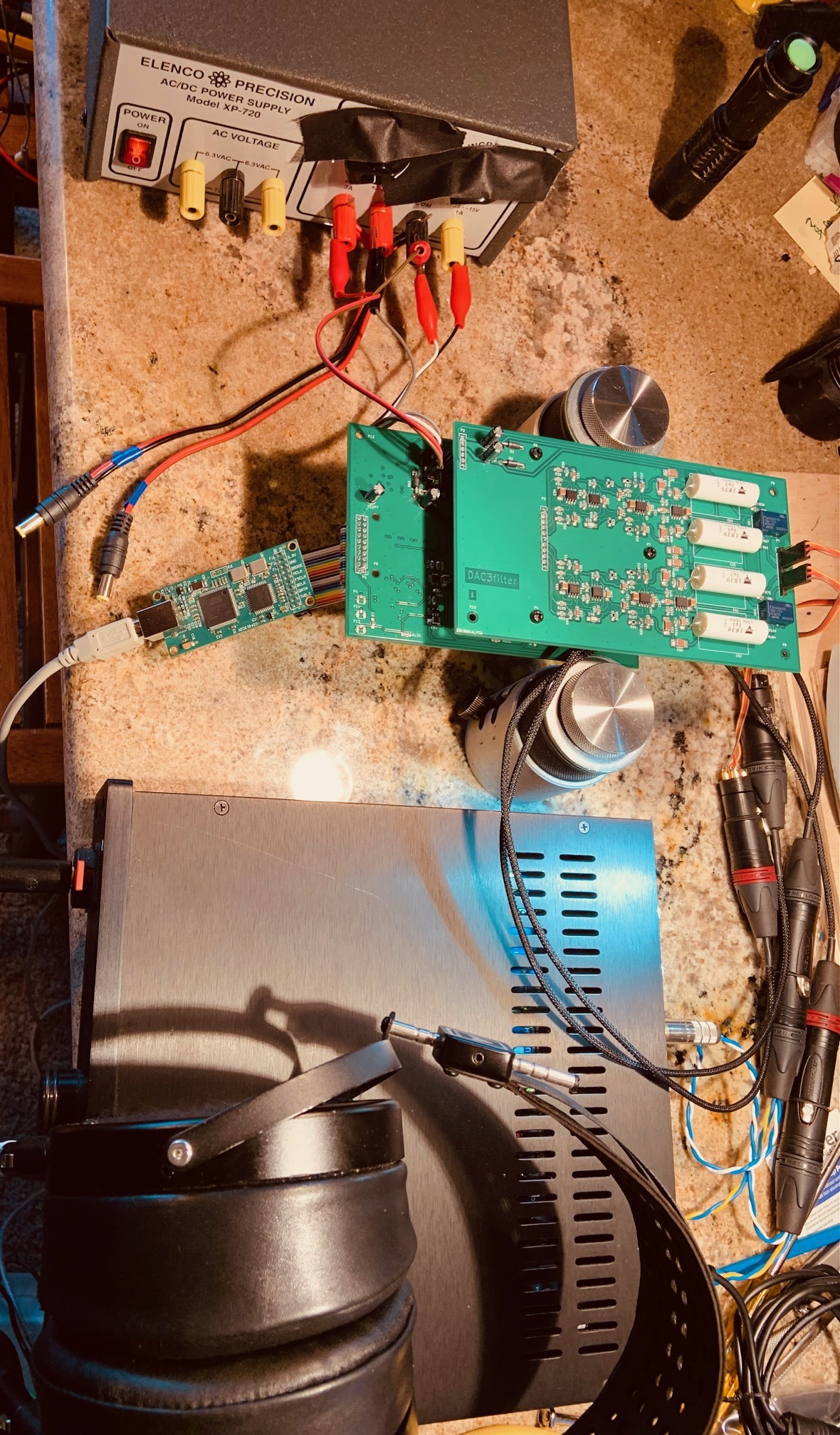

Here is a pic of the way the dac is hooked up now:
Power supply is set to +-15v (with knobs taped to make sure it doesn't get bumped). Regulators are LM317, LM337, and LM7805. All share a common ground which is then grounded to the AC power line ground. USB board is USB powered. Its all sitting out in the open. This will represent about the worst case setup. How does it sound this way? Not very good, really. Sounds are blurred together; a lot of detail is missing—veiled over, one might say. However some people might not even notice something is wrong if that's the kind of sound they are used to.
Next go round will be to start fixing some of the obvious issues with the setup.

Reason for starting with Amanero is because the dac board is designed to that interface standard. Obviously, its not completely ideal. However, each of the I2S lines has a ground on the adjacent pin the next row of the pin header.
So Amanero pin 13 ribbon wire should be between the wires for pins 3,4 in the ribbon cable, etc. At least that's why it seems to me.

Just moved Amanero to clean, isolated +5v, instead of USB power. Dramatic improvement in SQ. Most of the veiling is gone. More low level detail and accuracy.
Playback at the moment is still with SACD rips (DSD64).
EDIT: Now that the USB board power is fixed, other problems are becoming less masked. There is a bright, sort of metallic edge on the sound. Part of that is probably from the +-15v ground being shared with the +5v digital ground going back to the AC grounded power supply. More isolation of power and grounds may provide further improvement. We'll see.
