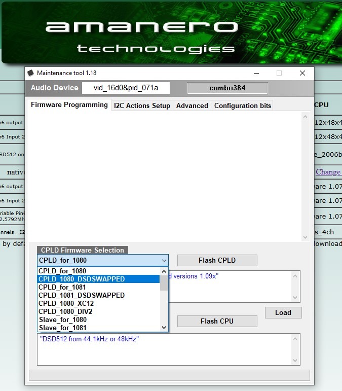

If you`re interested, there is supposedly a way to check if it`s a hardware pin issue by making use of the "DSDSWAPPED" version.

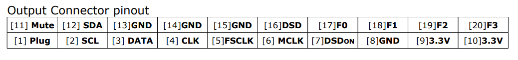

The reason I'm worried about the effect of the ribbon cable is that the ribbon cable I used to connect the digital part of my earlier solid-state DAC to the inputs of the prototype RTZ shift register DAC much increased the noise floor. The cable was several times longer than 5.08 cm, but it had grounds between the data and clock that you won't have with the Amanero pin-out (at least not when you connect the ribbon cable the way they are usually connected, with the first wire to the first socket of one row of the connector, next wire to the first socket of the other row, third wire to the second socket of the first row, fourth to the second socket of the second row and so on).
I really had to split the ribbon cable to keep the bit clock far away from the data. In the end, I switched to using thin coax for the bit clock.
Hi Marcel,
Reason for starting with Amanero is because the dac board is designed to that interface standard. Obviously, its not completely ideal. However, each of the I2S lines has a ground on the adjacent pin the next row of the pin header.
So Amanero pin 13 ribbon wire should be between the wires for pins 3,4 in the ribbon cable, etc. At least that's why it seems to me.
That said, I can check for noise on the lines at the dac board with an active low capacitance scope probe. If a problem, an easy fix might be to change the zero ohm I2S input resistors on the dac board to as much as 50R. Slows rise time a little, but often works quite well depending on the particular dac. Otherwise I can unsolder a pin header and replace it with a socket on one of the devices. We'll see.
Later, when I get around to trying with I2SoverUSB, I also have an interface board that is designed for use with the FPGA-based Simple DSD Converter (which also uses Amanero pinout). The adapter can probably be used to interface between I2SoverUSB and the dac board instead.

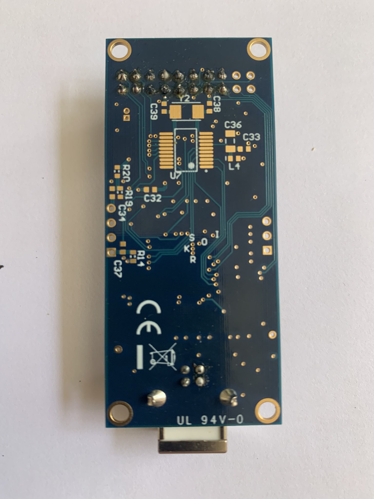

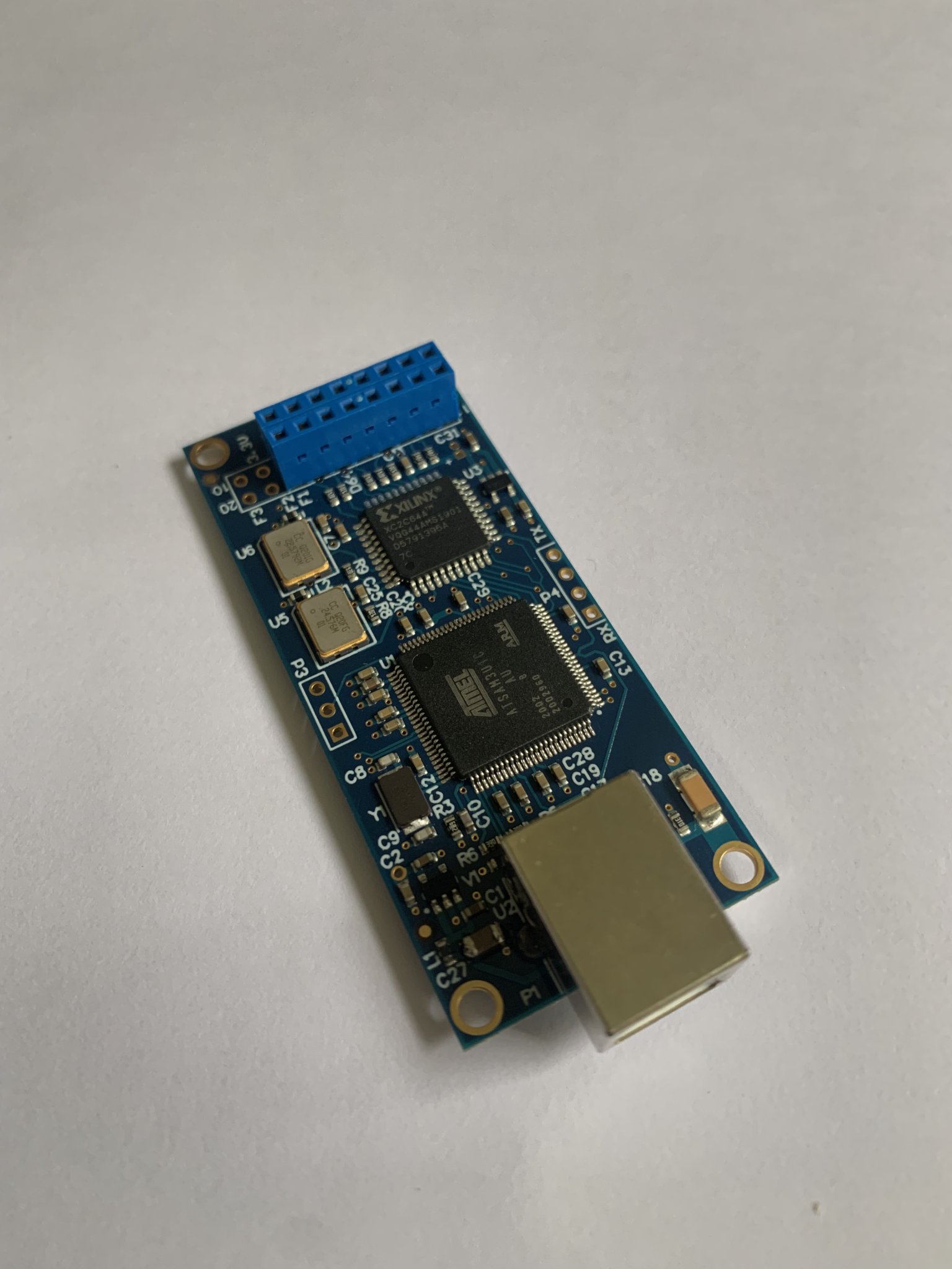

But, the previous image of Hans looks strange to me, all 3 looked way more like this one here:
https://www.audiophonics.fr/en/inte...l-interface-usb-384khz-to-i2s-dsd-p-7403.html
The pic Hans posted kind of does look a little odd, although maybe its just the color. A pic of the bottom side might be helpful.
Looks most likely real to me, although mine don't have pads for additional components on the bottom. Could be a model made for OEM use. Something like that.
Clones I've seen didn't have the CE marking, and the bottom plastic part of the USB connector was black instead of white. Another difference may be that real Amaneros have a ferrite bead for L1, whereas clones I have seen use a resistor.
Could this be a more recent model ?
Compared to the picture that Marco sent, mine has also receive and transmit connection points at the edge for SP/DIF communication.
