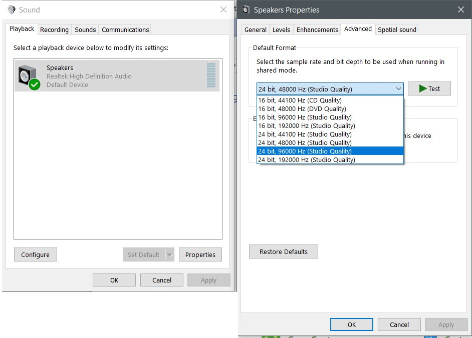

Also as I said before, Windows can interfere with ASIO. Its not a foolproof as WASAPI Exclusive Mode. Probably wise to make sure the sound device (the Amanero) has not been selected by Windows to serve as the "Default Sound Device" nor the "Default Communication Device." Its just just something else to check with working with Windows.
I never let my hi-fi sound card have the "green circle with the white check mark inside" as show below. That green circle is bad.

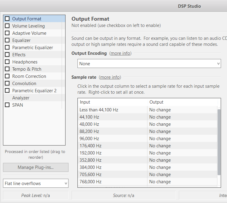

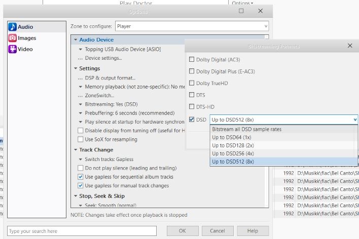

Hi Hans, hope you're enjoying your holiday 🙂. I've been playing around with JRiver and found some things. Did you enble DSD512 in Bitstreaming? Default setting is DSD256 (4x), and must be changed to DSD512.
The second thing is to disable the MC engine, Output format should be deselected.

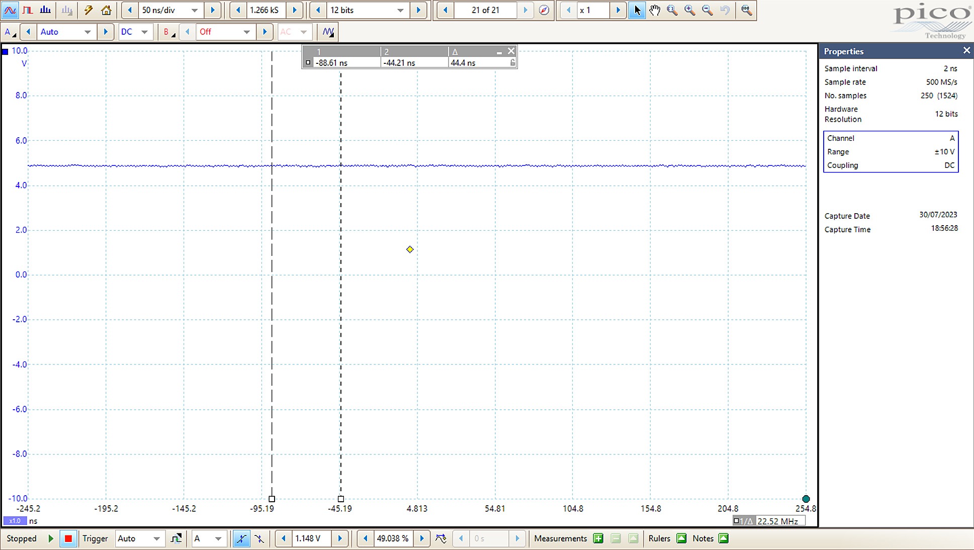

I measured the 5Volt USB power directly entering the Amanero Combo484.
The recordings where made while playing a DSD512 file, it didn't make any difference what file was played.
First image below is taken at a 50nsec/div almost equaling the 22.579Mhz clock frequency for DSD512, see dotted lines, this image recorded with a 2nsec sample interval, and never a glitch occurs.

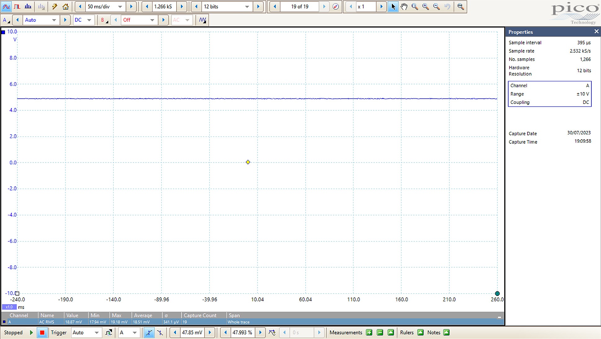

Second image shows the same but now for 50msec/div, giving a view over a much longer time.
In this image at the bottom, you can see that the 5volt DC has a noise level of ca.19mV Vrms, suggesting that the Amanero's power converter to 3,3Volt will have enough input voltage at all time.

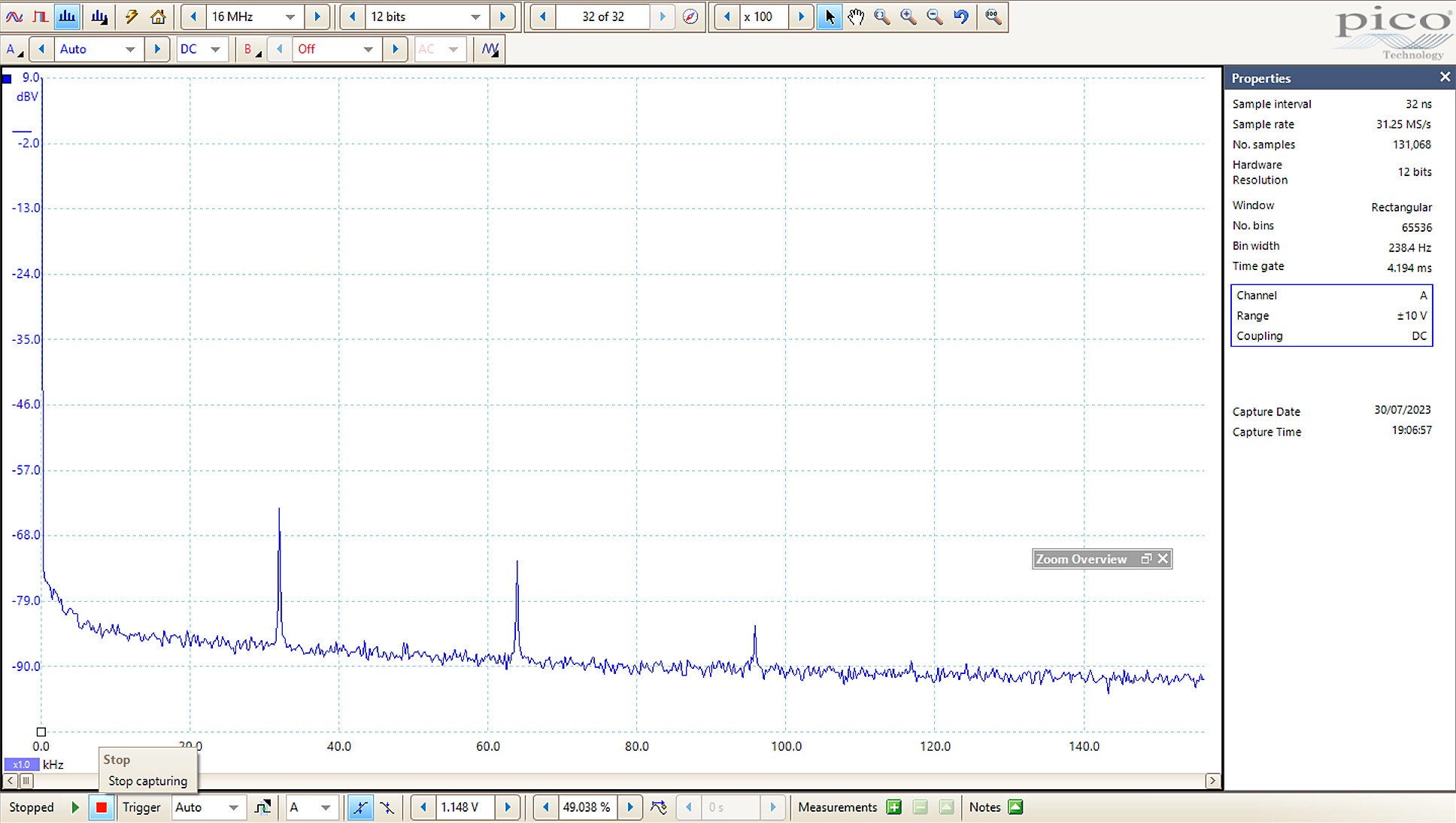

Last image shows the spectrum at a 16Mhz FFT BW, magnified to show the content up to 160Khz.
There are spectral lines visible at 32Khz, 64Khz and 96Khz, but at a 1mV level and below, most likely from my computers SMPS.
