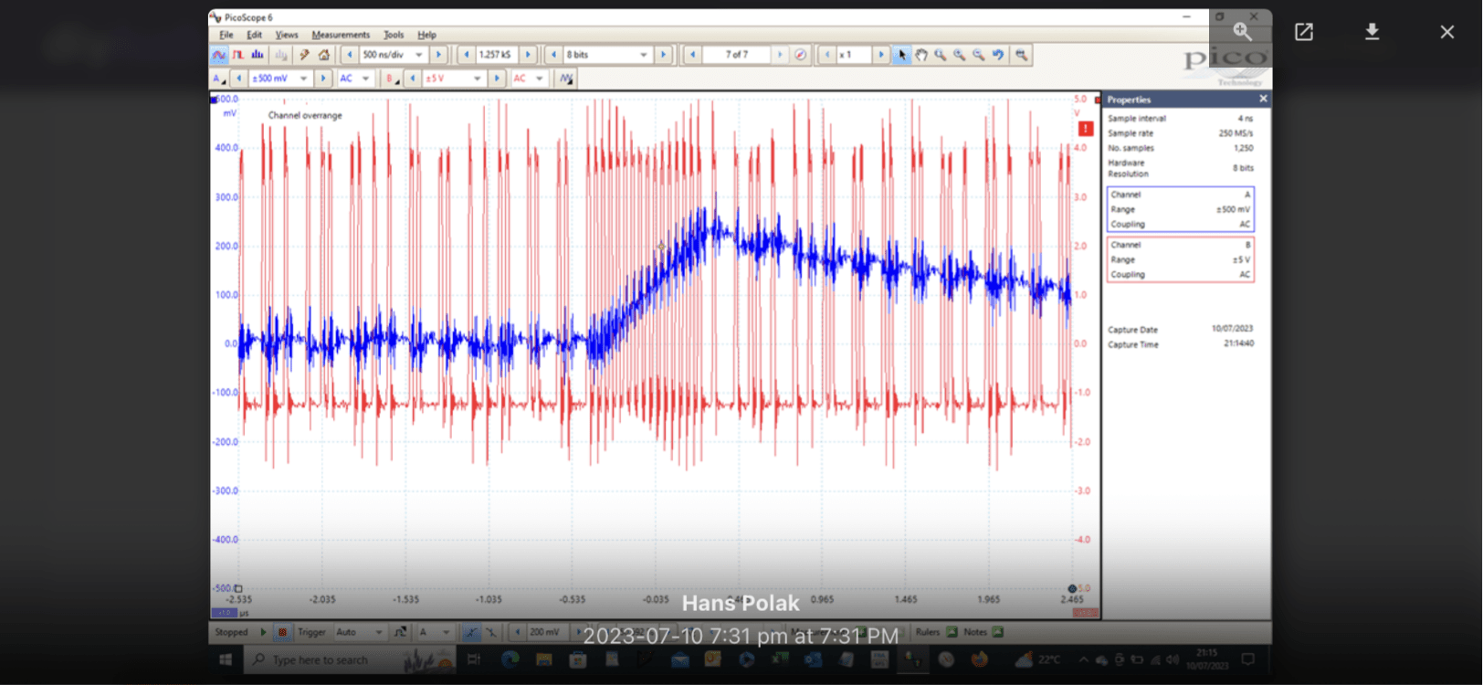

One could always use the trial version of HQ Player. It will run for 30-minutes at a time.
Its that when having problems like this, usually substitution is quickest way to figure out where the problem is. A scope to check the USB board output if often helpful as well.

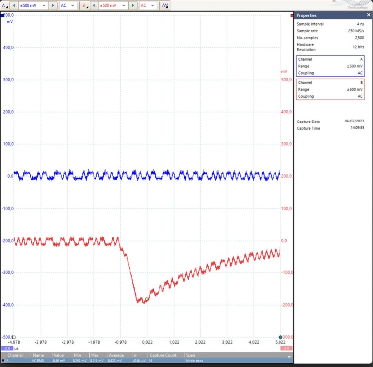

First image is the Amanero output in red and the Firdac’s output in blue before the analogue filter.
Second image is a more accuratr image of left and right channel again after the Firdac and before the analogue filter.
One channel is O.K. and the other is showing a spike, this time in negative direction.

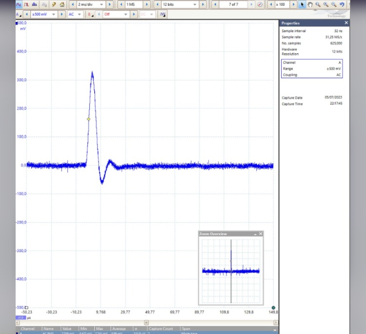

Third image shows how a spike looks after being analogue filtered.
Hans
Hans
Is the underlying issue here the DSD-on flag that is being output - Marcel's RTZ DAC has 0ohm jumpers that need to be correctly configured (for mute too). I suggest setting the Amanero to use ASIO non-DoP bitstreaming with a native DSD source and check the if the DSD-on flag at the output of the Amanero is hi or lo and then reconcile that to the jumper settings on the DAC. Just wondering, apologies if this has already been addressed.
