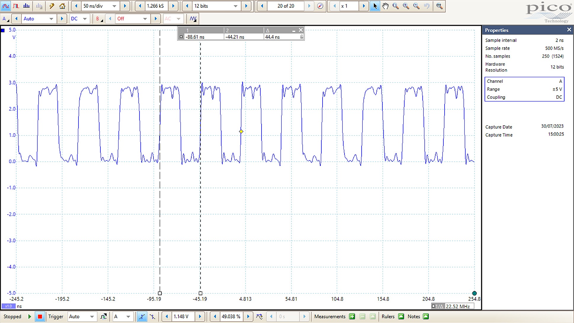

Without having the Firdac board, it's not possible to see glitches in the signal, but I measured Left, Right and Clock with 450R in series with a 50R Coax, terminated with 50R at the scope input.
I was surprised to see how well the signals were looking with this termination, so maybe the 100K on the Firdac board could be lowered quite a bit, possibly giving better results?
As an example see the 22.579 Mhz clock at the Amanero's output terminated as described for DSD512.
The left and right channel output signals had identical risetimes and shapes.
Recordings were taken at 2nsec sample intervals. For an even better signal shape I could have used 1nsec intervals, which I forgot to use, but this is probably good enough to show what a low termination does to the signal.

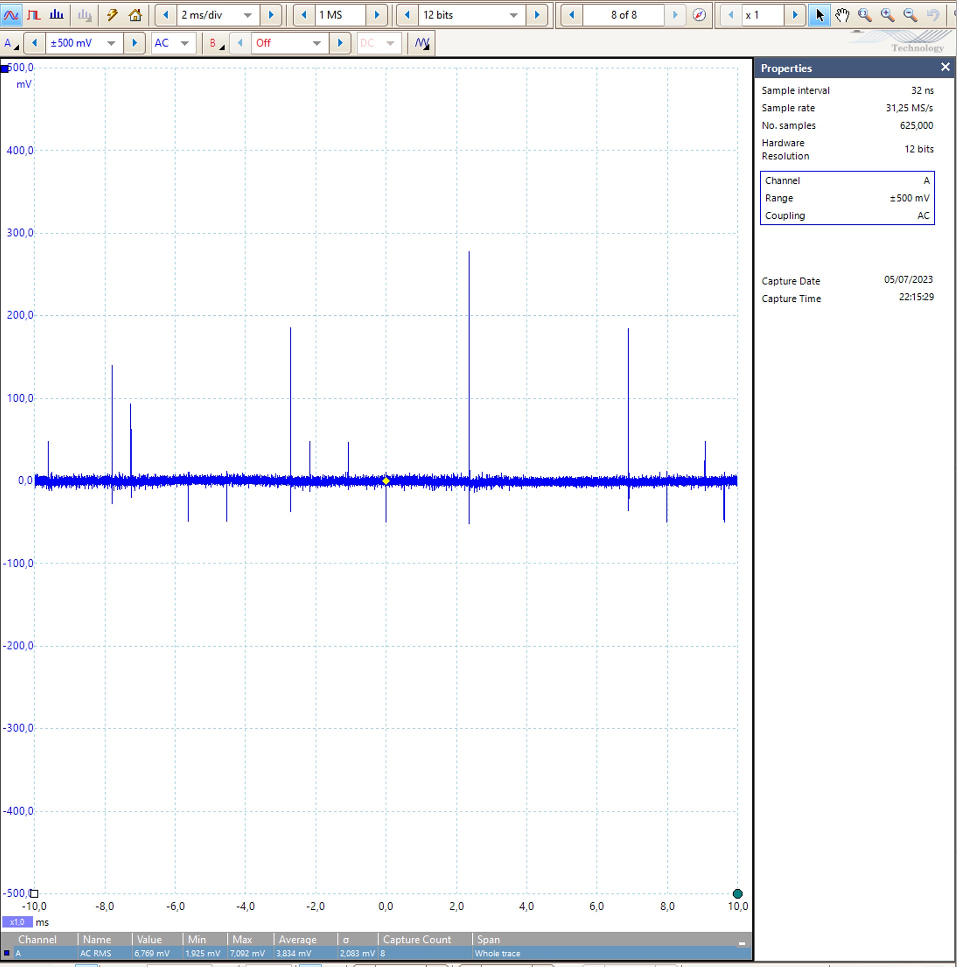

For some reason, the problem did not occur with the repetitive silent patterns, but it did with silence generated by JRiver and with non-repetitive silence generated by my Pascal program.

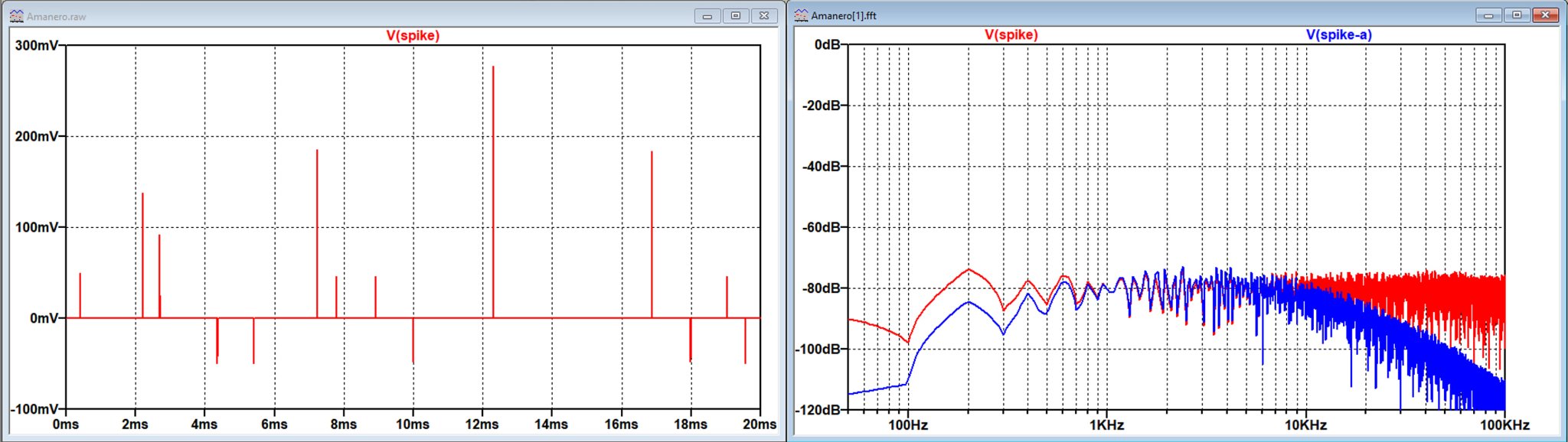

In LTspice I replicated the spike pattern recorded from the one Amanero channel that was giving these anomalies at DSD512, to get some feeling what spectral content this could possibly cause.

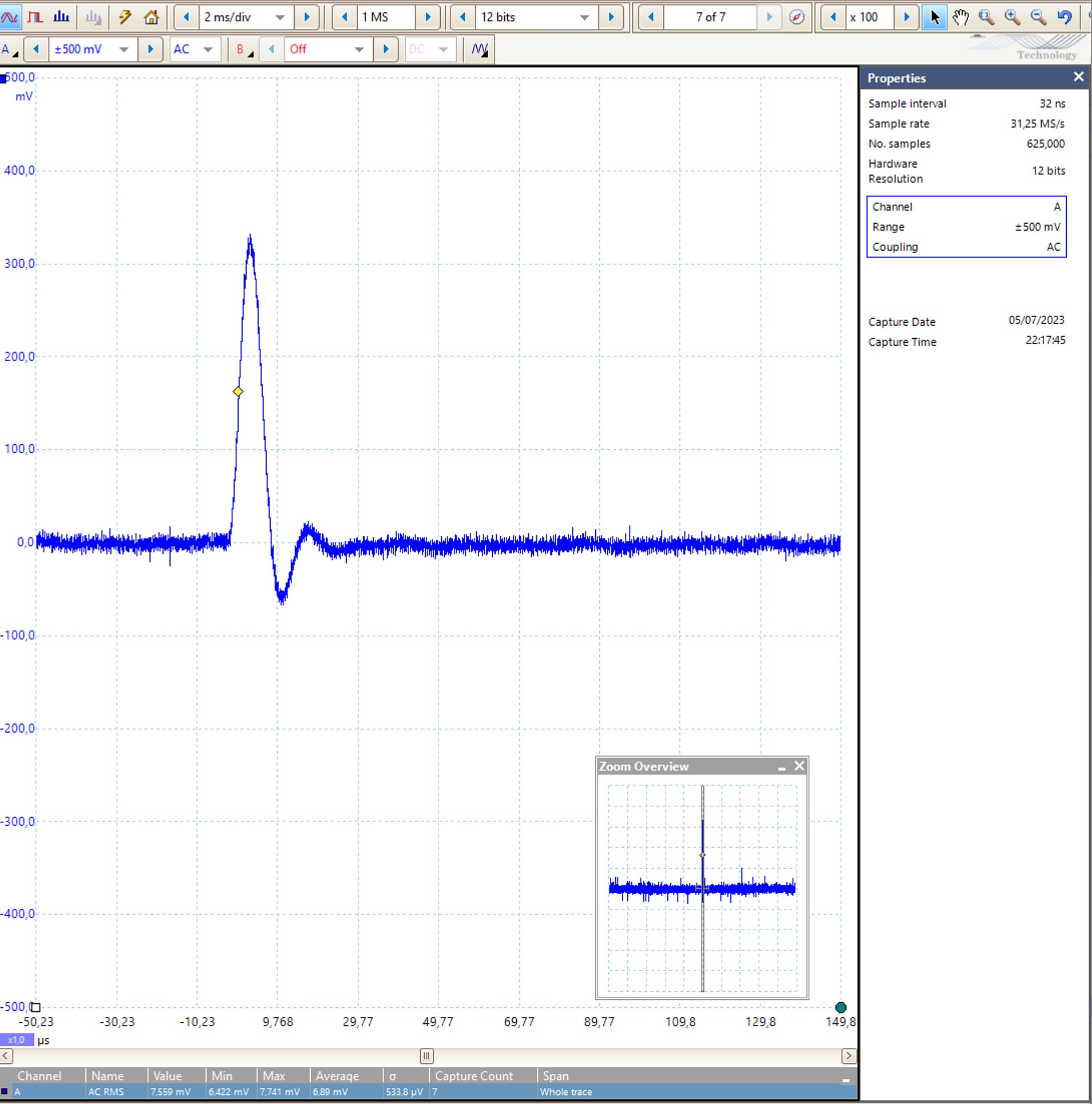

See first image for a 20msec recording from a silent track with unwanted spikes.
Second image is a magnified spike, showing a ca 5usec spike, of almost triangle waveform.
That is wat I replicated in LTspice, see third image.
This third image is also showing the spectral content Unweighted in red and A-Weighted in blue.
I may be completely wrong, but looking at the spectrum I have my doubts whether the effect of these spikes can be noticed while listening at normal audio levels.
In this case measuring is revealing a nasty problem that should not be there in the first place, but I still wonder whether this is a systematic or an exemplary problem that was not discovered before.
So, I'm looking forward to see Mark's discoveries.

You simulate white noise of about -80 dBV per 50 Hz bin, roughly -56 dBV A-weighted, with a very peculiar probability distribution. Why would that be inaudible?
Because of the spiky nature, I would expect it to sound like minor click noise or like a slightly dirty vinyl record. Anyway, we will see.
