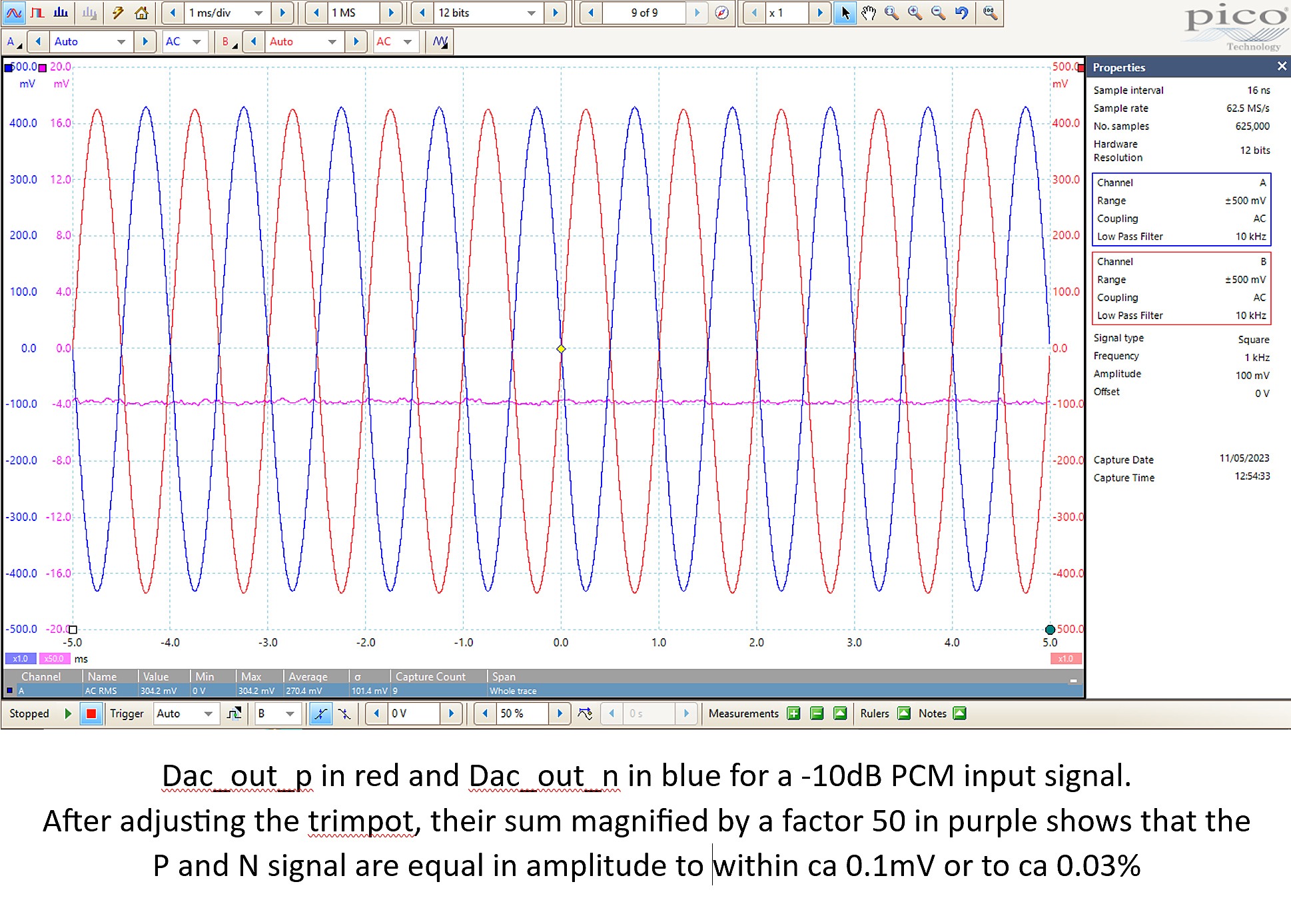

On the logic gate DAC I even mounted a 25 turn trimpot to equalize the gain in both path’s for a super exact tuning.Wasn't that the logic gate DAC?
See image below showing both SE channels and their sum magnified by a factor 50 after having tuned the trimpot, resulting in ca 0.03% equal gain for both path's, just to be sure to get optimal suppression of CM components
On the RTZ Firdac I did the same measurement, but didn't have to go as far as installing trimpots because the results looked good enough for going on with further testing.

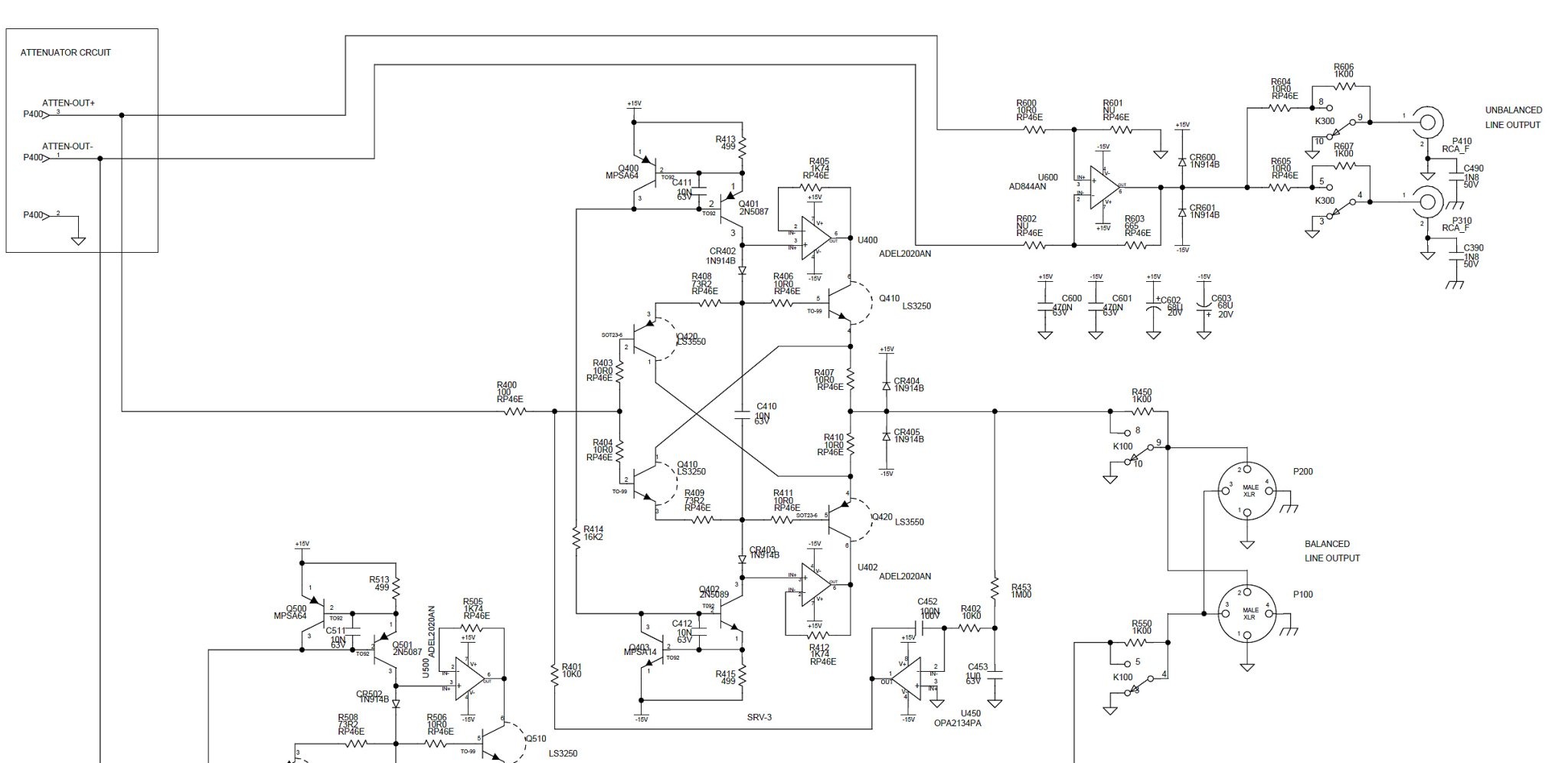

Because differential balanced signals suppress even harmonics, in some cases SE might sound more agreeable.
But there are many balanced outputs that are not differential at all, in those cases all even harmonics and CM components are still there for the full 100%.
And there are SE outputs made from both differential signals that have just as little even harmonics and CM components as the balanced output, see image below.
This is all just on the sending side, similar things can be said on the receiving side even with or without a transformer in between.
In this particular case, no one has to worry about even harmonics, because they are simply absent as my measurements have shown, but because of the aggressive digital environment, CM disruptions are manyfold and can only be suppressed in differential mode.

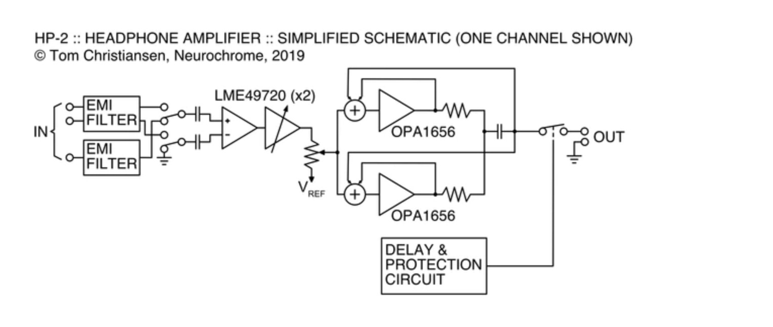

I have used HP-2 to listen in both modes.
