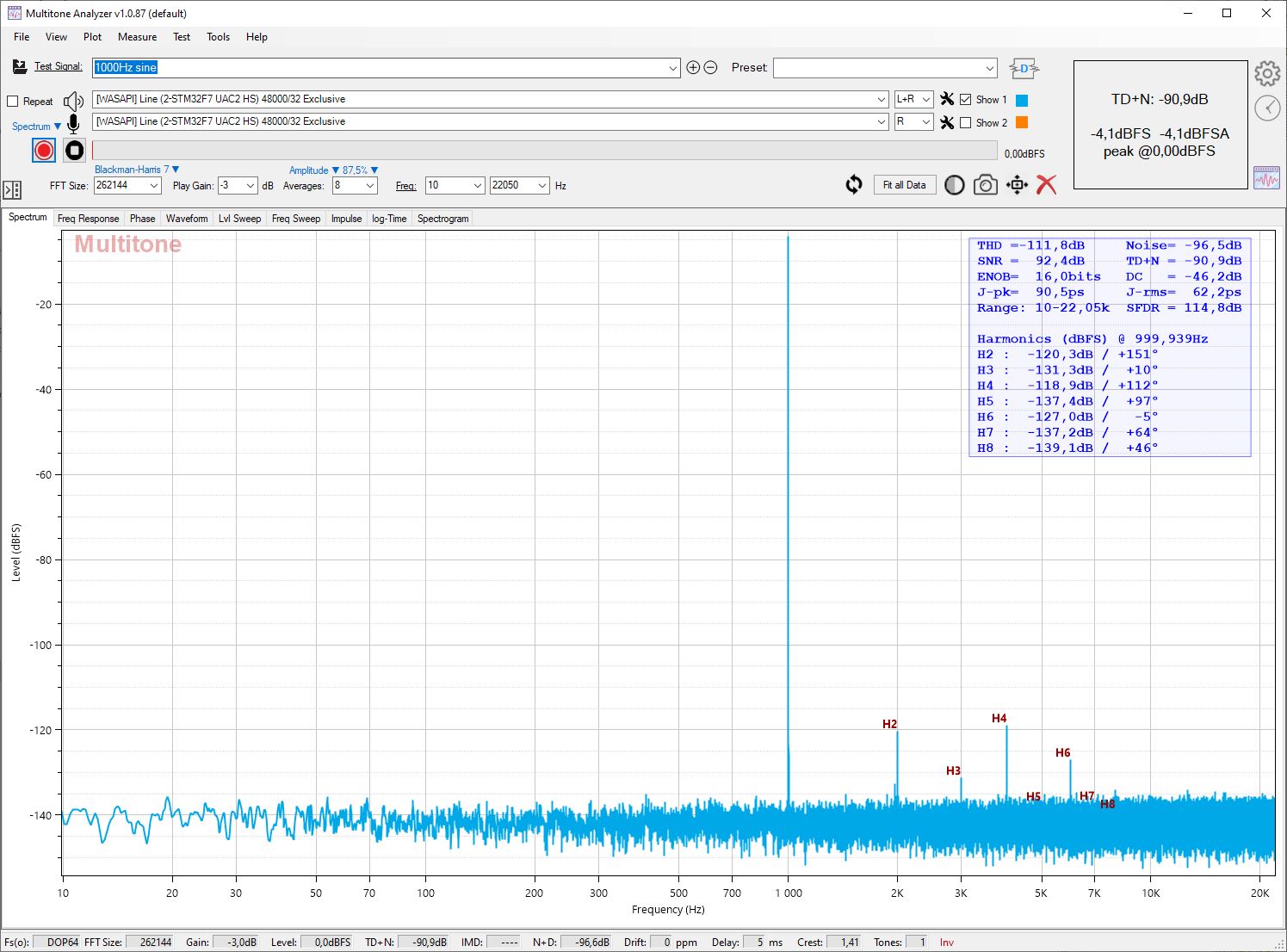

Even though measurements have a really bad rap in this thread I'll go against the tide and present some measurements of RTZ dac.
Have they? You are the third person posting measurements in this thread, after me and Hans. Thanks for posting!

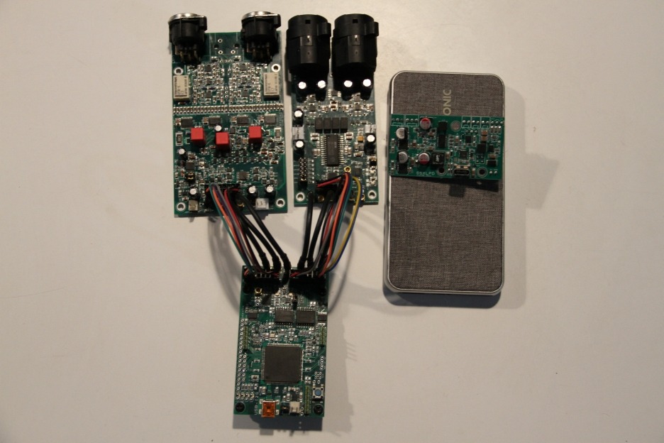

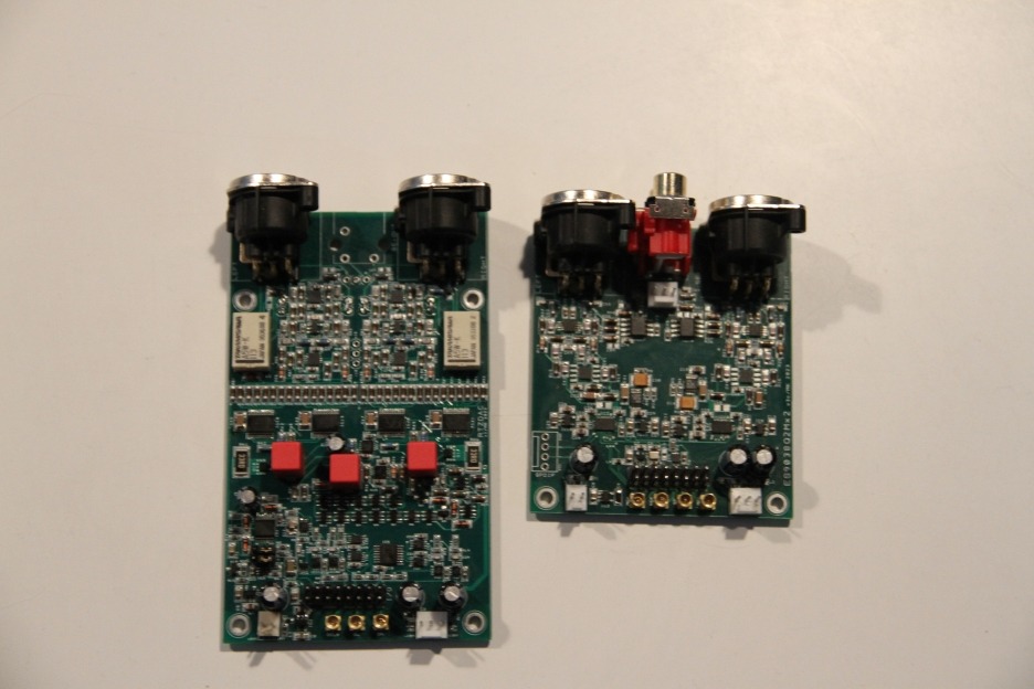

Note that these measurements are not from Marcel's original boards but my rendering of the same dac. Here is a picture of the dac.
It is a single board version (sans the last filter stage). Schematic is the same as original with only small modifications in the mute relay circuit as I used 5V relays. Parts are mostly same but I used smaller IC packages and MELFs in analog circuits. Main reasons for making my own version are the form factor and the connection to the USB-I2S as I wanted to use my own STM32F723 board. I use MMCX for I2S/DSD signals.
Cool, you are the third person designing a variant of the DAC, after Thorp's PCM version and nautibuoy's simplified filter board layout. In fact I hoped people would use it as a starting point to be redesigned as they like, nice to see that that is indeed happening.
Here is another picture of the RTZ dac next to my ES9038Q2M dual dac. Both use same form factor for input and output connectors which makes it easier to swap dacs in chassis.

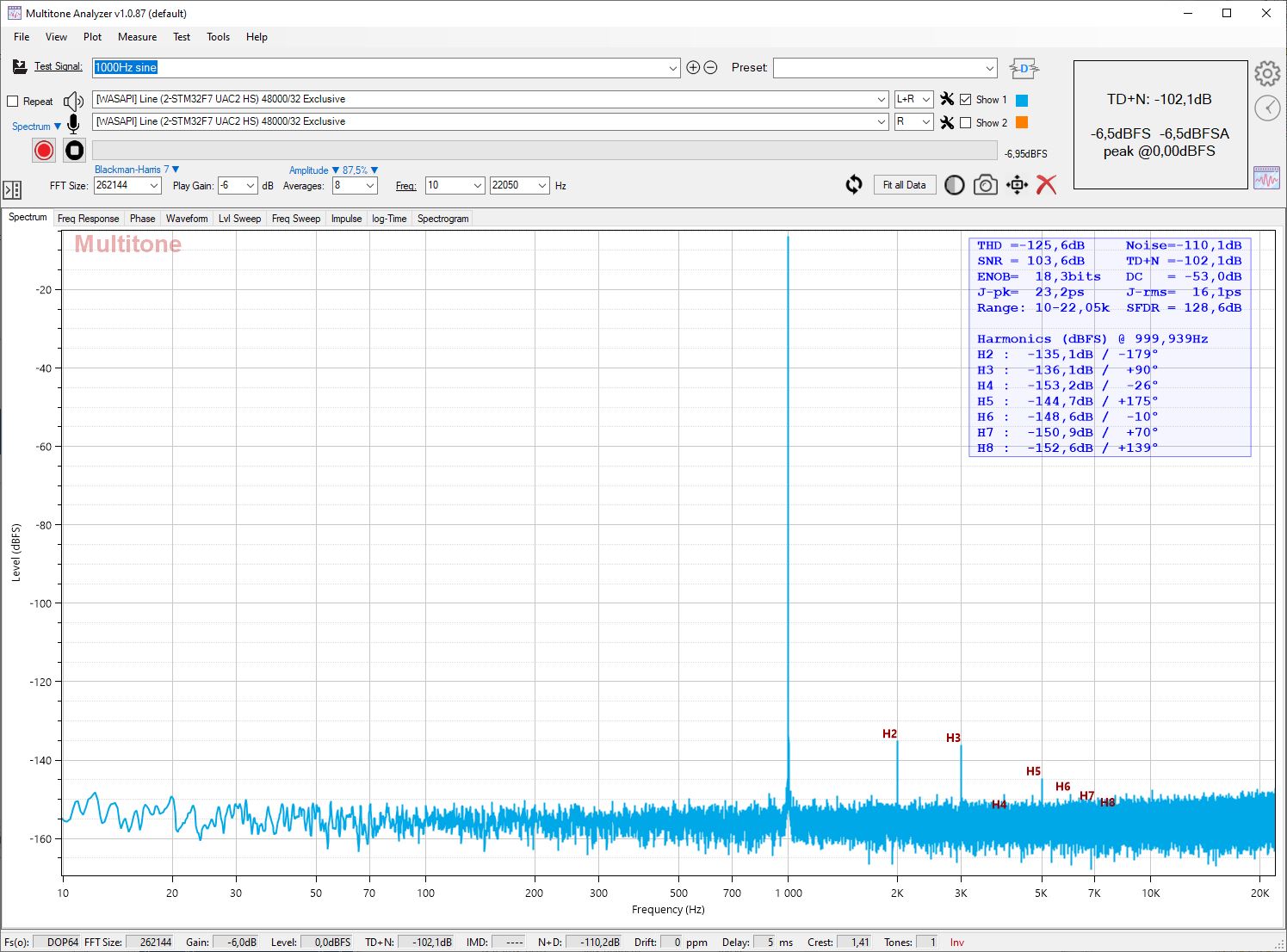

Ok. Then the measurements. I used Multitone Analyzer as it has built in DSD measurement signals. Measurements were made with DoP64.
First 1kHz sine.
Very good. Distortion is low and high order HD is missing. Noisefloor could be better. More on that later.
Just for comparison here is the same measurement with my ES9038Q2M DAC.
It is worth mentioning that with DSD input ES9038Q2M THD is much cleaner than with PCM as all the high order harmonics are below the noisefloor. But noise is a bit higher than with PCM input.

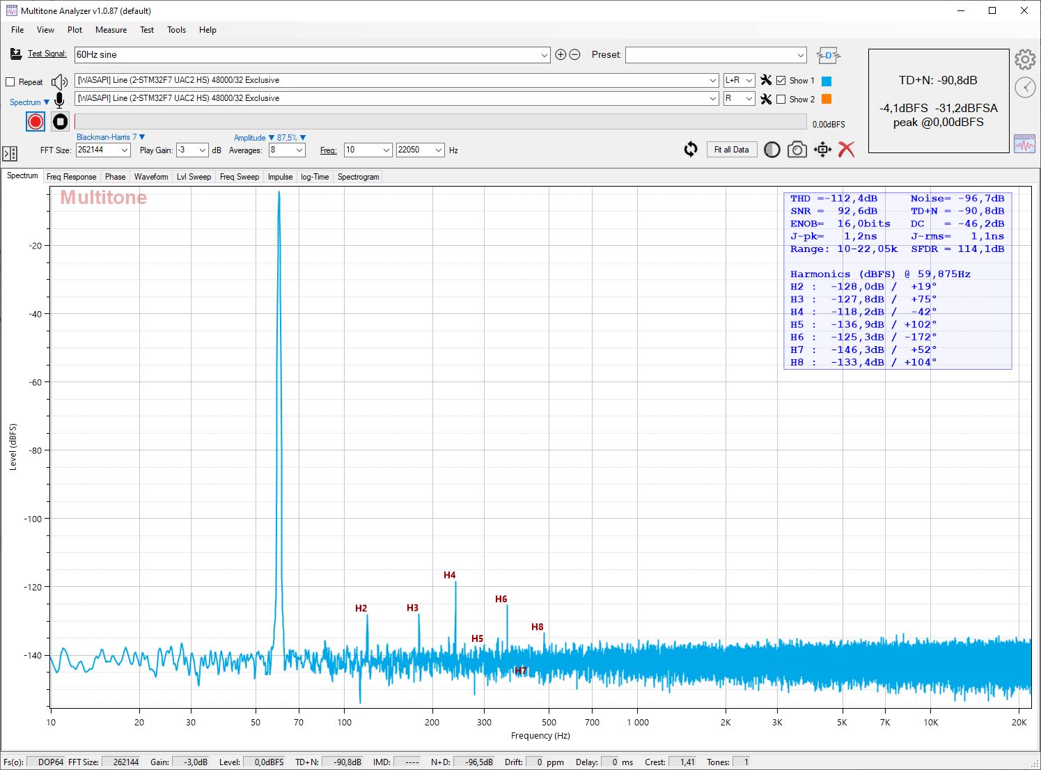

Here is 60Hz sine:
As with 1kHz high order HD is below the noisefloor.

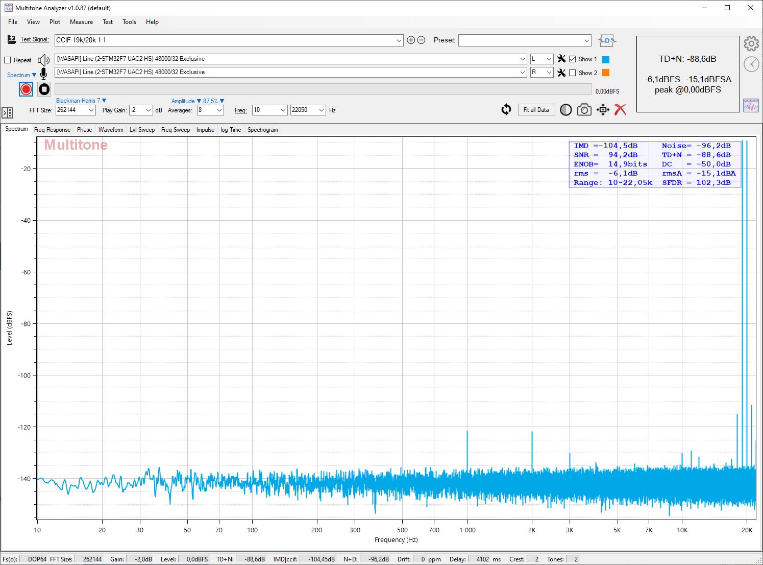

CCIF 19k/20k:
Very good.

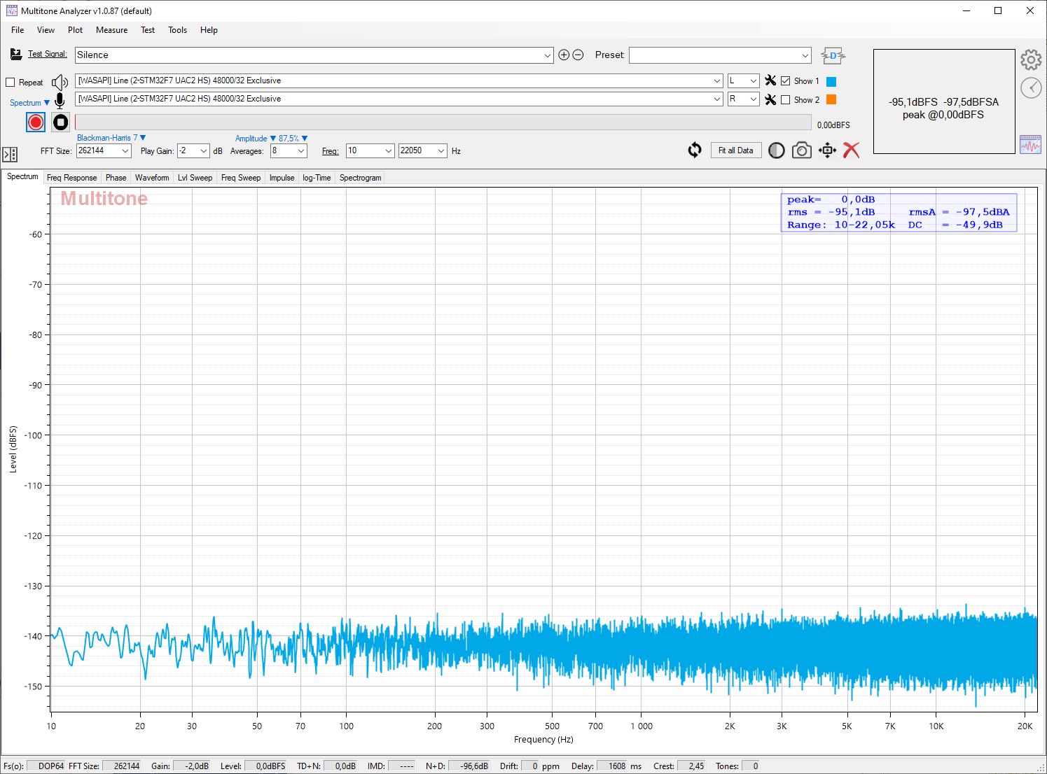

Let's get back to the noise performance.
Here is SNR (i.e. DAC playing silence):
So SNR(A) is -97.5dB. I'm not sure if this can be directly compared to Hans' measurements as I have typically seen slightly worse noise numbers with Multitone Analyzer.
The noise floor is considerably higher than what Hans and I measured. Of course it's a different board layout, but I don't know if that has anything to do with it.

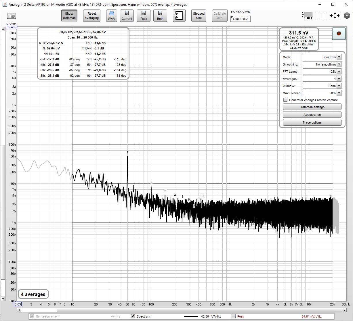

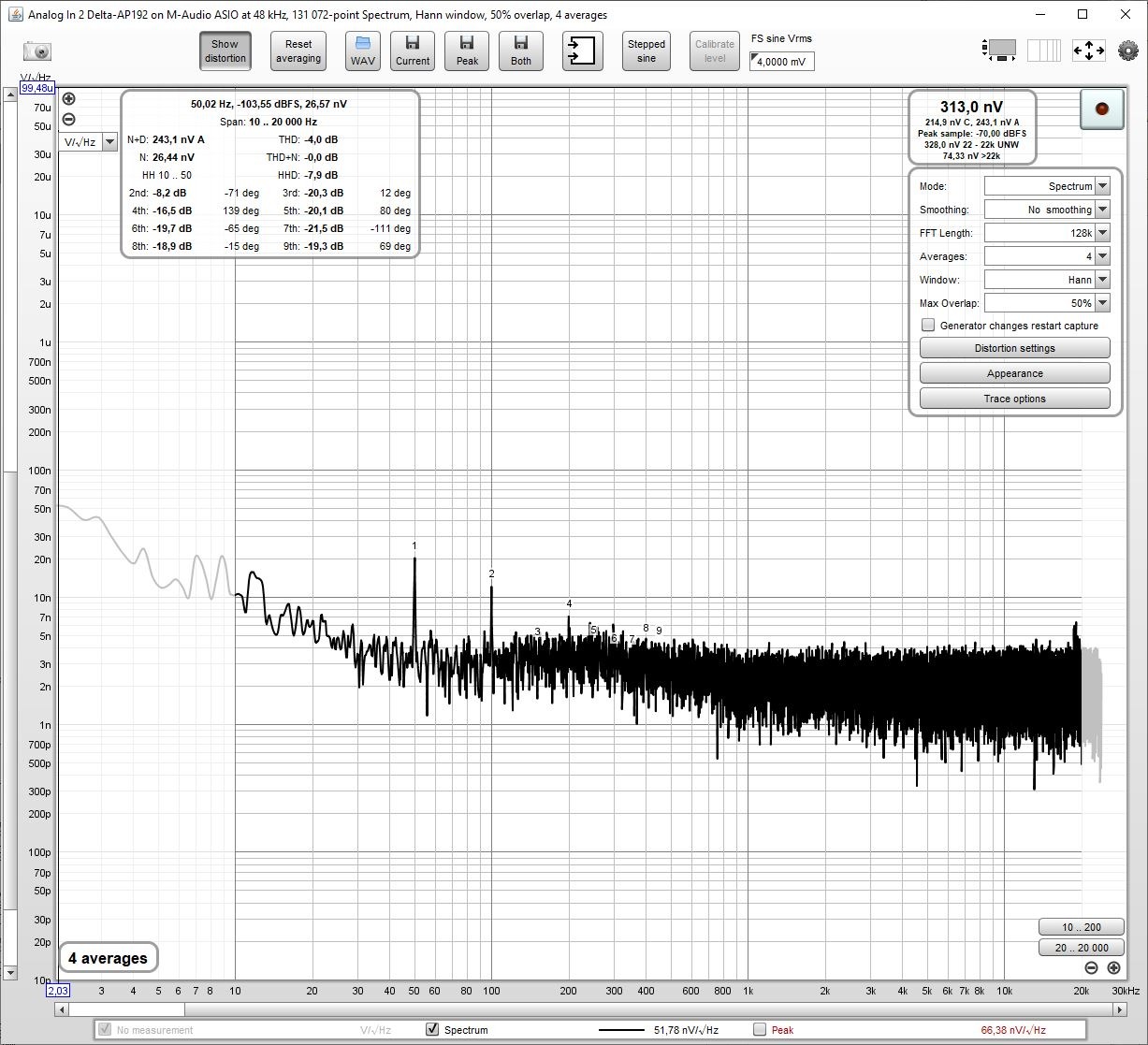

Finally let's delve into the Vref circuit as that is one of the exceptional features of Marcel's DAC.
Here is noise measurement of Vref circuit without any DSD signal. For noise measurements I used my 60dB LNA (Scott Wurcer's circuit).
Bandwidth in this measurement is 10Hz-20kHz. RMS noise (313 nV) is ultra low but a slight disappointment as that is more or less the same as I normally get with LT3042/45/94. Just as an example here is a noise measurement of the 15V that was used to power the Vref circuit in the previous measurement. This uses LT3045.
Since Marcel's Vref is much more complicated and uses lots of PCB real estate I don't really see it as in improvement over LT3042.
I'm sure the LT3042 is at least as complicated, but it's all hidden away in a small black package. A hard to hand solder small black package: small pitch and exposed die pad.

No. I use MMCX connectors but that has nothing to do with the noise floor as you can see from my measurement of ES9038Q2M which also uses MMCX.Regarding low hanging fruit: use the U.FL connectors and don't place the 0 ohm resistors that connect the data and bit clock pins of the Amanero-compatible header. Then again, bohrok2610 uses U.FL, as far as I can see, and has the worst noise floor...
These noisefloor measurements are not directly comparable as the used test signals or the measurement setups were not the same. The higher noisefloor in my measurement has nothing to do with USB-I2S board as the same board with ES9038Q2M results in almost 15dB lower noise.Overview of the measured noise floors:
-97.5 dB(A) for DSD64, bohrok2610, different board design, DAC + DIY STM32F723 board
-105.3 dB(A) for DSD128, Hans Polak, DAC + Amanero
-103.3 dB(A) for DSD256, Hans Polak, DAC + Amanero
-95.7 dB(A) for DSD512, Hans Polak, DAC + Amanero
-100.8 dB(A) for DSD512 with my PWM8 algorithm, Hans Polak, DAC + Amanero
-104.6 dB(A) at 27 Mbit/s PWM8, MarcelvdG, DAC + FPGA board and some other logic from an earlier DAC

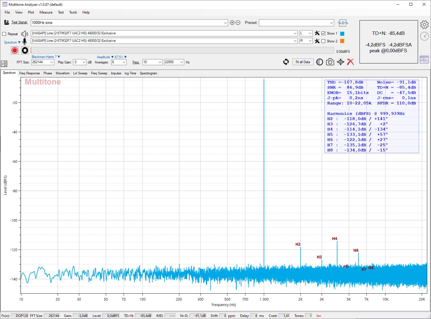

Here are 1kHz measurements at DoP128. Measurement setup is the same. My USB-I2S board can do DSD256 but only in Linux as I have not implemented an ASIO driver. DoP256 would require higher clocks on my board.I notice you say that all measurements were at DoP64. Any chance you made some measurements at DSD128 or higher? Could be interesting to see if the RTZ DAC performs equally well at different sample rates (to my memory Hans Polak in his review did not mention which sample rate(s) his measurements were made at ..?) ...
RTZ 1kHz DoP128:
Strangely noise is 5dB worse. I'll need to study this further to see if something is amiss on my RTZ board.
To rule out the measurements signal or UBS-I2S I also measured ES9038Q2M with DoP128 as reference.
In this case noise is almost 3dB lower with DoP128. So nothing wrong with measurement signal or USB-I2S.
