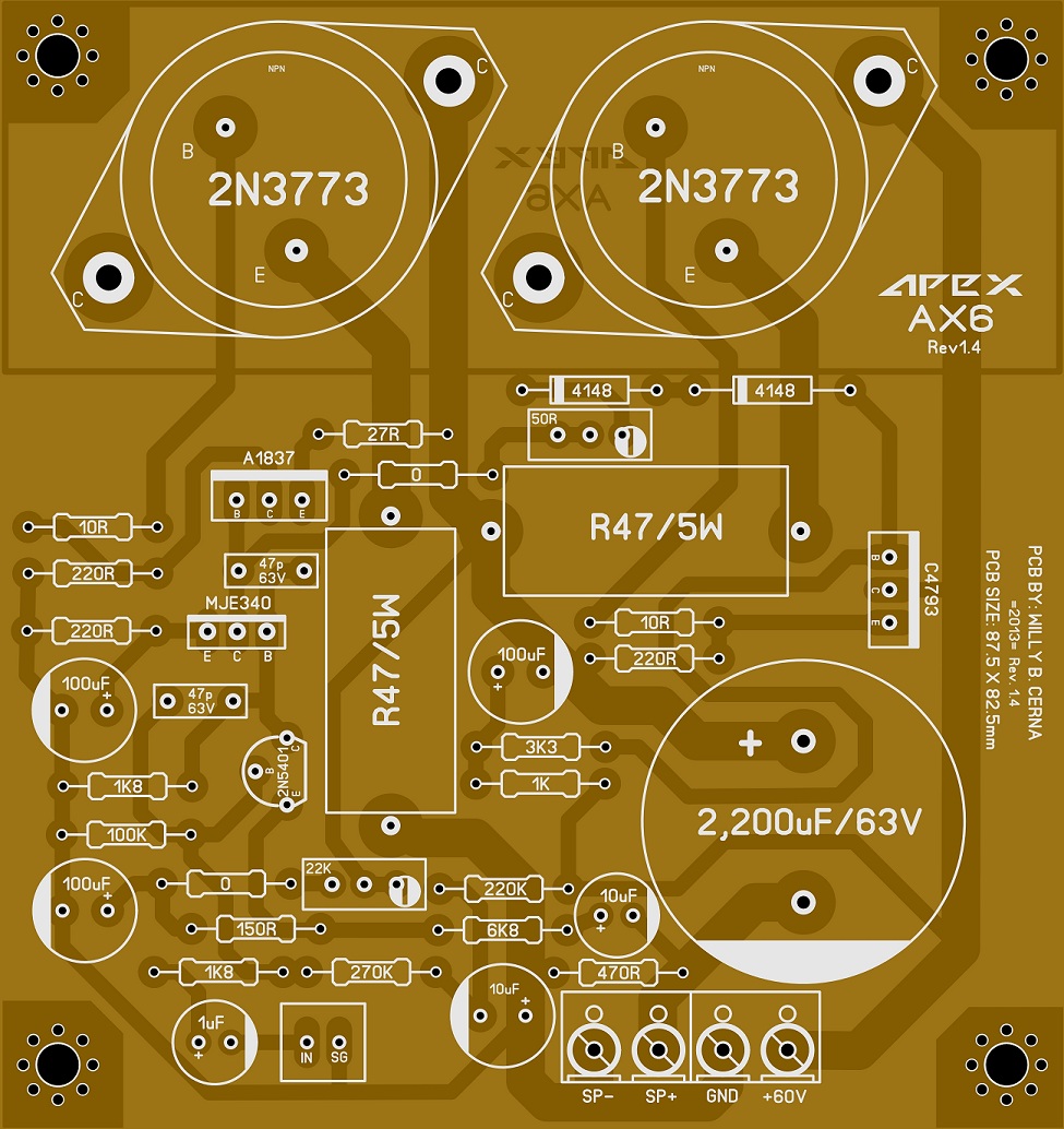

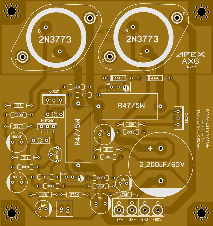

Which one you preferred?
Nice work, I suggest 22k pot instead 12k resistor for simetry adjust not 470k pot.
Regards
Regards
Ok... you mean like this?
This is ok, but I don't want use trim pots.
Ok so you want me to remove the 22K pot or let's keep it as an optional for some diy freinds?
Let's keep it as an optional for some diy freinds 🙂
Cool! Will post the files shortly.....

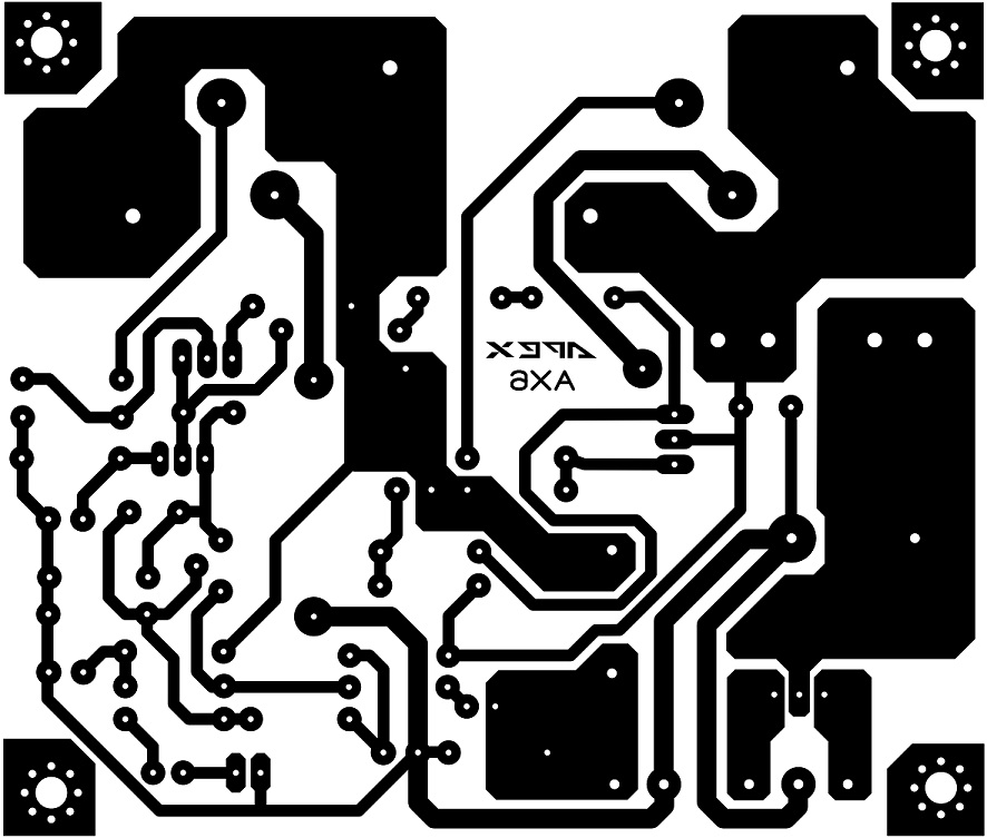

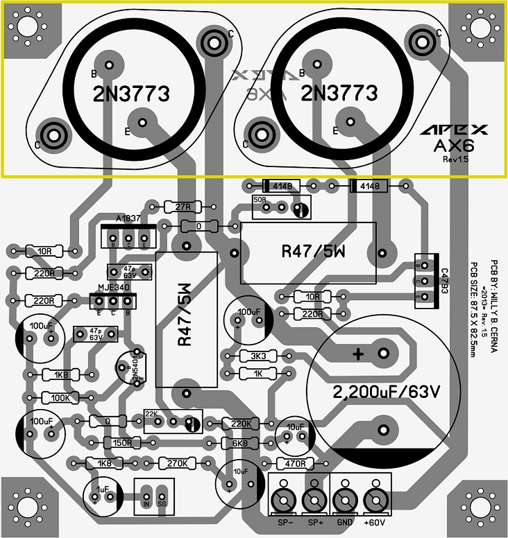

Here's the file for APEX AX-6 Rev. 1.4.

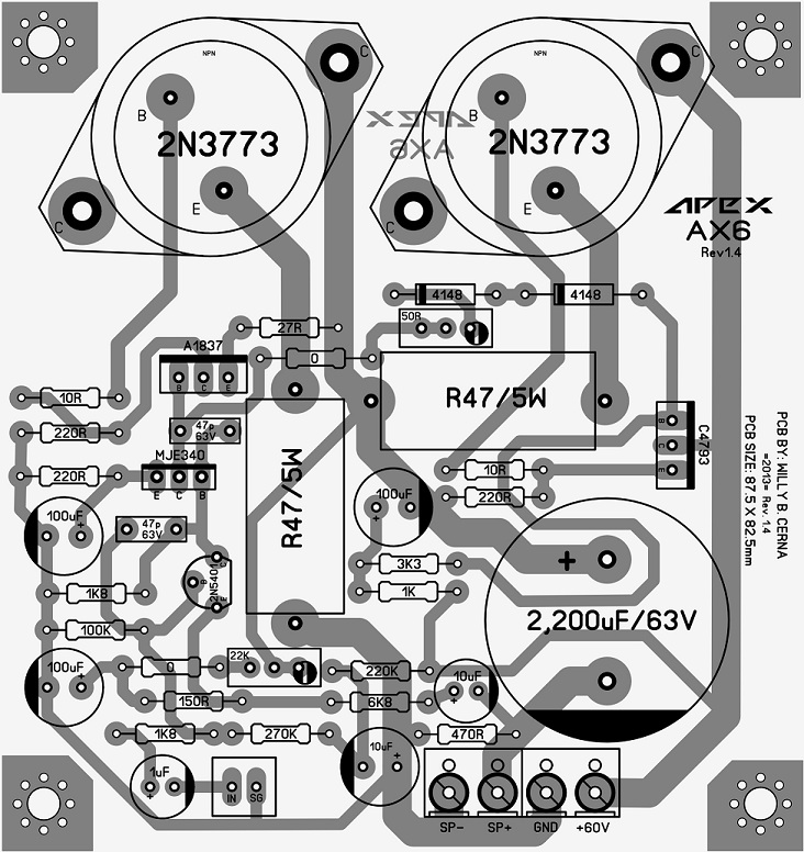

thanks Willy, bourns trimpots are tops and allows for output symmetry and bias adjustments, i would use no other types...

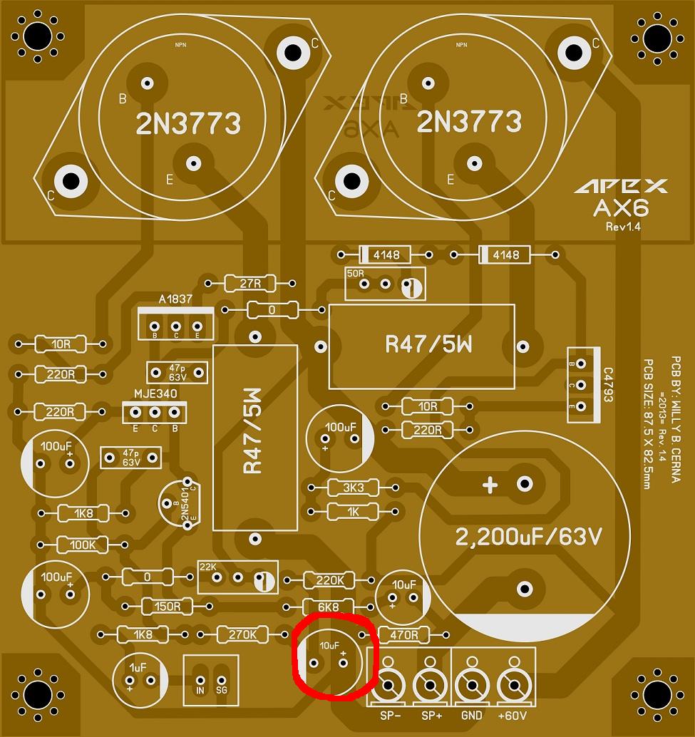

Willy 10uF polarity reverted.
Good catch Mr. Mile Thank you... will correct that shortly.
Ok here's the corrected one....
Bias 20-50mA can't be set with 50R pot, you need 220R pot to set 120-150R for proper bias current.
^what i have in mind is more bias than that...😎
It's a minimum value to remove crossover distortions, use more if you have large heatsinks 🙂
What is the recommended trafo that i would need to use, with 2N3055? (srednja skola i nije mi neki budzet 😀)
2x36vac 75VA for mono 150VA for stereo.

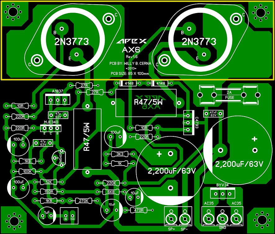

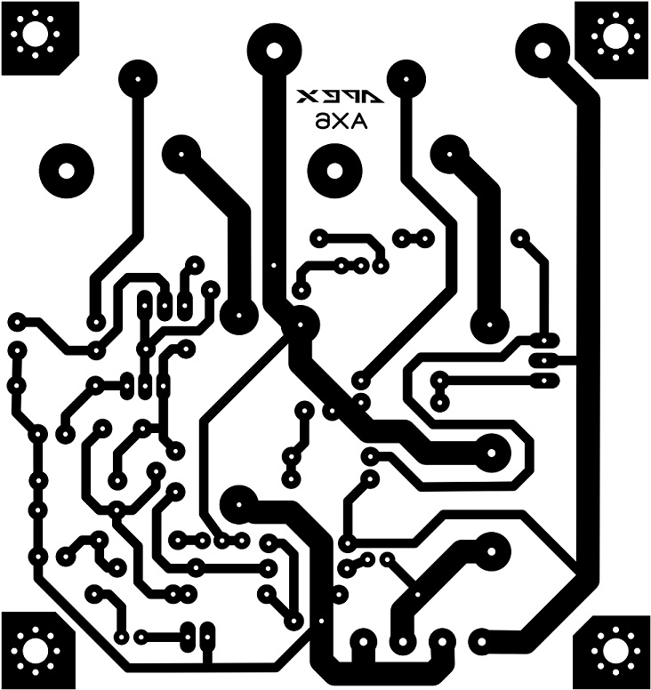

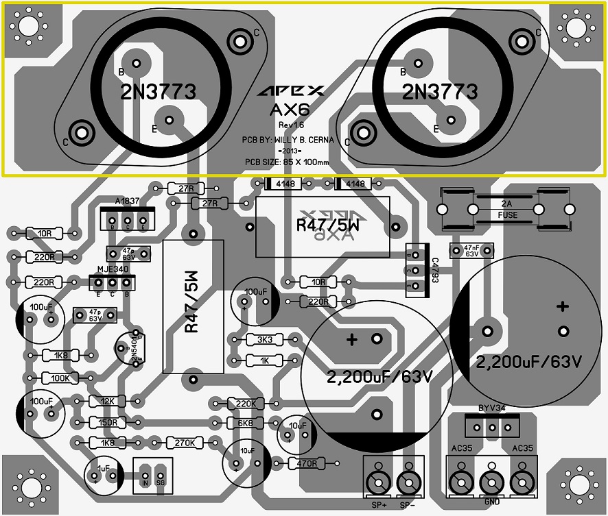

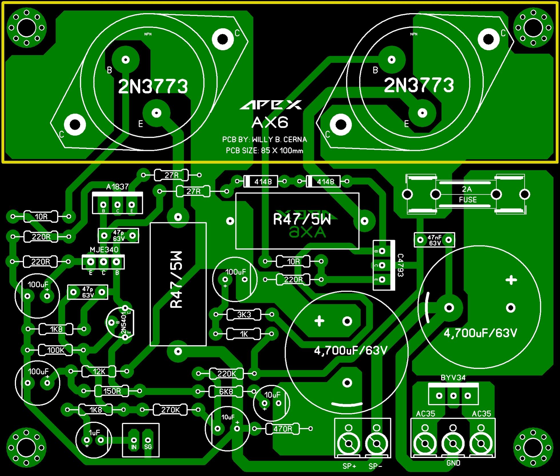

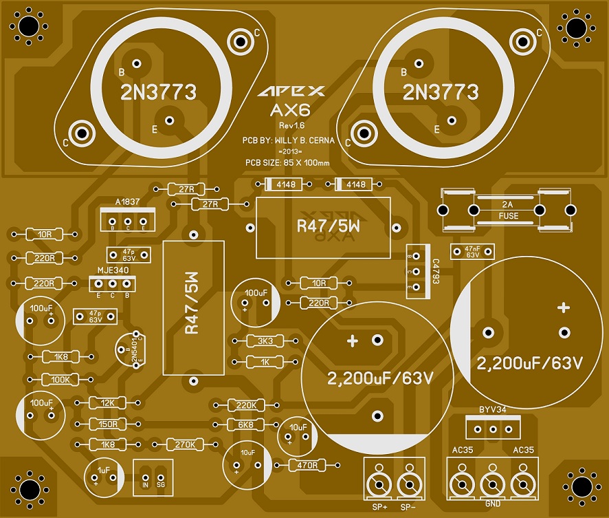

Willy please correct 10uF polarity on this pcb also 25mm diametar caps will be nice 🙂
Ok here's the corrected 10uF polarity ver.1.6 using 25mm caps.
