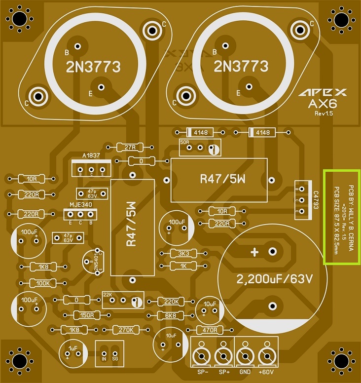

There you go...
https://www.dropbox.com/s/keav10qzief0m4l/Board_TO246.png
and PCB
https://www.dropbox.com/s/plh3ma156q8g0ug/AX6%20rev_1_6_TO246_PCB_PRINT.pdf

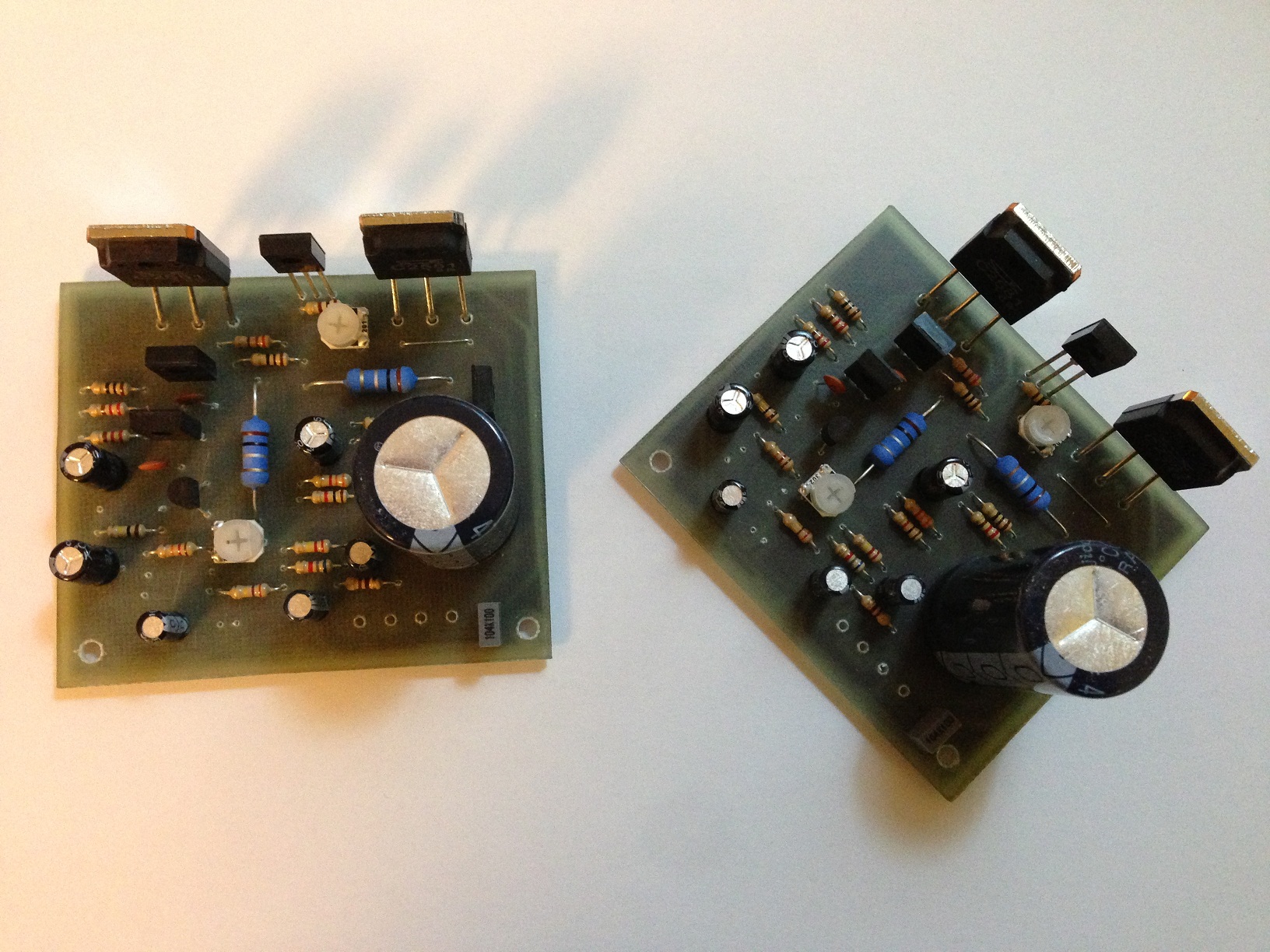

a little more before starting. 🙂
Here's the file for APEX AX-6 Rev. 1.4.
dear wiljj,
plz mention dimension too.thanking u.
dear wiljj,
Hello masood,
Re.1.4 have reverted cap polarity please refer to Rev.1.5 and i hope you can see the pcb size with mark in green.
Ok here's the corrected 10uF polarity ver.1.6 using 25mm caps.

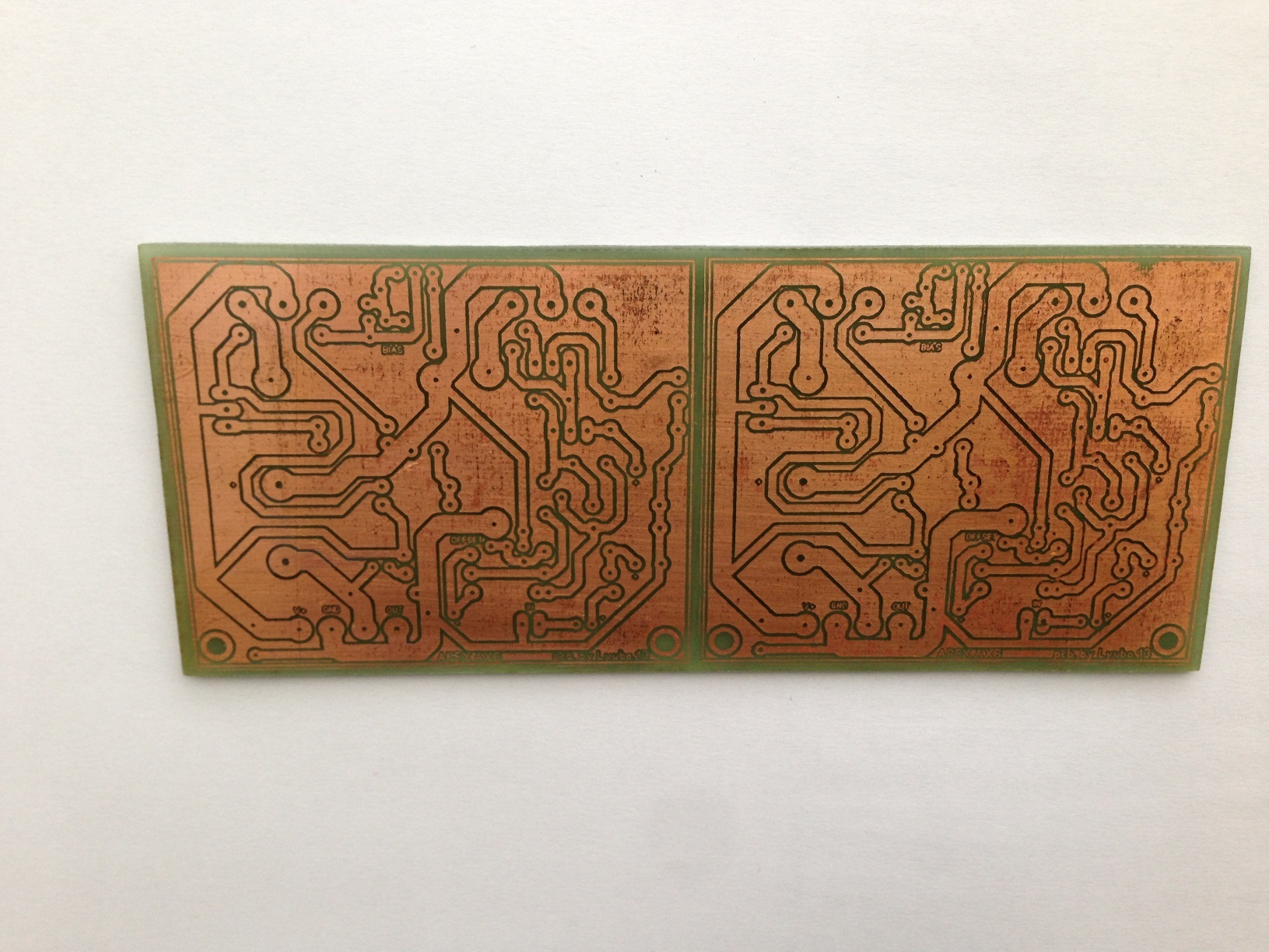

dear wilji
this pcb is for toner transfer method?thanks
plz send me all ur pcb for toner transfer because i can;t make screen.thanks

Hello masood,

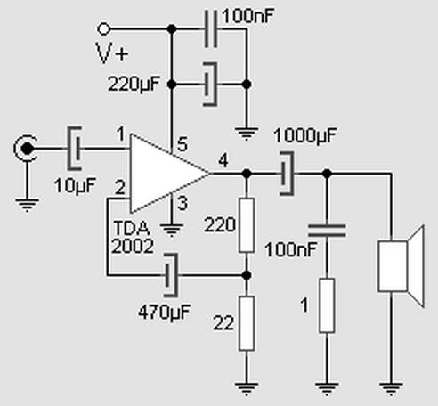

Can this run at 12v??
This amp run at 35V minimum, I suggest to use TDA2002 for amp run at 12V.
