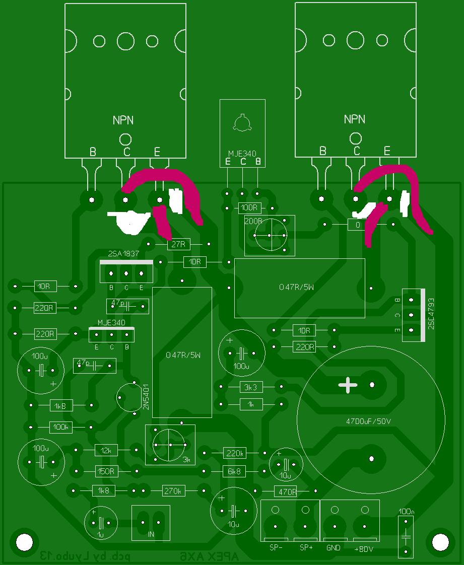

Hi All,
Here is my pcb version on AX6 amplifier circuit with TO246 package power transistors.
https://www.dropbox.com/s/kz2m72offvtio1g/Board_TO246.GIF
PCB for print
https://www.dropbox.com/s/plh3ma156q8g0ug/AX6%20rev_1_6_TO246_PCB_PRINT.pdf
Schematic and Simulation
https://www.dropbox.com/s/f4c109ep479b6aw/sch1.png
https://www.dropbox.com/s/suvoupxhxv0yqtf/sch2.png
https://www.dropbox.com/s/szavhehgng9uhxh/sch3.png
The trimmers on bias and offset are these - https://www.dropbox.com/s/fk05m8ruosaaq9w/SH655MCL _trimers.pdf or Bourns
BR,
Lyubo

Your outputs wrong connect, some pins reverted.

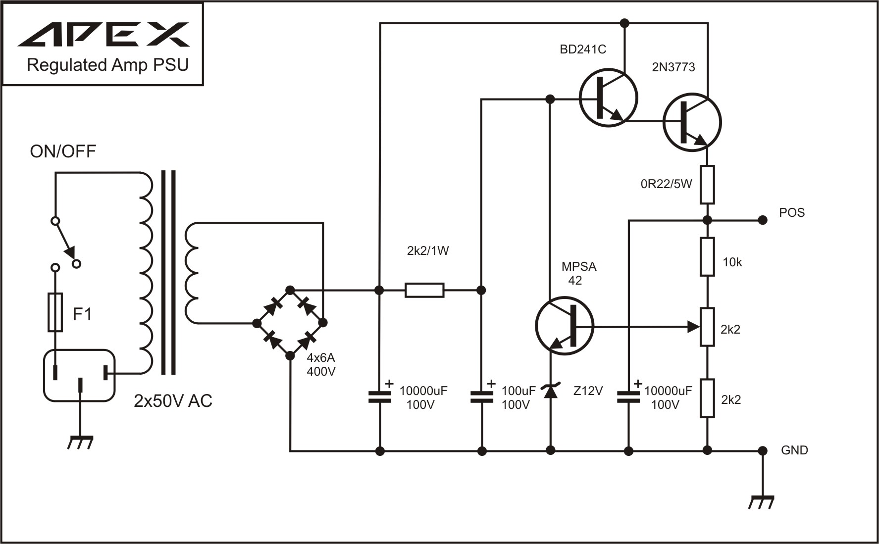

here is another question for APEX
Do you find any use to run this amp from a regulated power supply ?

Yes I was thinking to use a capacitive multiplier
Regards

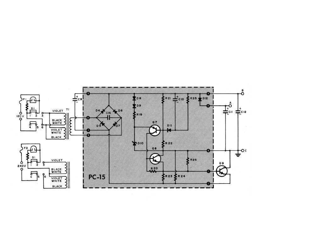

This might work nicely as a power supply for the amp:
Power Supply Replacement
The page includes assembly manual and schematics.

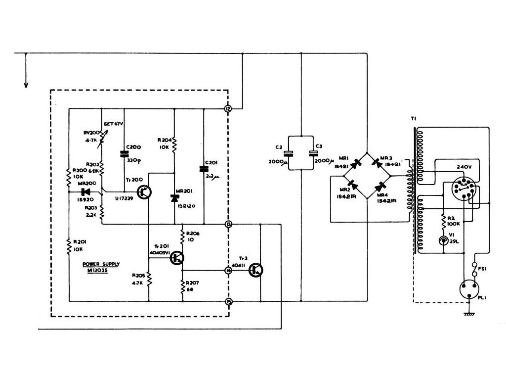

Close to the Quad 303 power supply.
QUAD 303 PSU and DYNACO ST120 PSU
I think both designs may share a common ancestor...the Dynaco Stereo 120 power supply design. Does anyone know when the Quad 303 first went into production?

The AX6 with the improvements, an idle bias current setting potentiometer, and a center level symmetry improving potentiometer, is beginning to be useful.
I own an original dynaco ST120. With an original 5 digit RCA TO3 transistor on the PC14 (power supply regulator PWB), it will actually collapse the upper rail voltage if the current out gets above 6.25 Amps (as designed). It collapses the voltage at about 2.5 A with an NTE60 transistor, which has higher gain. All this is fine at a stable temperature, which I encourage with two PCAT fans blowing on the amp- 17 hours a day in most cases. Mine doesn't regulate at 72v, running more like 80 all the time. I don't hear hum, with a shorted input, so I don't worry about the regulation. My speakers are 101 db @ 1W ! m, fairly sensitive.
1967 per Wikipedia.
using the same source, e.g. Wikipedia, the Stereo 120 dates from 1966...
Quite possible that they used an example from the RCA manual, or from a Wireless World article. Lots of ideas were shared via WW back then. Have a look at Peter Walker's Current Dumping amp article, which became the QUAD 405, then later the remarkably similar Stasis amps.
Yes sir, sorry for the confusion. Here is the corrected version.Your outputs wrong connect, some pins reverted.
Board

No, it's wrong again.
Regards
Sorry, could you please show me where is the mistake now?
Pins reverted

There you go...
https://www.dropbox.com/s/keav10qzief0m4l/Board_TO246.png
and PCB
This must be a final version 😛
Lyubo
