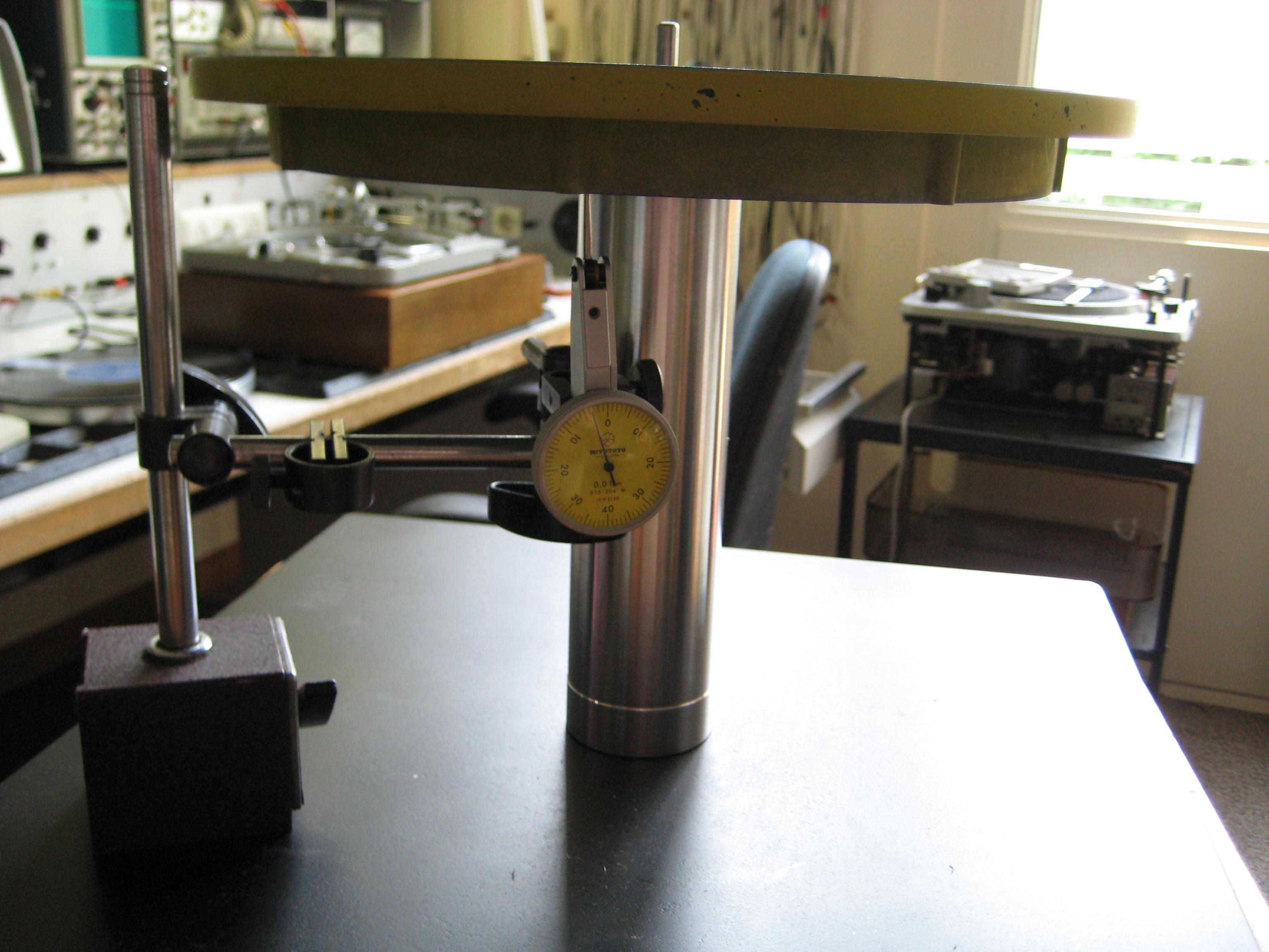

Platter centering TD124
The centering from the mainplatter on the bearing shaft is very critical for the speed and wow component.
On the picture you can see the jig I made for it kind of copy from the original jig from Thorens as you can see in the Thorens TD124 book.
Two speed measurements before and after tell a lot max. runout is about 0,03 mm.

Cool set up. I would expect this to provide very similar repeatability to the factory set up.
Can you provide a relatively simple treatise on your rumble measurement method, what you use and how you set up to do these rumble measurements? I've always been particularly confused by the X axis span of 2.8kHz - 3kHz - I assume this is done by playing a test recording with a tone at 3kHz? And you are looking at the intermodulation products between that tone and the rumble frequencies presumably if I interpret this correctly?
I'm somewhat familiar with the Thorens rumble-coupler set up which does not use a test disk.
Neither result (-40dB rumble sidebands) looks that good, but I don't know what the level of that tone is relative to normal recorded velocities either. The TD-124 is not regarded as having stellar rumble performance by more recent standards, but I have to admit that I don't hear significant levels of rumble from my TD-124/II and would expect it to be very similar to your measurement. Quite a few of my records have significantly higher cutter induced rumble than my table as evidenced by my quietest recordings.
One of these days I will get set up to do some measurements - that will only happen once I actually finish the project. I'm still waiting on the plinth, and arm. Plenty of tweaking will probably follow, and then perhaps a baseline measurement against which to make improvements if possible..
