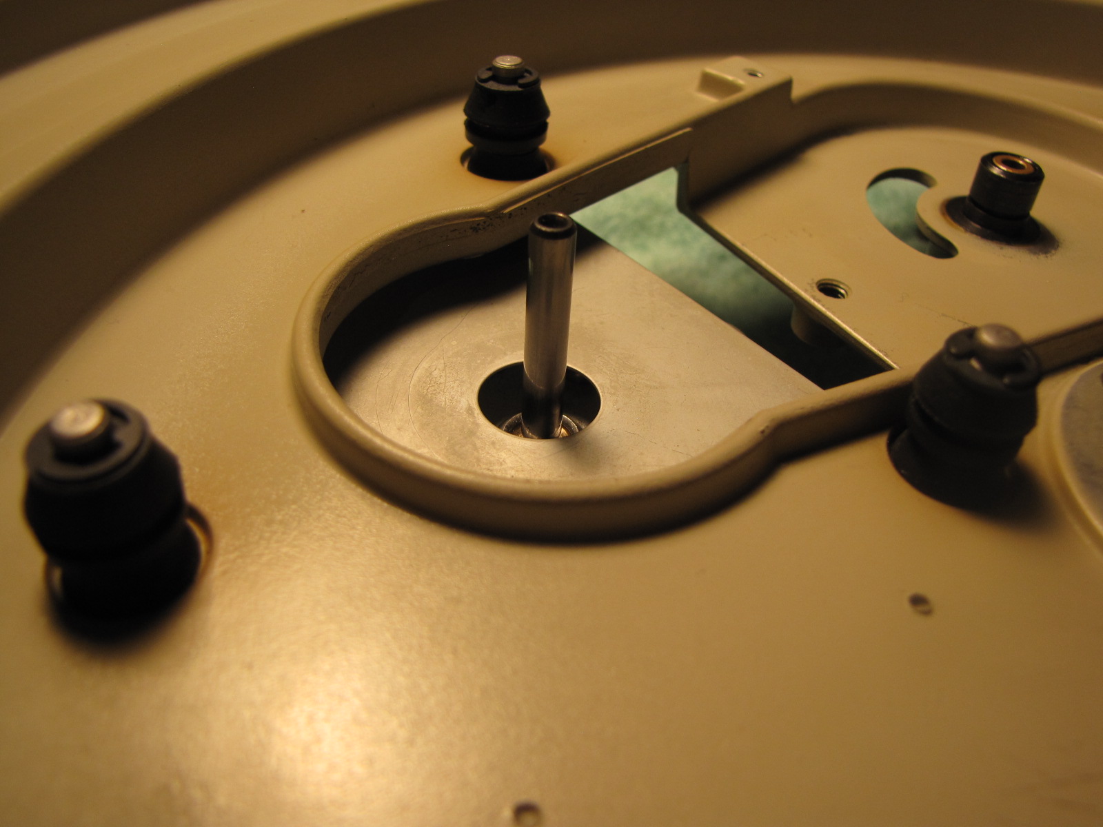

These? There should be three.
http://www.schopper.ch/uploads/images/Thorens/Kits und Belts/TD_4005_a.JPG

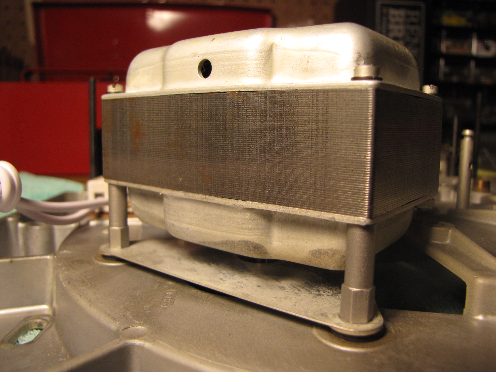

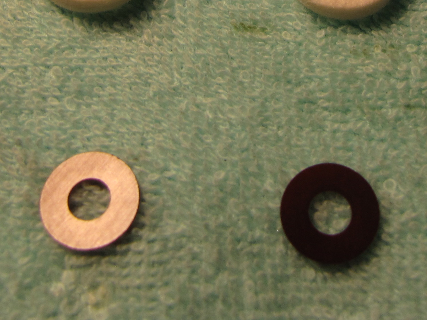

I'm in the process of rebuilding the motor now, but guess what?
I made the stupid mistake of NOT taking any pictures while disassembling, thinking I'd rely on web pics.... 🙁
Now I have two extra washers that I can't figure where they're going... they're the red-brown bakelites in the bottom of the picture. (sorry, I can't upload pictures yet I guess, not enough posts???)
I can't see them in the pics of this rebuild either: ƒg�[ƒŒƒ“ƒX THORENS model TD 124
Does anyone have any ideas? Thanks in advance.
Should be able to upload - your picture may just be too large. Please try to post a picture as I have rebuilt 4 of these motors and might know when I see them. Most motors have two lock washers on the nuts on the screws that are not attached to the standoffs. Some very early motors might have had fiber washers instead?
Nope, not those... those seem to be for the motor suspension, and I have those secured in a ziploc, and also have a new improved (mkII) suspension waiting to be installed.
You were right... pic was too big. I hope this will do!
Like I said, they're brown-reddish, kind of Bakelite, maybe fiber like you suggested.
Check if these fit the motor shaft, I've seen at least one early motor that had a washer or two on top of the rotor. (Internally, but never on the bottom!)

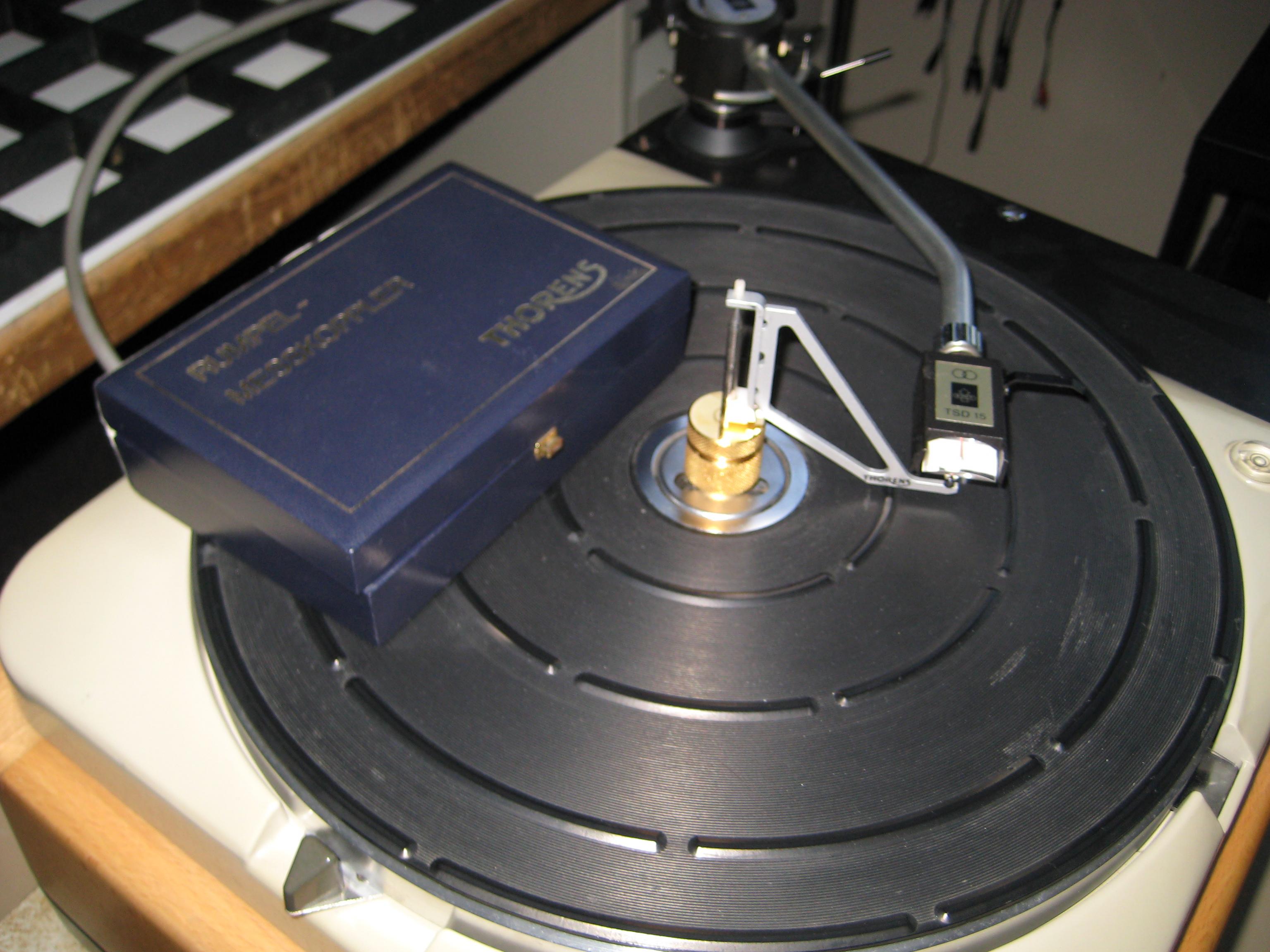

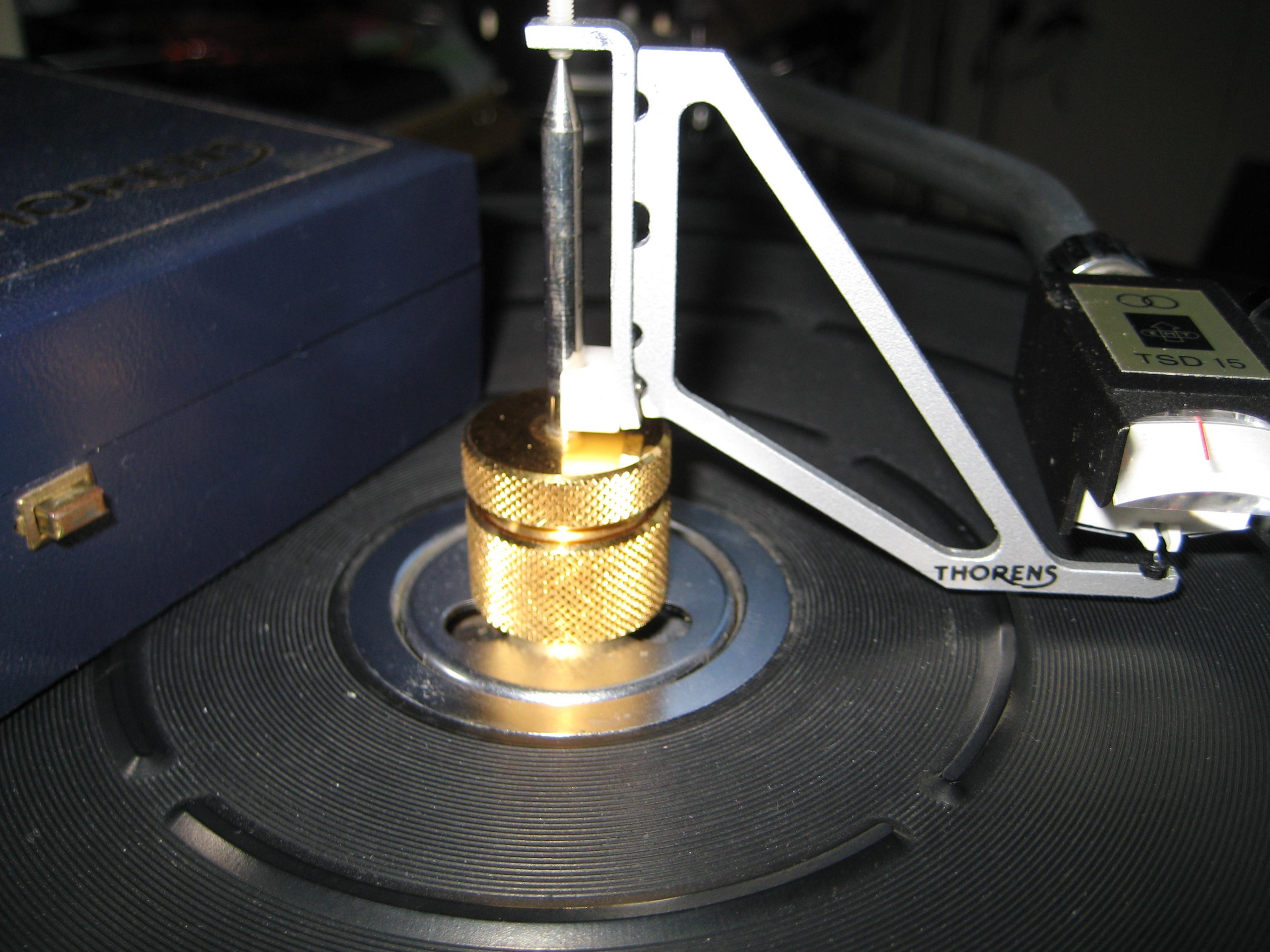

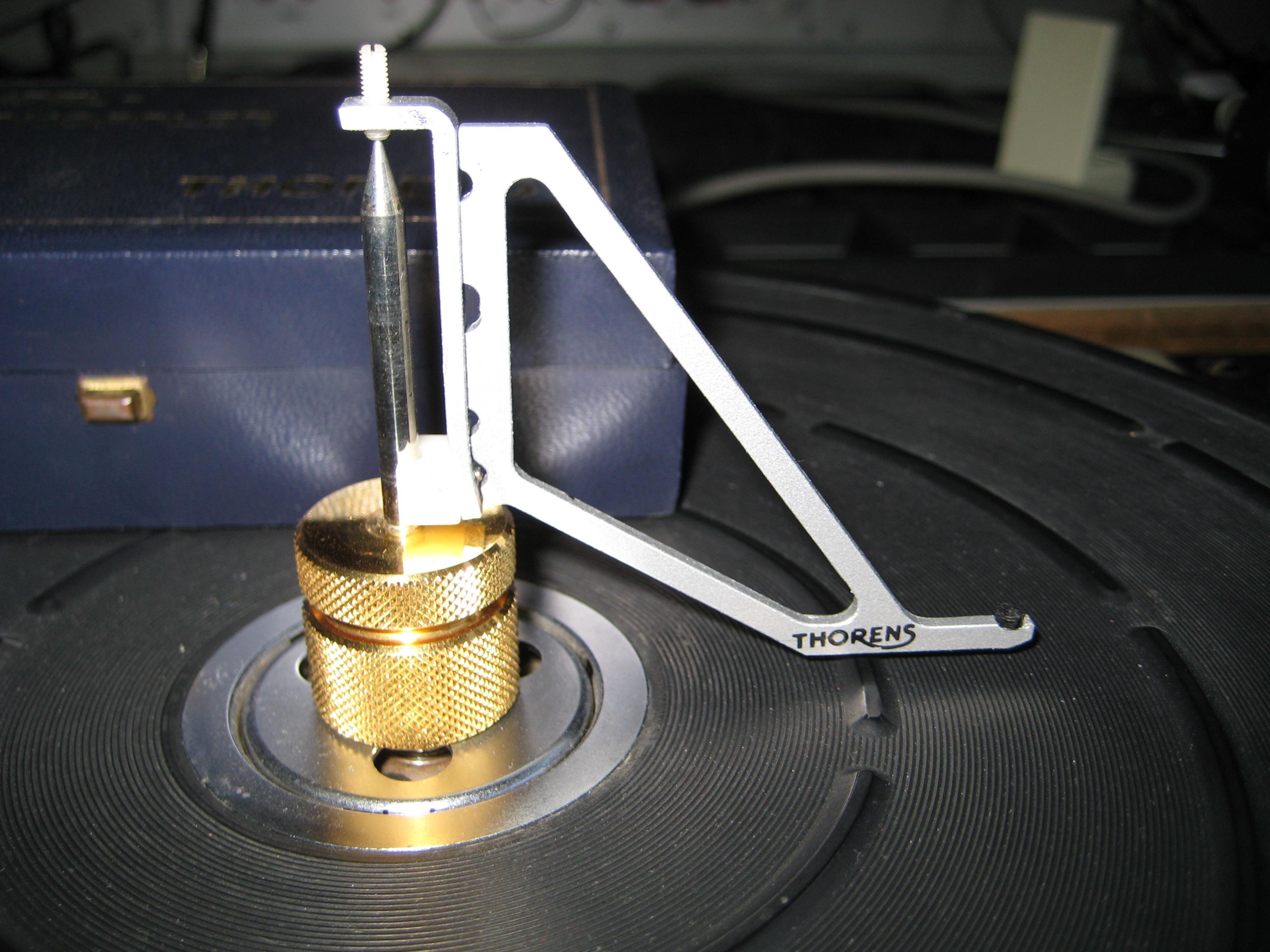

Thorens Rumpel Messkoppler
Gene here are some pictures from the messkoppler we bought this when Thorens came with it on the market .
Nowadays it is a rare item I have not seen it often , most European HiFi magazines using them still for rumble measurements.
The measurements on the Papst motor is done with three fase supply and normal because most people are not using a separate supply.
We build also a single supply for the E50 motor because the motor is better running on 200Volt then the 230 Volt we have here now .
Especially after revision the motor is running very smooth so we must set the magnetic breake on max.for the right speed this give no good results on the performance .
The motor is running full and the brake is on max with the externeral drive
on 200Volt you get a very good speed stability , measurements and the human ear confirm this .

I finally resolved the washers problem... top and bottom of the rotor, around the shaft before re-installing it in the bearings...
The motor is re-assembled and re-installed on the tt via a MKII suspension kit, and, EUREKA, it spins... Also changed the old power cord..
To my ears, minimal noise, but I don't have a stethoscope. After cutting the power, the shaft spins for about 10 secs.
Here are a few pictures:
After playing with the bearings alignment and letting the motor run for about 30 min., it's now fairly silent and spins for over 20 secs. when cutting the power. 🙂
