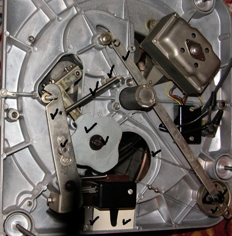

Some months ago I was given a badly cannibalized TD-124 series I table - originally I was going to use this as a parts unit for my 124/II, but have decided I could use a second one of these tables and am going to try and find some of the missing parts for this one. This unit was neglected and the paint is a little rough but acceptable for the intended purpose after a thorough clean and wax.
I've serviced the motor, and the drive train is largely intact as I have the intermediate pulley, and idler assembly. What I am missing are all of the components associated with the speed change mechanism like the speed change drum, linkages, springs, pins, and the linkages to the eddy current brake. I also need the steel ribbon, and all of the components associated with the knob. Any of these parts even in isolation could be of interest.
Currently I am close to being able to run it as a TD-121. Some improvisation and a little machine shop work will get me that far.
The great irony in all of this is that last week there were a bunch of the exact parts I needed on eBay, followed the auctions and forgot to bid when the time came.
If you have any odd parts that might fit the bill, please PM me and we can talk. (I'll probably need to see some pix to know whether it is a part I need or not.)

I suspect from the description above that your problem was the reverse of mine. I suspect the nylatron thrust plate is actually marginally quieter than the steel one I am using, but it is acceptable. The friction is certainly very low compared to the nylatron.

I can't help you with the rest, but I now have a fair amount of experience making a DIY metal drive ribbon for the speed change mechanism. *IF* you find an OEM one (or two, one for me), let me know. Mirko, (SQ38S), the guy from Calif (on ebay) that seems to make everything, told me he can make one, but it will be expensive. I made my own out of a small tape measure. I used my old one as a pattern. If you have any other questions, let me know.

Funny how our experiences are so alike, but some are so different. When it comes to main bearings, there are so many ways of lubricating them. I, like you, at first filled the bearing so it spilled lubricant out the top when I seated the shaft. I don't do that now, and I have noticed absolutely no difference between the way I do it now, which is clean the bearing with alcohol in a ultrasonic cleaner, (it took about 6 hours to get all of the old oil out of the bronze oilite bearing.) I then filled the bearing housing with "turbine oil", (20W) and used a bathroom heater to help it soak in, again, for about 6 hours. I then drained the oil, and left a spot of oil at the bottom for the thrust pad and ball, but thats it. BTW, I have 2 complete main bearings, and tried both, and they both are dead quiet and both got the same treatment. My theory is the oilite bearing will hold oil for years, and about every 2 years, I will renew the lubricant.
I did also polish the pully's, but also used talcum powder on the belt sourced from Brinkman, and having "THORENS" printed on it.
BTW, I love my 3012 arm, and have no complaints, except for the arm lowering a bit too fast. I am working on that though, (a good place to get heavy solicone fluid is from hobby shops, they use it for differentials in RC cars.)
