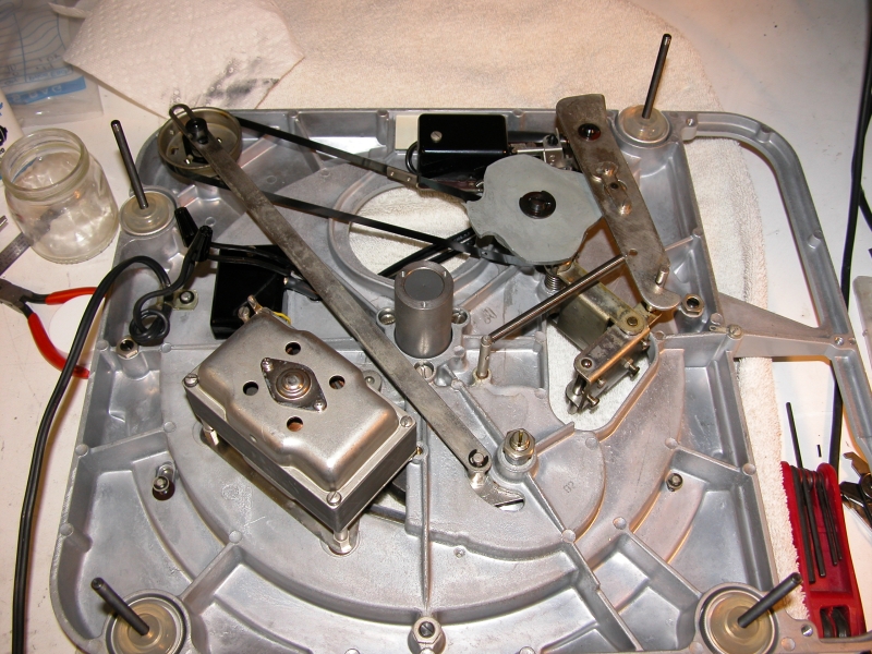

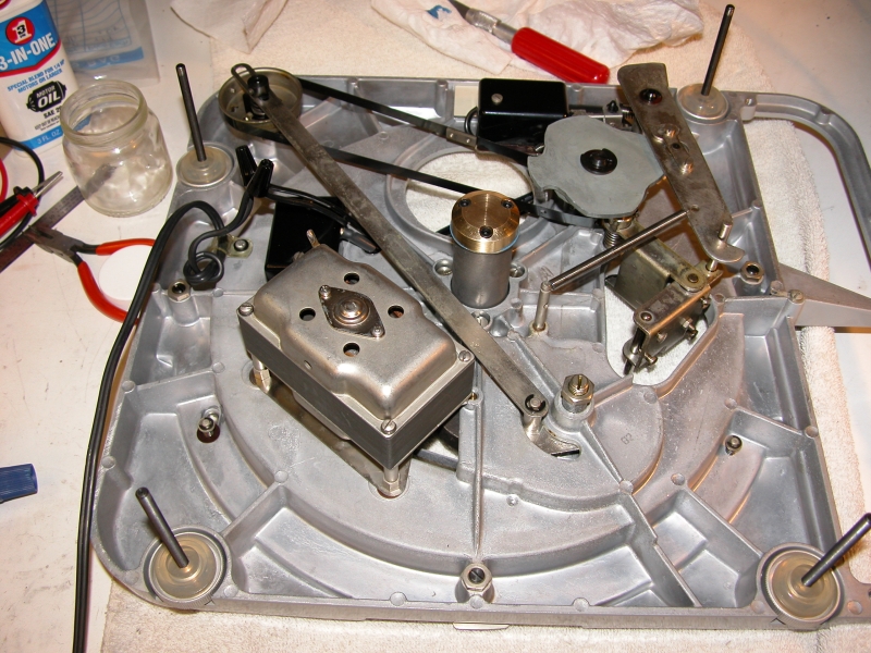

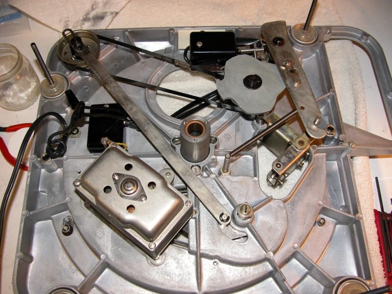

Main Bearing Service and Those Aftermarket End Caps
I have heard plenty of bragging over the months of coast times of up to 90 seconds or so from 33 1/3 rpm after shutting the motor off. Mine never coasted for anything like this long. At its best 45 seconds was it, lately it seemed to dropping into the under 20 second range which was getting my attention..
I periodically clean the motor and intermediate pulley to keep it running quietly as my table gets an average of 50 hrs a week of use currently. Since i finished the restoration I have logged over 600 hrs of use!
I decided to service the main bearing as I did not get all of the old oil out of the bushings previously. Today the main bearing spent about two hours soaking in lacquer thinner. In order to remove the bearing with the aftermarket end cap I had to remove the cap first, when I did this I noted a rather excessive dimple where the ball contacts the face of the bronze end cap. This dimple was nearly 3.5mm across, this is wear since I installed it in November, and was obviously increasing friction and bearing noise as well.
The moral of the story I think is to get an upgrade kit that includes a steel or hard nylon thrust plate. I reinstalled the original thrust plate after modifying the end cap to accommodate it.
The issue I currently have as a result of doing this work is that the thrust plate is probably too thick, and it is crowned. I turned it over when I installed it and am hoping in a day or two it will flatten out. I have not adjusted the brake which is currently non functional because the platter is about 2.54mm higher than it was previously, however if the thrust plate flattens out this will no longer be an issue. I'll see, if not I will get a much thinner and flat thrust plate and possibly a new end cap as well.
The message here I think is to get an engineered cap from Mirko, and not one of those exotic bronze, gun metal ones as they wear excessively.
Overall performance is slightly better, it takes a little less time to reach speed equilibrium.
The other thrust of this service was to further polish the motor and intermediate pulleys to improve belt behavior. It seems to have paid big dividends as the mechanical noise is now much less. The surfaces feel very smooth now as compared to originally when they felt rather rough. The belt chatters much less now. I am not sure why this table was so noisy due to pulley surface corrosion/oxidization as it seems to have been stored in a pretty benign environment and is in rather nice shape otherwise.

My table had extremely low hours when I got it, probably less than a couple of hundred hours in total, but it had sat for nearly 40 years unused in a dry air conditioned apartment in Manhattan. My problems have mostly been with congealed lubricant.
Since I cleaned the bearing yesterday, relubed it, and installed the thrust plate the coast time to stop is now about 60 seconds.
The clearances in the main bearing are extremely tight and there is little wear beyond that I have created running the table for the last 600 hours or so.
I'm going to order an end cap with steel thrust plate from sq38s along with a silicon nitride ball a some point soon.
The platter was still sitting about 2 mm higher than optimum for brake adjustment last night, and I've decided not to adjust the brake height, but fix the root cause instead. (I'm assuming that it will not have changed much since last night.) In the mean time I just scoop the record off the platter without stopping the player. Works fine..
This $69 bronze end cap was in no sense a worthwhile upgrade since I will probably not be using it unless I can find a thinner thrust plate somewhere, and will have to replace it. I think it actually significantly increased bearing noise as the running surface wore to conform to a progressively larger area of the ball. The contact point should be as small as possible, due to the softness of the material I suspect the contact area had increased by a fact of roughly 10X or maybe more.

End Cap and Thrust Plate
No change in platter height since last night so I'm assuming the thrust plate is just too thick. Don't buy any of those bronze end caps on eBay!
The turntable is running much better and comes up to speed quite bit quicker, cold speed is off by very little as compared to before. (Well under 1% I'd swag.)
I've ordered one of Mirko's end caps for reasons that I think make sense. I'll report back on how the replacement performs compared to the bronze end cap. Ironically the new one comes with several thrust plates so I will be able to save the bronze end cap for reuse with one of the extra thrust plates. Will go on the other TT if I finally decide to restore it.
