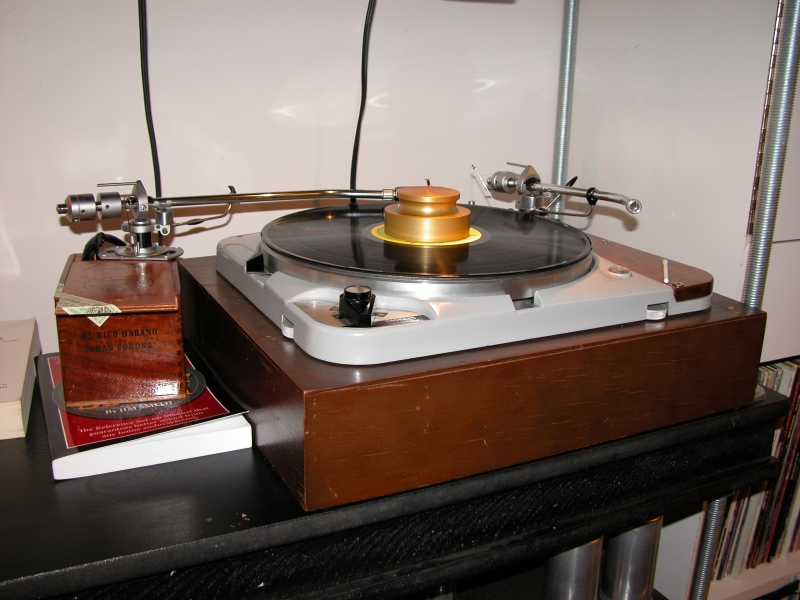

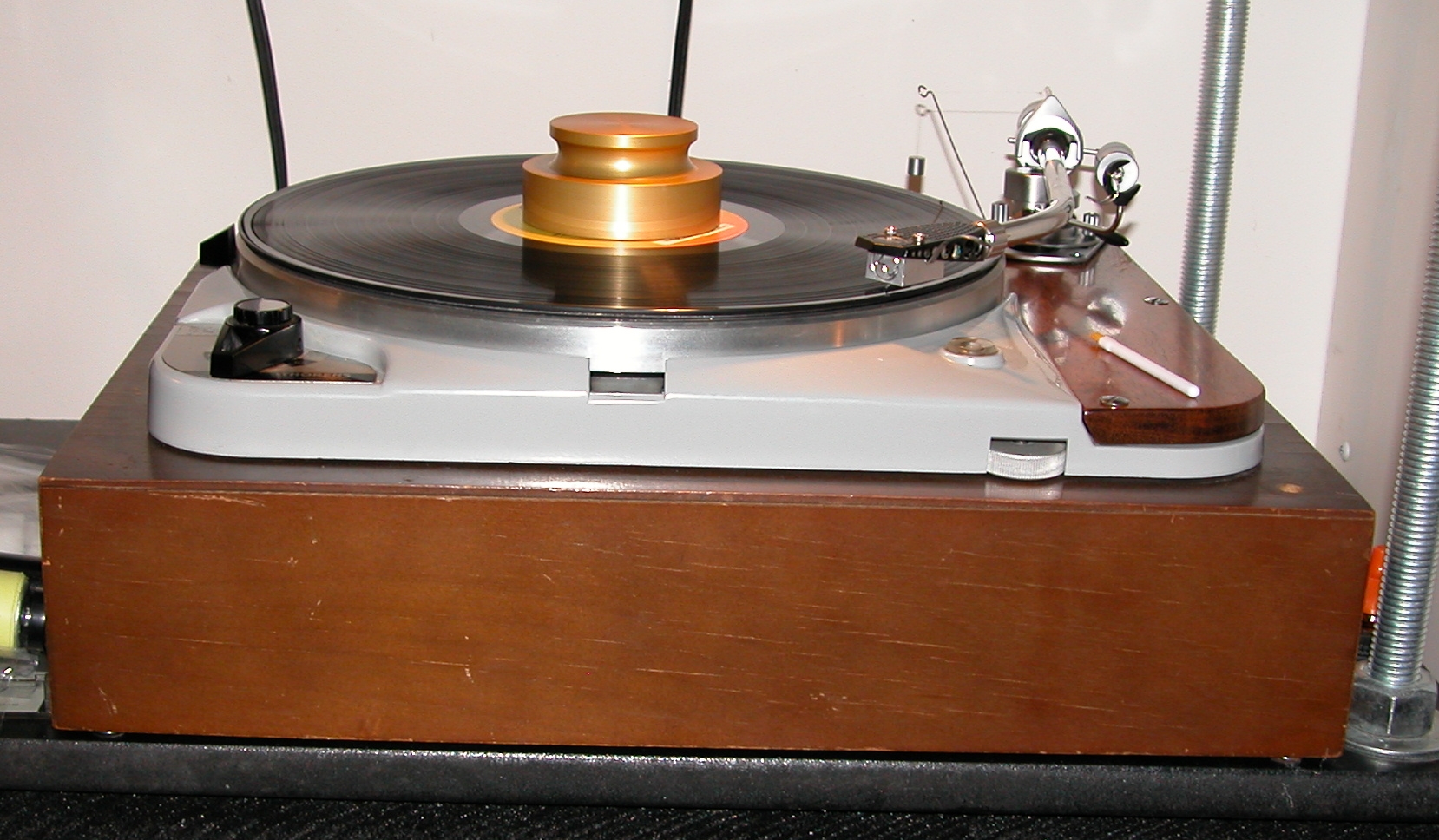

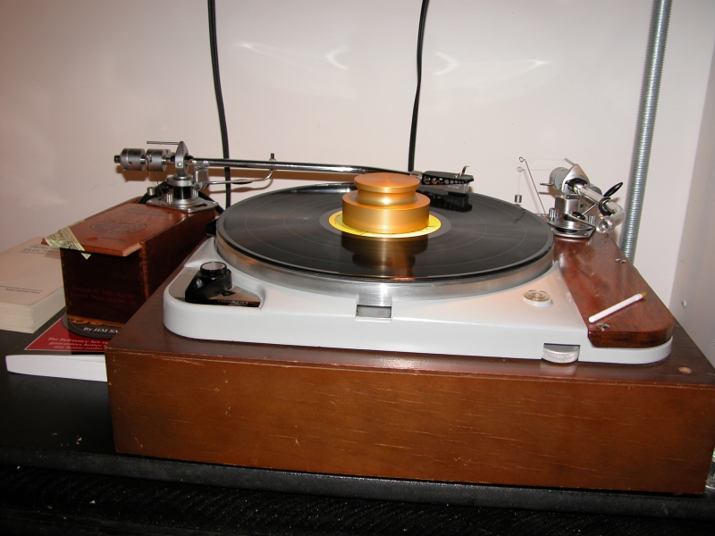

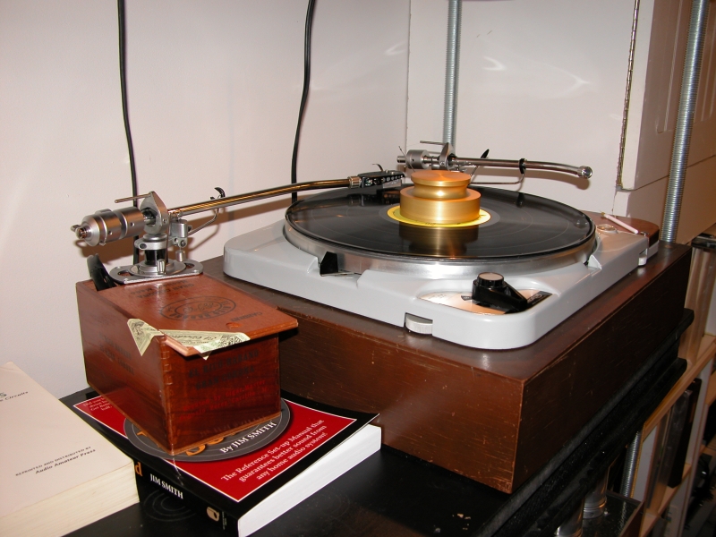

David, please post a picture or three of your TT, anything you'd like to share.. 😀 Would be nice to see it and I can probably reassure you that your arm is correctly mounted if you do so, if not I can probably tell you that too.. 😛

I have to appologize for being such a lousy poster. I hate it too, when people post stuff with out the pictures! Guilty!! I'll listen to my turntable for a while before I tear into it. I want to check the wear on the lignum vitae bearing. I'll try to take some decent pictures and post them. Steve, any pointers on how to take those beautiful pictures of yours?
As to the use of the compression coupler on the spindle housing, it reduced some noise. I just removed the coupler and listened to London PS 523 "How to Give Yourself a Stereo Check-Out" track #8 "Silent Grooves." I cranked it up to about 3oclock and I hear the familiar whoosh...whoosh...whoosh... sound of the idler wheel running along the platter rim. It was very faint but it was there. This noise is not obvious while listening at around my normal listening level (9-11oclock setting)and does not detract from my listening enjoyment. But the noise is just bearly noticeable in silent passages if you listen intently for it. I replaced the coupler and did the same test. The whoosh just about disappeared at 3oclock. In summary the coupler didn't seem to make that much difference in my listening enjoyment, but on a quantatative level (my hearing at an extremely loud level) it did reduce the noise transfered to the platter through the spindle housing.

Tinkering with an SME 3012 Series II

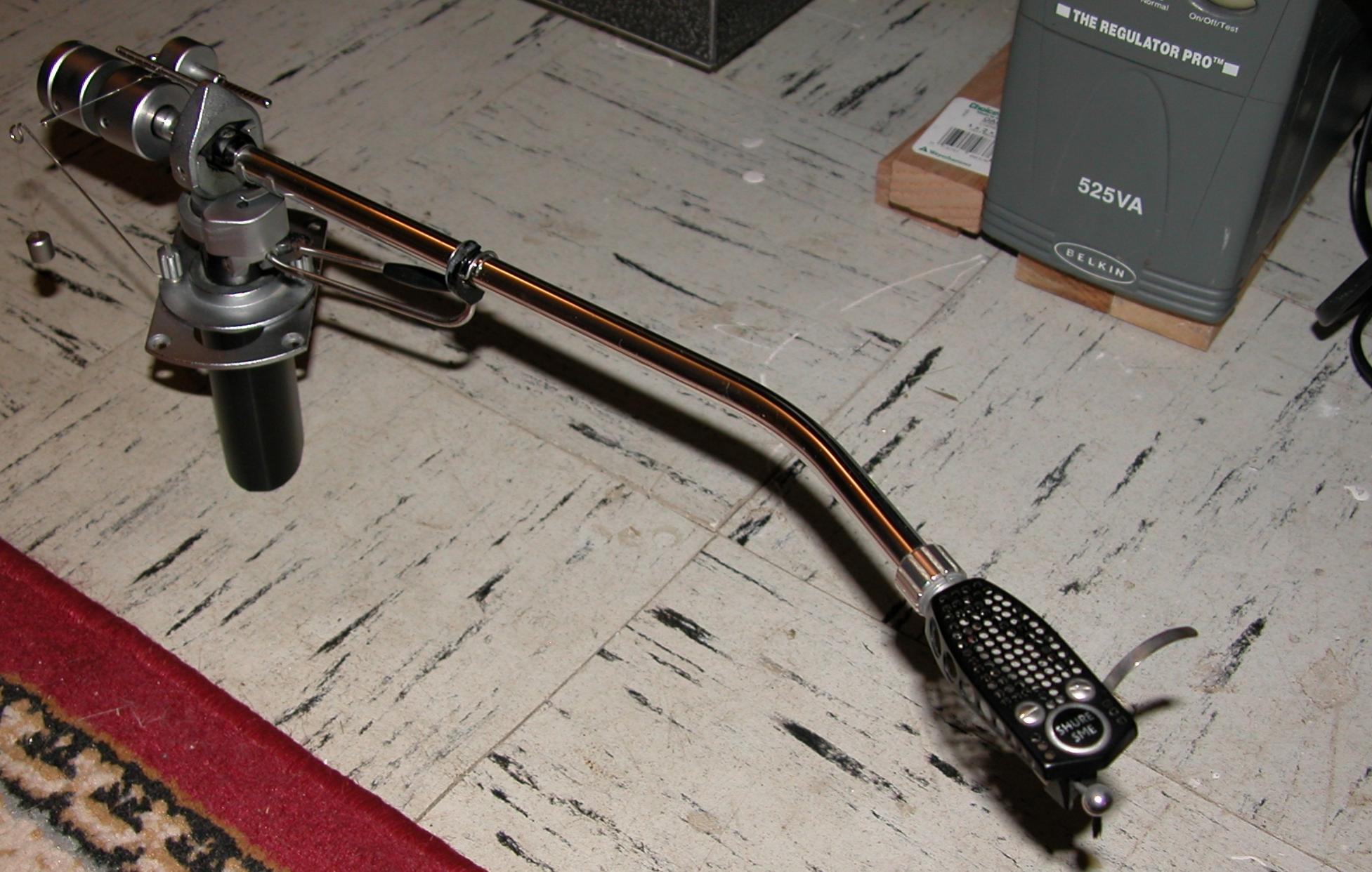

I've been working on an SME 3012 arm which was loaned to me by a friend. Curiosity did finally get the better of me and thanks to the help of a donated cigar box, a spool of solder, and "Getting Better Sound" I was able to play it for a short period of time. Long enough to know that I am acquiring an arm board for it, and am now scheming to acquire one of my own longer term. (A real one)
The 3012 is definitely a better match to the low compliance high mass of the Zu/Denon than the lighter 3009, and while most improvements were subtle there was a significant tightening in the low bass and the very extreme highs seemed considerably better as well. Overall the improvement was quite significant and worthwhile from my POV.
No problems with rumble either despite the odd mounting arrangement - guess that says the table is running pretty quietly since the rumble component is now no longer in any sense common mode since the arm was completely decoupled from the chassis.
The lash up shown in the following pictures was quite ill-advised but was enough to give me a sense of whether I should spend some more money.. 😱 It was quickly dismantled before some mis-hap took out my cartridge.
