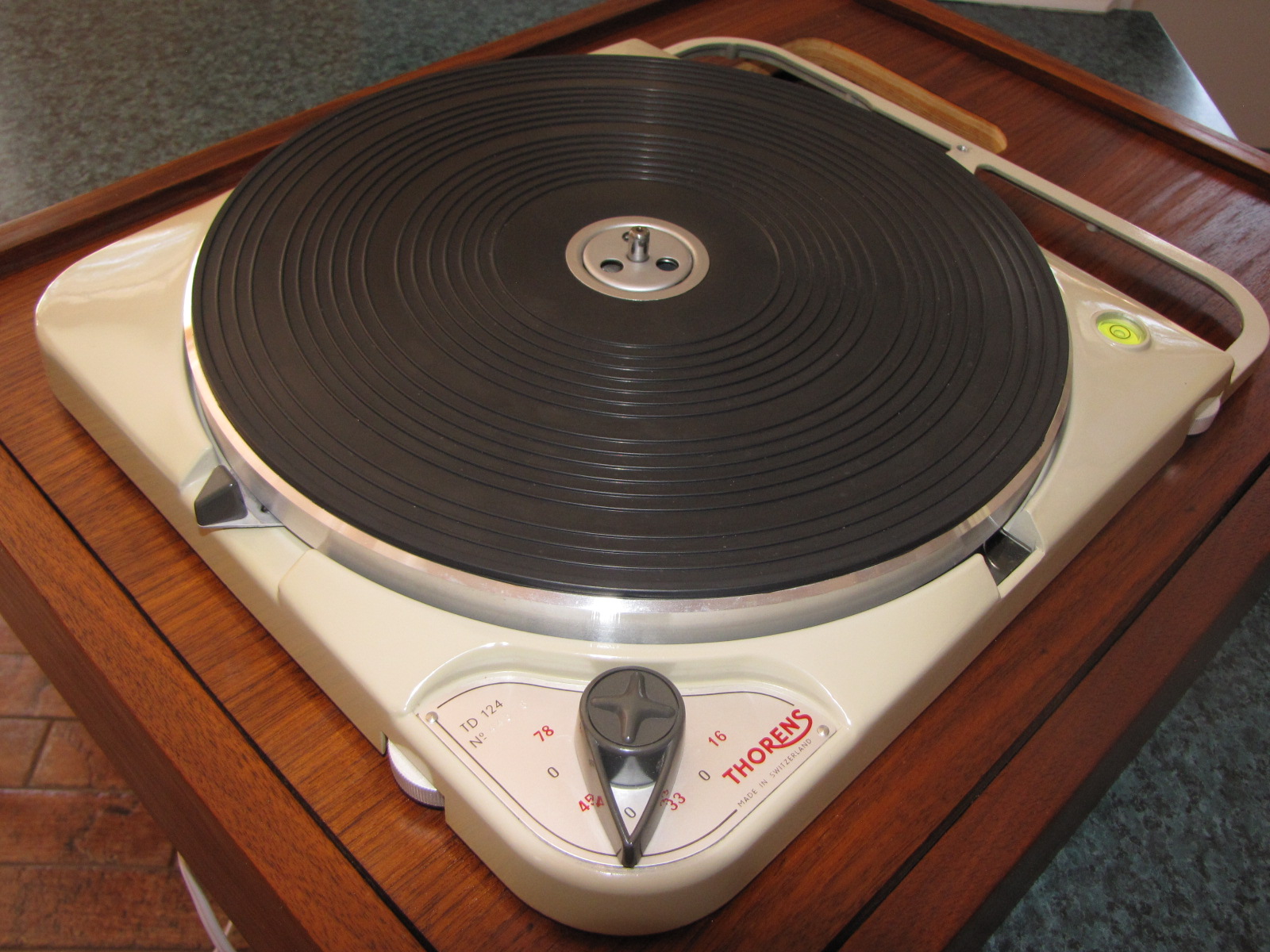

Just finished reassembling most of the tt. The only piece left to install is the clutch but I'd like to replace a piece of teflon tape on it before I do.
The turntable is actually spinning, running pretty quiet as I only hear a bit of noise from the rotation of the idler wheel. All speeds work, it comes up to speed pretty fast and seems to be holding it very well, although I've checked only by using incandescent lighting, strobe light doesn't work.
I had to spray clean the electrical contact assembly since it was sticking in the off position. After application of De-Oxit and working the spring manually, it came back to life and now works flawlessly when switching between the speeds.
It took me a good 6-7 hours to complete the work since I didn't take any picture while disassembling and had to rely on picture from this site:

Well, here is the fruit of my labor!
I'm very happy with the results so far. Now the real test is coming, as soon as the SME 3012 is modded and installed. Many thanks to you Kevin and the others who built this thread, I will continue to follow it and hopefully keep on learning about this marvel!

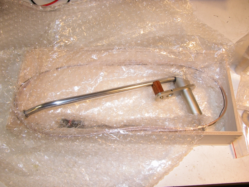

TD124 Listening notes 5/14/2011:
I'm still listening to #2729 and the Zeta/Uwe bodied DL-103R. With regard to tonearms I must confess I've a strong temptation to try something in the 12 inch range. I've been reviewing my options here.
1) modify a SME 3009 S2 into a 3012 condition by the replacement of the original armwand with one for the 3012. Then add a longer end stub and perhaps replace the 3009 cw with a heavier one. Perhaps made of brass rather than the steel/chrome satin plated original. A chap named Jeremy, who haunts the Lenco Heaven is making these parts for SME conversions. He has a number of replacement parts designed to modify/upgrade the arm. I'm looking at this.
2) Buy an original Ortofon RMG 309 and refurbish it. (expensive option)
3) consider the Schick (not cheap but by all accounts, very good value for the dollar spent)
4) Look into Ikeda 12 inch arms. (expensive)
5) FR-66s (no longer an option due to the insane collector prices being received for this arm)
6) EMT 997 (Banana arm)
In one of the rear recesses of what remains of my brain, there is a nagging thought that the differences I'm likely to hear will be at best, only marginally better than what I've got now. But in another area of what remains of my brain, there is a similarly nagging thought that I won't know til I try it.
re: what I've got now. This particular Zeta arm has an Incognito wire harness utilizing vdH silver wire and Incognito clips and plugs. Taking advice from other Zeta owners I removed the back cover from the cw. This improved upper end detail and air. Subtle but worthwhile. I'm also doing some "mass tuning" by using a head weight between the cartridge and its mounting to the arm. I've got the Denon and arm resonating at 9hz on the hfnrr test record. That was my target range. ('kept adding weight till it reached 9hz)
In general, this is one very dynamic sounding tonearm. A nice compliment to the TD124 which does have the ability to project the power and force of music. Much more so than most suspended belt drives, I suspect. In this context, the Zeta gets out of the way and allows the musical energy to flow through into the listening room. At the same time, this arm gets out of the way and allows detail, air and transients to to manifest themselves. (Yes the TD124 does allow some detail and air. And so do these Denons when fitted with a nice Uwe body)
On whichever 12 inch arm I make/acquire, I plan to continue using one of my two Uwe bodied DL-103R's. The one shown in the top photo has the standard conical tip. Another has the Uwe Panzerholz body and a SS ruby cantilevered/ FL stylus re-tip. The SS retip adds a some more detail, air and transparency to the already good Uwe-bodied Denon. But there is something about the standard conical tip version that I like for playing 60's/70's rock records. Perhaps it is a forgiving combination that ignores some surface noise while allowing the essential parts of the performance to shine through while allowing the objectionable parts of the recording to remain in the background. Not sure which of these I prefer best but it's nice to be able to make the comparison.

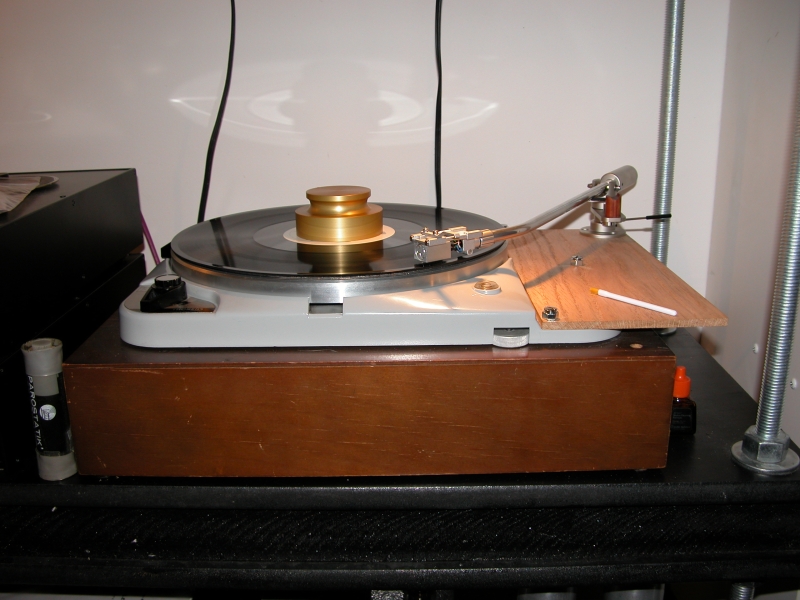

Hi Steve,
Yes, I purchased my Schick through Jonathan over at OMA - he's the only authorized agent for the United States. The arm shipped directly from Schick in Berlin to me. The time from order to delivery was about 14 weeks, lead times might be a bit longer now as demand has increased lately..
I mounted it on a quickly cobbled together and completely inadequate kluged arm board. The results are rather interesting to say the least. As a preface I am really glad I went this route, although the long wait and the financial commitment go against my grain for instant gratification. I must be growing up.. 😀
I agonized over getting a 3012 instead, but the cost is comparable and I am relatively confident that the 3012 is not the equal of this arm.
I'm using an Orsonic headshell with the Zu DL-103-1 and the optional counterweight intended for for use with the SPU.
The sound could not be much more different from the 3009 as far as the Zu is concerned. It's much darker, fuller, meatier, and in a good way I'd say - the detail is all there (and then some) the bottom end is very solid.
The sound is detailed, precise and this arm makes the Zu shine in areas where it hadn't previously. The midrange tonal balance is much more neutral in comparison the 3009/Zu combination and is something of a relief as the mids and highs generally sounded a bit aggressive in retrospect. (Reminiscent of the difference between aluminum and titanium diaphragms in mid compression drivers.)
I am no where near realizing the full potential of the arm given what it is mounted on, but should have the slate plinth in a month or less.
The arm is a joy to use, and not very fussy about set up either, changes are quickly and easily made. I anticipated difficulty setting the tracking force, but had it accurately set within 5 minutes, and there is no way for it to inadvertently get out of adjustment.

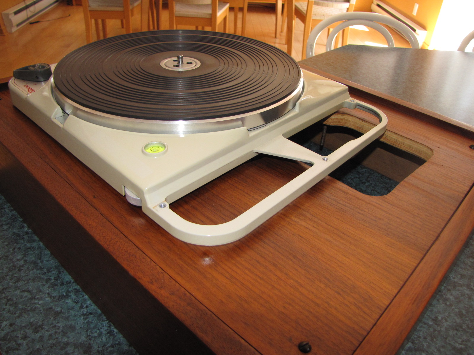

Update on noise reduction efforts
My TD124 is now behaving significantly better.
Old belts were fitted, I was able to get hold of two very well used belts, that had a much greater elasticity than new belts, also compared with the pair I bought from Beverly Hills, FL.
And when I fitted the old, discarded belts, the engine whirr was significantly reduced, without sacrificing platter performance. I am now stretching one of the new belts, to see how it will perform, once the tightness has been reduced.
Difference in elasticity between new and old belts is significant - the new belts resist being stretched, while the old ones are easily stretched quite a bit, relatively speaking.
I also switched idler wheels, to see whether that would affect performance. I had an idler wheel with bearings that produced a little "knock-knock" until I applied the grease that comes with the Schopper noise reduction kit. After I applied grease, the "knock" completely disappeared. I was able to get a wheel with good bearings and mounted that, without grease - and that runs truer than the old idler wheel.
I experimented with talcum, but with the more elastic belt that's not necessary, I feel.
But I did discover something that may be of interest - the Thorens libelle (level) mounted on my deck wasn't in true level! There shouldn't be room for error here, as the libelle is pushed into its slot, and should seat in a way that lets it indicate true level.
I discovered this when I bought an Ortofon record clamp with a bubble level indicator - and the two were not indicating the same. I therefore checked platter level independently, and it turned out that the smaller libelle was out of horizon.
Once I adjusted level according to the bubble on the record clamp, the noise floor through the speakers was lowered.
I understand that mounting the arm independently of the chassis, directly on to the plinth, can also significantly reduce the noise floor, and I'm going to experiment with that.
I'm using chassis #2729. Early version, circa 1959 or perhaps a little earlier. The stepped pulley/capstan drive is the early design with its axle fixed solid to the chassis. A bearing ball at the very top of the solid axle functions as the vertical thrust for the stepped pulley/capstan.
I think this earlier design holds up very well over time. I'm not so sure about the later re-design of the stepped pulley axle as is seen in the very late mk1 and mkII models. One example I'd give to support this idea is that my version seems to tolerate different drive belts of different thickness/length and tension without any overt/obvious difference in perceived drive train noise levels.
I've been using the belts sourced from Elex-atelier for the TD124 for the past few years. A few of them on different TD124's. It has seemed just a touch tight going over the 60hz pulley but wears in well. No perceived increase in drive train noise when using this belt versus an old stretched belt.
Then recently I've tried a new belt from Thorens Export. The one with the Thorens logo. It actually fits up easier than the Elex-atelier belt. Also, no perceived increase in drive train noise. I'm using it now. No problemo.
Sometimes, the real problem with motor noise has more to do with the self-aligning motor bushings (top and bottom) being slightly out of line to the motor axle shaft. It pays to revisit the adjustment procedure for this as many times as it takes until that motor runs as quiet as it can.
Sorry, but this is subjective stuff. If we had a factory spec for motor bushing alignment complete with motor vibration analysis and a chart with real hard values to shoot for, that would be one thing. 'Til then we are reduced to getting a 'feel' for the least vibes/smoothest running by listening through a mechanic's stethoscope as the probe touches upper and lower casings of the running motor. Then lightly tapping on one case or the other to 'adjust' orientation of the bushing within while the 4 machine screws are just loose enough to allow the case to slightly move in any direction. The stethoscope is a must have for motor bushing alignments. It does work.
Anyway, just sayin' no belt troubles over here on an early example TD124.
Hi Kevin. Thanks for that initial analysis of the Schick. It is useful to me since you've also experienced a 3012 and 3009 on the same/similar TT. And the 3012 is something I'm considering. Acceptable examples of the SME 3012 go for considerable moolah these days.
re: midrange tonal balance of the Zu DL-103R schick versus SME. I wonder if the Zu 103r didn't energize the arm wand of that SME a bit more than the knife edge bearings could cope with? I see that Thomas Schick discusses the SME with regard to bearings and condition. I have to agree with Thomas's conclusion that the SME knife edge can get into pretty rough condition after 40/50 years of use/abuse. Here's a close up photo I took of a steel knife edge from a later 3009 S2:
The wear pattern is obvious on this. Toward the armwand the knife edge appears sharp - er than outward where you can see evidence of the functional area and wear that has occurred over the years. Just a guess; a "sharp" knife edge bearing is going to sound better than a worn example like this one.
Then there are those bronze knife edge replacements being made.
Here's an example of a bronze knife edge bearing I bought from an ebay seller based in Taiwan:
In these photos it can be seen that the machinist has left a "flat" at the surface of the knife edge where you would expect a sharper edge, or at least a very tiny edge radius. Instead, a rather large flat surface that is too wide to seat down into the bearing race of the SME knife edge saddle. Not a good thing, I suspect.
I should note that I have not seen the bronze knife edge bearing being offered by Analogue Tube Audio. Maybe theirs is different.
