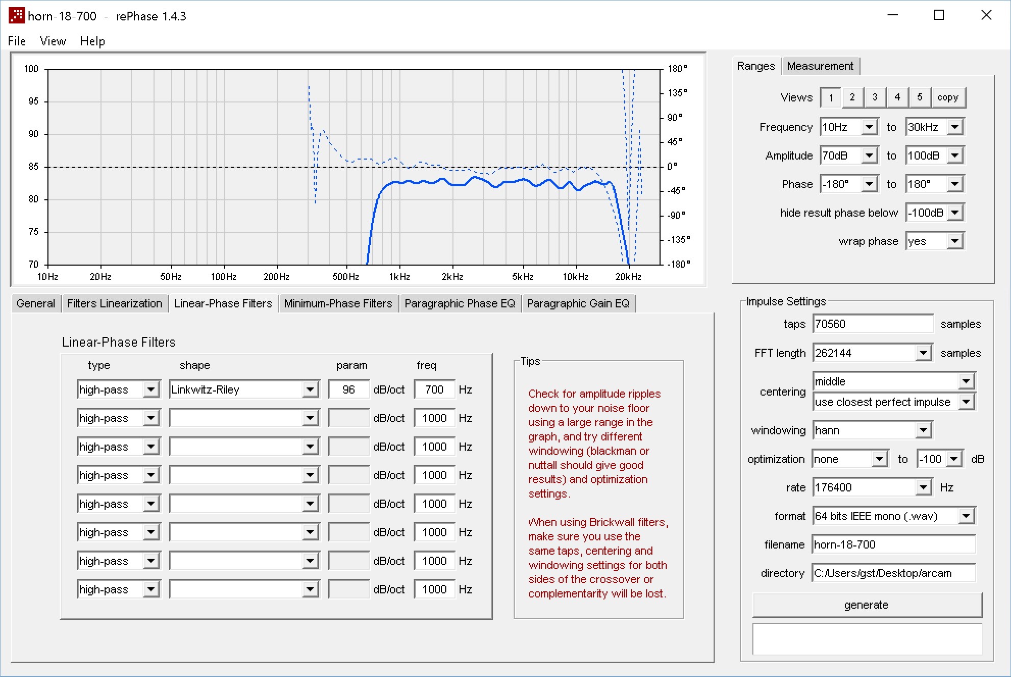

So now that I know what the box and crossover are doing I just tried some linearization only with minim phase crossovers.
A had to spread by bandwidth because the inband was too attenuated so it’s now 65hz-110hz (48db slopes both sides) have me a 16.6ms fir which mates up fine to my 17.66ms fit to sub with 3 more ms added to this 10”.
So I used this fir and added 3ms delay on top and it’s sounding very close to when it had the open and Hd in series.
Pic below (yeah it looks bad but sounds ok)

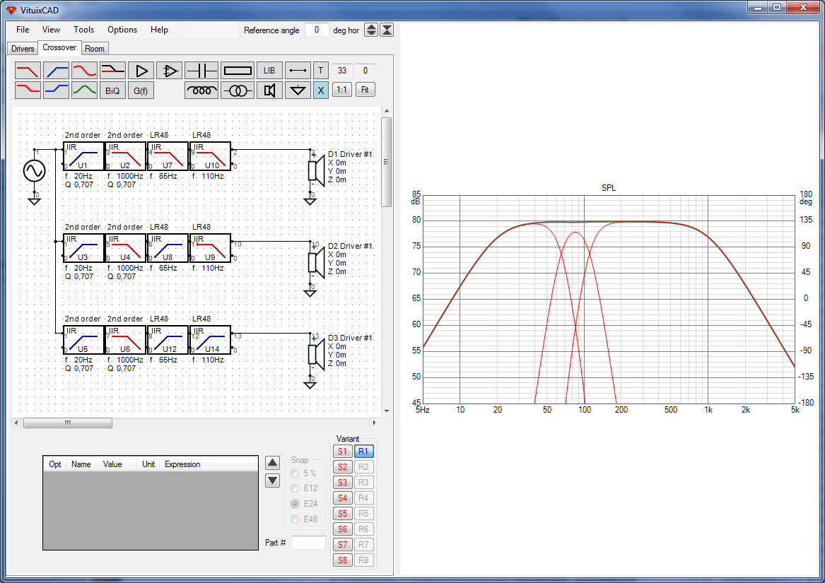

So the situation is basically this
I have a 3 way up front of car
6nd430- 80-300
2118h 300-1.2
Horn 1.2 up
Than a 18” sealed to 80hz
All LR4
Because of the car shape there’s a dip at 80
So adding the 10s under the back seat and using timing tricks and time them against the sub and the midbass to reinforce that null only where I sit
It works, using an allpass on the sub also works but changes things negatively
So I’m trying to get the 10” so sound smooth and have it only play 65-110
I tried crosier 100 but there was no output ( the dsp wouldn’t pick up the signal it was too low)
I went up in increments of 1hz ( 107,108,109,) and at 110hz audio came back
So now it’s just a matter of trying to get it to sound smooth
If I push the crossover up to 160 it sounds just fine but it detracts from my stage playing that high
