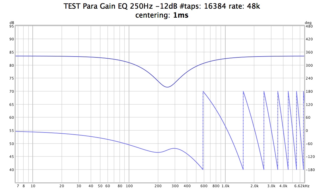

Hi everyone,
I use REW and rephase to create a param eq IR for convolution in JRiver mostly for attenuating some bass peaks, which sounded ok. A pretty basic use I thought I understood until I decided to run REW to check the convolution.
The new versions of REW can generate a sweep with 2 acoustic references (one before and the other after the sweep for clock adjustment). Without convolution the two acoustic refs would play nicely. With convo using the middle default centering the last one would not, indicating some problem with the convolution.
First I thought it could be something related to the number of taps but to no avail. Then I changed the default centering from 'middle' to 0ms and the convoluted sweep played nicely with both acoustic reference, and the REW SPL, as expected, showed a response similar to the effect of the filter (param EQ).
I realized I did not understand what is the effect of this 'centering'. Could someone explain to me why 'middle' did not work and a 0 or small delay did? or point to a link to some documentation about it?
Many thanks

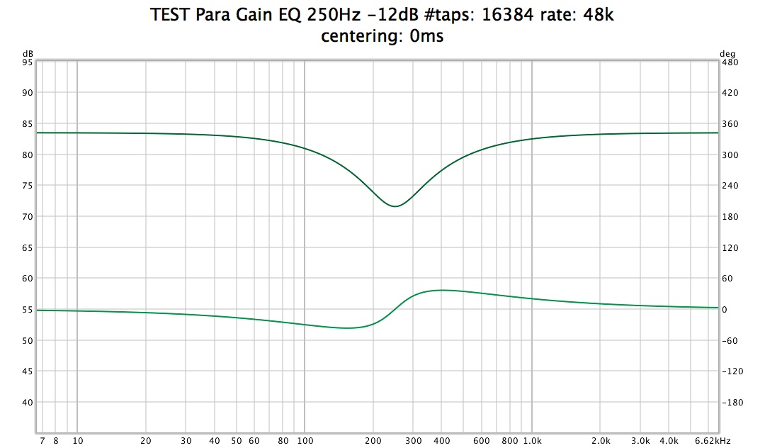

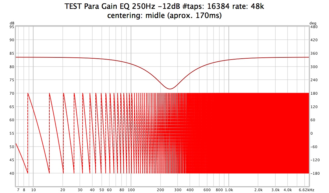

Thanks for the detailed explanation, and success with cantering. I am not even close to be in the saddle with all this IR stuff lol.
You have a point. I did some tests after reading your reply.
I just wanted a gain EQ IR (no phase adjustments) and now I see the impact of the phase changes that middle or anything different from 0ms will cause.
0ms seems to have only the phase changes related to the filter itself as shown in the attached 3 REW SPL graphics of the IRs generated by rephase.
It may well be that these many HF phase changes when using middle are affecting the high frequencies including the last acoustic reference of the sweep when testing the convolution.
regards and thanks again..

Hello hibikijin,
Centering will have an impact of the final delay of the processed signal.
When building a multiway crossover care has to be taken keeping all delays in check to create a properly time-aligned system, but for a global EQ (like you are doing here if I understand correctly), this will just be a delay.
The final value of that delay in showed under the "generate" button after the FIR generation. This delay has to be used a the time reference (sometimes called t=0) when displaying the response of the impulse in order to get actual phase response.
In practice when setting centering to "middle" you will have halve the impulse of delay. So let's say you have set an FIR length of 16384 sample at 48kHz, middle centering would be 8192 samples of delay, ie 170ms.
I suspect the delay you set was long enough to confuse that specific measurement strategy of REW?
