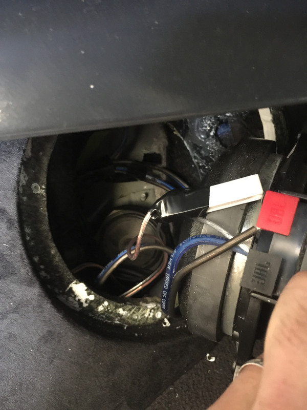

On another note
I added a 2” speaker in my kick pod, playing it in reverse and sealed the basket with 100 layers of electrical tape and a 25w 47ohm resistor on the 2” to lower the power quite a bit
Put the mic in the pod took some measurements of the 8 and the 2
Got the 2” to cancel the ringing and horn loading fairly good now. I just tryed matching the difference of the 8 in and out of the pod. And reversed it in polarity , all done in rephase! Worked so good. I can’t believe. Had to make a few filters till I felt it was nailed down
The 8 measurements are soooooo much better now.
The 8 is a tiny bit quieter but it should be , the ringing is gone. Lot better
Better depth , it’s working. Now to prefect this.
This is a very good idea. I am so surprised how well it works
That hollow sound is gone the echoing at 800 is reduced so much.
Extremely pleased. Thank you guys for the help

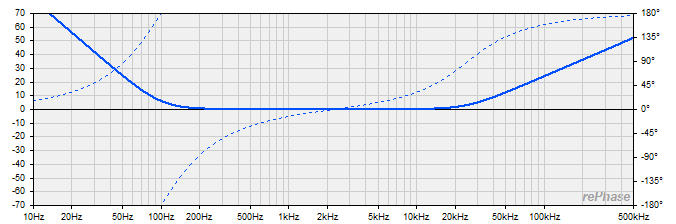

Import of settings from REW auto eq is only a partial workaround for lack of the feature in rephase for several reasons. REW refuses to fill any dip below the target line then complains when you set the target low enough that it doesn't need to. REW lacks flexibility in target generation - its only aimed at room eq, not XO generation. Rew limits resources applied to the eq and seems aimed at IIR filters rather than FIR.
That target line is REWs major benefit re' filters. But if I'm going to have to go into rephase and manually correct for REW's short comings as well as to linearize the phase, then why not do it all in rephase to begin with?
Thus my feature request: can you give us the ability to import a target response (in addition to the existing ability to import a measurement) that acts as a visual aid during manual equalization?
Filling of dips depends on your settings for individual and overall filter boost. Generally a bad idea nonetheless.
REW warns you if much of the response is above the target. Not sure how that constitutes a complaint.
REW has a speaker driver target setting that allows selection of Bessel, Butterworth or Linkwitz-Riley lowpass and high pass filters up to 8th order. It also allows a "house curve" to be added to any of the targets that can be any shape you like and is defined by a simple text file.
Yes it is.
...I would still want a target line in rephase..
In meantime there is below trick for stop bands, a "COMPENSATE" HP filter LR 4th order at 100Hz is set and a "COMPENSATE" LP filter BW 2nd order at 25kHz is set which should be close to target for your new line arrays, now it should work import a measurement and EQ everything flat as a pancake, when that EQ work is done disable the two compensate filters and what stands back is the target curve.

clever, perhaps too much so 🙂 I'd almost rather draw my target by hand on an overlay for the screen.

On another note
You can see the 2” at the bottom inside the kick pod
This is very interesting🙂
Can you draw a picture of this setup with responces and corrections?
signal - rew - amp - 2"
- rew - amp - 8"
As I understand it the 2" is cancelling the reflections at about 800Hz?
Maybe in an own thread. I know it is a lot of work, but the solution is fantastic!
