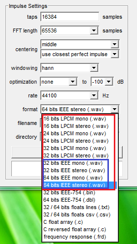

Can somebody help with the rephase export settings for targetting JRiver's convolver?
Thanks!
...Can somebody help with the rephase export settings for targetting JRiver's convolver?...
About format all of them in red below should work, in past using the 32bit JRiver version myself used 32 bits IEEE and after they released 64bit JRiver version i started use 64bit IEEE, but again all of the red ones would probably work inside their 64bit engine. Think all the other settings should more or less say itself, but can recommend if lag is no problem that huge taps and FFT lenghts combined "use exact centering value"/"rectangular" window sounds extra great and natural to my ears, but know not all users can live with huge lag of sound stream.
If JRiver automatic shifts rate (dynamic/bitperfect settings) from track to track one can ignore that and simply point to whatever wav-file with a user set rate and JRiver will resample filter for that single convolution file, but if one wan't correctly dynamic sample rate switching there is guides below:

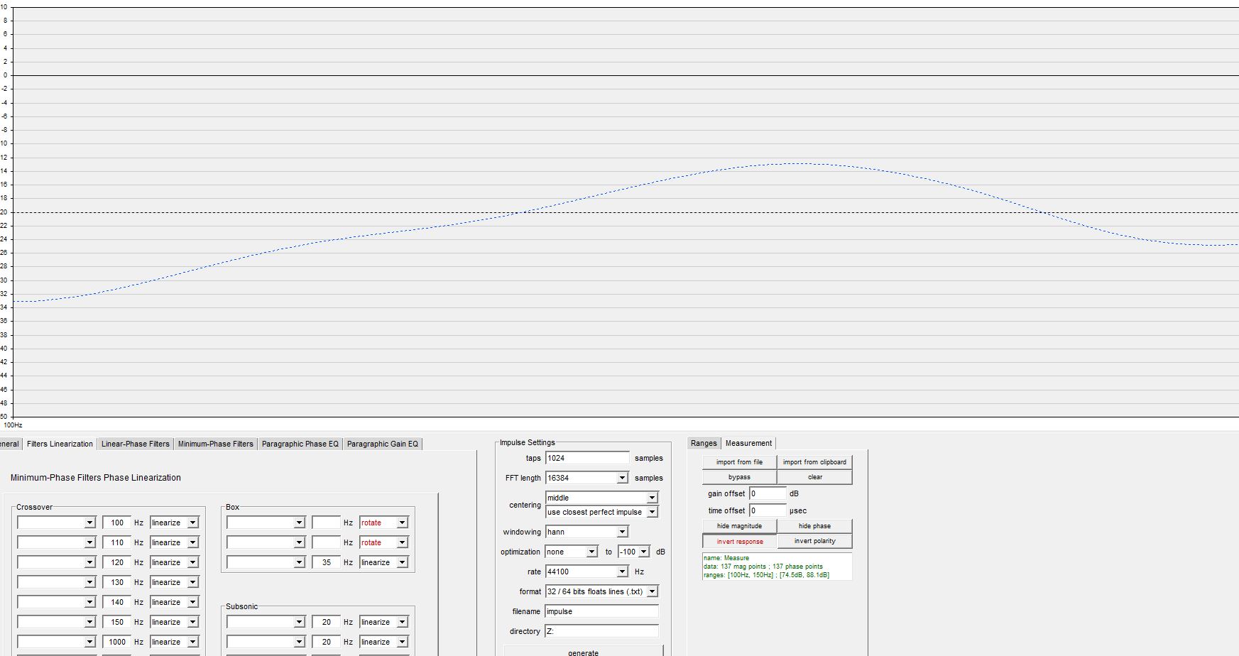

I do not understand. Unable to deploy phase as you want. Something I am doing wrong.
I have to settle like this. Is it possible
Is it a 100 to 150Hz measurement?
I am afraid I cannot provide any meaningful advice based on these screenshots.
Yes, I just need to turn these frequencies. Measurement made them. The full range of frequencies does not work, some kind of incomprehensible schedule comes out. I can throw the result of measurement.
I would be very grateful if you look.

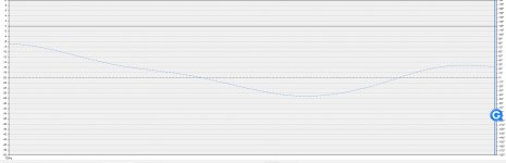

Hi Thomas
Time to waste ?
a constant slope from a given frequency ?
it can be done with low Q EQ but not really flat.

If you want an accurate measurement of that range you need to start the sweep lower in frequency.Yes, I just need to turn these frequencies. Measurement made them. The full range of frequencies does not work, some kind of incomprehensible schedule comes out. I can throw the result of measurement.
Moreover, you also need to see what is going on around that range to get a good assessment of the situation.
Regarding that particular measurement, the passband of its magnitude response appears to be around 80dB, so you need to set the gain offset to around -80dB in the measurement tab to see it.
Using minimum-phase EQ to "flatten" the magnitude response (quotes here to emphasis the fact that attempting to flatten anything in such a tiny range is not really meaningful) will already tend to flatten the phase response.

Hi Thierry,
I am afraid such a constant slope would not be physically "sustainable" 😀
You ought to have a knee somewhere otherwise the magnitude would be infinite at DC, no matter how gentle the slope.
If you are looking for a linear-phase response then using a LR filter with a low slope (can be set as low as 1dB/oct manually) would work. A "reject low" low-pass filter would also work, with a more angular knee.
For minimum-phase response a shelving filer (in the EQ tab) with a very low Q would work.
Re-Hi Thomas,
Linear phase or min. phase do not allows this "soft" slope from a given frequency (rePhase 1.4.3)
No needs to start from DC,but something like about ~500/2KHz.
neither with LR choice (min 12dB/oct) nor low shelving..
This is not important i can do it with min.phase EQ.😱
