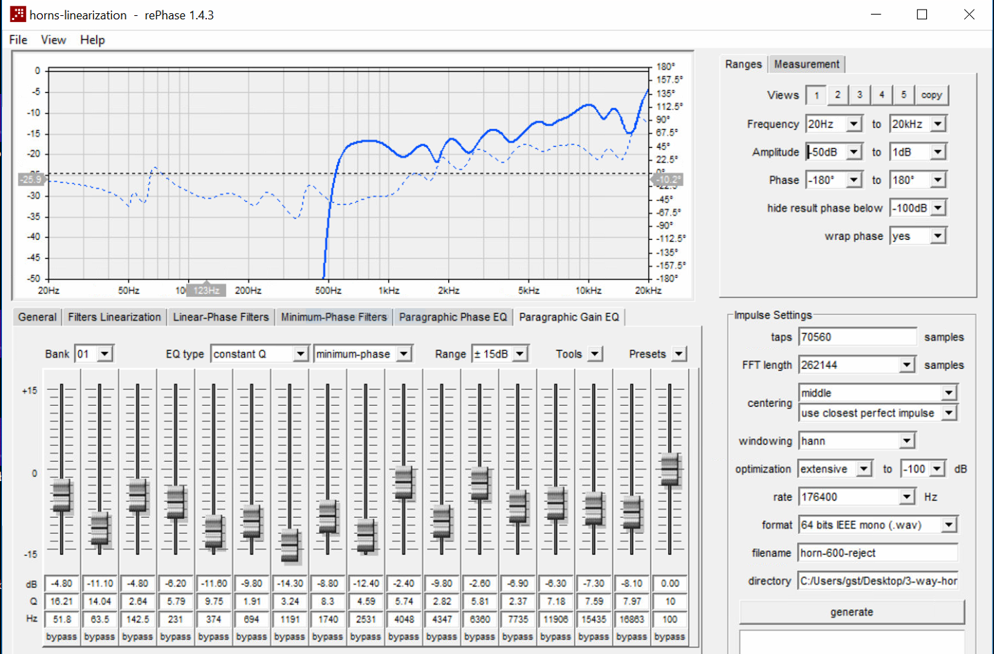

What do your EQs look like? (maybe show us a rephase graph screenshot, with any measurement bypassed)

I'm attaching a screenshot with EQ settings for the tweeter.

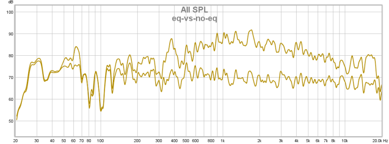

Amplifier's volume setting was the same. Actual volume was lower due to the equalization applied. I'm attaching a volume comparison chart as well.

Typical domestic ambient noise level is 30-35dB. Typical hifi-loudspeaker must play at 95dB/1m or louder to show "real" distortion above noise level. One standard is to measure/set spl to 95dB at 1000Hz with some smoothing of response. Another way is to use standard voltage, but then we must also see the measured dB values to compare.
In theory, loudspeaker equalization always leads to higher distortion levels (when we look at spectrum). There is no way to raise efficiency or lower distortion by eq. When input voltage is lowered, distortion gets lower too. With eq we typically suppress loud parts of spectrum which leads to effectively lower total efficiency. Then, to get same spl level in a measurement (say that 95dB/1m), we must use higher voltage and we will see higher distortion percentage.
If quiet parts of response are amplified, distortion rises just as well and for same standard spl, we get higher distortion again. The problem with this is that we might introduce clipping in loud parts of music signal, in digital domain. It is very common to see music playing very close to clipping of even badly clipping because of "the loudness war" in original signal, so there is not room for eq left. The propability of this depends on where in signal chain spl volume control and eq is performed.
I'm not sure we will see higher voltages across the whole spectrum. The voltage will be higher for initially quite parts of the spectrum and lower for the louder frequencies. It isn't that we will need more Watts to get the same loudness level with an equalized speaker. We won't. Just the Watts will be spread differently. Some frequencies will see higher voltages than others.
