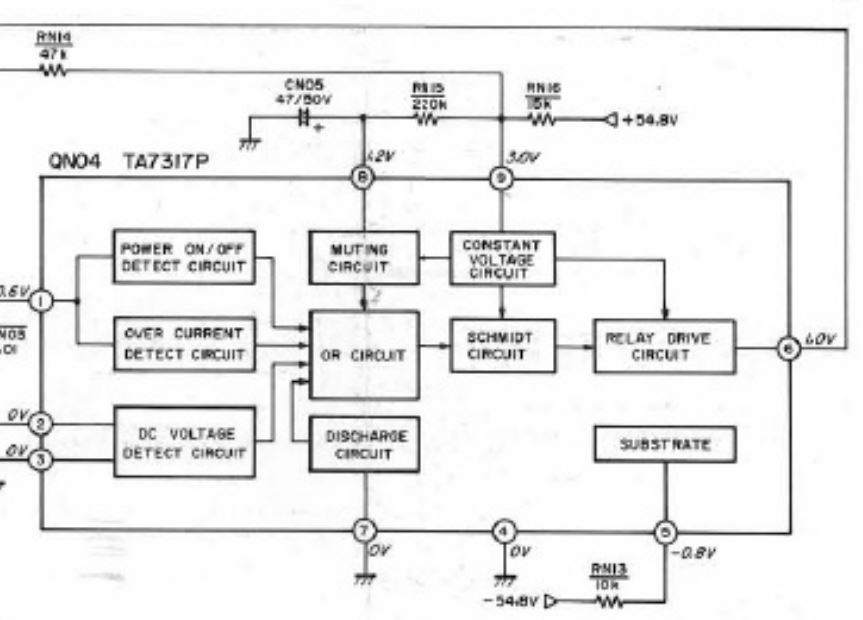

Note that pin 1 gets it's voltage from the chain of R409 and D402 ... D402 connects to pin 1 of J2 which leads to the power transformer's secondary coils. The diode samples this AC voltage, rectifies it and charges c413 to roughly -40 volts. This charge is then divided by R409 and R412 to hopefully provide less than 0 volts at pin 1. Thus, if too high a load dragged the transformer secondary down by more than a volt or two the voltage at c413 would increase, driving pin 1 above threshold, triggering protection. Although it's a bit primitive, this forms a workable over-current detector.
So the next logical step is to reinstall C415 set the board back into the case, install any grounding bolts, set up with the clip lead on chassis ground as before and do a repeat set of readings. We need to confirm the readings are as before, before we go to the next step...
To help you along, I'm attaching a screen shot from a Marantz schematic with the voltages marked by the factory...

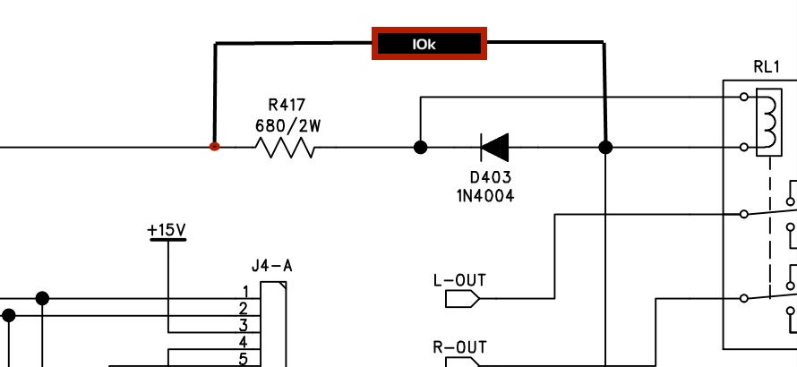

Alright ... lets get this set up so we can discern whether the amp is actually in protection or if the relay is simply not being pulled in...
Have you got a resistor in the 10k range with good leads?
Without doing anything else... Touch the leads as shown... the hot side of R417 to the anode of D403 .... do the protection lights come on?
Now with that resistor still in place, turn the amp off and back on... what do the protection lights do?
Now if this simple test works, you should go on the back of the board and perminently attach this resistor across the solder points as shown. This will let us see the protection light status even if the relay and R417 is completely fried.
This gives us much more information ...
Protection lights on, something is triggering protection.
Protection lights off, no sound ... the relay or R417
Protection lights off, music playing ... Eureka! It works.
Yes.
They come one / stay on.

Ok, that's good.
There is a very real chance that either the relay or R417 will burn out. Or with the amount of messing around, bad solder joints are a real possibility.
Now... when you are installing that resistor on the back of the board. Also remove R417 completely, both legs... Clean the legs with a bit of sandpaper and tin them. Clean the circuit board pads.
Test the resistor again, this time applying a gentle bit of pressure to twist or distort the resistor... see if it loses continuity under moderate stress... if it does you're going to have to replace it. If you have to replace it I would suggest using 720 ohms as this will reduce the stress on the relay coil somewhat.
Reinstall R417 and connect the new 10k across the pads as shown. Once again using extra solder and really cook them down.
Get the whole thing together and we'll continue.

Okey dokey .... When you start up again, here's what we do next...
If you study the schematic for pins 1, 2 and 3 of the TA7317 you will discover these are all connected out to the rest of the amp by fairly high resistance values. This is good because it lets us force certain conditions without damaging anything or massively disassembling the board.
So, get the board together, remount it, put in the grounding screws and fire it up... we're going to let it sit while you go get your morning coffee so it's nicely settled in and all warmed up.
There are three things that can cause protection here... Over current, DC offsets and thermal. So we need to test each of these separately to see which one is triggering protection.
The setup...
You will need a clip lead on ground with a pin or stiff piece of wire at the other end, to act as a probe. What we are going to do is force the protection inputs to ground one at a time to see if we can get the thing working. The TA7317 does not latch so once the fault is removed it should cycle automatically to active mode.
Note: If this doesn't cause a nervous sweat, I don't know what will. Keep in mind that you are inside a live amplifier with a piece of wire that is a dead short to ground... It's not a good time to be clumsy.
1) Over current
The over current sensor links to pin 1 through R412 and R409. Test the voltage here first. Now with your grounding probe touch the leg of R412/pin1. Hold for a good 10 seconds to see if the protect lights go out and/or the relay pulls in. If it does we know this was what was triggering protection and we can concentrate on this circuit.
2) DC offset.
This is on pin 2 of the chip. Take a voltage reading from R411/Pin1 first then touch it with your grounding probe, holding it for at least 10 seconds. I doubt this is what's triggering it, but if it is the protection lights should go out.
3) Overheating
I think we both suspect this one. I really don't like the voltage reading on Pin3. Take a reading from R422/pin3 first. Then put your grounding probe on it for a few seconds and wait for the lights to go out.
Once we know which of the three is causing protection, we can concentrate on getting those parts of the circuit sorted out.
There is one other possibility ... The output on pin 6 of the chip is blown and can't pull in the relay even if it should. But testing that means replacing the chip... so we go by process of elimination eliminating triggers first. When there's no other explanation, then it's time to change the chip.

1) Over current
(-) 218mV. Climbed from even a moment ago. Swapped DMMs to confirm and double check these "wandering" measurements. As I was measuring R412 and R409, the protection LEDs went out. 😕 This is prior to running the shorting check.
I just have to believe there is some kind of "physical" issue around a few of these small resistors or a cold joint. At the very least, I wanted peace of mind. So, I yanked the board out again, and touched up the solder... again, placing specific emphasis on the resistors around U1.
After reflowing and replacing the solder. Back to having protection LEDs.
So... per usual, when I make a change, I take measurements.
Here are the initial measurements after the reflow.

Voltage across R417 - Rock solid 0V0
Cathode (Stripe) side of D403: 44V3
Anode side of D403: 40V3

Yes... but keep in mind that lights on for a few seconds then off is normal operation... it's what we want to happen.
That's what Pin 8 of the chip is about ... When you first turn the power on, the amp goes into protection until the 3 main inputs settle down, then capacitor C415 begins charging through R413. When the charge reaches ~2 volts, the chip pulls in the relay, takes the amp out of protection and it's ready to use.

1) Over current
(-)142mV
Upon shorting R409 to GND on leg to U1 / R412 - LEDs extinguished.
Upon removing shorting probe - LEDs lit
2) DC offset.
(-) 1.8mV
Upon shorting R411 to GND on leg to U1 - LEDs stayed lit. However, after about 20s the LEDs blinked. Waited another 20s, and they blinked again.
Upon removing shorting probe - LEDs remained lit
3) Overheating
Somewhere between taking measurement 2 and probing, then prepping for measurement 3. Protection LEDs went out.
I cycled the amp again to get the LEDs to come back on.
Upon shorting R422 to GND on leg to U1 - LEDs went out.
Upon removing shorting probe - LEDs remained out
I admit that I am in the dark here... no pun intended.

I have yet to have the relay pull in while the relay is in the circuit. Only during the tests when removed with the 9V.
