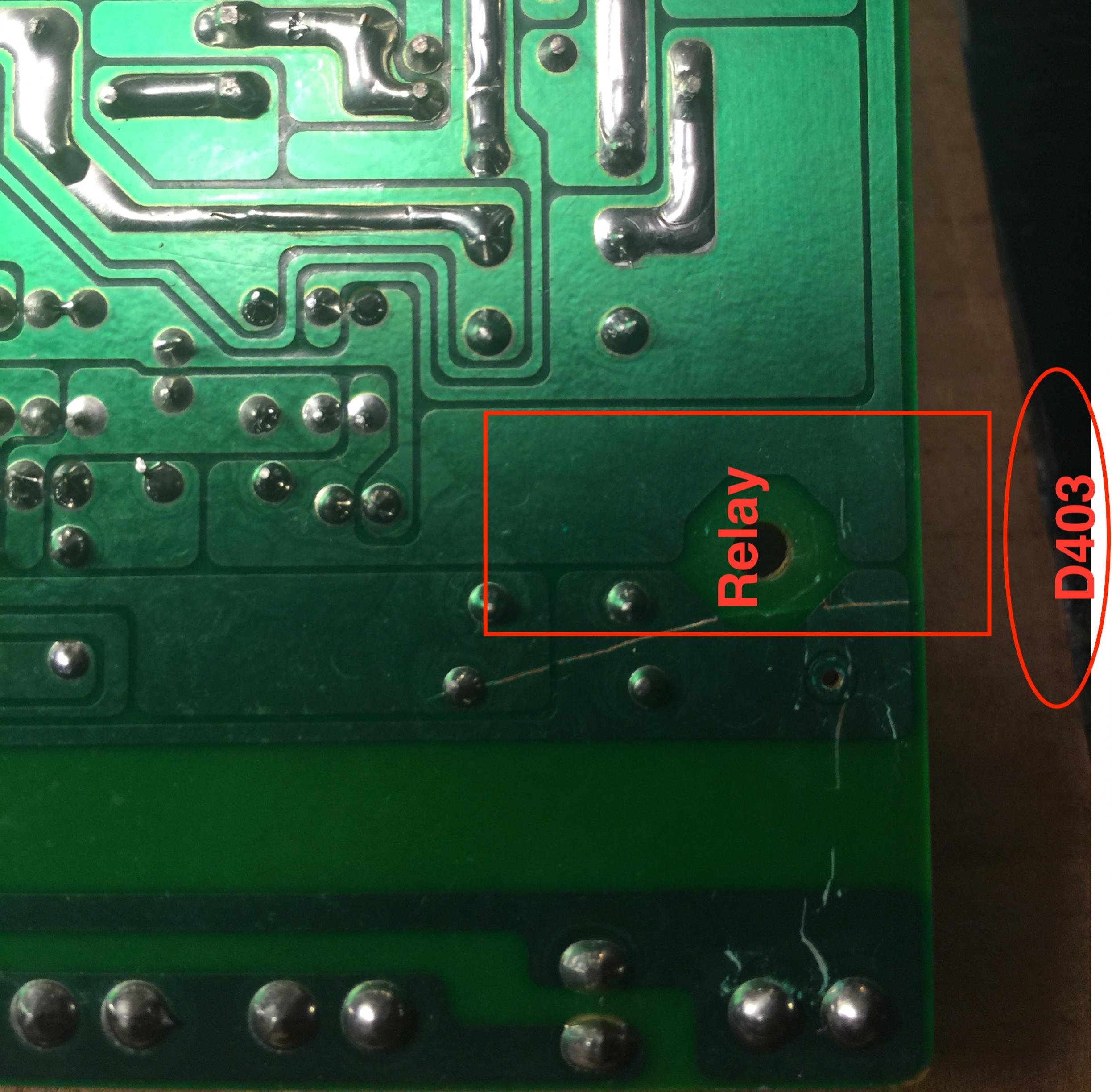

Ok now we're getting someplace. This is wrong.
D403 should have either the relay voltage (assuming 12volts) across it when energized or 0 volts across it when not. You've just measured 45. That you read almost the same voltage on both sides of R417, which is in series, confirms the relay coil is not drawing current. There might be multiple reasons for this...
Step 1 ... recheck your reading. See if you get 45 and 0 volts every time,
Step 2 ... Double check your solder work from when you replaced that relay. If you probe the solder points gently with a small metal tool (a meter probe will do) and it pulls in and starts working... clean off the bad connection and resolder it.
Step 3 ... Closely examine the foil traces on the board around the relay. Make sure none are lifted or broken.
Step 4 ... If that doesn't get it... You're going to have to pull that relay out of the board and get a reading across the coil with the Ohms scale on your meter. It should read no more than a couple of hundred ohms. If it reads open... you've probably found your problem.
Wiggled it with a chopstick in circuit and powered up. No joy. Solder work looks good. Pic attached.
Looking good. Same pic.

Edited to fix the formatting for quotes and add the pic. Also, the small scratch across the board seems to be from me dragging it across a standoff while removing.
About solder joints ...
When you solder something there is a risk that a little tunnel of flux is created between the component leg and the solder on the board foil. Essentially this will insulate the component from the board. This is your classic "cold solder joint". The reason we probe them with metal is that the tip of the probe (or a tiny screwdriver) will bridge the flux making the connection... telling us to solder more carefully next time.
They're easy enough to fix ... if you apply heat they will actually boil as the flux burns off.
For what it's worth... I've been at this over 30 years and I still make the occasional bad solder joint.

I still get 45V on one side of D403.![]()
If the circuit is in protection you should have 45 volts on both sides of D403. This would indicate no current flow, telling us the protection chip is not pulling it in.
The relay and the protection lights both operate from Pin 6 of the TA7313 chip. That the protection lights are back on tells us that you now have continuity through the relay coil.
Follow the circuit ... From pin 6 of the TA7313 to the bottom of the relay coil... also to R423, Q402 and off to J8, pin 1, which leads to the display panel. In the display panel it goes from J8, to a couple of diodes that trigger the leds.
The bulk voltage on pin 6 of the chip is triggering Q402 to turn on the leds. So it seems a safe bet that is now fixed.
