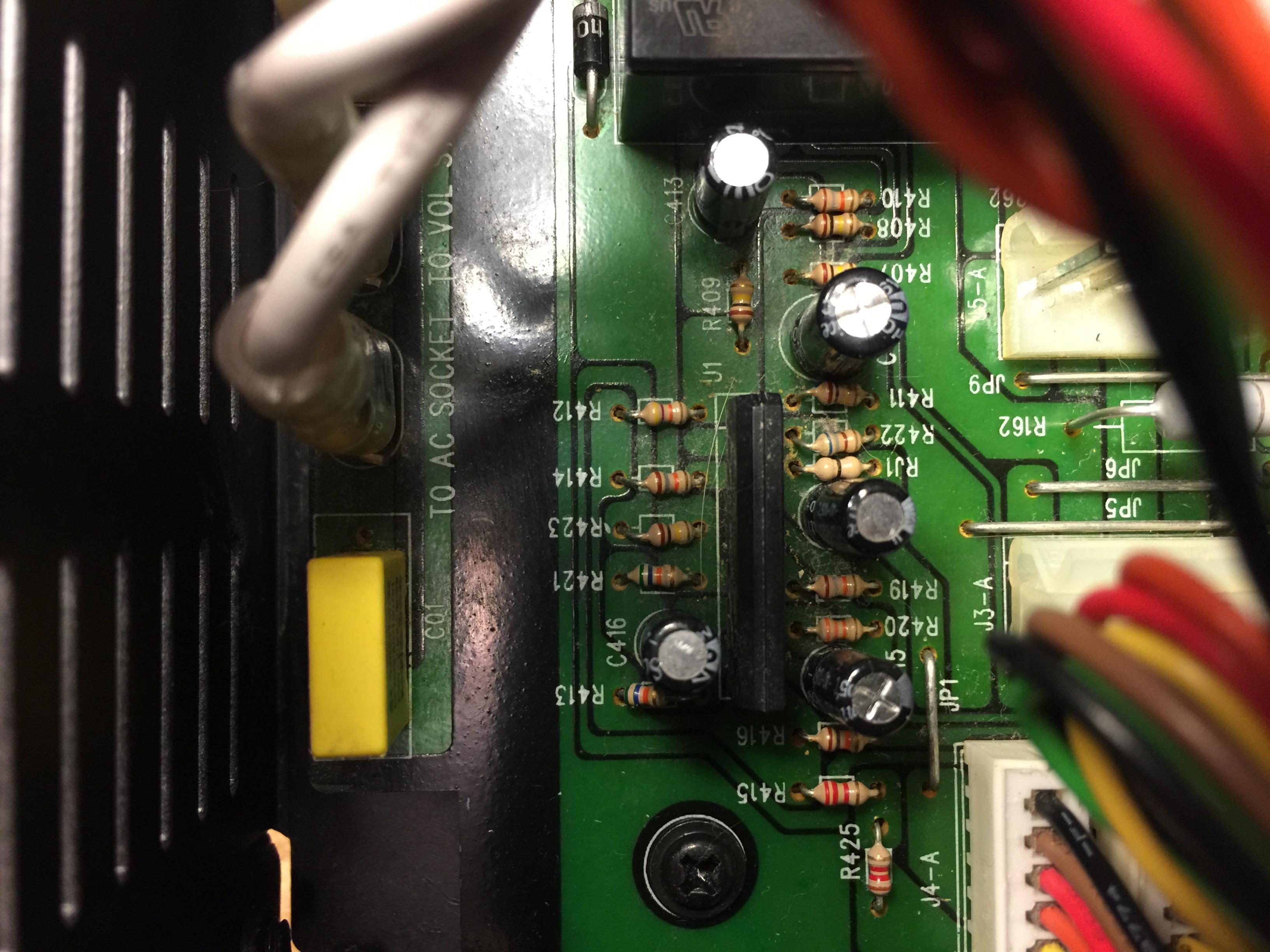

In the interim - I have researched U1 - the Toshiba TA7313P.
It seems I can get them on e-Bay for a reasonable price. From what I've gathered, replacing that little bugger may be the next logical step.
I can't make heads or tails of how to test the part in situ. Is that possible / practical?

A few things to check on the TA3717...
Pin 6 is your relay drive... it should be nearly 0 volts when the relay is energized. The easiest place to check this is probably right at the relay coil or on the cathode of D403. If this pin is low, the amp is not in protection. If it is high we need to dig a little deeper.
Other possibilities are that R417 is burnt. If it was you would see 0 volts on both sides of the relay coil.
In the event that pin 6 of the protection chip is not low, we would need to investigate it's inputs to see which one is triggering protection and why.
Given that the service manual does not specify the bulk voltages, I'm going out on a limb so say they look alright.

Discoloration like that is a sign of heat.... rather a lot of heat actually. Something pretty bad happened there.
I would take that board out... <SNIP>
Interesting. I just assumed liquid. Wow, yeah, heat was spread out over the area. I'm having a tough time imagining what would get the board that hot.

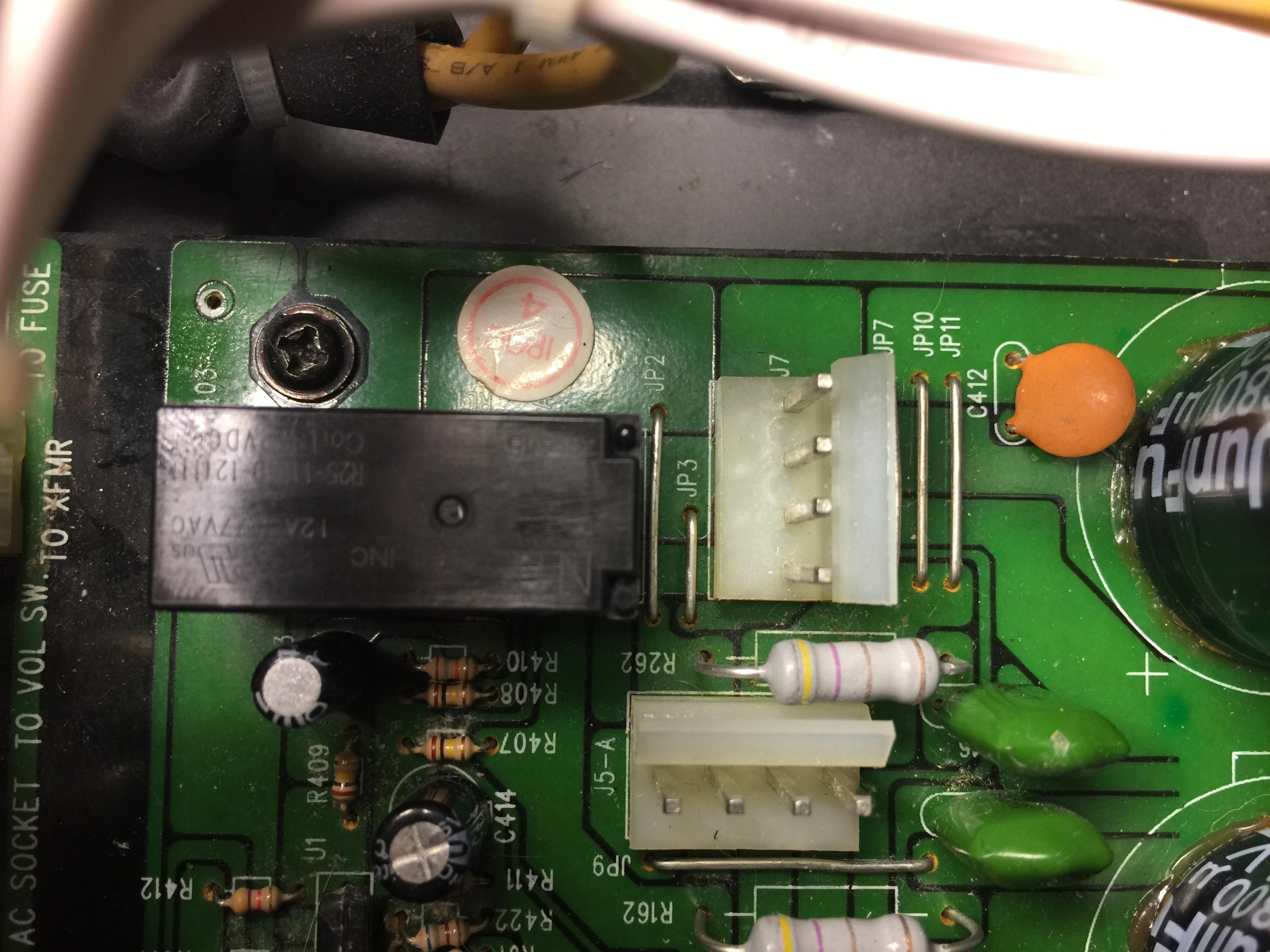

Pics attached of J7 / Relay area and TOSHIBA TA7313P area.

You can access them directly from the relay itself or from Pin 3 of J3 (left) and pin 3 of J5(right). Just push a probe (or stiff wire) into the plug next to the pin. The manual says it's a brown wire... should give you what you need to know.

It's a bit hard to tell from the photo but it looks like there might have been some heat/liquid damage in that part of the board as well.

Also, I think found the source of the heat in the discolored section of the board. R401 and R402 got very hot to the touch. I know this can be common, but they're very toasty.

So next step... lets verify that the relay is not being told to energize... Lets follow the chain of R416, R417 and D403 ... If the circuit is trying to energize the relay you should get bulk voltage going into R416, something less going into R417, about 12 volts on one side of D403 and nearly 0 on the other side... If it is not trying to pull the relay in, you will get nearly the bulk supply all along that chain. So lets see what we get from that...
I admit I need to digest this, so bear with me. I just learned "across" (measure across) vs. "at" (measure to ground) not too long ago.
Across R416: ~41V7____ Leg 1 to GND: 3V2_____Leg 2 to GND: -45V1
Across R417: 0V0_____Leg 1 to GND: 45V2_____Leg 2 to GND: 45V2
D403: Leg1 (Cathode/Stripe side) to GND - 45V1 Leg 2 to ground ~7mV
So... nearly zero on one side... check. But 45 on the other... not so much.
Okay, the low DC voltage proves the problem is in the protection circuit itself, not the rest of the amp.My error was the misunderstanding re: that measuring from R207 and R208 to speaker ground was not the same (in effect) as measuring from the inductors that @JonSnellElectric had recommended. We took those measurements and found 0VDC offset.

I don't understand TA7317 & I don't really want to. It is not likely to fail.
Measuring relay coil resistance from the pads on the board proves you soldered it correctly. Should about 400-700 ohms on diode scale (or volts actually) with plus on diode not-line, minus on diode line. Some thousand ohms or so the other way.
You can also measure volts on relay with power on. Should be near the coil voltage rating printed on the top of the relay for the relay to pick up and stop music flow. Near zero volts for relay to drop out and allow music flow.
If relay is soldered okay, too much DC is not coming into R407 & R408, something is wrong between A & B. Good enough for me. You may follow through detail analysis with Mr. Blake if you wish. I personally don't replace the "one bad e-cap", at 10 years or older age, I change them all. Start with the ones in the protection circuit since that is failing first.
If TA3717 is at center of the problem, a couple of zener diodes back to back, a resistor-capacitor network, and a transistor to drive the relay are my suggested replacement. Further details to follow if necessary.
