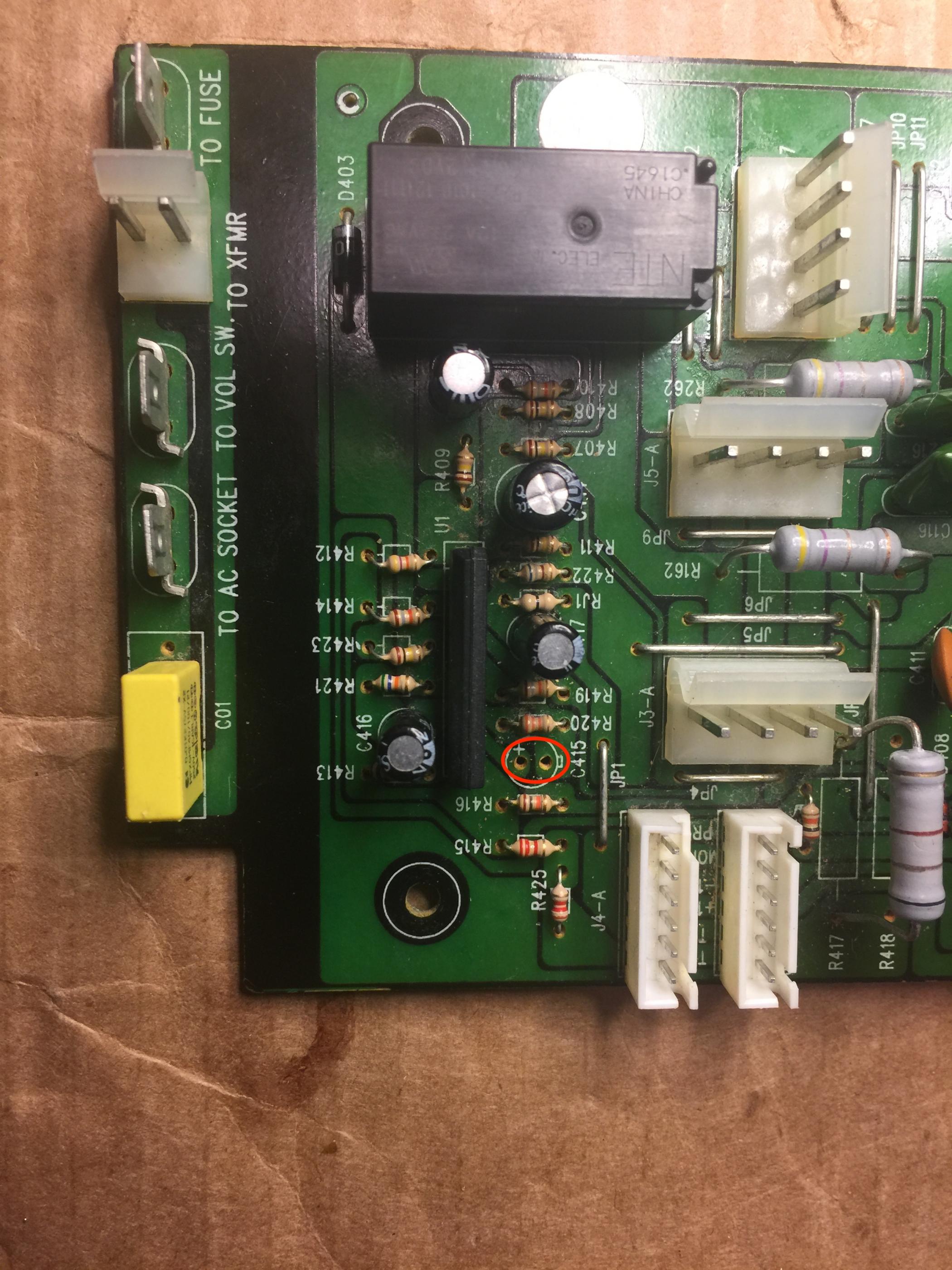

Thank you for looking that up. I did some additional measurements exactly as follows. All measurements taken with black probe to chassis ground and red probe to:
Pin 1 - Junction of U1 and R409, R412: (-)200mV
Pin 2 - Junction of U1 and R407, R411 and positive side of C414: 50mV
Pin 3 - Junction of U1 and R414: 596mV
Pin 4 - It joins the negative side of C414 through the trace, but I can'd find a suitable place to ensure continuity to GND on the top side of the board. If this is vital, I'll keep digging.
Pin 5 - Junction of U1 and R419: 0V75
Pin 6 - Junction of U1 and R423: 45V0
Pin 7 - Junction of U1 and R420 (-)0V75
Pin 8 - Junction of U1 and R413: 0V65
Pin 9 - Junction of U1 and R413 (opposite side of R413 to Pin 8): 3V2
So Pin 6...??

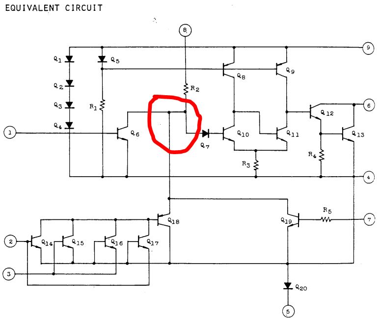

This is based on the TA7317 datasheet and schematics with marked voltages.
(Data sheet, such as it is, attached below)
The TA7317 protection chip is designed so that if everything is right, after a time delay, it pulls in a relay that connects amplifier outputs to speakers. It is intended to protect speakers by preventing DC offsets and turn on thumps from reaching them.
Power is on pin 9, ground is on pin 4 and pin 5 is connected to the chip's substrate.
Signals...
Power detect at pin 1
DC detect at pins 2 and 3
Relay driver at pin 6
Rapid turn off at pin 7
Turn on delay at pin 8
In operation...
pin 1 ... < 0.75 volts ... power detect
pin 2 ... >-1 <+1 volts ... DC detect
pin 3 ... >-1 <+1 volts ... DC detect
pin 4 ... 0 volts ... ground
pin 5 ... -0.8 volts ... chip substrate
pin 6 ... ~1.5 volts when on +Vbulk when off ... relay driver
pin 7 ... < 0.6 volts ... rapid turn off
pin 8 ... >+1.7 volts ... delay turn on cap.
pin 9 ... ~+3 volts .. chip power.
If pins 1, 2, 3, 7 and 8 are not biased correctly the relay will not energize.

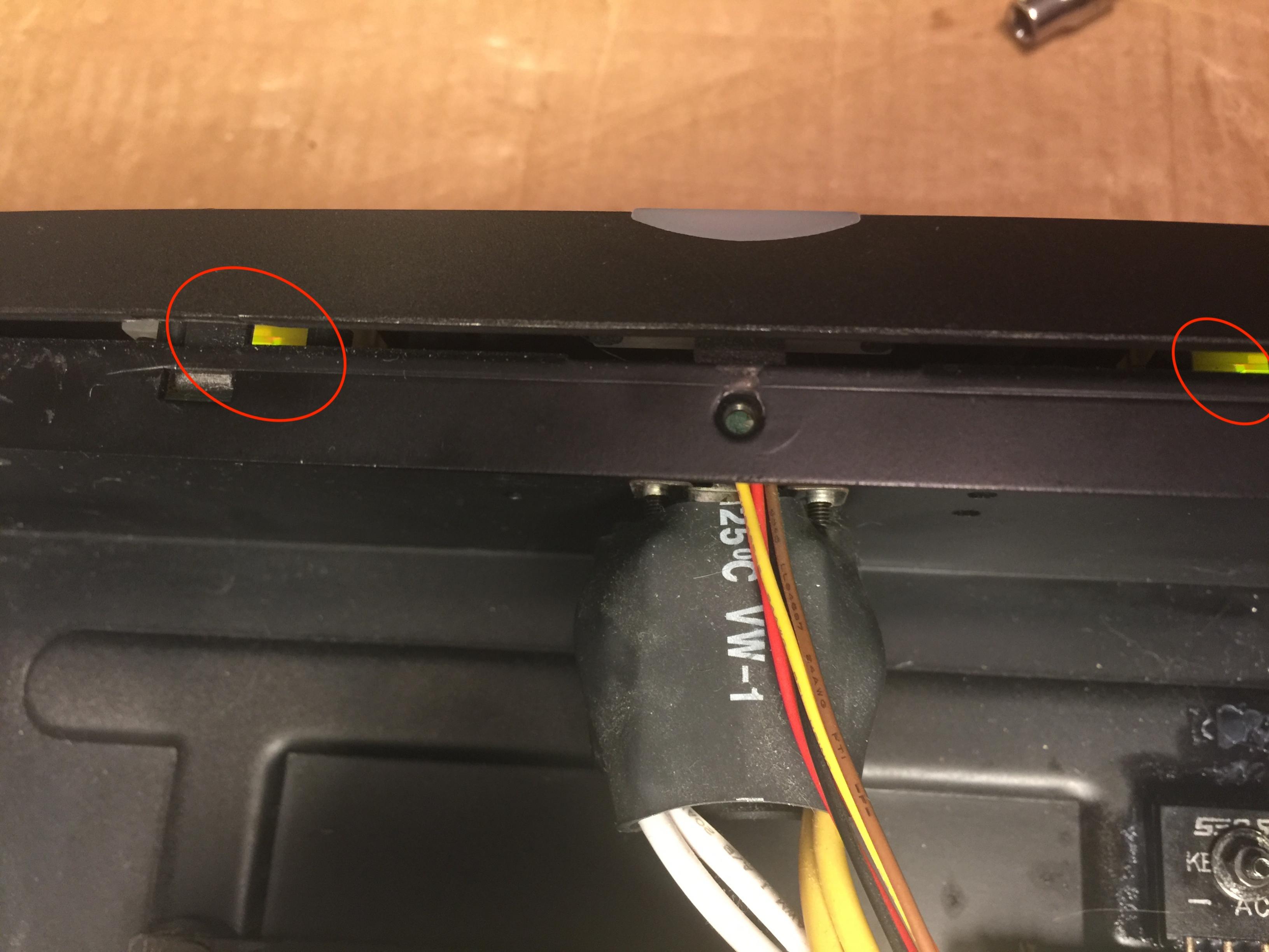

Now that we have continuity through the relay you can see that on the LEDS. They are fed by pin 6 of the TA7317 ... follow the schematic... Pin 6, to R423, to Q402 through J8 pin 1 to the lamp board then D310, D311, D350 and D351 to the leds.
So we have a visual test point for protection.

Pin 5 is concerning. Recheck your measurement to be sure.
If you look at the TA7317 data sheet you will see it is a substrate bias for the chip. It is connected via a diode (Q20) to the internal circuit ground (pin 4) and pulled down by R419 to the negative bulk voltage... thus it should be reading about -0.8 volts, not +0.75. This could indicate that the chip is not properly grounded (pin 4).
Also looking at the chip internal schematic we can see that Pins 2 and 3 both go through a series of switching transistors, leading to the protection triggers. Now these transistors are biased against ground (pin 4) so if the internal ground were offset from actual ground, it could falsely trigger the chip into protection... and the offset you read on pin 5 would seem to indicate that the internal ground is indeed floating.
So the next thing to try is to remove that chip --very carefully-- clean up the leads, clean up the solder pads on the board then check the land for pin 4 for continuity to ground.
If you have continuity, you likely had a bad solder point, so you can reinstall the chip and see what happens.
If you don't have continuity, you need to start following the traces and find out why.

Pin 8 0.65? Supposed to be 1.7? delay turn on to amp?
Held low by the protection triggers.
If OP lifts one leg of C415, pin 8 should pull right up to higher voltage, unless transistor from pin 1 in U1 holds it down internally.what are his choices?
Proves problem is C415, or other. C415 is a $.20 part available newark,digikey,mouser,alliedelec.
I'd build 2 peavey type overload detect/relay driver circuits (7 parts/channel) before I gave a counterfeiter money for TA7317.

Take a look at the data sheet for the TA7317 ...
The inputs at pins 1, 2 and 3, all connect to the internal resistor for the timing capacitor. When triggered they will hold it at a low voltage, as we are seeing. The capacitor won't charge until the fault is removed.

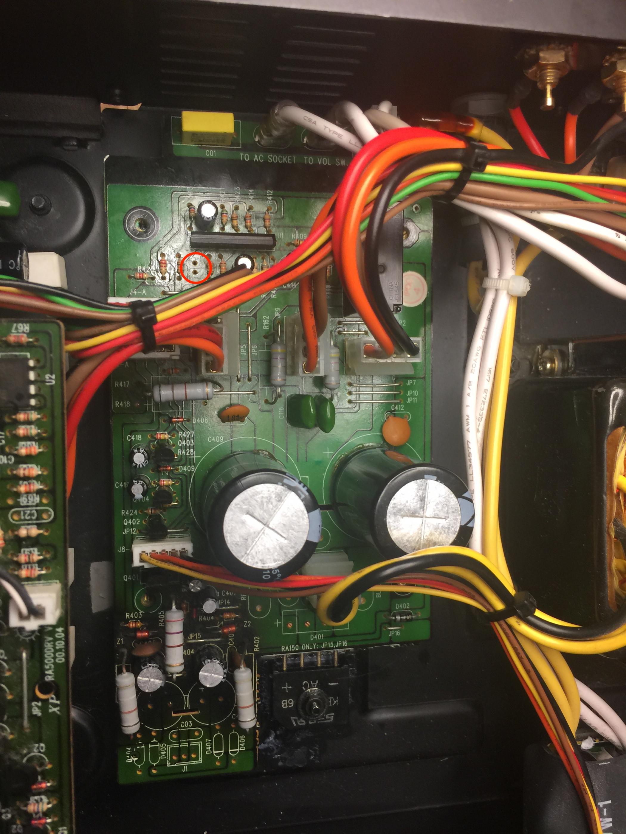

Good morning,
Great conversation. Thanks to all for continuing while I stuffed my face and made merry. I had a day off (well most of it anyway) from hobbies. Back at it.
I've read and re-read the previous posts. I believe I understand the concerns. Let's first start with confirming my measurements (or not). 😀 I know very well that my measurement technique is sketchy at best. So I took measurements at the same points to try and ensure reliability.
This morning, the amp is in the same condition, but has not been on for more than 5 mins. Fresh start up vs. previously the amp had been on for at least 30mins prior to measurements. I marked in red what I think may be meaningful changes.

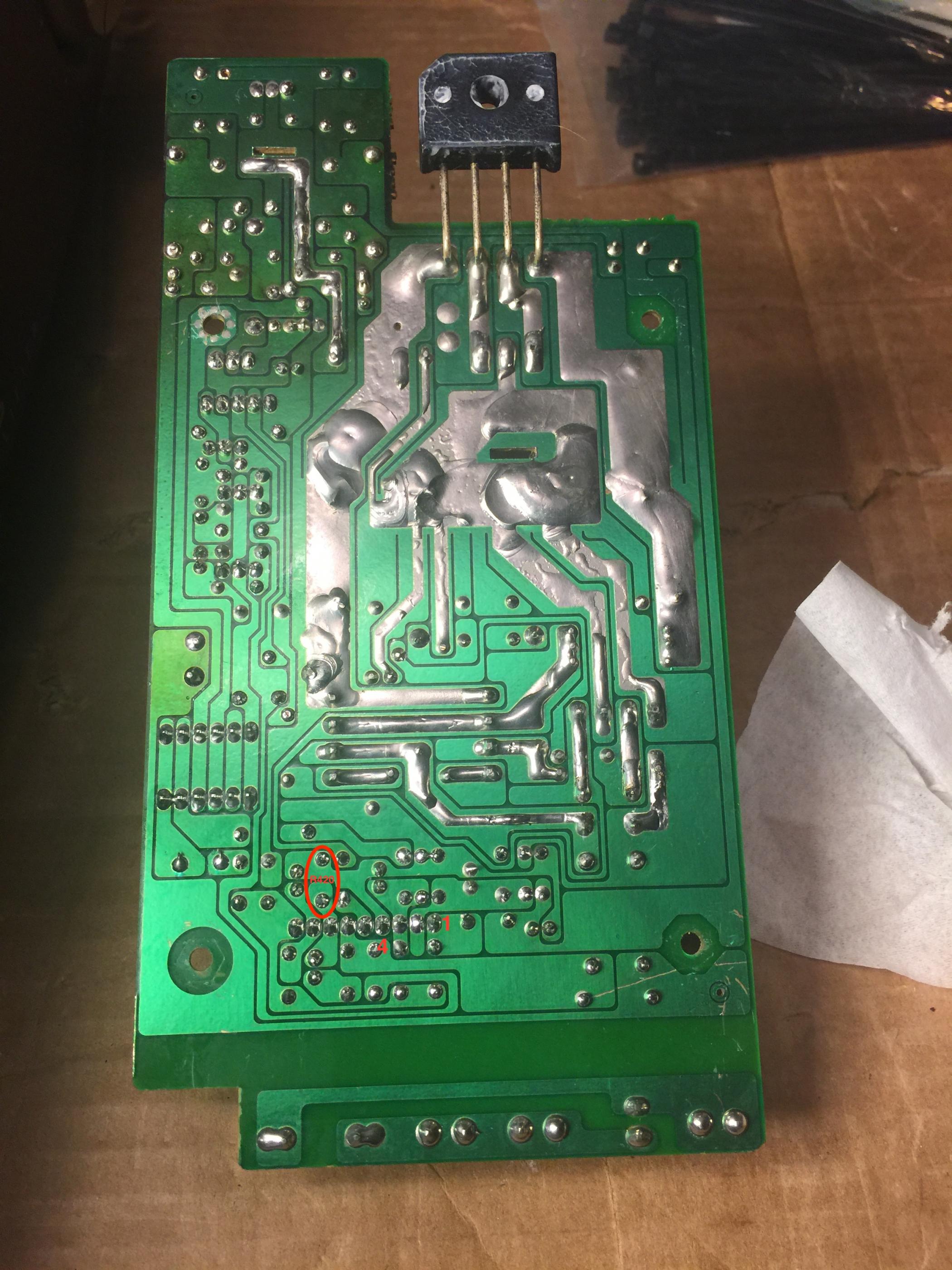

Just to be doubly sure of measurements / polarity, although it may not be the "best" method, I alligator clipped the black probe to the bolt on chassis ground and then moved the red probe to the appropriate spot. I was very careful yesterday, but pin 5 seems to have reversed, and now I have no voltage on pin 7. We're also about 500mV lower on Pin 8. If that's seemingly impossible or highly improbable, then I'd have to chalk it up to my measurements yesterday even though my attempt was to be meticulous.

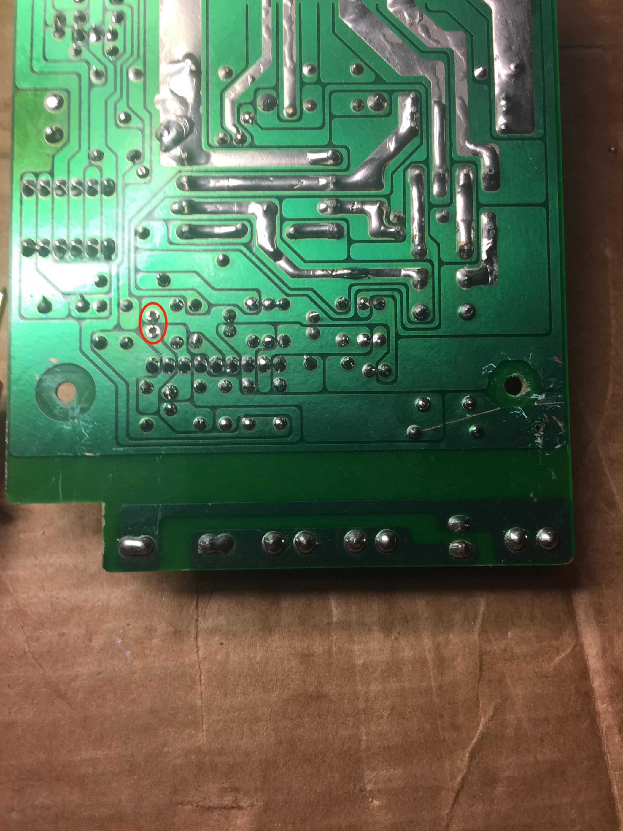

Next step is that I'll reflow all the pins (again) on U1. I'll take a look at the schematic and find a few points re: continuity to ground along the traces. I completely understand that until I get the pins separated from the solder, I won't know if the actual pin has continuity to gnd, but after a nice double re-flow, I'd feel better. I am certainly willing to desolder the chip if needed. Thankfully, I have a decent amount of experience, and if needed I have a Hakko desoldering thingamabob that makes short work of multipin parts on motherboards etc. This board being single-sided, just a bit of wick (didn't even use the sucker) had the relay falling out of the board both times. I do appreciate the concerns though.
I'll report back after another touch-up, reflow and a scan of the board for continuity to ground.

A good reference point to measure voltages on U1 is pin 2 of J2. Also the common point of C409 & C410.
If you can measure from IC side of pin 4 U1 to that point, you could test Mr Blake's theory that pin is not soldered. If measurable voltage, that is different from zero that is should be. Use grabber.
If you do as post 68 lift one pin of C415 then check if protection light goes out, you could test my theory that it is leaky.
If you destroy U1 I'm shutting up. It is not a relay and excessive heat may damage the die.

OK - Fun stuff (for me anyway). When I had the board out and flipped over, I ran the trace from the IC side of pin 4 on U1 to its next closest junction. It hits the same area of the board as one side of R420. The schematic also shows one side of R420 going to GND.
(Pics attached). I checked continuity from (technically the solder) of Pin 4 to R420. It is good.

2) I removed C415 and replaced the board. The amp is still in protection. Are there any valuable measurements on the board to be taken while it's out? I don't have an ESR meter, but my DMM is showing 95uF for the cap.
Truly appreciate both of you working through this... time for more coffee (and maybe more pie)...
Pics:
Back traces
C415 out - no bridges 😀
Top Side - C415 out
Board back in
Protection 😕
I put the board back in and measured from the proper leg of R420 to GND.
1) Leg of R420 (GND side NOT Pin 7 side): -1.7mV. I also just did a quick continuity check in situ - continuity from leg of R420 to chassis ground. Good continuity in circuit. So, I am absolutely not disregarding the possibility of pin 4 itself not being properly soldered. However, I'll hold off on removing U1 at this point... I'll come back to it after we run through the last readings etc.
Pics:
Back traces
Top Side - C415 out
Board back in
Protection 😕

Let me explain one more time how this protection chip works...
When the amp's power is off ... the relay is in it's off position and the speakers are not connected to the amp.
When you turn power on the bulk supply begins rising and can take several seconds to settle in. Also while the bulk supply is unstable the amplifiers are unstable, This is when you will get a turn on thump which can damage speakers.
The input on pin 1 is used to sense a bad negative supply and needs to settle in.
The input on pin 2 is used to sense DC offsets and very low frequency instability and needs to settle in.
The input on pin 3 is used to monitor the thermistors for thermal protection and needs to settle in.
Now once everything is right ... Pins 1, 2 and 3 all sitting at nearly 0 volts... the hold offs will be released, pin 8 goes to an input state, the external capacitor begins charging.
After a delay of a few seconds, the capacitor charges enough to trigger the internal relay driver and pulls the relay in, connecting the amplifier to the speakers.
It HAS to be this way... unless you want to listen to a canon shot from your speakers every time you turn it on.
YES... that relay is pulled in all the time the amp is playing music. Relays can remain in the active state for years with no ill effects.
Now should something go wrong...
If the power supply fails, either by power loss at Pin 9 or by sensing the negative supply on pin 1, the relay drops out and the protection lights come on.
If there is a DC offset on pin 2 the relay drops out and the protection lights come on.
If there is a thermal problem with one of the amplifiers Pin 3 would trigger the relay drops and the protection lights come on.
