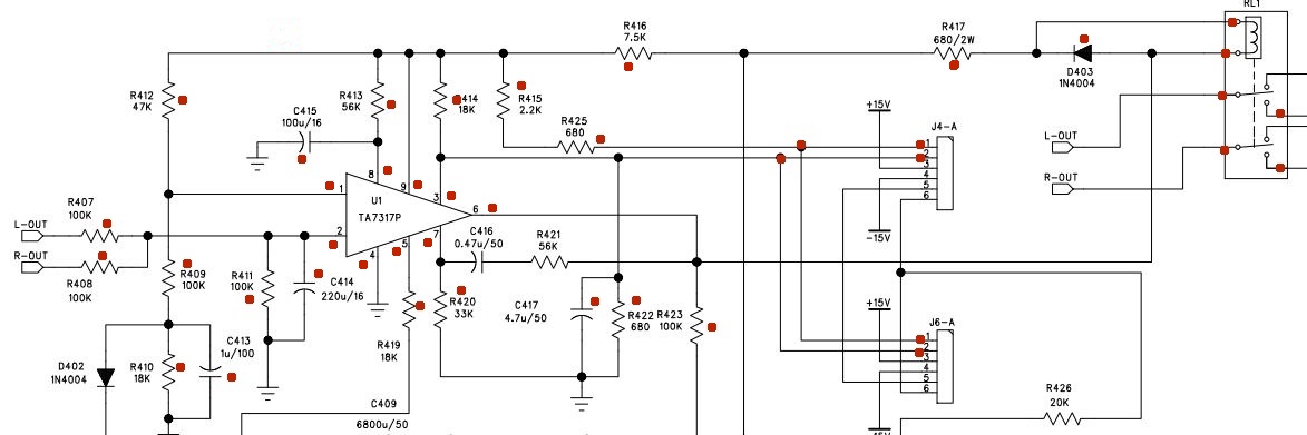

This has to be a bad connection...
First of all, the instant those lights go out the relay should pull in.
Second if probing it changed it's behaviour it is almost certain to be a bad connection.
Now ... for each of the parts I marked with a red dot. You need to check the solder work, with a magnifying glass, and resolder any that look even remotely suspicious.
Realy cook them down... apply heat and stay on them for a few seconds each. If any of the boil or smoke, remove the old solder and resolder the connection.
When done, clean the board with alcohol to remove any trace of flux and look at them again...
We can't get a good diagnosis with bad connections... and, in fact the whole problem might well have been a bad connection from the beginning (eg R417)

At this point, I think I would get that board completely out of the amplifier, flip it upside down, reheat every last solder point, add a bit of fresh solder and let it cook for a couple of seconds.
This should be a simple diagnosis... find which of the three protections is triggering the chip and fix it... but it's behaviour keeps changing. Until it is consistantly fixed or consistently bad, it's going to be almost impossible to diagnose... especially by remote control.
When you get it back together, let me know what it does...
While you were typing that, I had the board out.
I first cleaned the board.
Then, I examined it under the loupe with my readers. I didn't see anything of concern.
I went point by point from top to bottom of the board - applied a tad of flux, and reflowed each joint with a touch of new solder. Holding to ensure proper flow and contact.
Cleaned the board - ridiculously thoroughly - and reinstalled the board.
Popped the board back in.... Protection lights.
Re-checked per above.
Pin 1: (-)68mV
Pin 2: (-)1.2mV
Pin 3: 346mV
Re-ran the shorts to ground.
Pin 1 - Very slight delay to turn off. Immediately back on
Pin 2 - Protection LEDs stay on and remain on. No blinking.
Pin 3 - Protection LEDs stay on and remain on.
I can't be sure if I've affected a change with cleaning / touching things up and/or if the amp just has not warmed back up. I'm going to let it sit for an hour and see if the LEDs remain lit. If they are, then I'll re-run the pin checks to see if anything has changed.

When I left the amp after literally poking it with a stick... Protection LEDs were lit.
One hour after firing it back up (post reflow and clean) - I went back to check on it.
Protection LEDs out.
No DC
R417 - 0V0 Across. 45V1 legs to GND
D403 Anode - 833mV
D403 Cathode - 44V1
Pin 1 - Junction of U1 and R409, R412: (-)247mV Still does not seem steady
Pin 2 - Junction of U1 and R407, R411 and positive side of C414: (-0.8mV)
Pin 3 - Junction of U1 and R414: 345mV
Pin 4 - Assume it's got solid continuity to GND
Pin 5 - Junction of U1 and R419: (-)0V73
Pin 6 - Junction of U1 and R423: 0V833
Pin 7 - Junction of U1 and R420: (-)0.08mV
Pin 8 - Junction of U1 and R413: 1V37 Still does not seem steady
Pin 9 - Junction of U1 and R413 (opposite side of R413 to Pin 8): 3V2
Pin 6 seems to swing a lot based on whether we have LEDs on or off....
I know the test is supposed to be done starting with LEDs on, but why not...
Short to GND
Pin 1 - LEDs stay off
Pin 2 - LEDs stay off
Pin 3 - LEDs stay off
This thing is possessed. Short of just swapping out all the passives... I have no clue whatsoever.

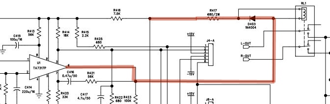

Randomly changing parts is the desperate act of a failed technician.
It's not possessed ... it's broken. Our job is to figure out why and fix it. We do this by a combination of things... We follow the schematic to understand the circuitry, we take measurements to determine what state that circuitry is in... then, when we isolate a fault we do a repair. The task is straight forward and logical.
Right now we have an amplifier that does come out of protection. That it takes too long is irrelevant... it does try to work. The protection leds switch off but the relay is not pulling in... That is the immediate problem... why is that relay not pulling in?
Forget everything else, get focused on that one problem...
Lets follow the schematic... R417 is connected in series with the relay coil so we know that whatever current passes through one should be passing through the other. Now we can use Ohm's law to figure out what those voltages should be...
R417 is 680 ohms.
The relay measured at 368 ohms.
From message#55...
Ohms law says that we should be seeing...
680 ohms for R417 + 368 ohms for the coil ... so 45/ (680 + 368) == 45/1048 == ~43ma of current.
Thus R417 should have 680 X .043 == ~29.4 volts across it
So one leg should read the bulk supply and the other should read 45 - 29 == 16 volts.
thus D403 should read 16 volts on one leg and nearly 0 on the other.
D403 is not of concern, it is simply an easy way to access the relay coil from the top of the board.
Now... with the protection leds finally off ... we can measure the voltage to ground on both sides of D403 ... we should expect about 14 or 15 volts on the cathode and about 2 volts on the anode.
Per your last set of readings you had 45 volts on the anode and almost nothing on the cathode ... that is too high... Now the whole thing collapses into one simple question.... Why is it too high? ... for the moment that is what we care about.
Again look at the schematic... When you probe D403 you are, in effect, reading the voltage across the relay coil. The only reasons it is too high is that the relay coil is either not connected or burned out. Given that you took two relays out of there that both had good coils in them... I'm pulling toward "not connected" and since it's right on the board... that tells me "bad solder".
So that's where we are ... we have an amp that does come out of protection, albeit slowly but does not energize the relay. We need to fix that before we move on...
Remove the solder from the relay coil contacts... heat it up real good, add some new solder and cook it down real good after.
Now... put a piece of cardboard over the standoffs supporting that power supply board so there's no risk of shorts... fire the thing up, wait for the lights to go out and tell me what happens.
No readings, no probing things with sticks... just turn it on and observe it's behaviour...

@Douglas Blake - you have the patience of Job. I have no way to properly convey my appreciation.
Just so I'm sure. I need to wait for the protection LEDs to extinguish prior to doing the checks you've mentioned, correct? What is perplexing me (and having me jokingly call the amp "possessed" is that the LEDs come on when the amp is "cool" and then cut off after some period of time. My speculation is either parts finally getting the voltage they need (or reducing to a correct point) and/or heat stressing a part.

Should I leave in the 10k resistor or remove?
I would leave it there ... it holds the protection lights on in case of another relay failure so it's a good indication that the relay has failed again.
Power ... protection ... lights out... no sound ... probably the relay.
OK - last question before moving things back. I've removed the solder from the relay pins. Re-checked resistance across the relay pins - 358 Ohms. Re-soldered.

Amp is fired back up with fresh and gorgeous solder on the relay pins.
Protection LEDs immediately light.
I will let it sit until the "lights go out". They will eventually based on previous behaviour.
Hopefully when they do, the relay will kick in when they go out. Must.... resist.... taking.... measurements...
Oh - OK - thank you. I just wanted to be sure. I remounted it - may as well remove that variable.
Yep... wait it out.
At this point you could probably put some music through it... at a low level, with a pair of old speakers. You would not be trapped there waiting, you could just listen for the music to start.
If the lights don't go out ... then we take some measurements.
