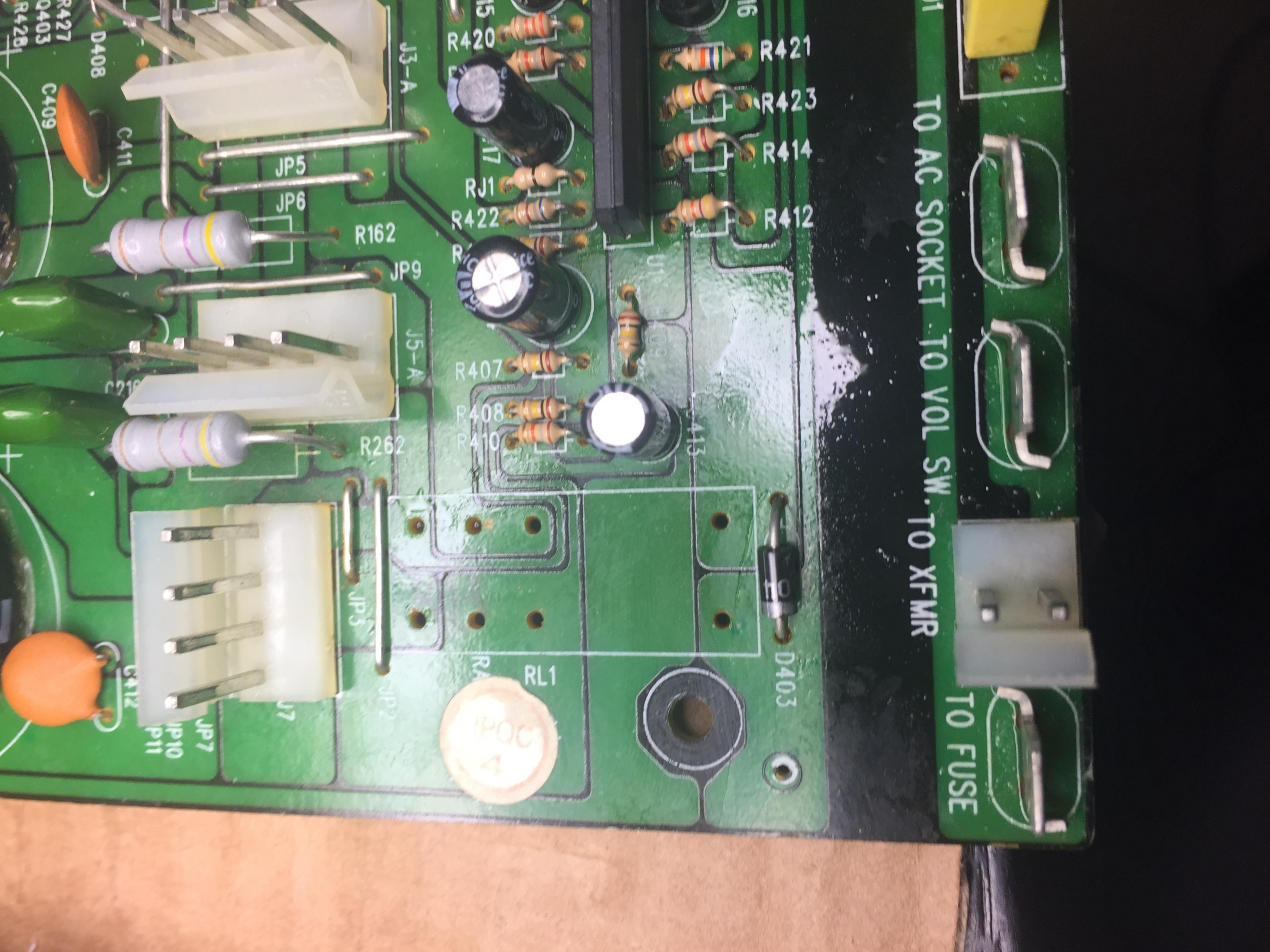

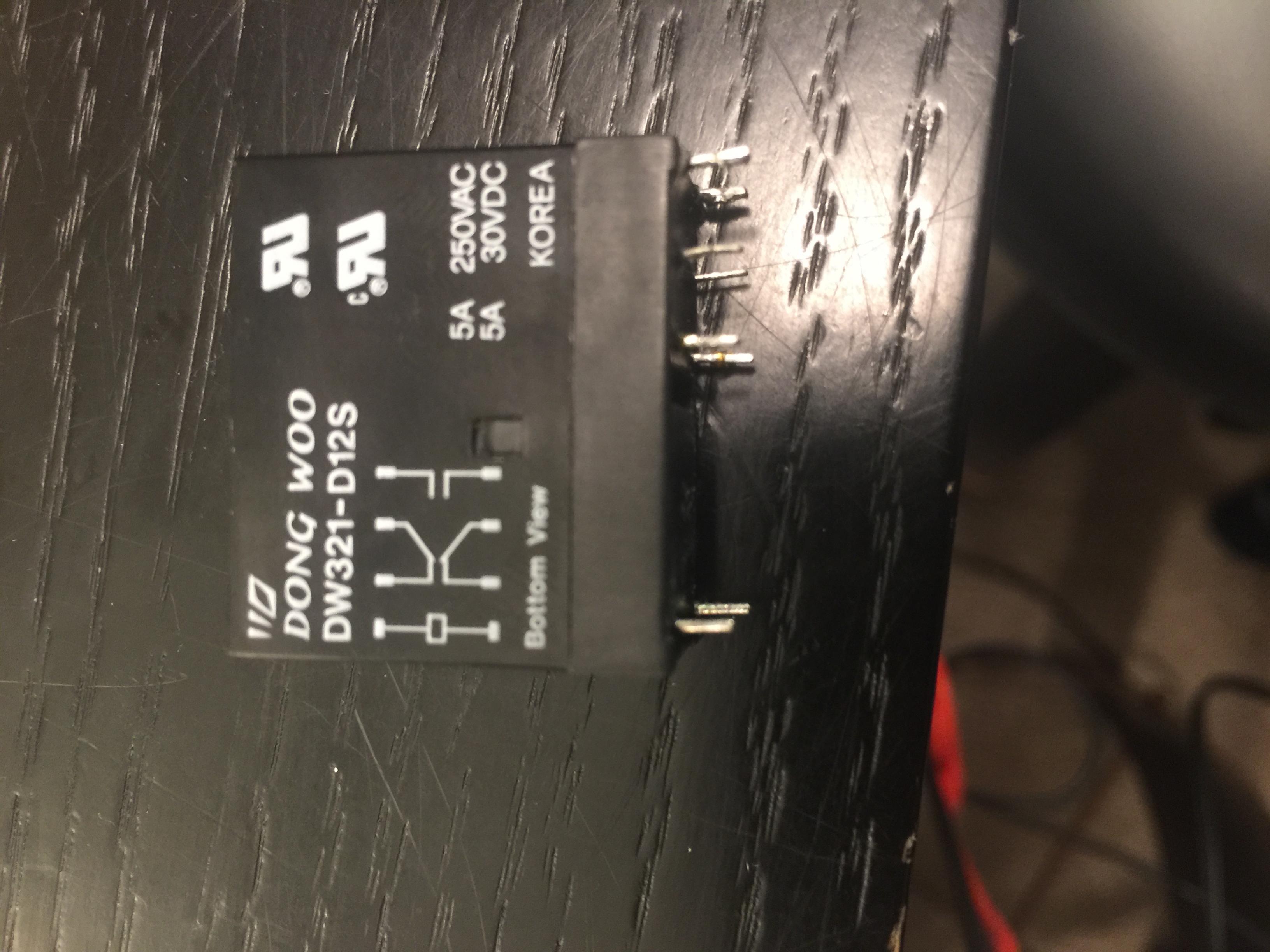

Pics are worth 1000 words. Maybe there's something physical I haven't caught.
Removal Top Side
Removal Bottom Side
Relay layout from side of original relay
Back in Top
Back in Bottom

Removal Top Side
![IMG_1641.jpg IMG_1641.jpg](https://www.diyaudio.com/community/data/attachments/723/723861-489b6d1504dec690439d6adaf6b33871.jpg)
Removal Bottom Side
![IMG_1642.jpg IMG_1642.jpg](https://www.diyaudio.com/community/data/attachments/723/723883-ccbabfc50078e3c79bb3d9fd776023cb.jpg)
![IMG_1643.jpg IMG_1643.jpg](https://www.diyaudio.com/community/data/attachments/723/723902-55206ad4ec4bf195196342563323158d.jpg)
Back in Top
![IMG_1644.jpg IMG_1644.jpg](https://www.diyaudio.com/community/data/attachments/723/723920-1131d87b3c82117483b53c9c7b63ccc8.jpg)
Back in Bottom
![IMG_1645.jpg IMG_1645.jpg](https://www.diyaudio.com/community/data/attachments/723/723941-12e1b86f4710b7c491f77cd78cb9a974.jpg)

All that green traces on top with black lines around it. Looks like the top side of the CRT monitor I'm working on.
It looks like the top side is painted green with the trace outlines of the bottom side of the board painted on top. Single sided board. The jumper wires on the board point to single sided as well.
Alrighty - Out with the new; in with the old. Just from moving the board around on the standoffs, it's getting a few scrapes, but we don't have continuity anywhere we shouldn't.

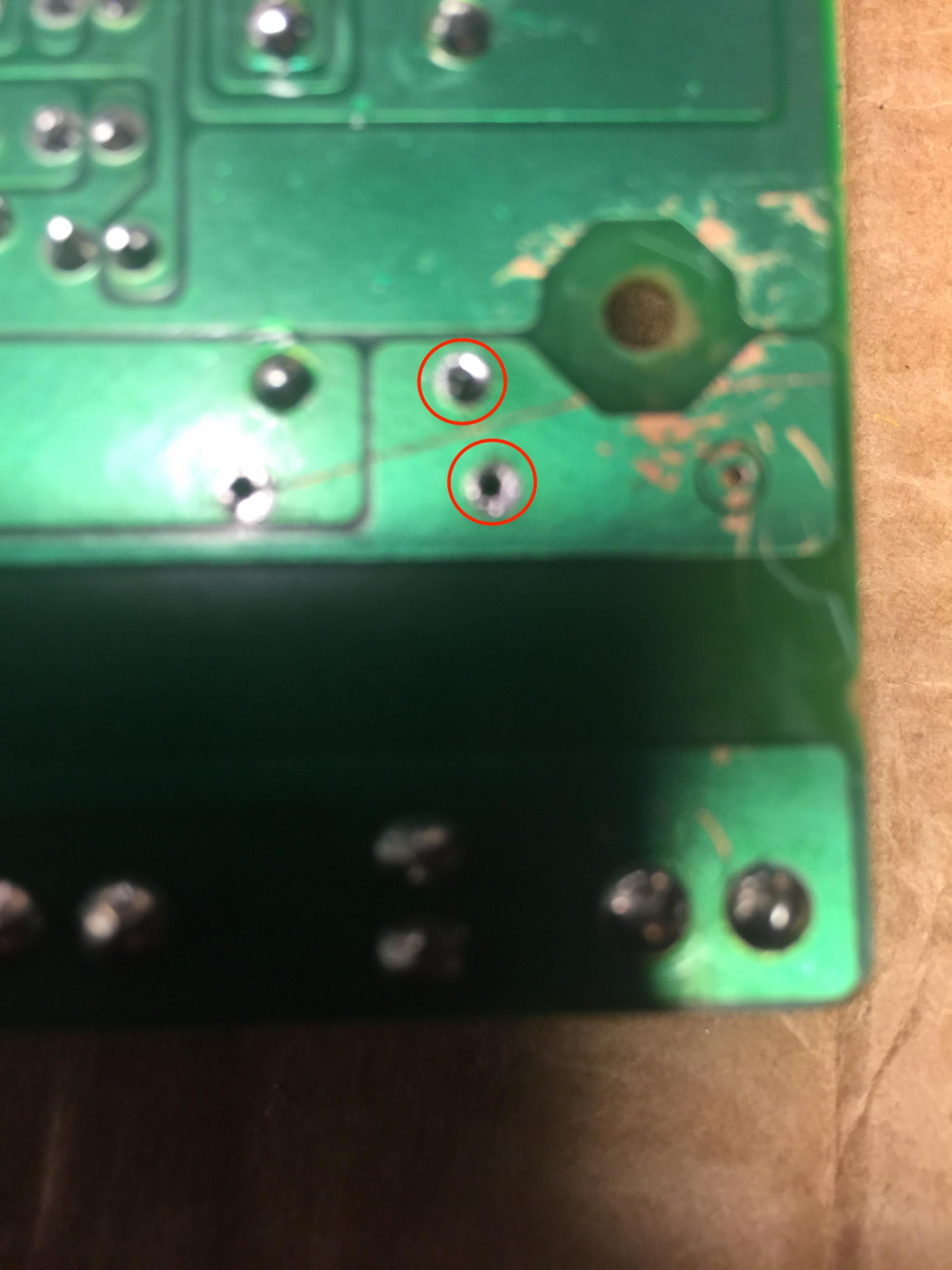

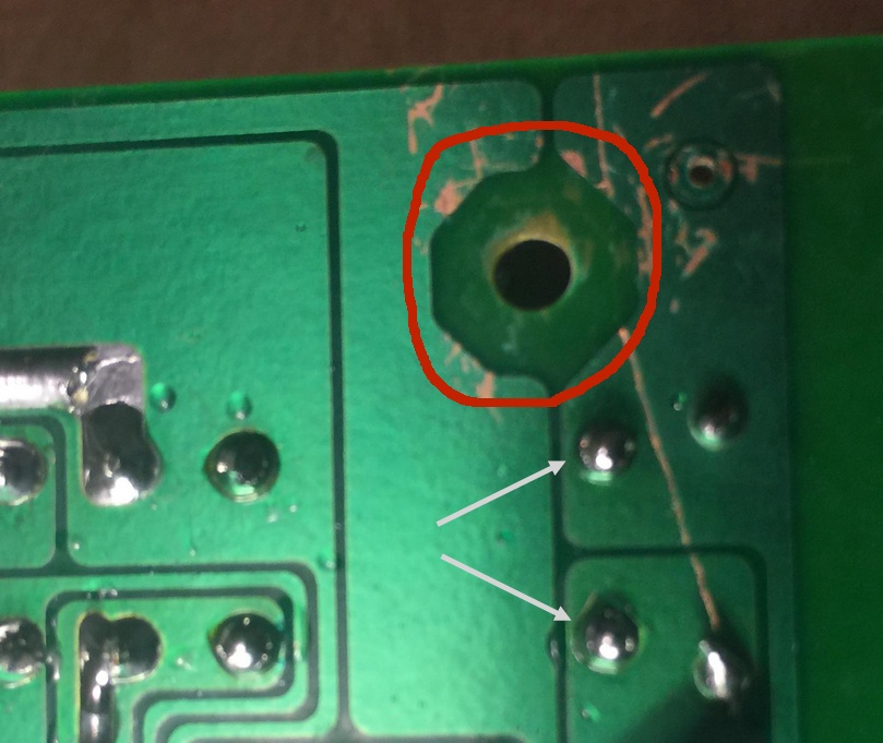

I just spotted this ... Want to see an example of bad design... here it is...
Take a look at the relay coil contacts, indicated by the arrows. The foil for the top one wraps right around a mounting point for the board. Neither side of that coil is grounded. Judging by the scratches it sits on a metal standoff ... a dead short, waiting to happen.
Don't know what the trace on the opposite side of the hole is, but it's at risk too!
I strongly recommend either adding a fibre washer to that mounting point or replacing the stand-off with a plastic one. (maybe others too...)
Although the enlarged section of the photo is not very clear, I would recommend reflowing those two solder points, with a fair bit more heat applied and more solder. They don't look like good joints to me.
I agree ... it looks like single sided board. I see no evidence of plate through or vias anywhere.
OK - I admit that I "went rogue". I'm an Occam's razor kinda guy, so I was looking for a simple solution. Everyone has been exceptionally helpful. Douglas, whatever your favorite beverage of choice might be, if I ever run into you (or can send something to you), it's yours.
Anyway... One thing that (I think) I know how to do is check for proper continuity, check for dead shorts etc.
So here is what I have done so far. No flogging for effort (even if it's misguided).
We want the relay to engage. So, after fiddling (yes, again) and wiggling things before removing the board I found an intermittent connection at J2 due to the pins in the plastic connector on the transformer side. I don't think this is related to the core issue at hand, but I can't disregard it related to the intermittent appearance of the LEDs. I did my best to snug all the wires and their connections tightly back into the housing. The board-side connection and its pins seems solid. It was the side running to the transformer. The symptom appeared when I wanted to test the theory around the dead short of the mounting hole near the relay. I simply took all the screws out and lifted the board. The protection lights went away, then flickered. I traced it to J2. Wiggling J2 caused the LEDs to flicker on and off. No dead short at that mounting hole, but I'll also try the nylon washer when I remount it.
Onto the "rogue" part. I took my trusty 9 volt and put it across the solder joints on the relay coil. "Click". To me, that meant that we had a solid connection from solder to pads, to pins, to board, to other side. But, just for good measure, I removed all the solder again, cleaned the pads, and re-soldered the joints. 9V and lovely "click". Now, in fairness, I recognize that this isn't under current, but it was the best I could think to do to test it in situ.
So, I started doing what I always do... tracing the circuit. I ran the 9V leads to all adjoining points on the same (not sure what the correct term is) copper planes. Better than the beep from a DMM for continuity is the solid "click" from a relay snapping.
I did a number of checks from the direct relay points, then I moved to the pads on D403. Here's something maybe interesting.

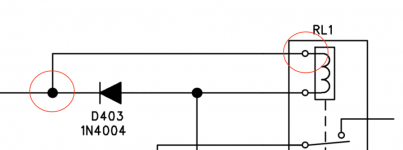

See schematic and picture below.
These two points do not have continuity. I think they're supposed to. I originally thought it may be due to a bad solder joint on D403, so I removed the part with the intention of cleaning the legs etc. and fully cleaning the joint. Even after removing the part, there is still no continuity between these pads. I even removed the solder again from that side of the relay to check "pad to pad".
Am I onto something, or am I fundamentally mistaken that there should be continuity here? It makes sense on the board, and it shows a direct connection in the schematic.
Is it unwise to run a small wire between these points and test? For the life of me, I can't figure out why there's no continuity. The relay pad has continuity to the "scratch", and so does the pad for D403, but no continuity between them.
I'm currently going with the simplest explanation that (the big ol' scratch was there before I got to work on the board - I own the scratches around the mounting hole) either I or someone previously damaged the board in this area. Crazy? Worth pursuing?

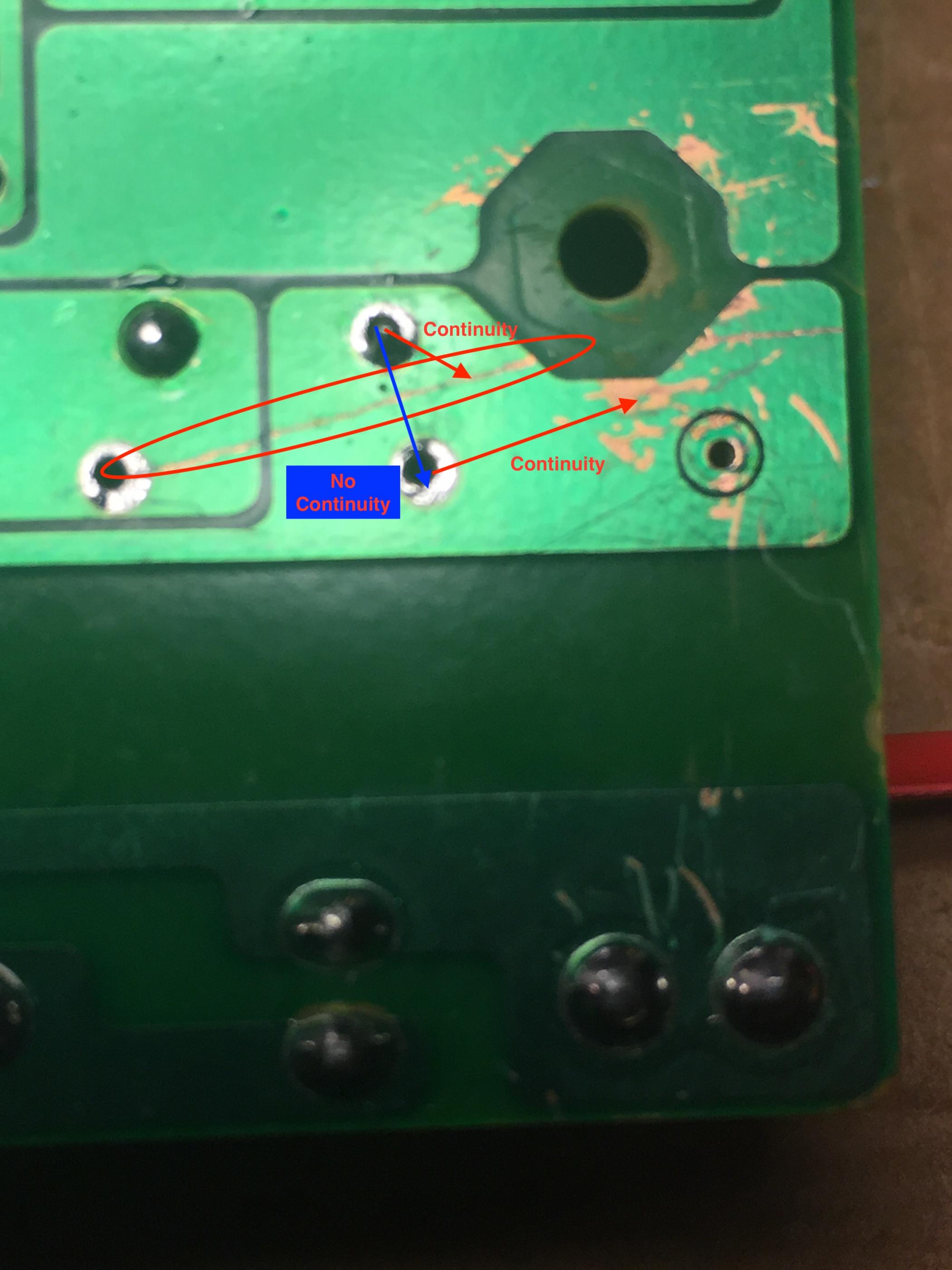

![Screen Shot 2019-12-01 at 6.48.34 AM.png Screen Shot 2019-12-01 at 6.48.34 AM.png](https://www.diyaudio.com/community/data/attachments/725/725008-c44f8cebb3a903f0dd308ff8a50b5566.jpg)
![IMG_1647.jpg IMG_1647.jpg](https://www.diyaudio.com/community/data/attachments/725/725020-42f8a051d6564df253eeba26ba1d6fc4.jpg)
It's hard to see the "scratch" in the picture but what you are describing sounds more like a cracked trace. If that's the case you can either remove the solder mask and solder a wire across the crack or go point to point between the relay pad and the diode pad.

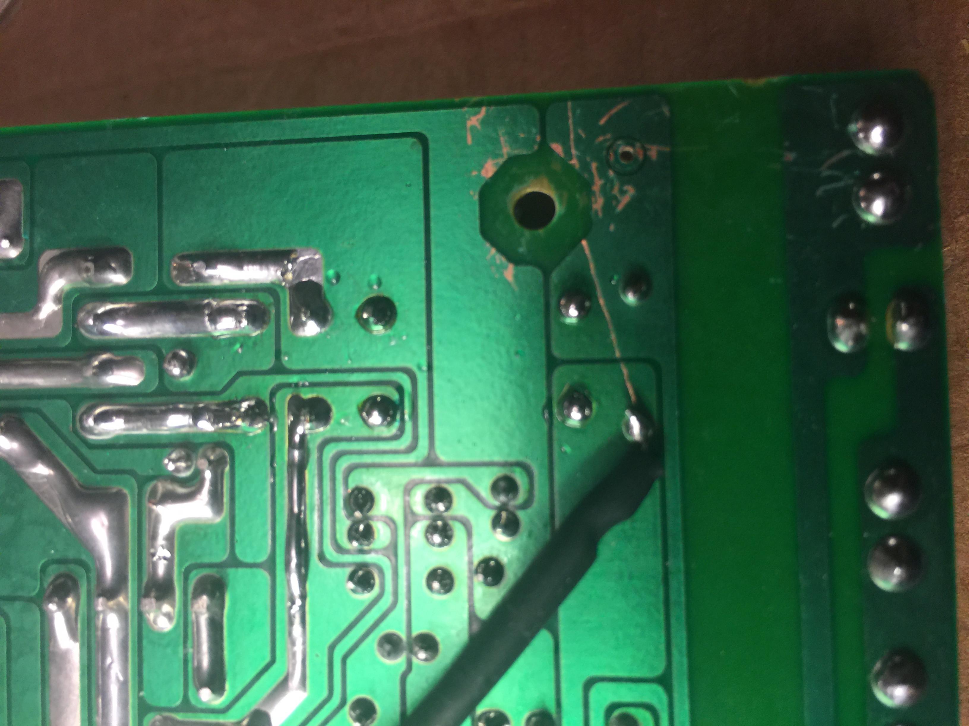

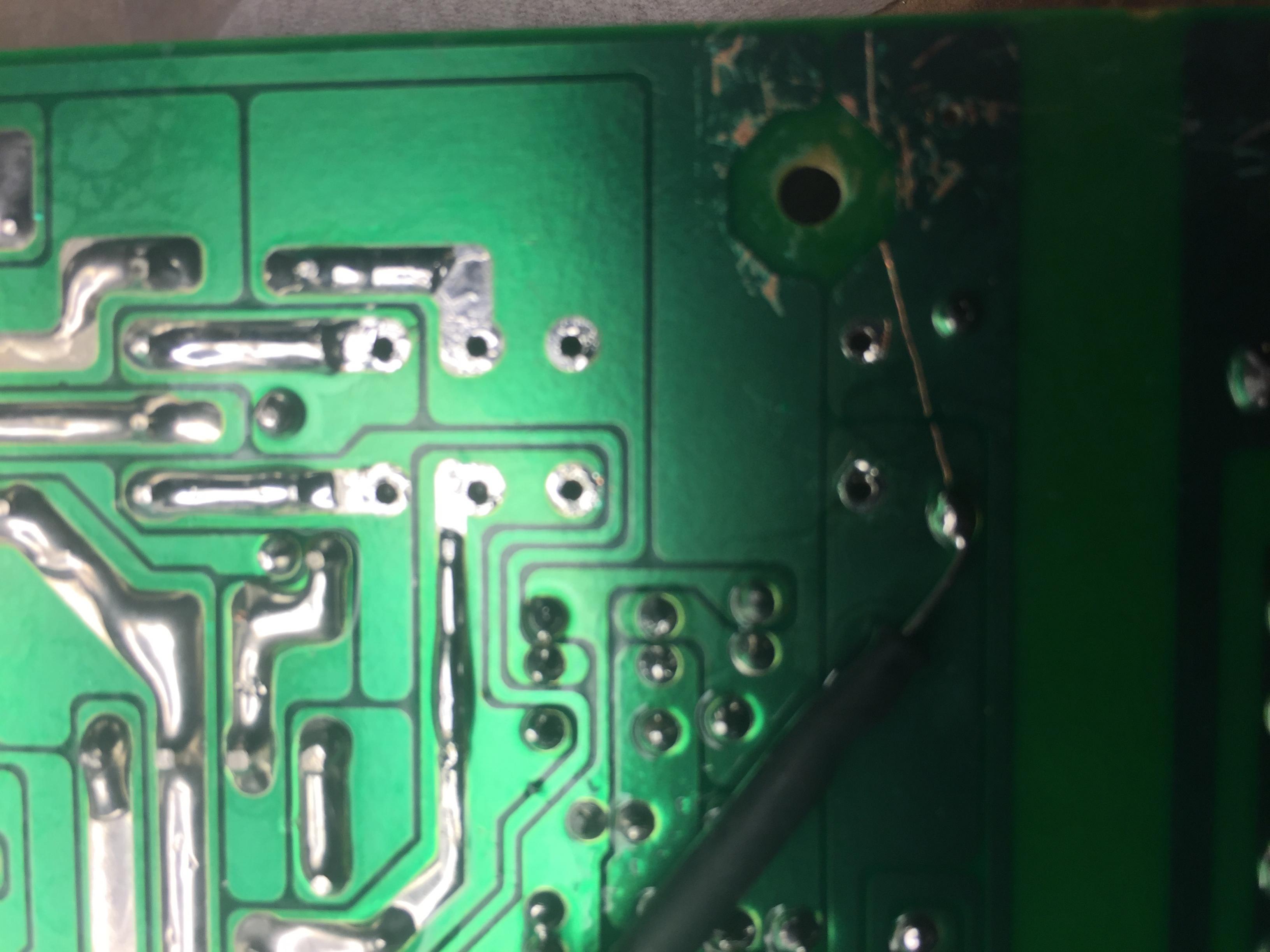

Thank you. Apologies. I didn't see that the previous picture was so out of focus. See below. I circled the "big" scratch that was there when I first removed the board. The other scratches around the standoff hole, I created with the multiple removals etc.
I'll run a small wire and see where that takes me.
Thanks!
![IMG_1648.jpg IMG_1648.jpg](https://www.diyaudio.com/community/data/attachments/725/725115-70999573842fe21444449e8500f49264.jpg)
