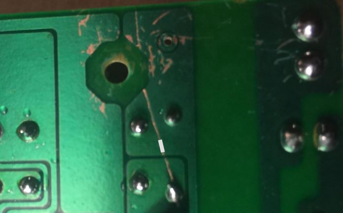

To get the amp operating you need to shift the voltage at pin 1 more negative. If you notice in the schematic the positive lead of C413 is connected to ground. D402 is pulling it negative on negative swings of the transformer output. You may possibly get the circuit operating by paralleling C413 with that 0.1uF cap to give it a little extra help.
If you check the schematic... Pin1 of U1 only needs to be less than +0.5 volts for the protection to cycle out and let the amp play music. Any stable voltage less than that is fine. In fact, the closer it is to 0 the better it would detect overcurrent situations.
Now... picture that transformer connector with a bad connection. You would be getting brief AC drop outs at unpredictable times for unpredictable amounts of time... The overcurrent circuit which actually senses voltage, doesn't know the difference between "no voltage" and "too much current" so it would trigger protection. If that connection is bad enough, it would hold protection permanently... Which is what it was doing.
As I suggested already... before starting to change parts or adjust values, that connector has to be dealt with first.

It's a bit of both...
D402 samples the AC at the transformer's seconday and rectifies it into a negative half cycle voltage that should sit at about -30 volts AC.
C413 smooths this voltage to get about -40vdc.
R410 is a bleeder resistor to discharge the cap if there's a voltage loss.
R409 and R412 form a voltage divider that feeds pin 1 of the TA7313, when the whole thing works right it should sit at about -1 volt.
Pin 1 in U1 is a simple transistor gate that, should it go higher than +0.5 volts will turn on and drain C415 and clamp the chip into protection. When that happens Pin6 will unlatch, turning on the protection leds and dropping the relay.
It senses both voltage loss and overcurrent. The overcurrent function is by detecting a roll off in the AC voltage in the transformer secondary with load. The voltage loss is detected as we've seen by an outright loss of AC from the transformer.

The amp is likely at the age where all the headers will be starting to tarnish. A good cleaning with Deoxit followed by some good contact lube usually helps a lot here. If you see any signs of heat do yourself a favor and just replace the header and connector. They will fail again shortly after cleaning.
Best I can find out, the model was introduced in 2004 ... Unless we have and extreme environment issue, I doubt component aging or tarnishing is much of an issue...
Personally I think the issue is a botched prior attempt at repair...

Anyway I've attached a thumbnail to show how I would fix that cut in the board. I've placed a white mark where I would do the work... clean the foil on both sides of the scratch, tin it, lay in a piece of wire and solder it down then trim the wire ends... that should do it.

This is a perfectly sensible thing to do...
When you reassemble it take each wire seperately and wiggle it a bit, if it trigger protection you've got an actual break in the wire, not a connector problem.
Odds are that connector is what triggered this entire situation.
You guys are amazing. I am not only trying to just "do the work" on the board, but follow along with the logic re: how the circuit is intended to function and what may cause it to flake out.
So, at the moment. I have the bridge pad to pad vs. the permanent repair on the "cut". I will fix that once we figure out what else may be at issue. Should not take long. However, we have good continuity now, and I'd hate to introduce yet another error or compounding factor, should I goof the repair. So, I'll always follow the best advice of experts, but the little bridge is sound, and is what got us going, so I'd prefer to hold off on "repairing it better". I understand that it's not the best permanent solution, but while we're still troubleshooting, "if it ain't broke.. don't break it"
re: J2. I have that thing solid as a rock at the moment. At least I think I do. Not saying it could not have an underlying issue. What is still puzzling (to me) is the issue with the power LED. Still will not engage again. That is a head-scratcher, but for another time. No amount of wiggling will cause the protection LEDs to flutter after my "reinforcements" and cleaning. I'll definitely consider soldering the leads directly to the board, but again, everything for the moment indicates a reliable connection. As an example, if we were getting intermittent drop outs from J2, I would generally think it would continue throughout operation and cause the circuit to go back into protection at some point. However, once the amp leaves protection after power up, it stays functioning for hours.
re: preventing a catastrophic short to ground - I put in a temporary, but effective stop-gap until I can find some very thin washers that allow the board not to flex when the one point that should be grounded is in place and also won't stress the legs or the part for the rectifier (which is bolted to the chassis for heat-sinking).

I am not sure if this would help AT ALL, but I'm always curious. We seem to be focused on Pin 1. So, I did a bit of an experiment to see what kind of fluctuations happen at that pin. I turned off the amp and let it sit for a few minutes to drain caps etc.
Fired it back up.
Starts off ~(-)60mV
Over several minutes the voltage slowly climbs to very, very close to (-)160mV. Click.
At the click - the voltage immediately drops to (-)150 or so while the relay is engaged.
Click - Relay very quickly disengages.
Voltage immediately shows (-)162ish
Relay Clicks... Voltage drops ... relay disengages.
This occured 5-6 times over the course of a minute or so, until the voltage with the relay not engaged was about (-)170mV then it dropped one more time to just about (-)159mV. Then it picked back up and stayed engaged.
So, to my naive brain... It seems the voltage at Pin 1 needs to be roughly (-)160mV or higher (lower) to trigger the relay.
After another 5mins or so, the voltage at pin 1 seems to cap out at about (-)385mV After 10mins or so, the voltage is (-)428mV. After 30mins or so, the voltage is (-)-440mV. Still not in protection and has not switched into protection.
In the multiple times I've measured at that pin, I have not seen a spike or dramatic drop in voltage that would indicate a disconnection at J2. The only times I saw that behavior was when I was intentionally poking at things, which.. I know I'm not supposed to do, but it's how mechanical reliability issues and bad joints have revealed themselves to me in the past... so kind of like the quote in Hunt for Red October... when I get confused, I kind of run home to mama.
So... something... is slowly allowing the negative voltage to climb at pin 1 from (-)60mV or until the relay starts to to engage, drop, and re-engage until it does not drop below (over) (-)160. The voltage continues to climb (drop) for a while until it seems to reach near equilibrium at around (-)450mV or so. I'll continue to monitor it to see if it continues to rise (drop).
Is it completely absurd to wonder what is slowing the negative voltage change at that pin? I'm often out in left field, but in my current practice, I observe and try to notice trends ... then I can see what controls those trends... May be a crazy approach, but I'm still trying to grasp the schematic on a more intelligent level.

Pin 2 J8A: 12V35 on PSU side
Pin 2 J8B: 12V35 on LED board side.
Touched up solder on the back side of the connection board (J8B) and also the leads to the LED itself. We have light.
Turns out that when I was jiggling J2, I was also jiggling J8. The wiring harnesses were zip tied together. I need that facepalm emoji again. Sorry for that wild goose chase re: the transformer leads to the PSU board. I'm still glad I went through the entire harness and beefed it up after so many disconnects / re-connects, but likely unnecessary.
