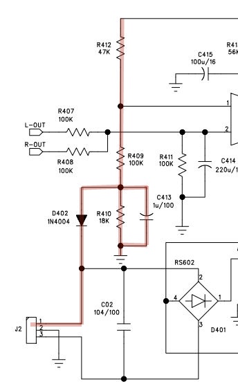

The AC/Current detector
@itsallinmyhead
Lets take a look at that AC detector circuit...
But first there is something we need to know about your multimeter. I need you to put it on the AC scale and hook up to a battery. You will need to test this in both normal and reversed polarity. What we are trying to discover is if the meter ignores DC when on the AC scale... if it does it will read practically 0 in both directions. If not at least one direction will read the battery.
If it doesn't ignore DC we can make ignore DC by putting a low value capacitor in series with the positive probe... a .1 uf ceramic cap should serve nicely. In this case the readings won't be as accurate but that's not going to be a problem. I generally just wrap one lead of the cap around the meter's probe wrap it tightly with a bit of tape and use the other lead as my test probe... Verify this by testing the battery again you should see nearly 0 after a second or two to settle in. We'll use this for the AC scale measurements, but remove it for DC measurements.
The way this circuit operates is that D402 is tied to one side of the AC input from the transformer at pin1 of J2. It samples this AC voltage and rectifies it to pulsing DC. This pulsing DC is smoothed to a steady DC voltage by C413. This is a negative voltage that is applied to the voltage divider chain of R412 and R409, the junction of which feed the input to the protection chip. At pin 1 of U1 we want a negative voltage when things are operating normally. But if the AC drops out or falls off significantly by loading the transformer, the voltage on C413 will move more positive, changing the voltage at the junction of R409 and R412. If this voltage goes above about .5 volts protection is triggered.
Failure modes in this circuit are that the D402 is not correctly sampling the AC input, C413 is not filtering out AC or R409 is not providing a negative voltage to the input.
So here goes...
It doesn't matter if the amp is in protection or not.
The attached thumbnail shows you the parts we are going to be working with, highlighted in red.
As a preparatory step you should examine the foil and solder for good connections... we already got caught out on that one on the relay, so lets go there first with this.
Test 1 ... Using the AC scale get a reading from pin 1 of J2. It should be somewhere around 30 or 31 volts and it should be stable, varying by no more than half a volt when the amplifier is quiet.
Test 2 ... Repeat the reading from the cathode (ring) of D402. It should show the same voltage with equal stability.
While you are on this point, gently wiggle and tug the wire from pin 1 to the transformer, moving very slowly to see if there are any drop outs in the voltage. If there are, it would indicate a connector problem... broken wire, intermittent contact, bad solder... You will need to fix this before moving on.
Test 3 ... On your DC scale take a reading from the anode of D402. This should read about -40 volts and it should be fairly stable.
If you are reading less than that, shut everything down, lift one leg of D402 and test it on your Diode scale. It could be either open or shorted. In either of those events replace D402, observing the polarity in the schematic, before moving on.
Now take a look at the schematic...
The anode of D402 feeds C413, which will smooth the rectified AC from D402. In other words, at this point the AC is gone and only the rectified DC voltage remains.
Test 4 ... on your AC scale (with the isolation cap, if needed) take a reading from the anode of D402. This will tell us the state of C413. if all is good you should not read very much AC there at all, maybe a volt or so.
If you do get strong AC you will need to replace C413 and get this reading down before moving on. If you need to change the part, I would suggest staying with the designated 1uf 100v part, no more than 2.2uf 100v. Electrolytic caps should be fine here. Remember to observe polarity when installing, the cap has it's + pole to ground.
Once we have stable DC at D402/R410, we can move on to the voltage divider formed by R412 and R409. Using ohm's law we can figure out what the voltage here should be ...
We should have ~ -40 volts at one end of the chain and +3 (the protection chip's supply voltage) at the other ... so 43 volts across the two resistors.
Now we add up the resistors to get the total resistance ... 147k.
And from that we can calculate the current in the chain... 43 volts / 147k == ~300ua or 0.3ma.
And again using ohm's law we can calculate the voltage across R412 ... as 47k * .3ma == 14.1 volts.
There is 3 volts at the top of R412 so 3 - 14.1 volts == -11 volts.
Test 6 ... on pin1 at R412/R409 you should have about -10 to -11 volts.
Keep in mind that this is a high impedance circuit, your meter might affect it and the input impedance of the chip might affect it... so lets say that if you read anything less than -9 volts the circuit is working.
So here goes...
Let me know how you make out with this...

(-)17V9DC
I removed the diode and checked it. It checks out fine. 0V54 forward bias and OL reverse. I have a stash of 1N4007s. Is it advisable to swap a tested-good part as a check, or should we examine other things before swapping the part?
I ensured good solder joints on both legs when putting the part back in. All previous measurements stayed the same.
I went ahead with this anyway, so we'll have a data point for before an after we sort out Test 3.
2.82VAC
A replacement part (if necessary) should arrive today or tomorrow.
600mV AC, and our typical (-)128mV DC. Just a data point until we sort previous steps.
Exceptional explanation as always. Thank you for taking the time.
33V7x to 33V8x over the course of about a 30s check. You mentioned stability, so I wanted to do a longer check.So here goes...
As a preparatory step you should examine the foil and solder for good connections... we already got caught out on that one on the relay, so let's go there first with this.
Looks great.
Solid.
(-)17V9DC
2.82VAC
I am going out on a bit of a limb here. Since we are only going through one diode my Google-fu tells me we are doing "half-wave rectification"...
Is it accurate that we'd expect closer to Vo = 33.7*0.9/2 or closer to 15V2 at the anode of D402? I watched a few videos and read an article. I am not sure how to figure in for the Vb of the diode...and one or two videos in my hands is a dangerous thing. Particularly when my fundamentals are not strong, and I haven't done an integral in a VERY long time... so I just tried to understand the theory and look at the final formula.
I never mind being incorrect, so if I'm off-base - I'll go back and read a bit more.

The explaination for the long time in protection comes from your last reading...
Taken at R409/R412 which read pin1 of u1 ...
If we take that 600mv of ac convert it to peak and add it to the DC we get...
(600 * 1.414) - 128 == +720mv peaks at the input to a chip that triggers at 500mv.
So now we know why it's staying in protection and it also explains why shorting that pin takes it out of protection.
Clearly the problem is that D402 and C413 are not creating enough negative bias on the divider chain of R409 and R412 to bring it out of protection.
Given that you got so much AC at that point, I would first suspect C413. So you should replace it and I would suggest trying 2.2uf 100v in that spot.
Also check R410 ... make sure it's actually reading 18k. If not you should replace it as well.
Let me know how that goes...

At this point we know it is being triggered by the AC on pin 1.
No need to run the whole sequence ... we are now only worried about the voltage at R409/D402. It should be far more negative than it is and there should be far less AC present.
First replace C413 with a 1 uf part, and see what happens. If we decide to put on a second cap, you can solder it to the bottom of the board.
If that doesn't get it, you could also try replacing D402 with one of your 1n4007 parts. (The only difference is voltage tolerance, all other characteristics are the same)
Also... if you got the parts for the 15 volt supplies, you should install and verify them now, rather than continue to risk failure when repeatedly turning the amplifier on and off.
New cap installed and the amp comes out of protection in under 2s.

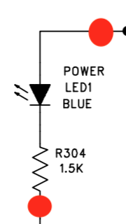

Oddly, the darn power LED went out again. I've looked at all the physical connections and solder points on the schematic. Is it safe to run 12V to the points below to test the LED itself? I rechecked all physical connections and the voltage at the J8A and J8B sides. Still 12V3

1) 2 seconds is too fast... Can you replace C415 which is the timing cap for the turn on delay? You can use this to increase the time delay when turning on... 100u if you have it or up to 150u, at least 16 volts. The higher the value the longer the delay.
2) Also check the value of R413... I wouldn't change it, but you may have to replace it.
2) Double check the readings at D402/R409 AC and DC just to be sure.
3) Double check AC and DC at R412/R409 just to be sure.
(I'm a born skeptic ... I need proof)
4) Repeat the power off, power on sequence a few times. Turn it on, time it, turn it off, go have a beer, try it again. If nothing else you'll get yourself into one very mellow mood, basking in the warm glow of success.
For the power led... yes you can feed it 12 volts if you unplug J8. But your time would be better spent checking continuity between pins along that run of foil... There's a bad spot in there someplace... if it wasn't getting 12 volts, none of the leds would work. Worst case just stuff a new led in there and see what happens.
EDIT: OK I see you've fixed the power LED problem, good work.
Almost done! Yaaaaaaa...
Pulled out the LED and checked it. Dead. Replaced with new LED. Good to go.
That's a blue led isn't it?
Man I hate those things, they're like little laser beams aimed right at my eyes. Usually just way too bright... If it's bright enough to interfere with your enjoyment in a dark room, you can tame it down by increasing the value of R304 ... I'd start with 3.3k ... which will also increase the new LED's lifetime.
I have those here, but I'll hold off on pulling the board out again until I have the new diodes and resistors tomorrow. A few of the little caps look a wee bit bulged, so once I am good with the operation of the amp, I will swap out the dodgy ones. I am careful taking the board in and out, but I try to minimize doing it. Hopefully one solder slinging session tomorrow, and we'll be complete.
Will do, I think I have some 56k resistors around, just in case.
3) Double check the readings at D402/R409 AC and DC just to be sure.
(-)0.700VDC
0.000VAC
As you should be.

Cycled it quite a number of times.
Yes! A bit of tidying up, and things are looking very good.
Good plan. It's probably better to minimized the on/off activity before those 14 volt supplies are fixed.
My bad ... I meant R410 ... part of the AC sensing circuit. It just drains C413 when power is off... so no big deal, but it should be checked even just for thoroughness.
(-)0.700VDC
0.000VAC
As you should be.
