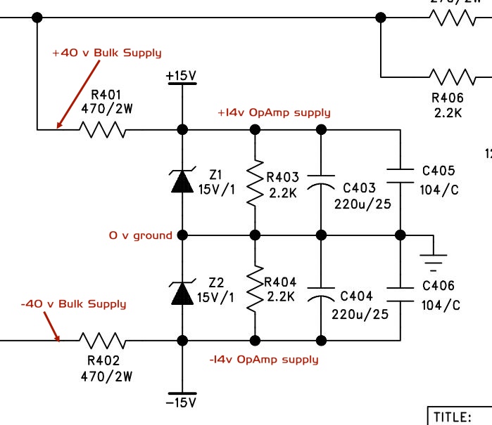

I thought you might like something of a final checklist after putting the rest of the parts into that amplifier and based on what we found...
1) AC and DC at the anode of D402.
2) AC and DC at pin1 or U1.
3) Voltage across D403 (relay coil)
4) + and - 15 volt supplies at Z1 and Z2
5) Protection timing, adjustable by C415.
6) Relay click.
All good ... job well done!

So close! I need a bit of help please. I've triple-checked continuity, solder work and orientation of appropriate parts. Something is amiss with the Z1 / Z2 changes and/or the associated R401/402 resistor changes, and C403, 404 Cap Changes. I did not swap out C405 or C406.
I've reviewed the schematic and previous posts re: the function of the circuit to try and understand where to focus effort. I hit a dead end.
Something is off.
R401: 44V5 and 24V2 I can't diagnose why the voltage is high here.
R402: (-)44V5 and (-)14V4 😀
Z1 Anode - 11V0 DC
Z1 Cathode - 24V2 (matches R401 appropriately)
Z2 Anode: (-) 14V4 DC 😀
Z2 Cathode - (-)14V2 DC 😀
Any help is appreciated. I felt like it should be easy to trace this back, but I can't determine why it's high at R401.
It sounds like your ground is disconnected to the low voltage supply. The anode of Z1 should be ground = 0 volts.
@jwilhelm - Thank you! Nailed it. Now I need to figure out why I could not diagnose this... More learning to do. I had PMed Douglas that I thought I may have lifted a pad b/c the legs for Z1 and Z2 were very tight. I had checked all continuity previously, but on a recheck, I was getting intermittent continuity to GND on the anode of Z1. So, I repaired the pad, and just for insurance ran a small leg to the nearest part on the back of the PCB on the same plane. Woo hoo! 😀 Truly appreciated.

Z1 Anode - 11V0 DC
See the attached thumbnail ... I've marked the voltages in red.
A zener diode is one that has a specific breakdown voltage (14 in our case) when reverse biased. This leads to an avalance effect where when that voltage is reached it begins conducting current. This lets us use them to regulate voltages... put a resistor in series with a higher voltage and use the voltage across the diode. It's not complex.
In this circuit ...
the cathode of Z1 should read +14 volts
the anode of Z1 should read 0 (zero) volts
the cathode of Z2 should read 0 volts
the anode of Z2 should read -14 volts

11. I checked the power supply and there was no +/- 15 volts. Both zener diodes Z1 and Z2 were damaged...you will excuse me - there are technical words I forgot how to translate on english, so I will explain the damage like this. I desolder both diodes. I measure them using my multimeter on diode mode. I checked the diodes connecting them both ways. One of them shows zero impedance in both directions. The other one shows nothing in both directions. So they were damaged. I'm really careful when connecting cables and soldering, I also check few times and I never do it with the power on. So I don't know why the zener diodes were damaged. Anyway, I bought few new ones.
12. After replacing the zener diodes and with the amp boards cables disconnected, I checked the voltages. I had +/- 15 volts. Then I connected all the cables and powered the amp again. The protection was immediately activated and there was some weird smell, before turning of the power. One of the zener diodes (the one on the -15 volts) was damaged immediately.
13. It is clear there is some problem, that appears only when I connect all the cables. It's like some sort of short circuit, but I have no idea why and where. Could it be the driver boards that I Swapped? But according to the schematic, both are the same and their connectors are also the same and positioned in the same way. The only difference between both channels is with the stereo/mono switch (and some parts connected to it), but these parts are on the power amp board, not on the driver board.
14. At this point I decided to do some experiment. It was probably wrong, but with no idea and being pissed of, I decided to do it anyway. Without replacing the zener diodes I had only +15 volts. The -15 volts was actually 0 (measured to the ground). So I don't think this could damage the integrated circuit. Both J5-A and J5-B were connected. They provide +/- 40 volts, ground and connect the channel output to the power supply board (the protection and relay chain). Then I tried connecting the other cable sets from the amp boards - J6-A and J6-B. When connecting one of them I still had +15 volts power. When connecting them both I could hear louder buzz from the mains transformer and the powerful resistors at the +/-15 volts chain got hot. Also the +15 volts power became +13 volts. It looks like connecting both J6-A and J6-B makes some sort of short circuit. But I have no idea why.
15. Next thing I did was to replace the damaged zener diode. Good thing I bought plenty of spare parts. Just in case I also replaced R401 and R402 - the powerful resistors at the +/- 15 volts chain. I measured the voltages (with J6-A and J6-B disconnected). I had +/- 15 volts. I believe connecting both J6-A and J6-B will lead to short circuit again and will damage some of the zener diodes. But it was worth trying connecting them separately. No problem. With one of them connected I had +/- 15 volts power and there is no heat.
