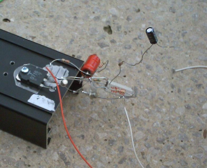

Mooly said:Last one folks, as above but with a 0.1 ceramic cap for decoupling close to the output transistor. Enjoy !
This looks nice!
Where exactly should I pop in the cap? Between emittor and ground?

Soldered from the collector of the output to ground (But it has to be the correct bit of ground) . If you are still interested I can post some "guidelines" on earthing and layout when I get chance.

can we see
some picture of your construction mooly ????
thats kind of strange and makes me wonder why my prototype wasmaking trouble....
is it the same schematic like the original posted by dutch or you made any mods to it ????

Should have done that really. I knew someone would want a viewing. Actually you really really dont want to see it. O.K. then you do but it will be tomorrow this time.
Just a point on the oscillation, it was the kind where even bringing your hand near to it would stop it. A classic case of how not to build something 😀 😀 . Well I wasn't going to design and etch a PCB now was I.
Post it tommorow all being well.

As per GD circuit earlier. Only difference is a 15 ohm instead of a 20 and ancient 2SD something or other 😀 . Very old, an audio output from 20 odd years ago. I did have a 2N3055 but it's easier with a flat pack. Thats a shocking thing to say isn't it 😱
