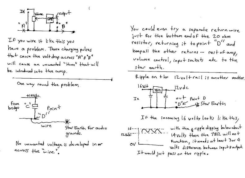

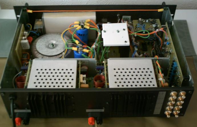

Mooly said:GD Would you still like some info on grounding and layout.
Yes please!
I also found this article very informative: http://sound.westhost.com/earthing.htm
D
Hello GD,
It's all relevant and good stuff.
I know from years of experience that getting a design hum and noise free to be the biggest challenge.
This is an internal view of my amp -- there a lot of wiring in there but with a correct grounding scheme it is absolutely hum and noise free, even at full gain. You have to treat each and every wire as a potential source of noise and as a potential "resistance" that an unwanted voltage can develop across and therefore be introduced into the amp.
I will try and draw out a few simple pointers for you, but you have to be methodical and attend to each issue.
See what I can come up with.

Wow! That is some amplifier... driving the B&W's I suppose?
D
Hi GD,
It is driving the B&W's and very nicely as well. If you want to read a bit more about it have a look at the current thread in the solid state forum "My MosFet Amp designed for music"

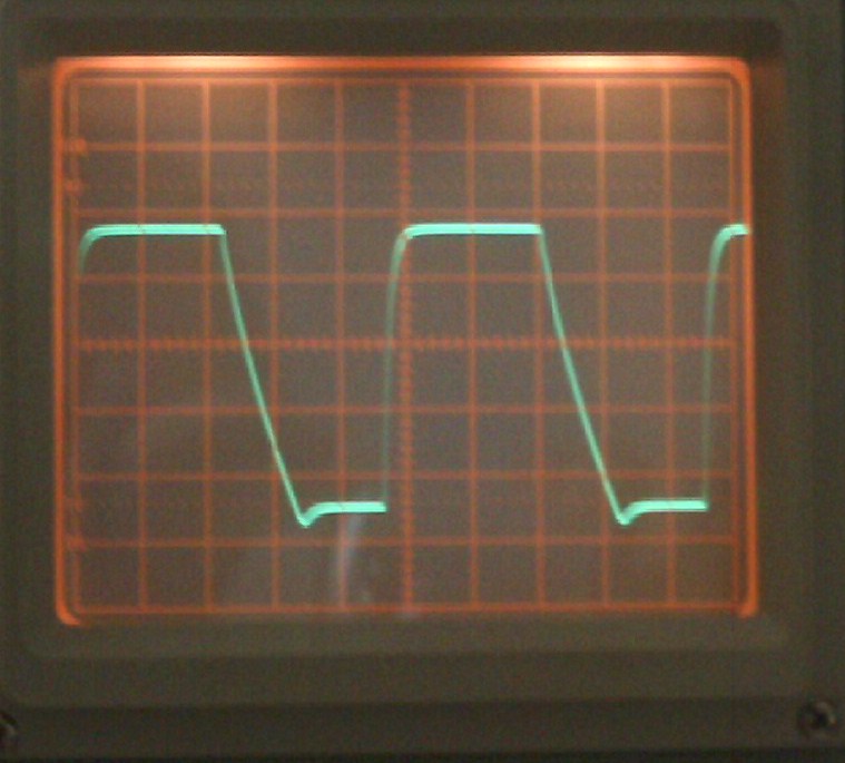

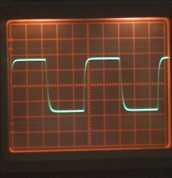

Anyway back to yours. I've just to scan some notes before posting them but here some more pics to show how the performance is affected by choice of parts in a design like this.
First up 100Khz with a TIP3055 this is the flatpack 2N3055.
Mooly said:And this one-- hope it makes some sense.
Okay - makes sense...
I'll report soon.

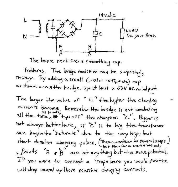

Mooly said:Lets see if this is readable.
Transformers do not saturate because of high secondary current. But the peakier currents you get with bigger caps have another problem - higher RMS to average ratio. The bigger caps used the higher current drawn from the transformer for the same output power.

choise of parts make hell of a diference ......THIS WHAT I THINK !!!!
wll have to see this again some times later with some other componets ....

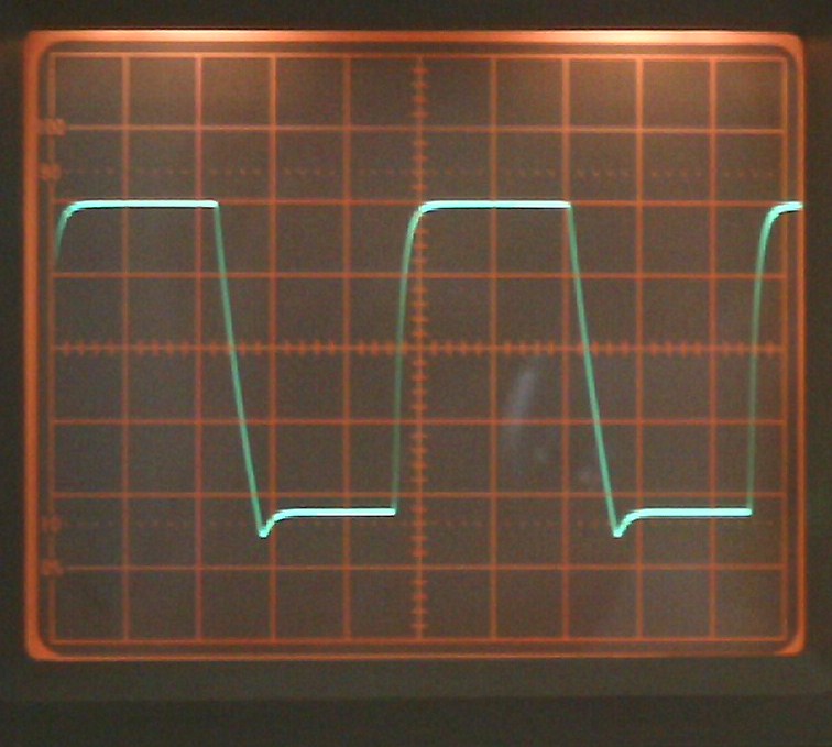

Mooly said:And this will have you guessing. One component removed and one substituted. This is at 100khz.
Mosfet?
Correct . An old BUZ90, together with removing the driver. No gate stopper, WHAT !!! All the tv,s just wiped out for quarter mile. Not me guv.
Sakis -- BC107's those round metal things we all used to play with. Next would have to be to tweak the bias and perhaps use a Germanium front end.

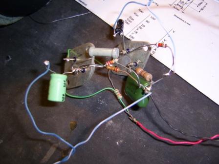

It's just a bit of fun on my part, trying to show the effect of various components.
No noise or hum, other than that picked up by it being a lash up. Run off a Farnell laboratory PSU.
