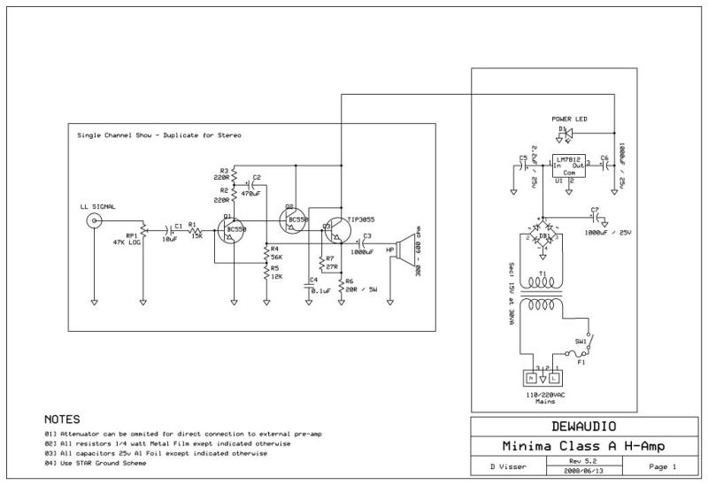

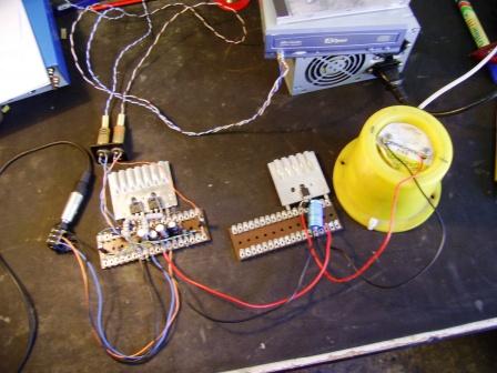

When you dangled the B-E junction over the 100mfd cap in the multiplier did you re - read the voltage at the amps themselves. It should have dropped to around 7 or 8 volts. This would "prove" it was working OK as a zener. It would prove a lot as to whether it really is a PSU ripple issue ! You ask about overvoltage. That in itself will not affect the hum. I am a little suprised it made no change at all, I think we could do with making sure the multiplier is working correctly. If you disconnect the 4.7 K resistor the voltage to the amps should drop to zero. Could you try that as well. Something does not sound quite right here.
The quality thing is interesting. Quite a few years ago now I had a Pioneer A80. If specs meant anything at all this was the ultimate. Sadly, although I tried to convince myself there must be other shortcomings in the rest of the system it wasn't so. The amp was unmusical, cold sounding. That's how I ended up with my present design, it's not perfect technically, but it sounds fantastic, now 95% of my music collection sound fabulous, the music shines through whatever the shortcomings of the recording.
Whoa-hey!! What did I tell you??
All the amplifiers needed were a simple regulator.
The sound, using the mains transformer, is now breathtakingly brilliant. Dead quiet background - ZERO hum or buzz.
I am using a 1A, 7812CT regulator with a 400mfd cap on output. Works like a charm!

keantoken said:
Hmm. I appear to have missed something!
Is the end result different enough to post a schematic? I must have a schematic of everything that sounds good...
- keantoken
Hi Kean
I'll draw up a detailled schematic of the stereo amp including the regulator circuit and mail it to you.
Drop me a mail at: dewald (AT) greenlizard (dot) co.za
I would also then be honoured if you can build the amp and tell me what you think of the sound.
