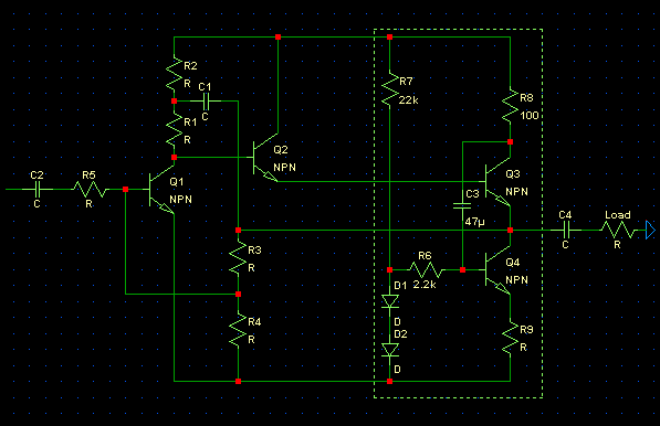

Hello. Adding a pseudo-CCS to your amp like below should help PSRR as well as increase load driving capacity (which might make it sound better).
The value of R9 should be calculated as follows:
divide 0.6/the current through R6 (in your schematic) and make this the value of R9 (in my schematic). I never heard the quiescent current specified in the above posts so I cannot do this for you.
I would advise you ask someone more in the know about this since I am subject to errr.
Also, do you fully disconnect the transformer when you switch to battery supply? It shouldn't happen with toroidal trafos but with the standard E-core you can get EMI from nearby equipment...
Hope this helps reach a viable solution,
- keantoken

Thank you Keantoken.
I just have to get some new veroboard or such to do a second prototype...

Also, bypassing the 470uF cap with a smaller non-electrolytic (ceramic, not a can) may help high-frequency response just a bit since electros have internal resistance and for larger ones, the inductance caused by the rolled plates might be a problem.
I would also suggest bypassing electros in the PSU as well. This might help filter out higher frequency EMI without having to add an expensive .5 ohm resistor or inductor in series with the load (your amp).
Wait for the pros to correct me though before you do something bad. 🙂
- keantoken
