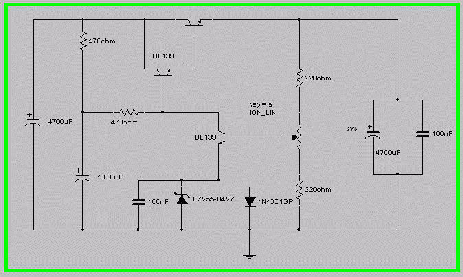

Enter with 17 to 30 volts rectified...best results will
be when you adjust to 12 volts DC into your output.
The extra diode is to install when you need lower voltages...as this circuit will not adjust voltages lower than 6 volts (around that) with the zener diode (4V7) into the circuit..using a switch and producing a short into the zener (installing both in parallel) you gonna adjust from 2.5 volts and upper voltages till the maximum DC supply limit reduced by 1 or 2 volts because of power transistor saturating voltages.
Use to the power transistor, the big series pass regulator transistor, the one you have no number on it, the NPN you have, the NPN you like, the one can hold twice the current you gonna use...and install it into a good heatsink if needed....and this will depend your power demands..if 1 ampere, use 10 by 10 centimeters aluminium plate that will fit...... 2 amperes, then use two blades or 200 square centimeters (calculate one side only)...each 100 square centimeters will dissipate, easy, 10 watts of power...using that ratio you will have the needed dimensions.
Precise?.... no...nothing precise here.... precise is the day we gonna die...no negotiations...the moment, the hour, the day, the year, no negotiations possible.... this is precise.... eletronics use to have 10 percent of tollerances.
Other supplies can be as good as...but i doubt will be easier, cheaper and better.
Condensers are for 1 Ampere operation.... the bigger the units you decide to use, the better will be your results.

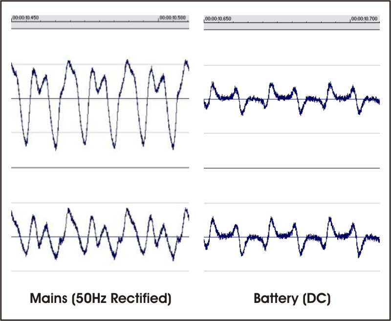

Buzz - 100hz - through the phones connected to the amp. I have referenced the buzz to a simulated signal.
I'll try and measure a graph of the buzz I get
- a moment please...

You say you have a PSU with 10000 mfd cap and the capacitance multiplier I posted. And you still hear hum at 100hz ?
Here is my findings
Mains PSU (Transfo with standard regulation)
Prominent Freq: -54dB at 108Hz
Battery
Prominent Freq: -67dB at 151Hz
See attached graphical measurement
Unit measured by 600 ohm dummy load on outputs tapped to Line in of soundcard. "Silence" recorded.

If it's run off a lead acid battery where is the 151 hz from ? It has to be silent apart from thermal noise ( hiss ). And I think you said it was earlier when you used a battery.

Do you have any zeners available up to 10 volts ANY AT ALL ? you can put them in series to make the voltage you want. Do you have a 7812 or a 7805 reg.

Mooly - I appriciate every little piece of help and advice I get from guys like you.
I dont know where the 151Hz comes from on the battery but do notice the lower dBs - It is inaudible throught the headphones - probably induced by the soundcard... tiny bit of hiss is there but it is neglible.
