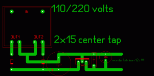

The hum (100Hz) is gone when using the battery in my main system but returns when I connect the 12v transformer PSU...

Sorry, I don't do a lot of transistor cascades.
I'm just looking at your amplifier circuit.
What is the operating point of the amplifier as a whole?
I'm guessing that when the DC offset at the output goes over 3.4V the voltage on the base of the input transistor starts to climb over 0.6V (through the NFB divider R4, R5) and since the emitter is grounded the transistor starts to conduct, pulling down the voltage at the collector, and hence, through the darlington, the voltage at the output, which settles at some unknown point over 3.4 V.
Taking 3.4V the voltage at the first transistor collector must be about +1.2V i.e. 5.6V so the voltage drop across R2, R3 is ~6.4V and the quiescent current is 6.4/440 = ~14mA. DC current gain of the BC550 is 110 min 800 max so current into the base is <125uA and can be as low as 15. However at 3,4v the current down thru R4, R5 is 3.4/68000 = 50uA so this is not a stiff source as far as the base of Q1 is concerned
Given the wide variation of DC gain of the BC550 this topology may result in wide variations of the operating point from unit to unit and may contribute to a poor PSRR.
Anyway how did you arrive at this design?

Whee-hooo... all greek to me!!
So you think that the hum occures due to over volting?
This design is based on some basic transistor circuits and gentle nudges from friends in general (good) directions. The circuit works beautifully exept for the hum using mains... battery is fine.

Your amp circuit has poor Power Supply Rejection Ratio (PSRR) - that means any voltage noise on the 12V seeps on to the output. That's why you hear hum with the mains psu but not with the battery. The noise is dominated by this, not shielding problems or anything.
Either you need to change the amp circuit to increase its PSRR or you need a regulated psu. Hey, that's what you asked for in the first place!

Already have one installed - doesnt help much. I'll look for a suitable regulator.

Let me try to clear some confusion here.
The amplifier circuit functions beautifully - I coudnt ask for a better sonic response.
I get ZERO hum/buzz (50/100Hz) from a fully charged lead acid battery
I get ZERO hum/buzz from a switch-mode, regulated desktop PSU.
I DO GET hum/buzz from a normal transformer with a standard rectifier bridge and single smoothing cap.
My phonostage is an EAR 834P Signature with level control and this works A-OK with the h-amp.
Also my PC soundcard works A-OK with the h-amp.
I know, from basic knowledge that the hum/buzz is not a ground fault as I am all too familiar with ground faults in phono systems - I do design and build turntables for a "living".
What I suspect, from previous experience, is that a simple POSITIVE regulator with solve the hum problem as that is how the clever folks at Pro-Ject gets away with a single rail AC supply in their phonostages - spitting the single rail with two diodes and using one POS and one NEG regulator for dual power rails 9-0-9v.
