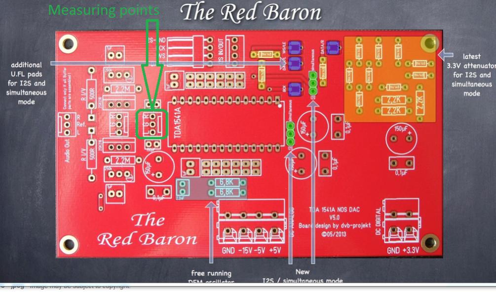

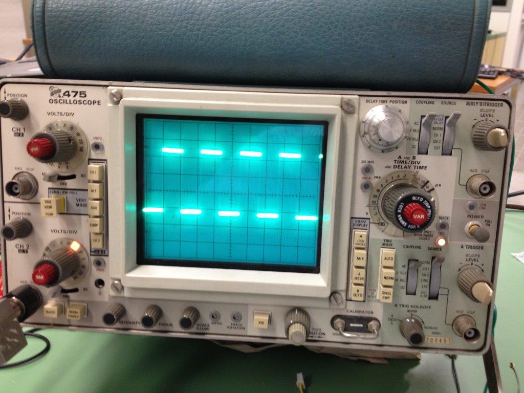

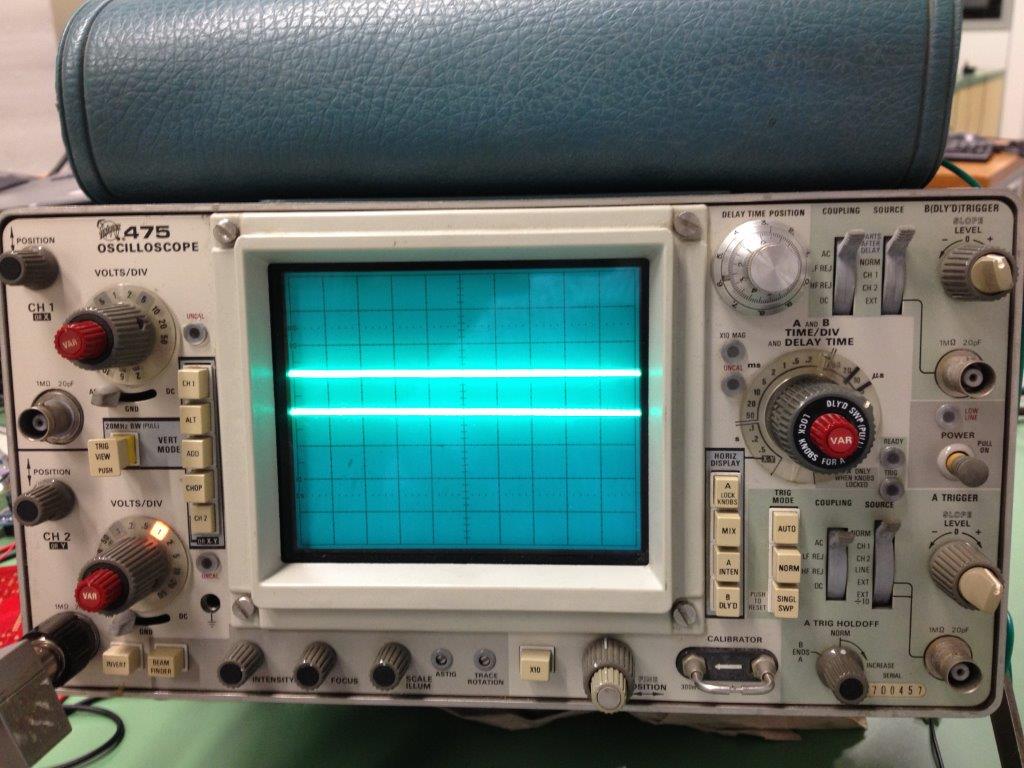

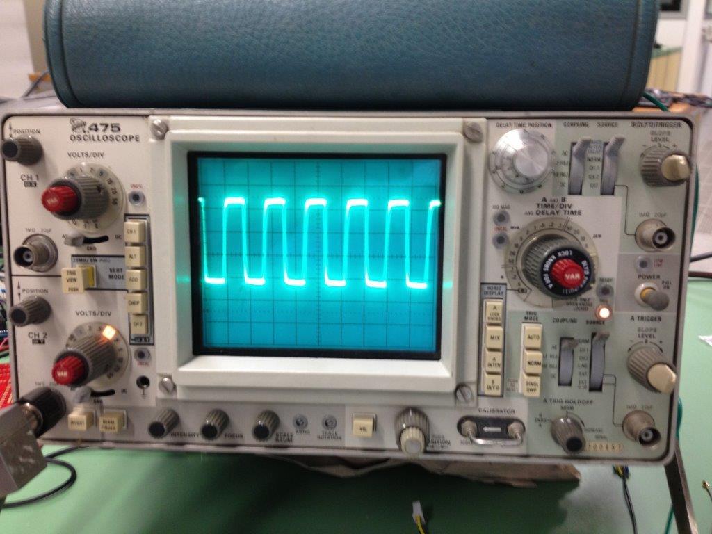

as a follow up to my post http://www.diyaudio.com/forums/grou...dac-i2s-bus-architecture-151.html#post4718234
I finally managed to get some time to try to get red baron to fly again by re-configuring it to run in I2S mode and connecting it directly to the I2S outputs of Ian's clock board.
It does not work and I suspect that the reason for it is that there is something wrong with 1N4148 diods.
There is a nice signal going in to diods from WS/LE and DATA/L u.fl sockets:
and on the other side of the diods the signals (without changing the scope settings) look like this:
Can anyone provide a scope view on the diod outputs, or the WS DATA/L TDA inputs for comparison?
Any hints on what could cause this signal change apart from obvious - broken diods?

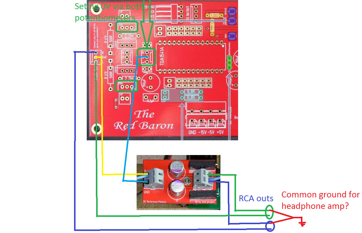

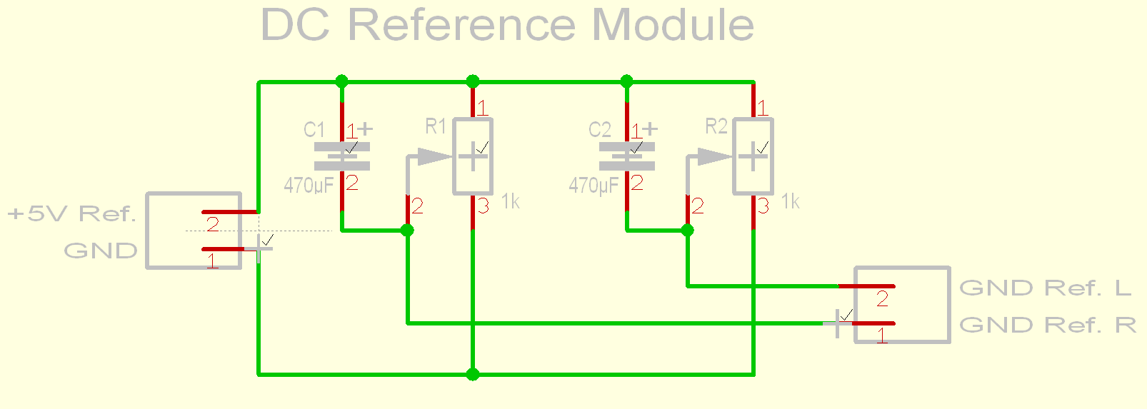

Hi all,
Came back with a question, now, that I've (finally) finished Red Baron, I want to feed my headphone amp with it.
What I've did:
I've set 0V vs. Digital GND via potentiometers.
I've wired the reference module to Red baron as in picture.
I've set the 0V to RCA outs via potentiometers on the reference module board.
What I want is to feed a headphone amp via 3.5mm jack.
In this case the both ground will be linked together.
Will that be a problem? I've found around 1.5V between both RCA out grounds...
Kind rgs,
Alex.

It should not be a problem.Anyone please correct me if I am wromg here.
If you check the schematics. All the signal grounds are usually commected together.
So it will happen regardless of the connectivity type you are using rca or headphone jack.

Having some issues setting up the Red Baron.... I have -0.8V on both L and R channels to GND, playing with the pots does almost nothing. Any ideas? I don't know what the hell I'm doing.
Imgur: The most awesome images on the Internet
You made a failure with the I/V Resistors.
Please solder the 2nd end of the resistor to the quadrangle solder point like here on an older RB V3.0!
The round solder point vis-á-vis is for the form factor of i.e. TX2575 naked bulk foil resistor.

Hi Oliver!
And for me, does the schematic looks OK? I didn't shunted the I/V res. when soldered.
Still can't figure what would I do with two different voltage GND from DC ref. board common in the 3.5mm jack for headphone amp.
When I common I get different readings for DC voltage vs. when I measure each channel with it's own GND.
Kind rgs,
Alex.

reference dc module
In the ground reference module, there are two outputs----GND REFERENCE L and GROUND REFERENCE RIGHT .
Why do i need two Gnd reference output as the output ground of both channels from the red baron are tied together on the Red baron board ?
Thanks for clarification
