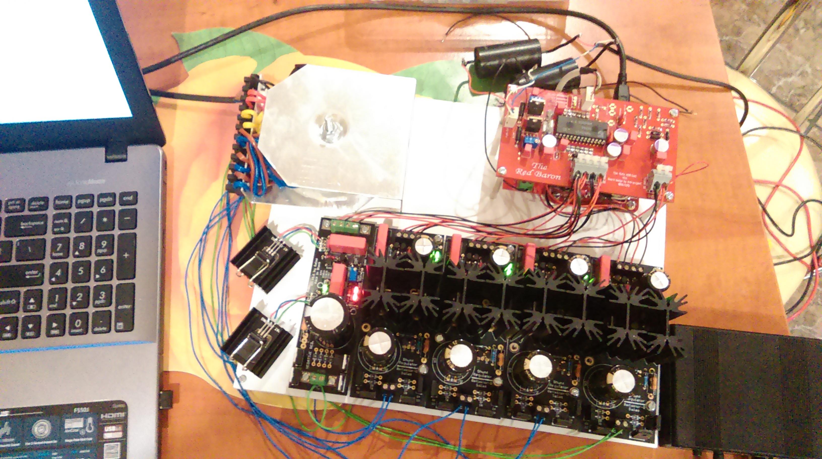

Red baron working !!
Thanks to John and Oliver .
The Red Baron is singing and I hope the wiring for the Dc reference module is OK . I manage to null the dc across the IV resistor.
I post my build and I hope my wiring is correct.
Anyway I have input caps in my pre .
Sounds very relax, 3D imaging. Outstanding high, mid and low .
Vocal is especially detail.
regards

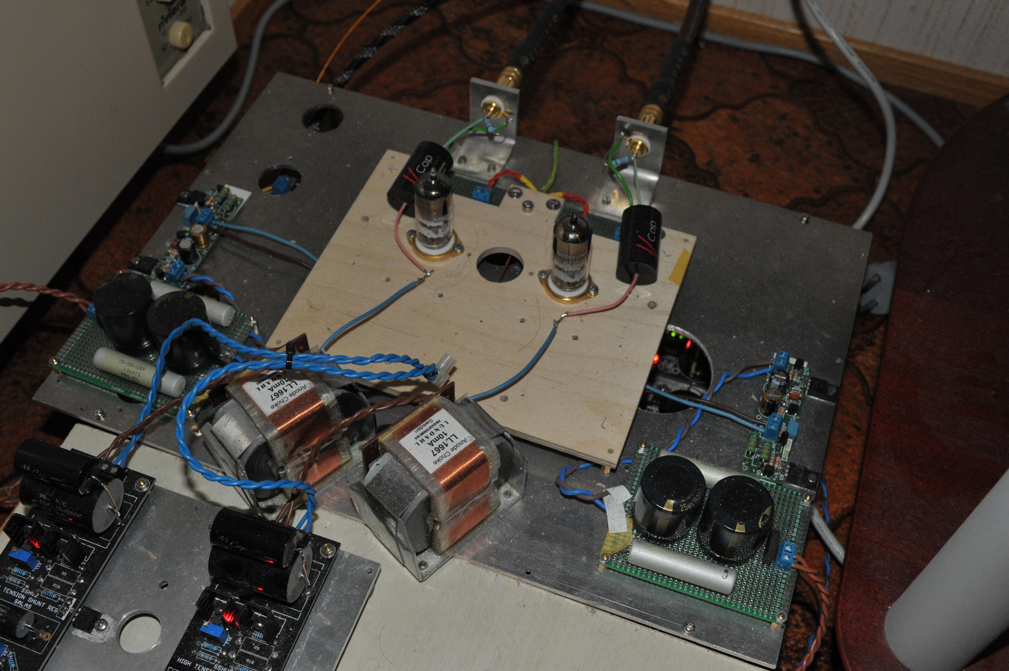

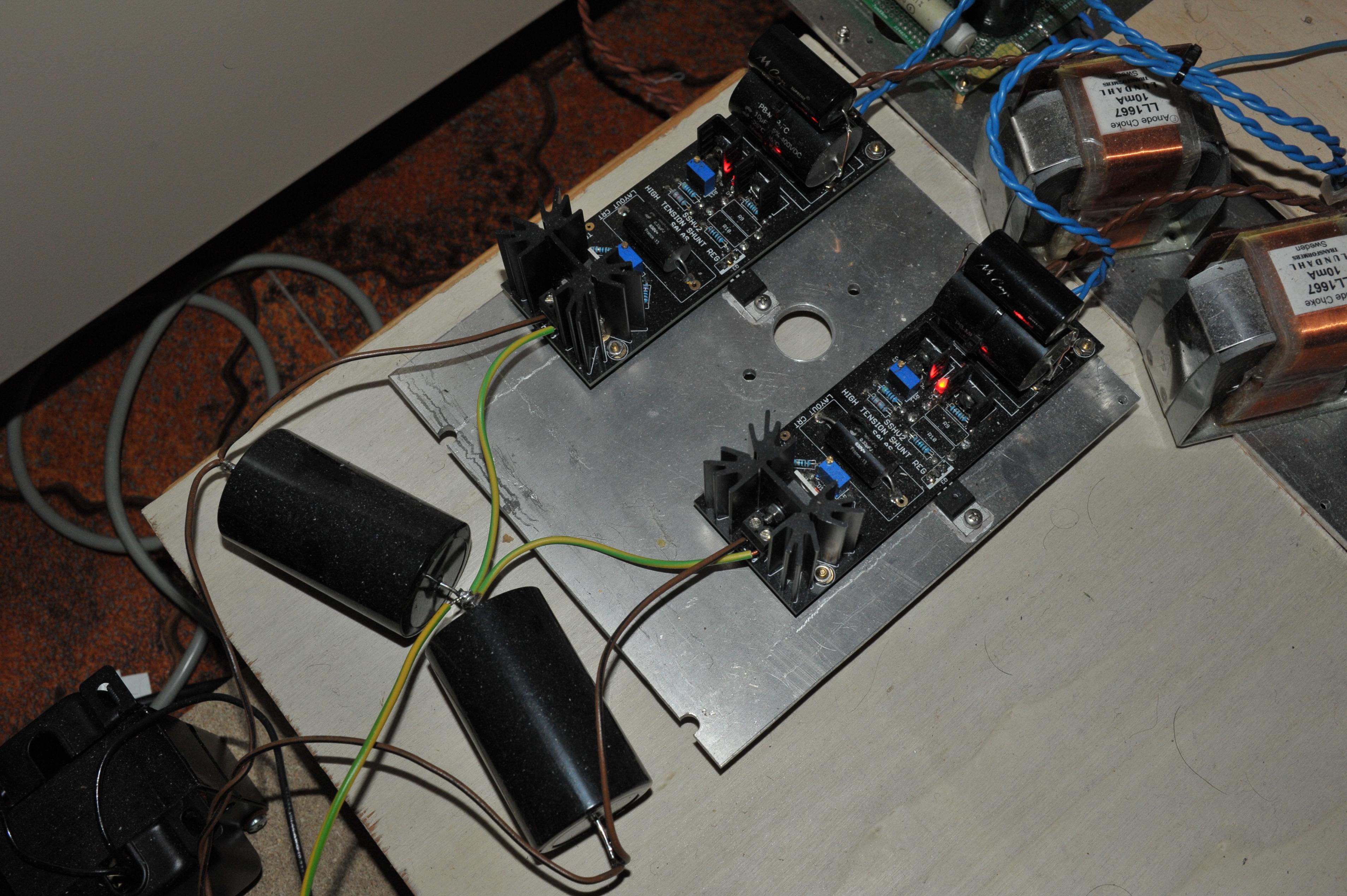

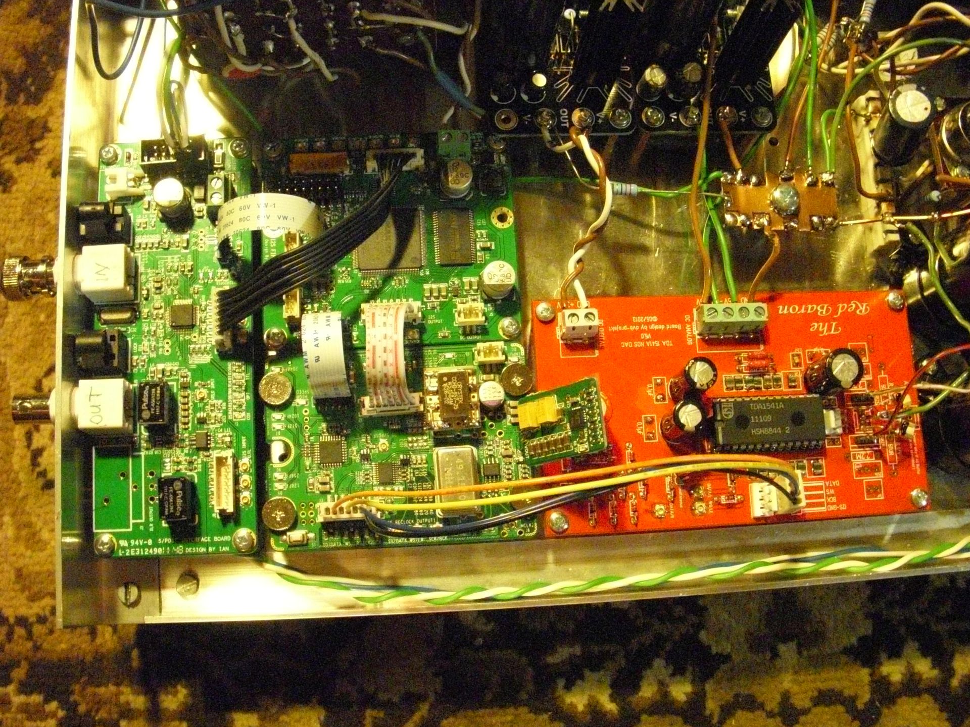

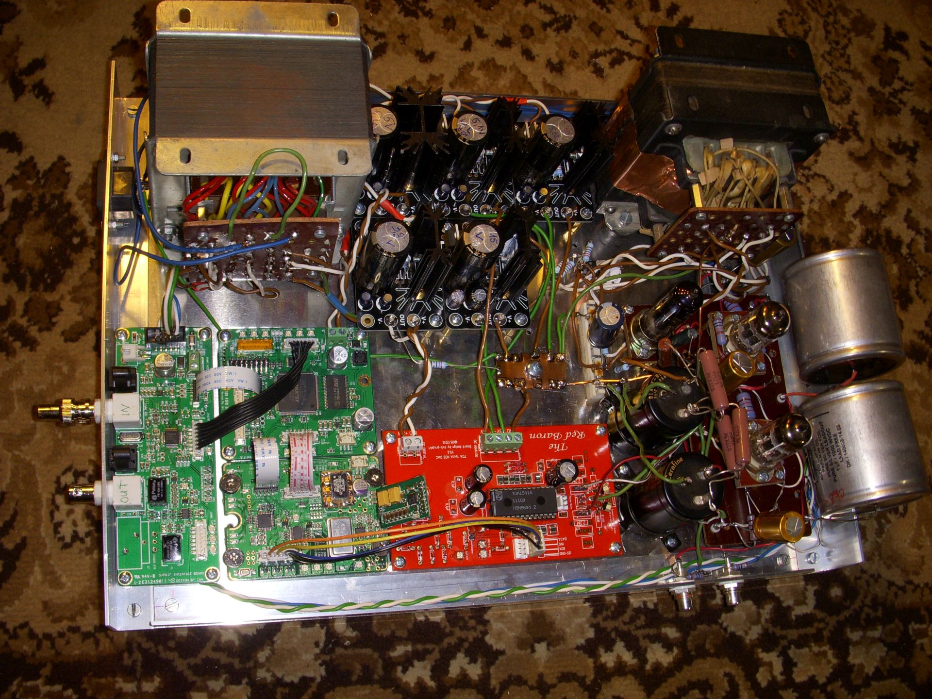

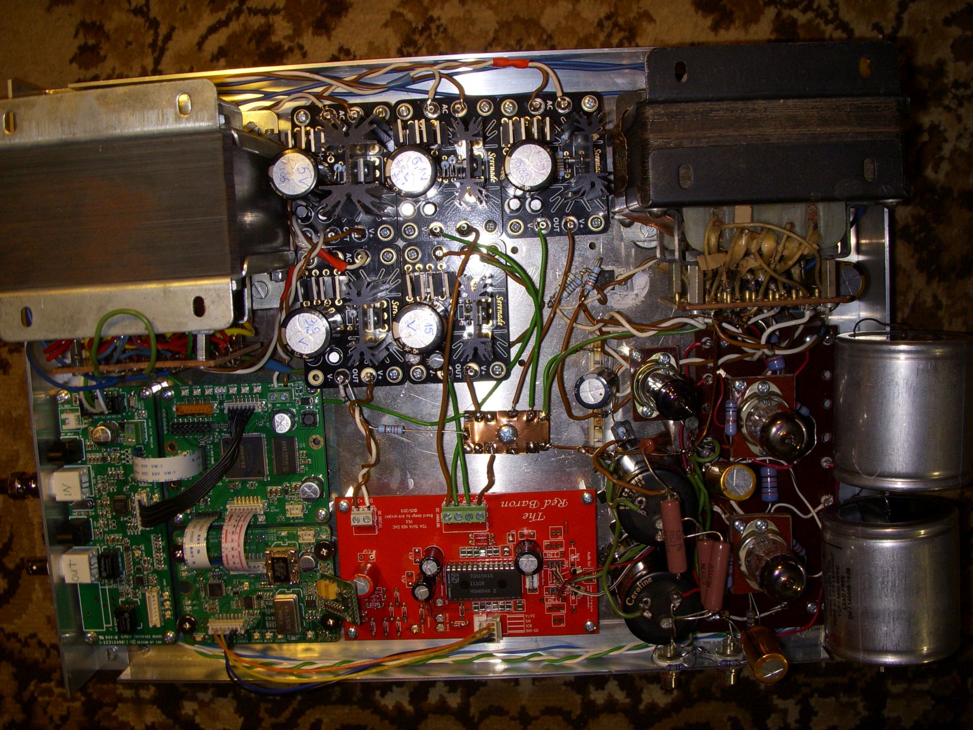

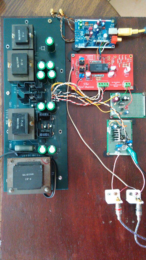

OK guys, lets see how I can upload pictures (first time for me here)
Some comments.
- this is not the final version, kind a breadboard, just to see whether it works or not
- transformers are pulled out from previous projects
- I2S to PCM modul is missing, I'm on the group buy list as you may see
- I2S connection is made with Ian's connector, just the ground wires are extracted exept for 1 piece
- Crystek CCHD 957 45MHz oscillator is installed, 49MHz one is still what I got from Ian - not so important for me
- all B+ are chinese printed boards, populated with CREE SiC diodes and LM317 regulators, Black gate capacitors. Regulator IC-s will be replaced by more sophisticated ones, but I have not decided which ones.
- current/voltage converter resistors are 47 ohm Z foils
- analog section is made with 6072 tubes
- annoying that the spdif board wakes always with optical source as default, a switch needs to be wired to the front to switch to coaxial source which I use
Any question?
Regards, Gábor

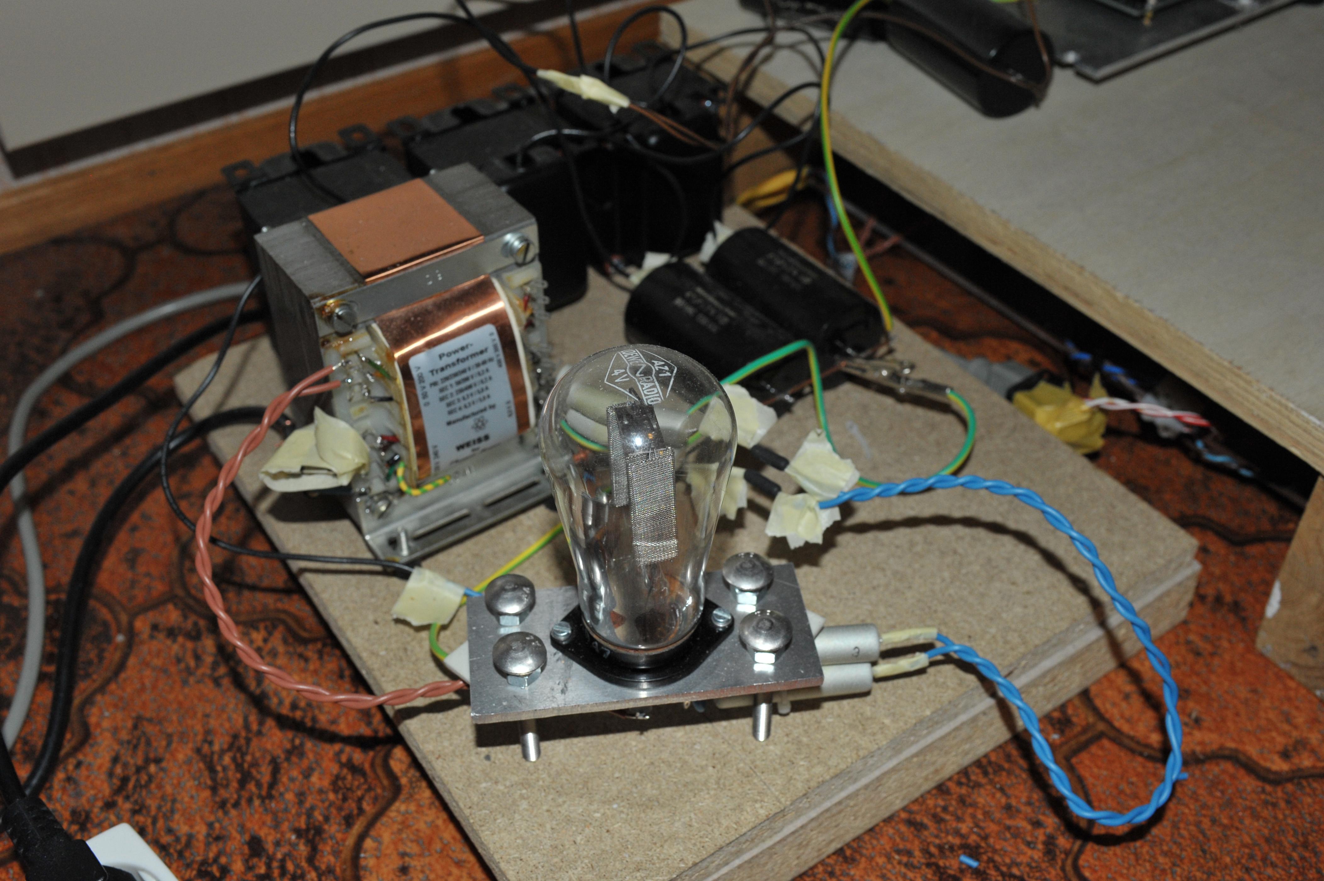

Great pictures! I'll bet it sounds nice with thouse 6072's. Is it cathode follower Kondo style?
Yes I have a couple of questions: How many boards do one need from Ian if one is going with I2s input, and what are they called? And last but not least, how many powersupplies are needed?
Thanks!
- the analog section is really a Kondo style with an anode follower and a Cathode follower next. The currents are increased a bit because I used lower anode resistor - 62K - and lower cathode resistor - 68k - well, the chance to have 2W Shinkohs is a bit limited and I had these on the self.
- if you go with I2S then you do not need SPDIF board, the widest green one on my picture.
- You need a FIFO board,
- a clock module - you should choose which one, I suggest the dual XO board which I use but please follow Ian's recommendation and replace the generic oscillator with at least a Cristek CCHD 957 xxMHz one. Or if you are a maximalist, you can choose an OCXO instead at a price of 10*.
- all above were the minimum. In this case you will have a reclocked FIFO with a precise I2S input-output.
- you can further improve the system with an Isolator board - I have one but not yet installed. It's not a must, you can live without.
- some states that the best ever is the I2S to PCM board which transforms the I2S signal to the PCM which the dac chip expects directly. Since I was late for the last group buy, I could not buy this board, because Ian had run out of them.
- Ian's power supplies - the actual digital installation needs only one +5V power supply, because the boards supply each other. But if you use an I2S isolator board, you will need one more +5V. I think when I have a PCM board, I will need a plus +5V. You can see a sidebar regulator for 3,3V, which uses the main 5V, this board supply the oscillators. You can use here another +3,3V regulator or a battery. I suggest to start with Ian's TPS7A based board and replace If needed. The Red Baron needs 4 different voltages, as yo can see on the board.

I have been using the Red Baron 5.0 and the Olivers Tube-I-Zator board for a couple of months, and so far I am very impressed with the result.
But my build seems to suffer from some kind of grounding issue. When I play music through my DAC, and I touch the volume control or the enclosure of my TVC preamplifier (Stevens & Billington) there is a hum through the speakers. The problem is only there when I listen to my Red baron DAC.
When I listen to my Salas Folded simplistic RIAA or my old DAC there is no such hum.
It is not a huge problem, as the hum isn't there unless I touch my preamlifier, but I would certainly like to eliminate the problem once and for all.
All help will be greatly appreciated.
Grounding issues are always difficult. I think good pictures and a drawing of your connections are in order to get help. Hopefully someone will see something "funky" that can be fixed.
