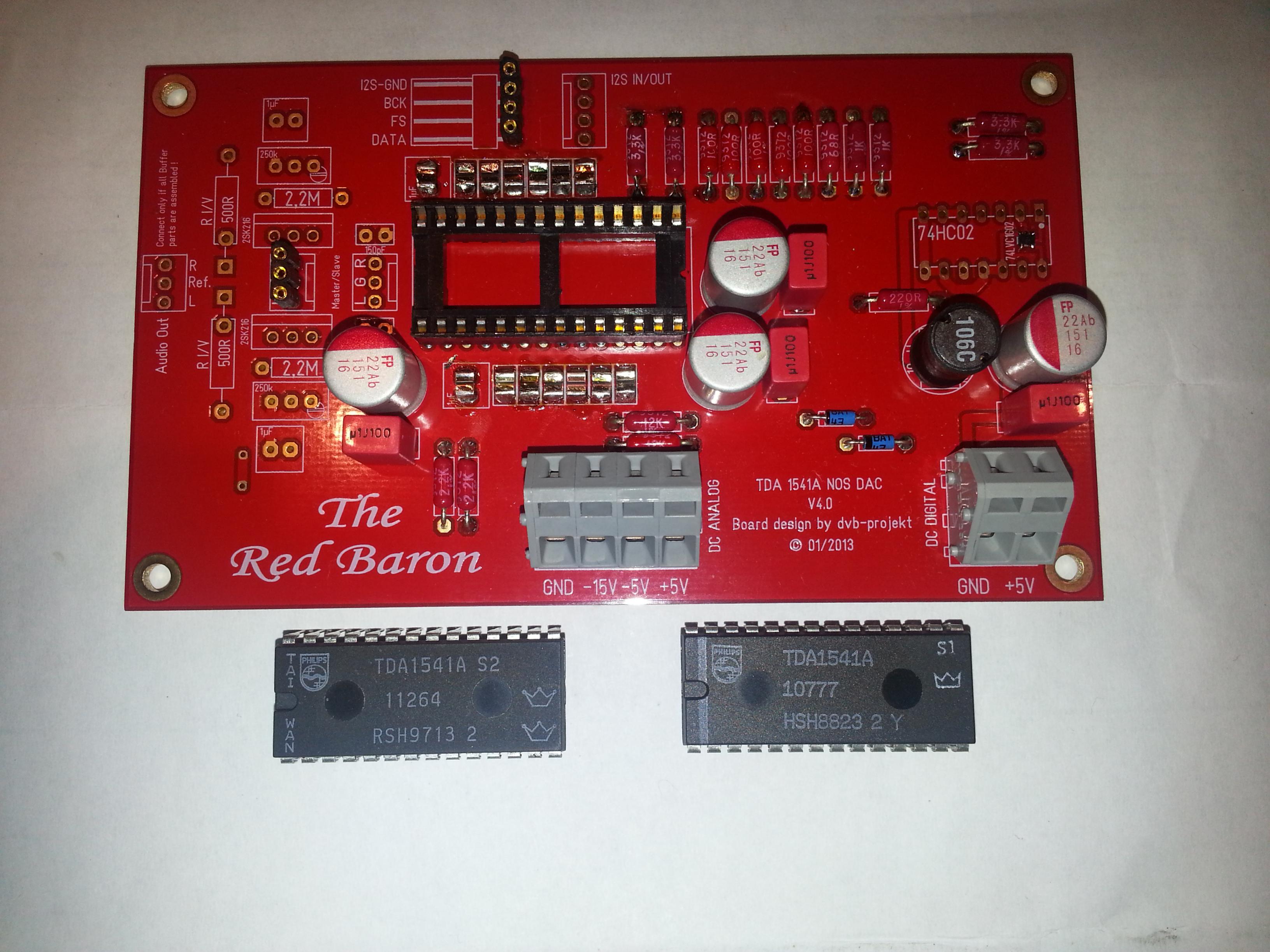

I read the files were lost in a HD crash, is there any chance that the PCB Fab might still have these files?
Sadly as the Red Baron is out of production is there an alternative board available anywhere?
I've got some TDA1541A's I want to play around with.
I have one available from his personal system. A couple of rev's back but perfectly useable. If you want it, PM me. Alternative would be Ryanj's Distinction board.

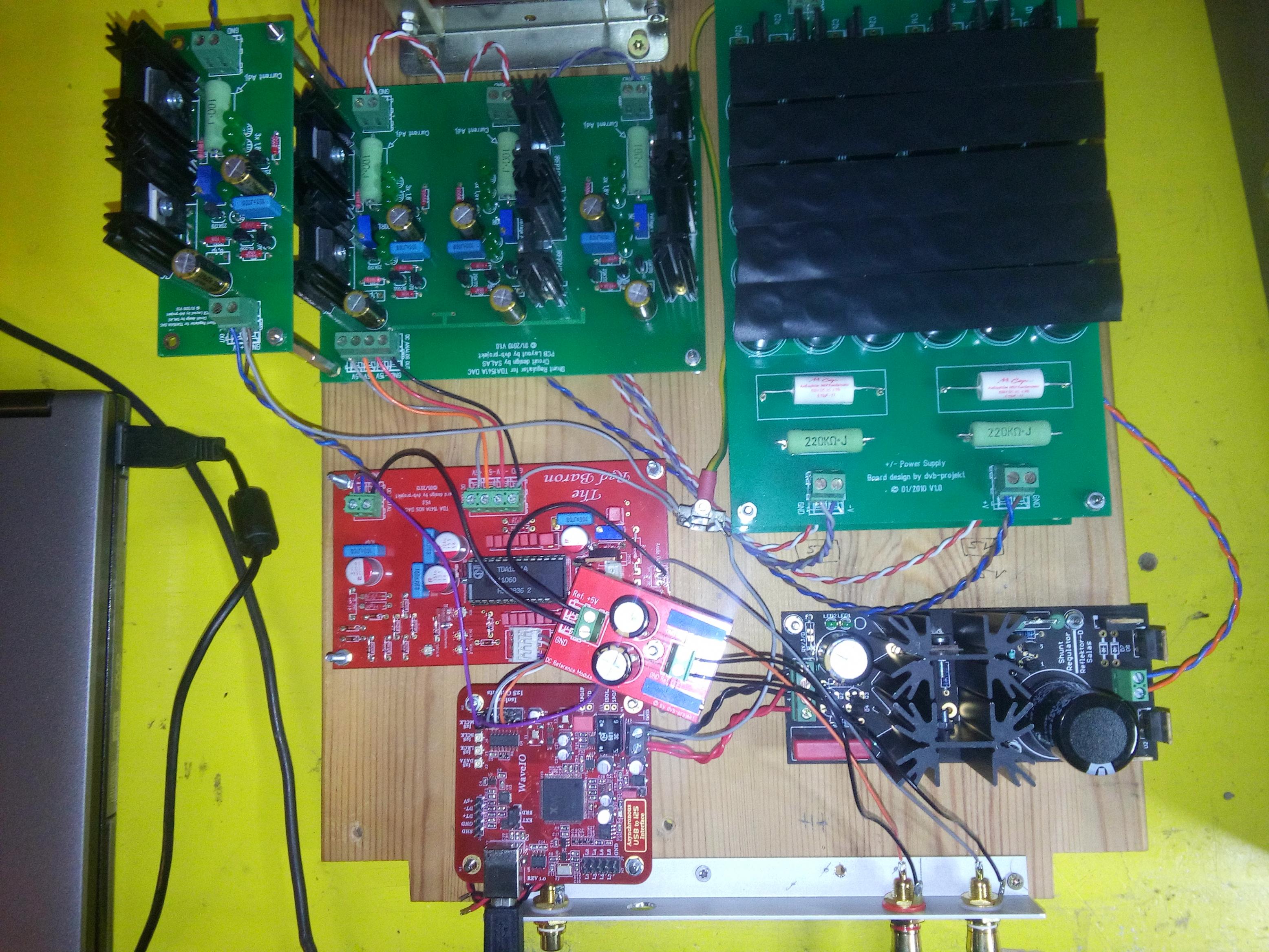

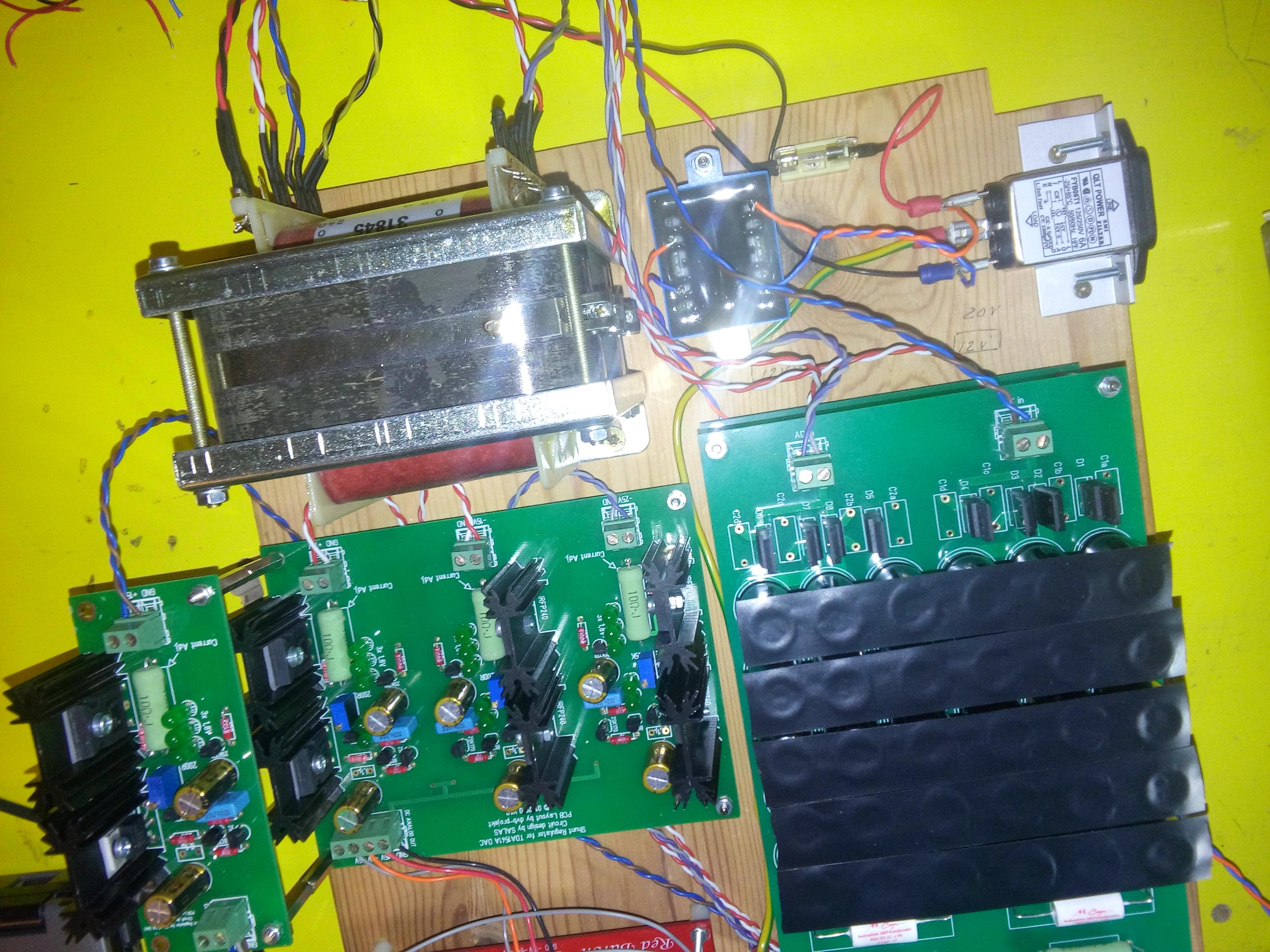

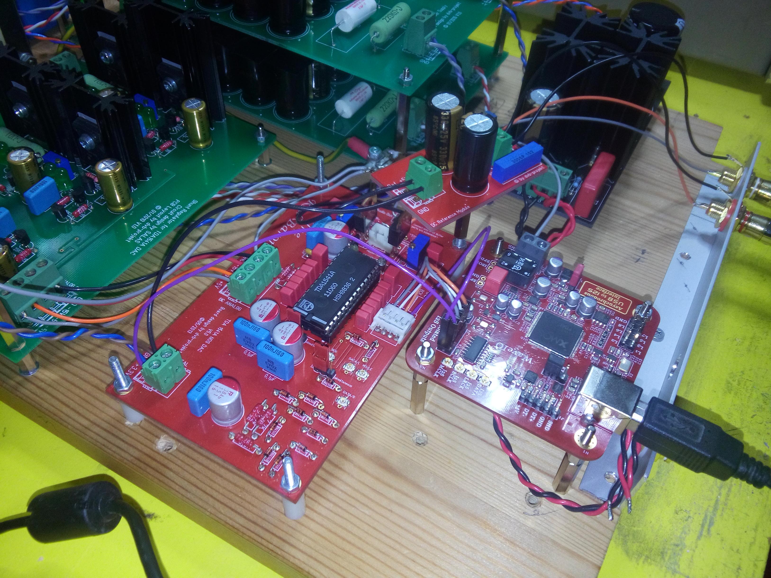

I am owner of the Red Baron DAC and I have put all parts together but I have a big problem, it will not play.
I mean I get nothing out of this device and since I am entirely newbie when it come to digital signals I don’t even know where to start.😱
I have checked and dubble checked the PSU and I have +5.3 V, -5.3 V and -15.3 V from Olivers big shunt board. I have another shunt of Olivers that is rebuilt to deliver 3.3 V and finally a Salas ReflectorD for another + 5.25 V. Olivers Shunts are delivering juice for the DAC while the Salas ReflectorD is dedicated for the Waveio and Twisted Pear WM8804. Right now I am just trying to get some sound out of this device, don’t know if it is to be called DAC until it has proven that it can in fact do the work as DAC. I have just connected the Waveio board since I couldn’t get the TPA running either and from what I have been reading here in the thread it seem that the easiest input is the Waveio, straight forward and no fuzz….. but not for me, I have no music.🙁
Should I give up or is there still hope? I got the drivers for Waveio today from Lucien at Luckit since I had bought the Waveio as second or third user and didn’t have the drivers for Windows, everything installed without problem but still no…. sound.
I also have the Tube-I-Zator but I don’t want to mix that one in this mess until I have sound from the DAC, then I can implement the Tube-I-Zator also but that will be later…. Just as implementing the Spdif with a switch between the TPA and Waveio, that will be later. First step is to get sound out from this DAC.
I am usually not stuck like this but when it come to digital signals and since I am only owner of a DMM, not any Oscilloscope, I feel like a stranded whale, I can just watch and listen but I don’t know what to do, is there anyone who are willing to help to get this working??😱😱

don't know if this helps, when I got no signal from the Red Baron, the problem was that my input signal I2C was too weak. everything was hooked up properly, voltages etc., but the signal was below the threshold for the TDA1541A to "work".
one thing you can test is having less attenuation, my Red Baron an older version than yours has 5x 100 ohm in series resistors, you can test by jumping them.
at some point I had also a 74HC125N buffer in, can't remember if it was for the bit clock, or word clock...
seeing how much you invested in power supply, red baron, wave io, I/V stages... for your troubleshooting having an oscilloscope would definitely help, i got mine for 25 eur on ebay plus shipping of course 🙂 it's pretty shabby, but you see if you have signal or not
good luck 🙂
Martin
Agree with the previous suggestions. Also work through the basics with your multimeter. Check that you have proper voltage at the power pins of the 1541a, and the DEM circuit. In my experience, if the 1541a has voltage and there is an I2S signal there will be music. Of course check that you have grounds connected everywhere there is a ground.
I forget the details of WaveIO, but are there LED's to indicate that it is powered and running correctly? I believe you can look at the driver to ensure it sees a DAC and is playing.

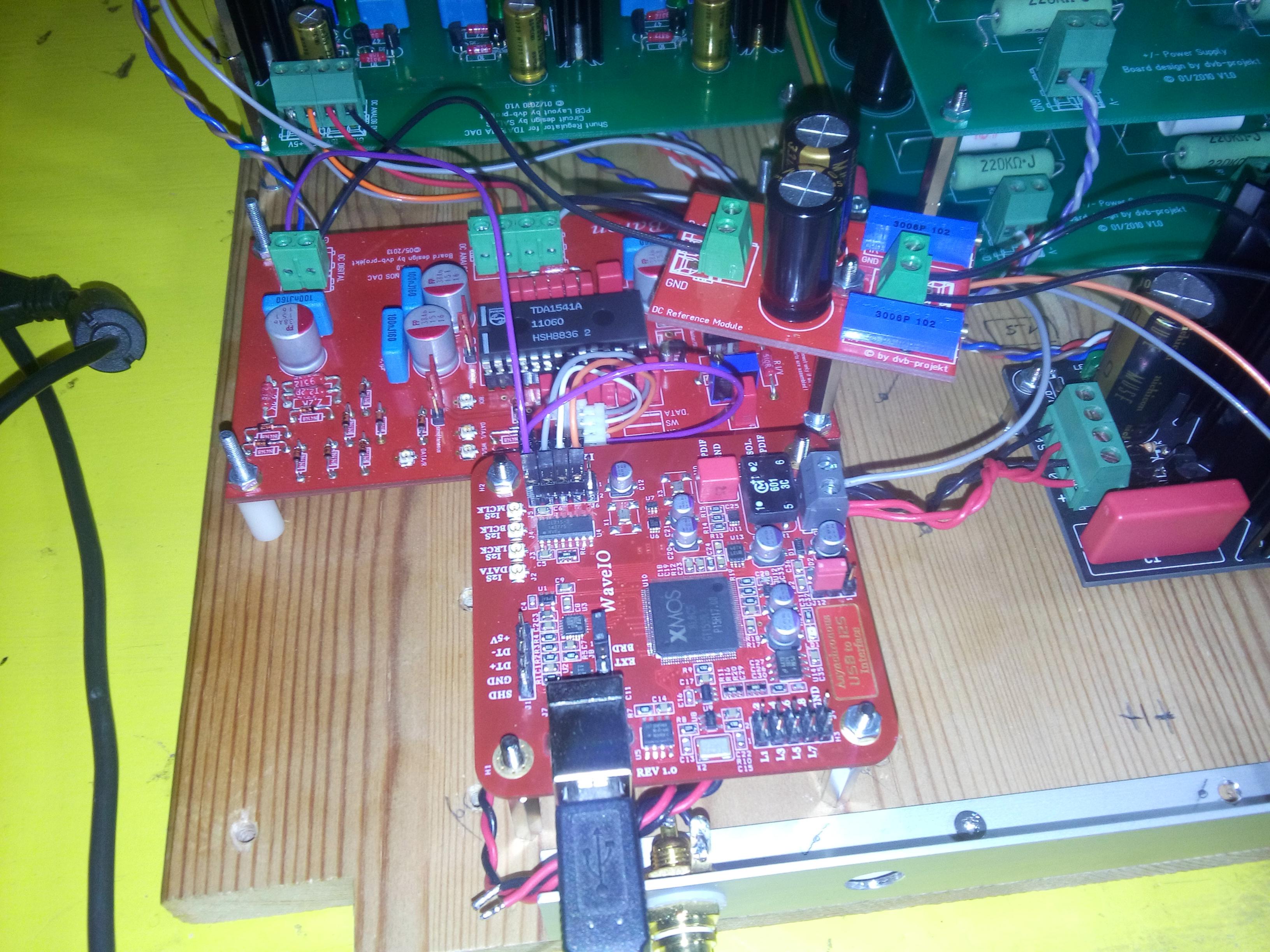

The WaveIO has two leds (my version at least) indicating if it is working properly. I have had a WaveIO working perfectly with a Red Baron PCB.
Some early morning work
I did check all incoming power and I was little on the high side when measured directly on pins 15, 26 and 28 on the TDA chip.
All ajusted to -15.100 V, -5.200 V and 5.200 V so they should be correct, I can even take them down further since it says 14.5 -15.5 V respectively 4.5-5.5 V in the data sheet with center just on -15 V, -5 V and 5 V.
Also checked for continuity from Waveio and DAC chip and here is something I don't understand. I am running the Red Baron in I2S mode and when putting a probe on Pin1, which shuld be WS I can measure continuity with the other probe both on WS from Waveio but also DT, which should be Data, is it supposed to be like that??😕
Lastly, I was thinking about the DEM oscillator and earlier in this thread (don't have the quote right now) it was asked if the 2.2 nF cap was correct since in many other applications it is just 680 pF. Was there ever an answer to this question??😕
My Waveio only have one LED but I will tonight connect LEDs for Host Found and Music Streaming so I can see what happens when I send a signal through.
