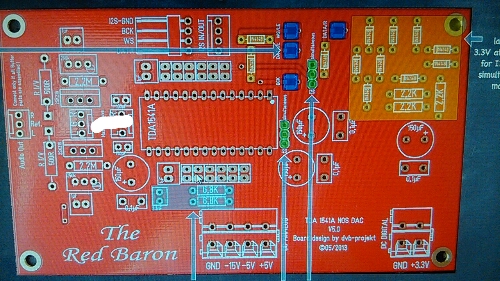

I understand Dvb Projekt ended the Red Baron awhile now, but can the Red Baron V5 pcb file be posted via link so we can continue for those late in the game?

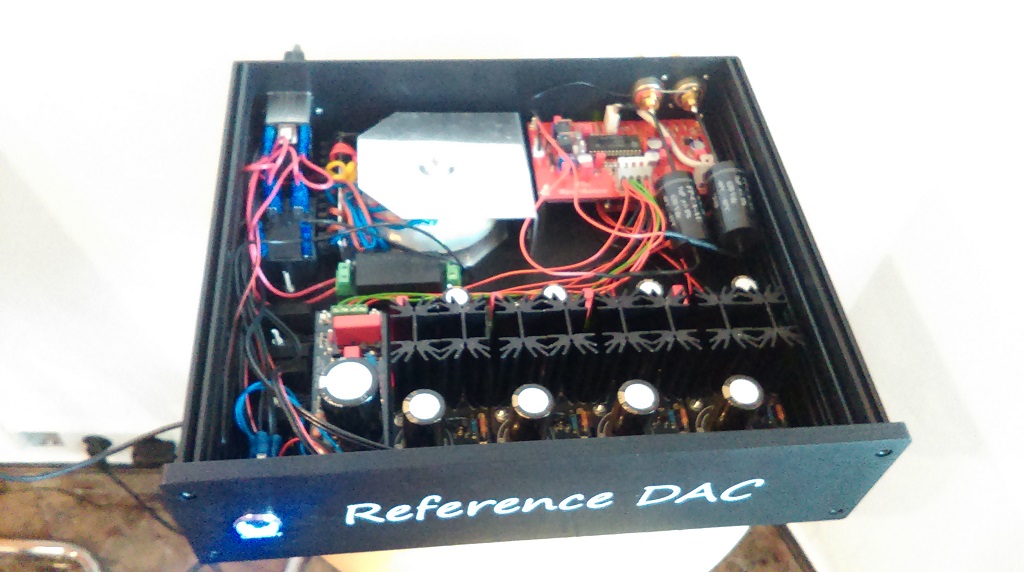

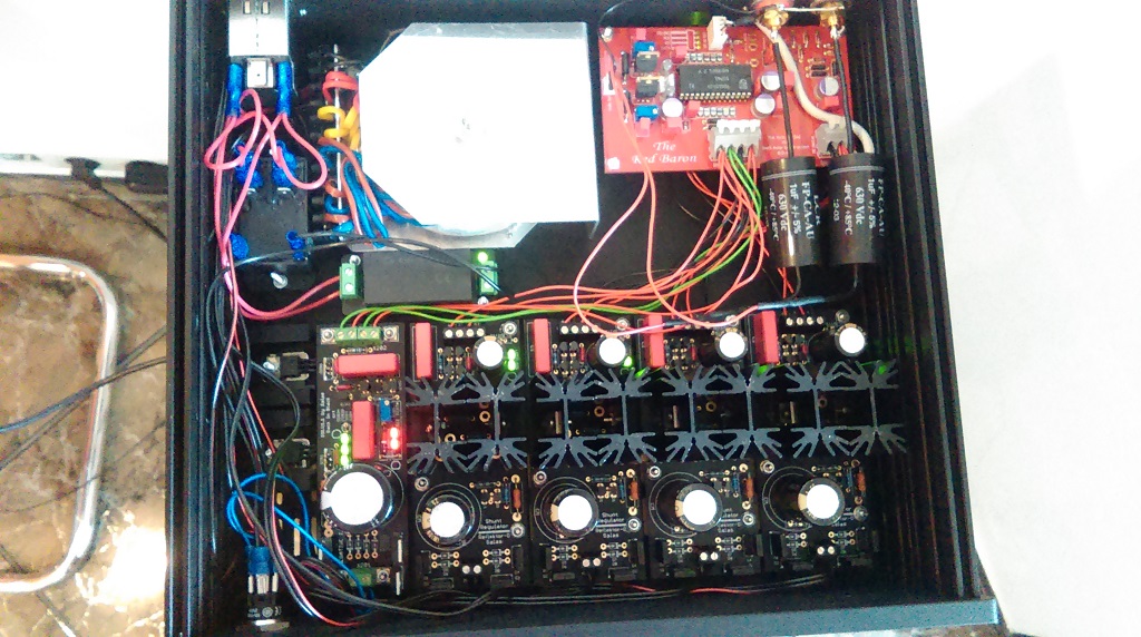

I have a fully populated red baron v5 board with the current buffer installed.
Recently completed a tube i zator board.
Can i take the current out off the board directly without removing the 2sk 216. ?
See attached picture.
To be save, remove the 2SK216. 😉
Unfortunately my RB V5.0 files are blown away at a HD crash.

It's really pity but I have at least got my hands on a Red Baron DAC that I am about to start building but I have a question about the SK170. I saw that Salas have changed the fets for SK117 in his SSHV shunt, is it possible to go the same way for the Red Baron or is it mandatory with SK170??
The price is major reason for asking but since Salas have changed the use of SK170 to SK117 I don't see no reason that it should not be possible doing the same here.

Ok, I ended up ordering the SK170BL anyway....
