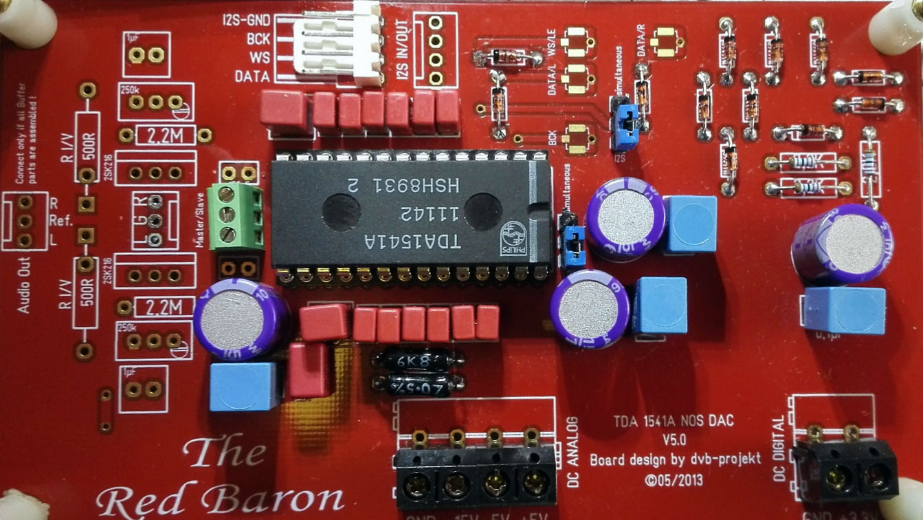

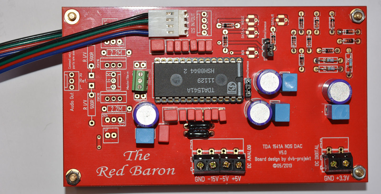

Hi Mayday, I am about to start accumulating parts for the build and would appreciate some close up photos of your completed unit.
thanks

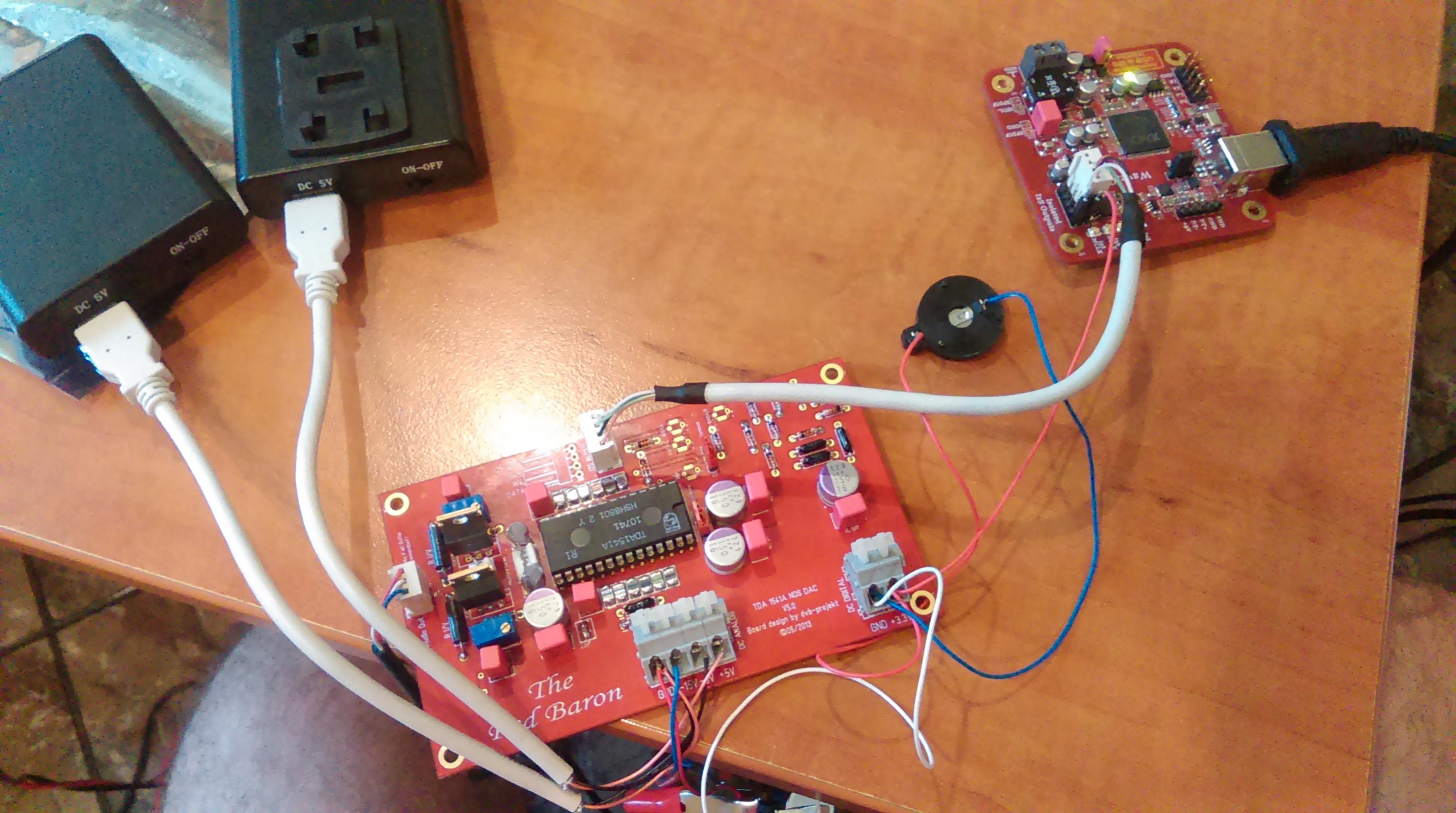

kp93300
Two of them look like this, the third has other film caps and 6K8 resistors.
If better pics are needed, I'll take some as soon as time allows.

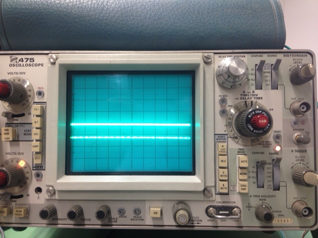

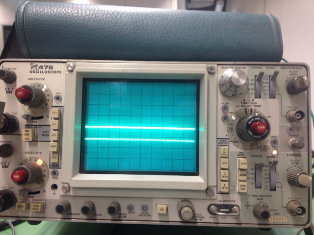

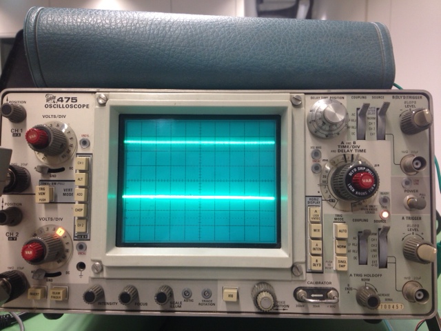

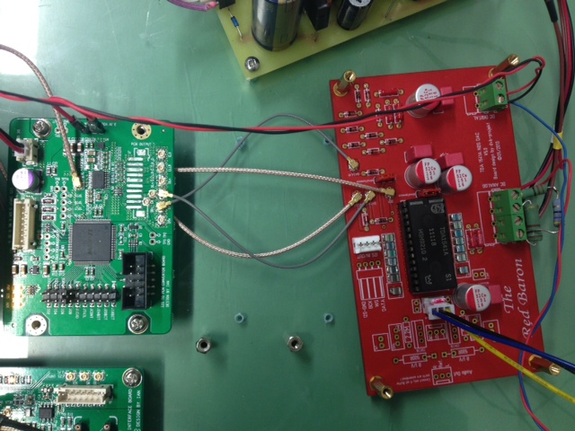

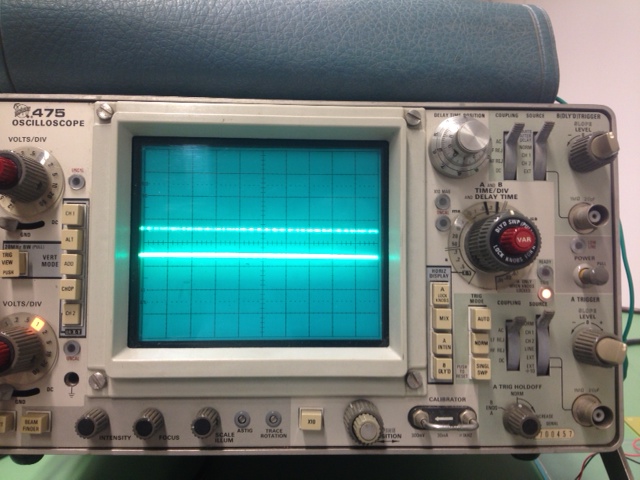

Hi Oliver,
I having troubles getting Red Baron to fly.
The signals on the le/ws, dataL and dataR TDA1541 pins are slightly above 1 V. The BCK signal is healthy 3.3V.
Before attenuation circuit all signals are 3.3 V.
Supply voltage is correct with 3.3 +-5 and -15V
Is there something wrong with my attenuation circuit?
How can I debug it?

Hi Oliver,
How can I debug it?

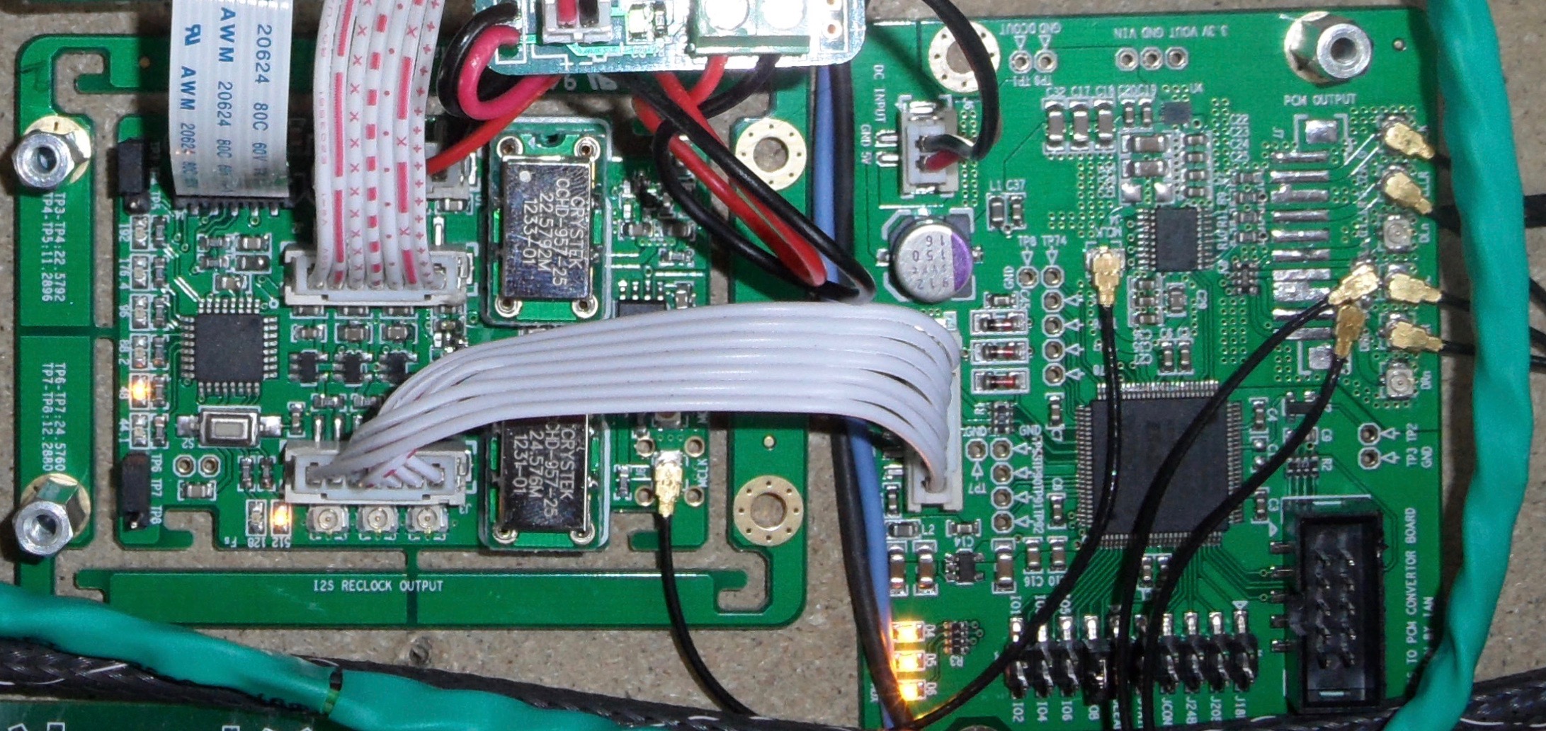

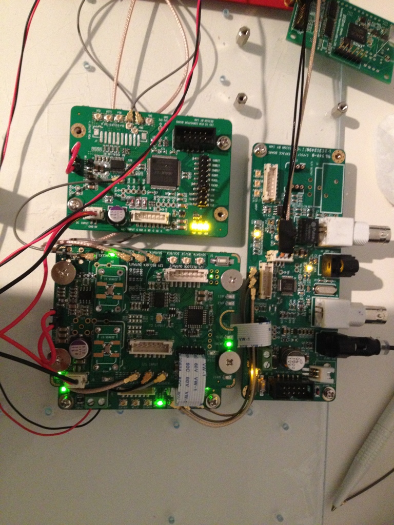

witch Clock Modules are you using (Freq.)?
Wiring as followed:
Ian´s PCM Module --> Red Baron
LLLR --> WS/LE
CLK ---> BCK
DR ----> DATA/L
DL ----> DATA/R
Did you have sound in normal I2S mod.?
BTW, i don´t see the connection between the FIFO/Dual Clock Module and the PCM... see attached.
Best,
Oliver

I use 45, 49 MHz clocks.
The wiring is correct, but I will check it again.
I did not try I2S yet - would be my next thing to try.
TDA1541 datasheet says 0.8 as low and 2V as high signal.
Is 1V high on TDA dataR/L pins enought?
What voltage is on your TDA dataR/L pins?
I think with 45, 49 MHz clocks, you must set th PCM board to Half-Speed mod.
Please look to Ian's thread about this.

Hi guys,
Need a bit of your guidance, can't figure in all hundreds of pages where can I find some guidelines for Red Baron v5.
So I've ( finally ) finished it, but the shunt regulators aren't built... so I've test it with batteries 😀
I've turned the multiturn potentiometers for minimum DC offset on output. (~0.3V)
(seems the difference to 0V must be obtained by mounting the DC reference module o the output? ) When music plays will remain on 0V!?! No danger for headphones? Can still some couplings caps be mounted for extra safety? Sorry for being noob, but things are not so clear to me :S
PS: with some (very) cheap headpohones even in this state, the music flows from it... i'm really happy 🙂
PSS: if this is not the place to write this, I please ask a moderator to move it.
Rgs,
Alex.
Red Baron Setting Points
Hi guys,
Rgs,
Alex.
Hi Alex,
here is how to use the Setting Points:
1st
2nd
You connect the DC-Reference Module as followed:
From DAC module
Ref. (Audio out) --> Ref. +5V
GND (DC Digital) --> GND
From DC Ref. Module
GND Ref. Left --> GND RCA Left
GND Ref. Right --> GND RCA Right
Trimm the RCA GND to 0V
:wave:
