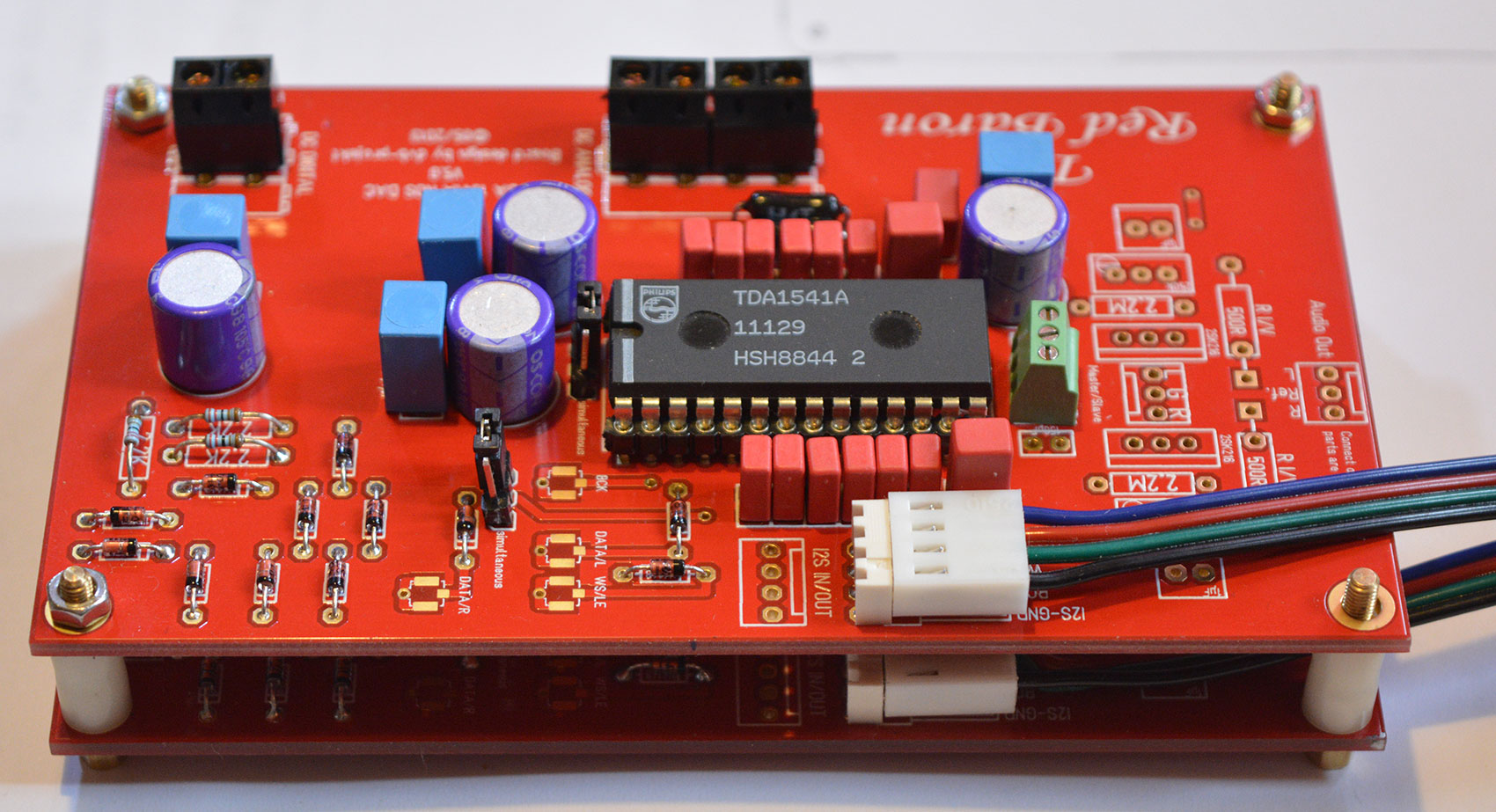

if you want to use two Red Baron DAC´s parallel with the onboard I/V stage, you must connect it like this:
1st - Every DAC module needs all parts of the I/V stage, expect the I/V resistors. Adjust the DAC output to 0V (DC-offset of the TDA1541A).
Don´t forget to make the small modification and switch the source and drain of the MOSFET like in this picture !!!
2nd - The output of the current buffers on each DAC module (inner four-sided point of the I/V resistor) must be connected together (parallel).
3rd - You need only one pair of I/V resistors with 250R value on one DAC module (four-sided / round point).
4th - You connect the DC-Reference Module as followed:
From DAC module
Ref. (Audio out) --> Ref. +5V
GND (DC Digital) --> GND
From DC Ref. Module
GND Ref. Left --> GND RCA Left
GND Ref. Right --> GND RAC Right
You could see it on this photo
5th - Trimm the RCA GND to 0V
That´s it. 😉

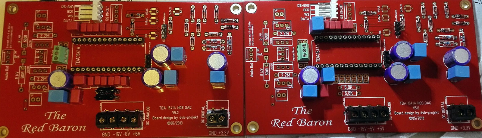

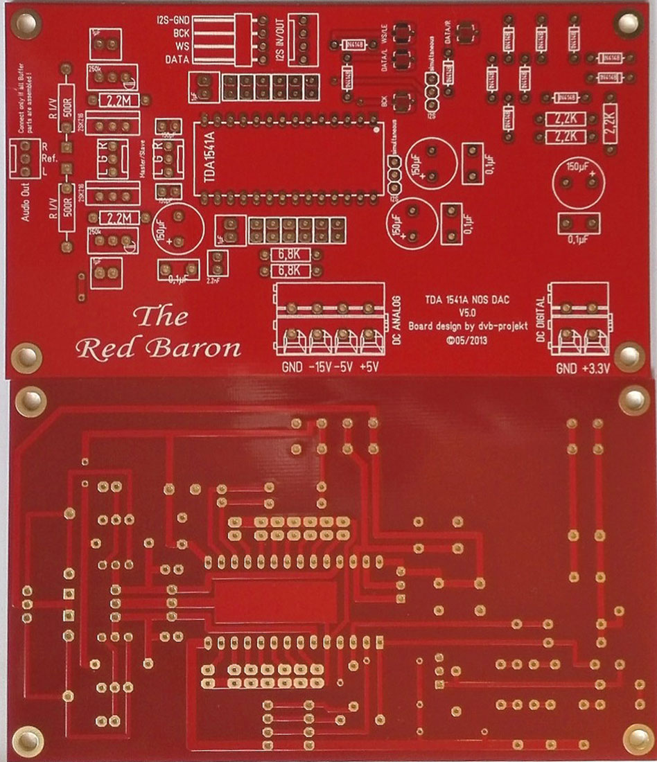

I am just about ready to build a Red Baron Dac, using two Red Baron v5.0 DAC´s in parallel with the onboard I/V stage. Please let me know if there are any major changes to how it is done from the quite ancient post featuring the v3.0 boards above?
Thanks in advance!🙂

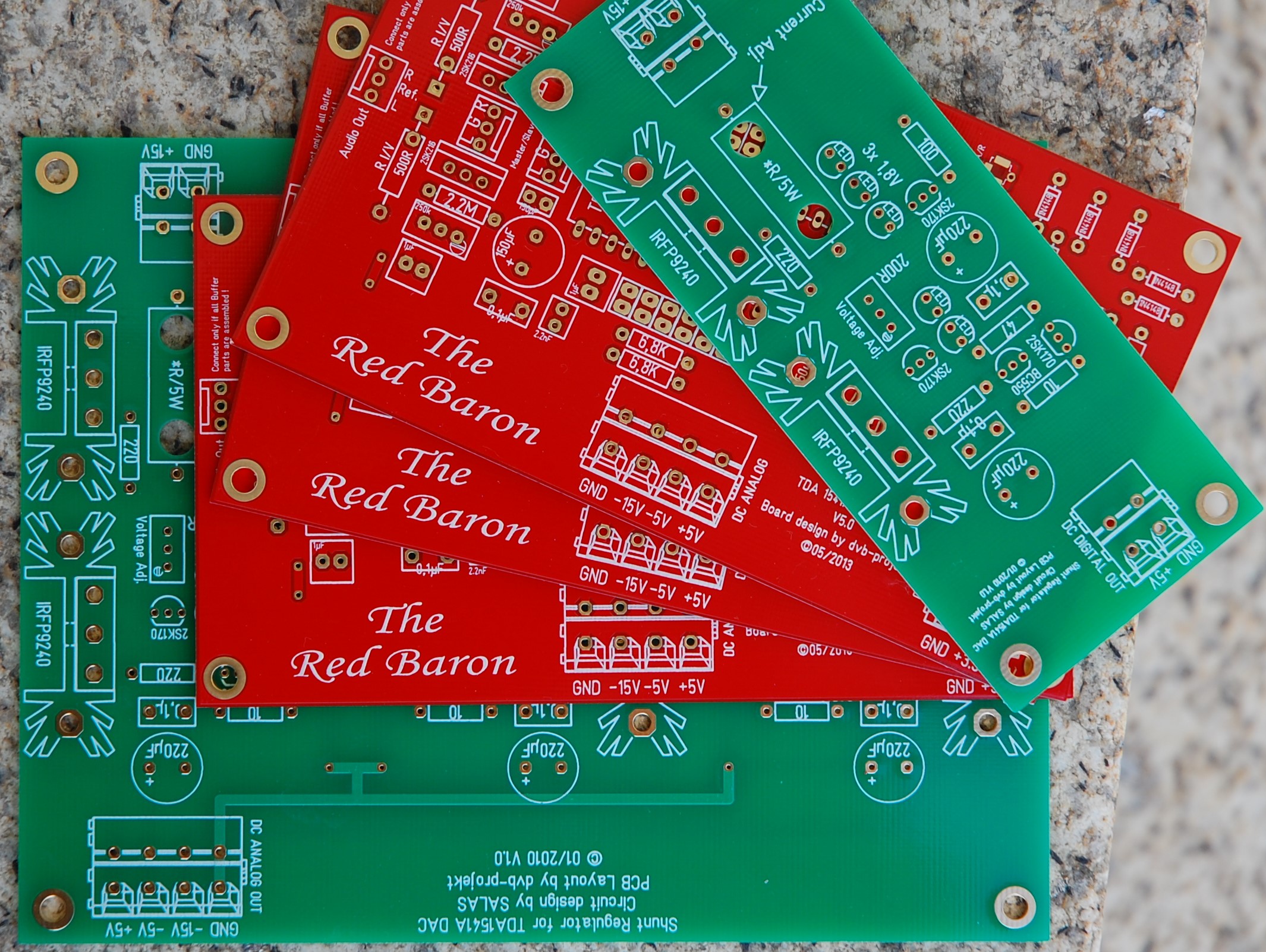

Got these at the post office today, thank you very much Oliver 🙂
The day after I got them, they looked like this 🙂
Pics of three boards, two done and one waiting for a few parts.
