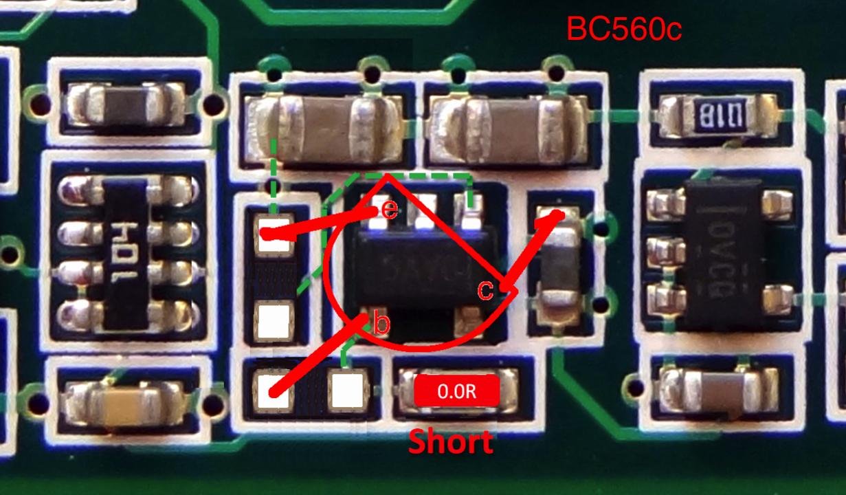

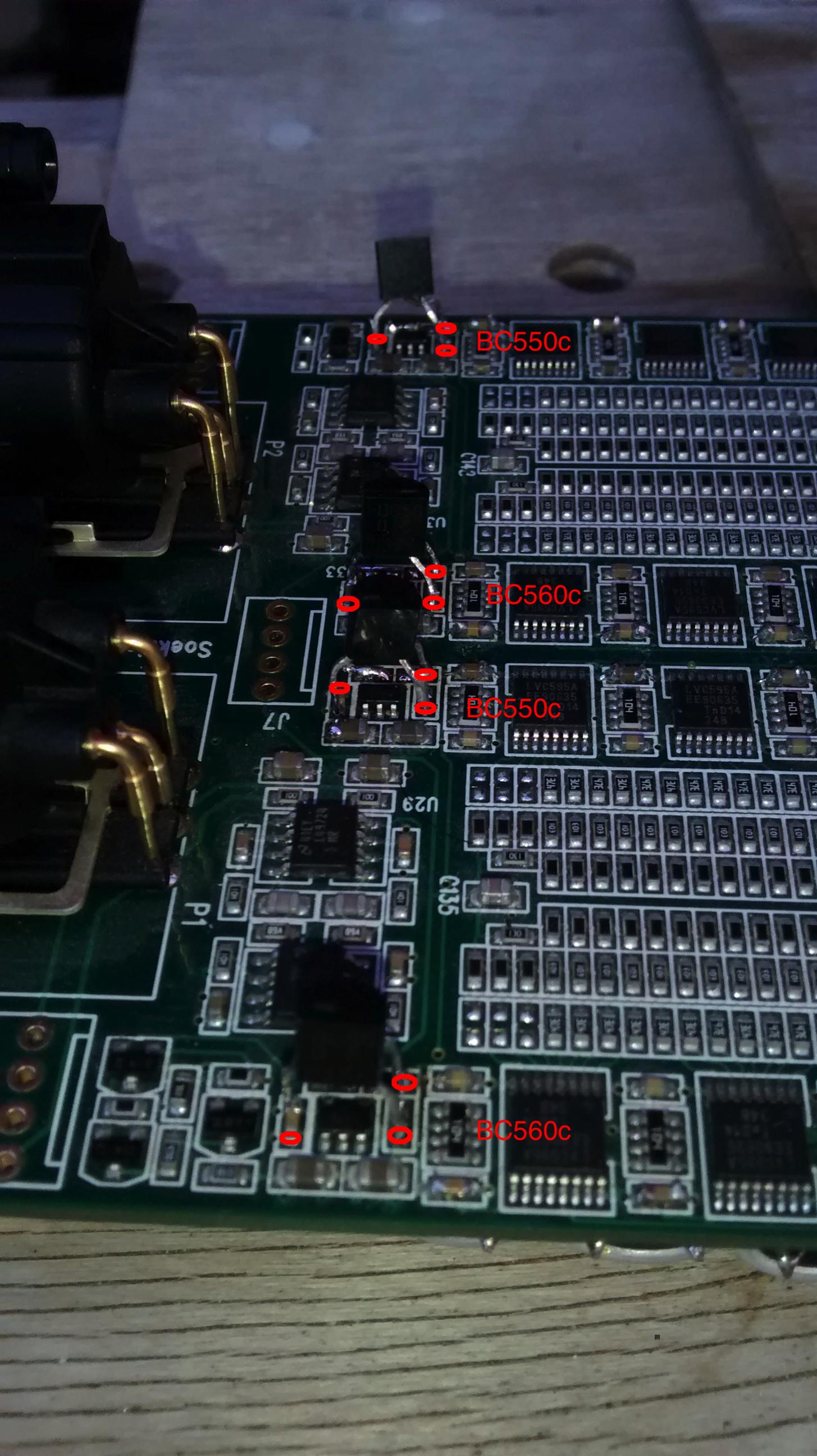

Is it the right way of doing the transistor mod for rev. 1?

correct me if I am wrong guys, but... these transistors work as the emitter followers, and then on the emitter leg, there is plenty of capacitance, like 10mF or so?
But why not add some nice capacitor on the transistor base, use a Darlington (or Sziklai) that would be something called the capacitance multiplier by a factor of beta1 * beta2 and we don't need to use these caps for Vref?
I need to simulate it...
EDIT: OK, it won't help :/ there would be a peak at around 9kHz :/

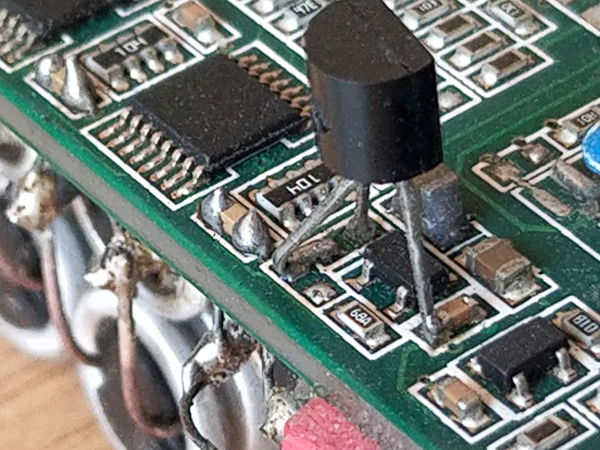

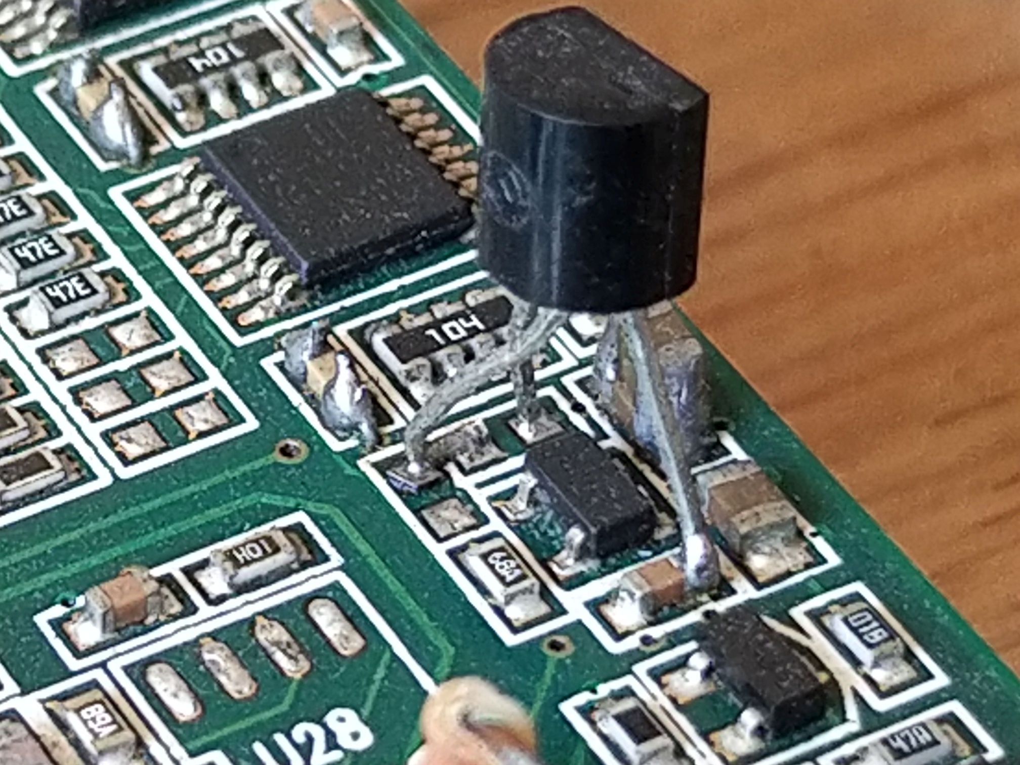

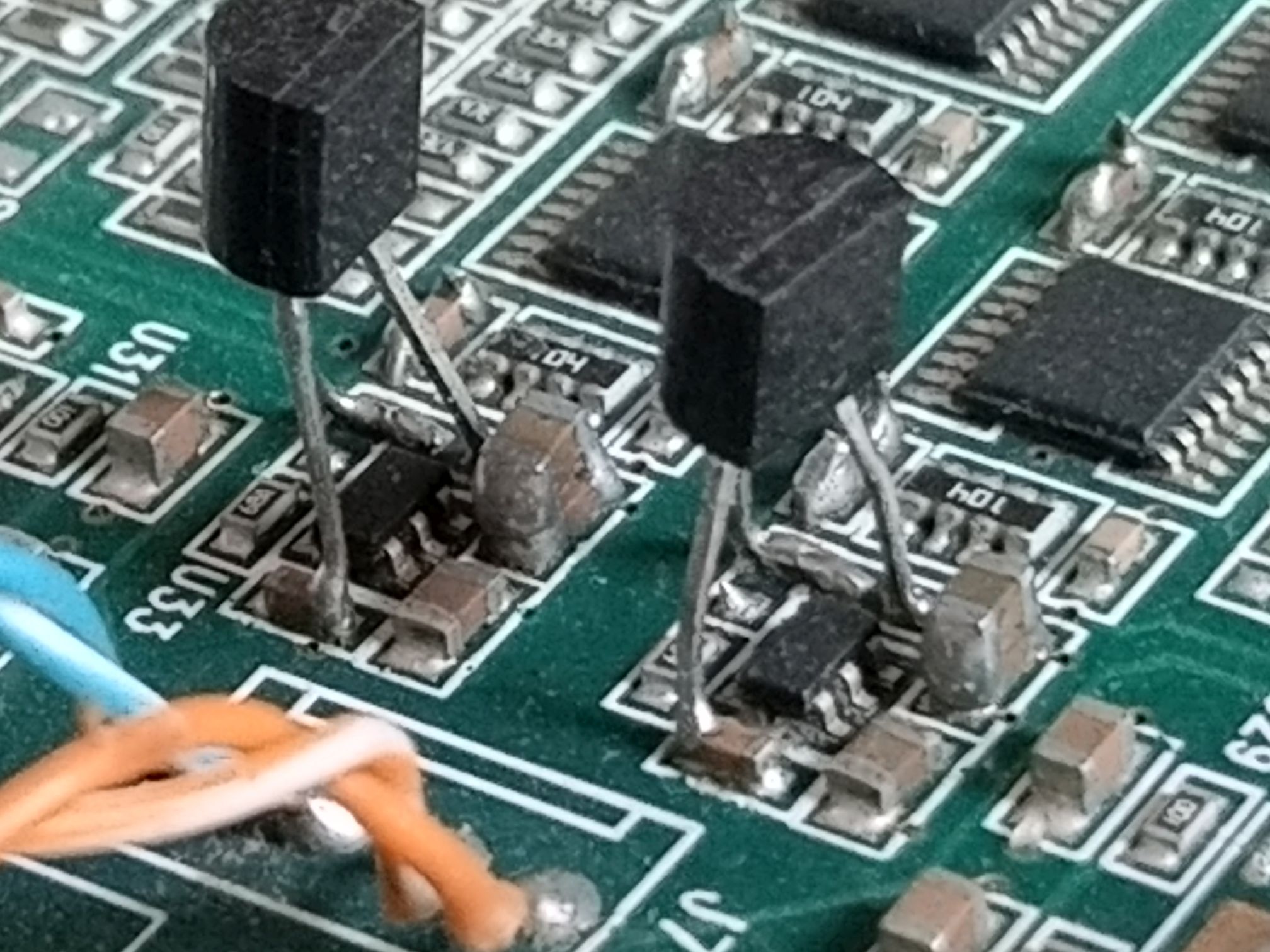

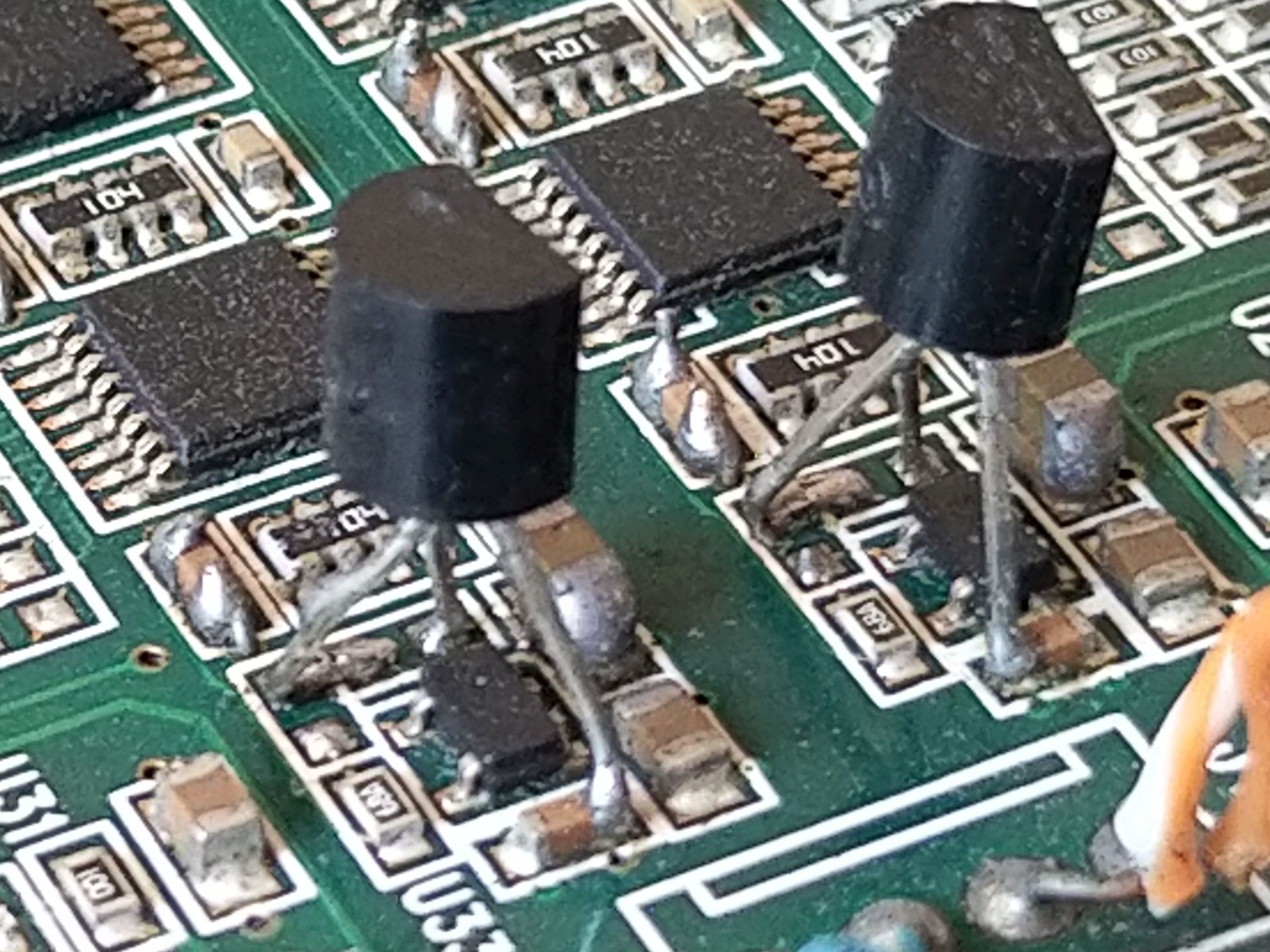

Here are some pics of the transistor mod.

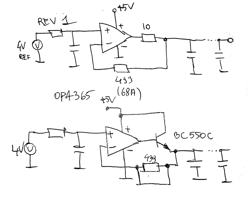

I have analyzed the Vref circuit. That was probably done before but I could not find it, this thread is so huge.🙂
I don't want to make any changes that I don't understand so I did a simulation. Shorting or leaving 68A (499 Ohms) resistor doesn't change much. It gives a small difference (in a favor of leaving) in the region of 100MHz. I would add at least a 2000uF low ESR cap on the emitter.
This mod removes the peak at about 142kHz (at least in the simulation)
I will apply these changes tomorrow and let you know if I hear any difference. For now, I'm using a simple LM317/LM337 supply but ordered Salas UltraBIB.

I have completed the Vref mod by adding BC550C and BC560C (hfe=450-500 at about 2mA) and a single polymer 2200u/6.3 cap per rail from Wurth. I left 499 Ohm feedback resistor.
Does it sound better? Well, it doesn't sound worse for sure. But if there is a difference it's not as obvious as after bypassing the output opamps and then removing the blocking 1.2nF caps (I don't need them as I'm using First Watt F2J connected directly to the DAC - amp with no feedback, single stage, the JFET input capacitance stops HF anyway). Maybe it's slightly more defined, crispier, less harsh, but it's easy to self-suggest 🙂
There is a lot of micro details, great 3D imaging, I really love it. But I am not 100% sure if that is thanks to the Vref mod 🙂
