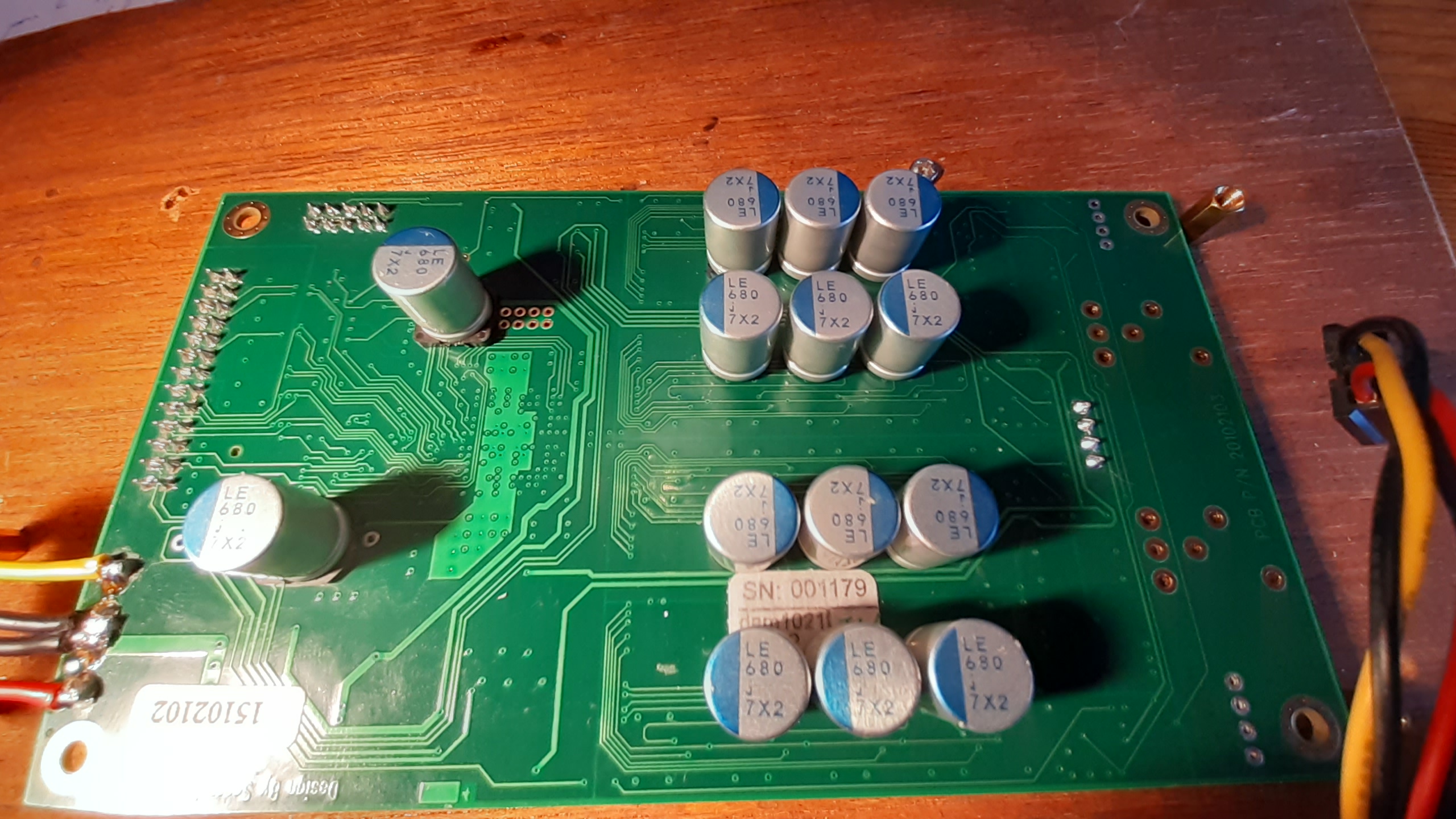

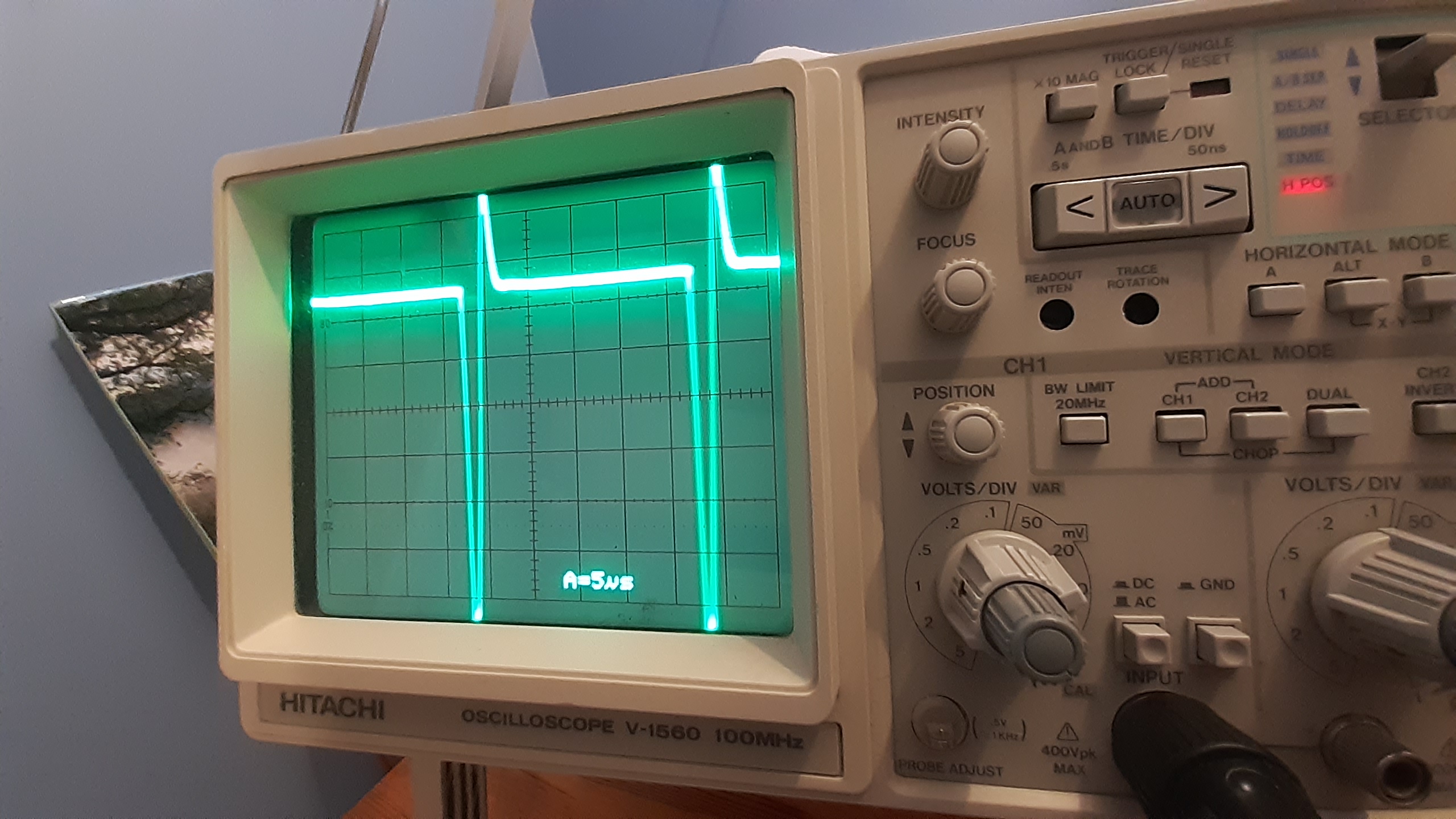

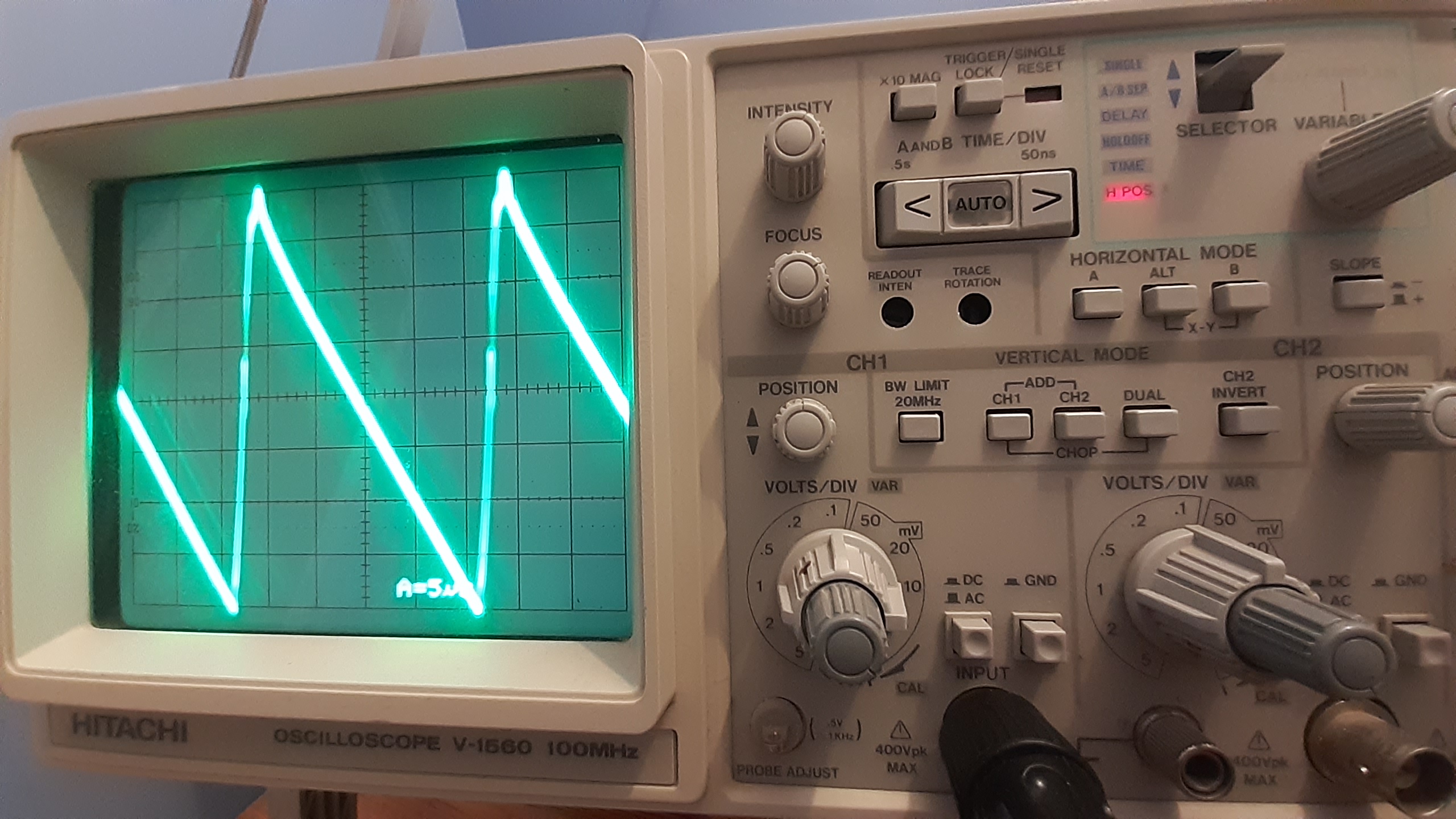

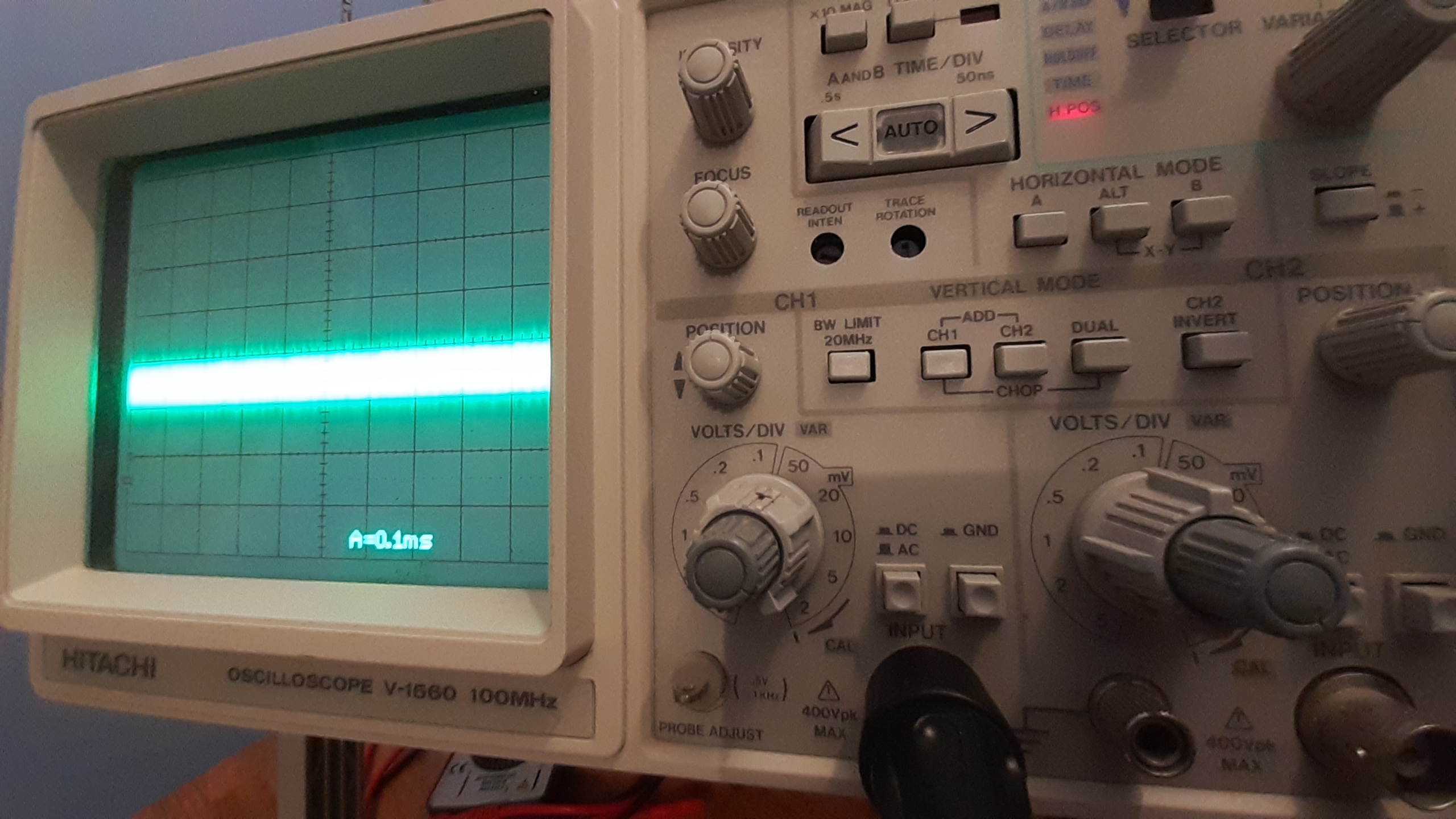

I will say that at least on my dac, there was an issue with the 3.3V regulator, generating some kind of a 80mV peak-peak saw-tooth pumping at around 40MHz.... this gave still 20mVpp ripple on the oscillator powersupply and a nasty 200mVpp swing on the positive raw supply rail. Buy a bag of 15 polymer caps and that will give you the most and simples improvement according to me.
Edit: Pics from left to right: pic1: 3.3v regulator output, pic2: impact on the supply rail, pic3: 3.3V reg output after adding caps on the two locations on the 3.3V(only 2mVpp remaining!), pic4: bottom of my board after mods. I also added 1000uF cap at the input of the 3.3V regulator (on top of the regulator, directly to its legs)
